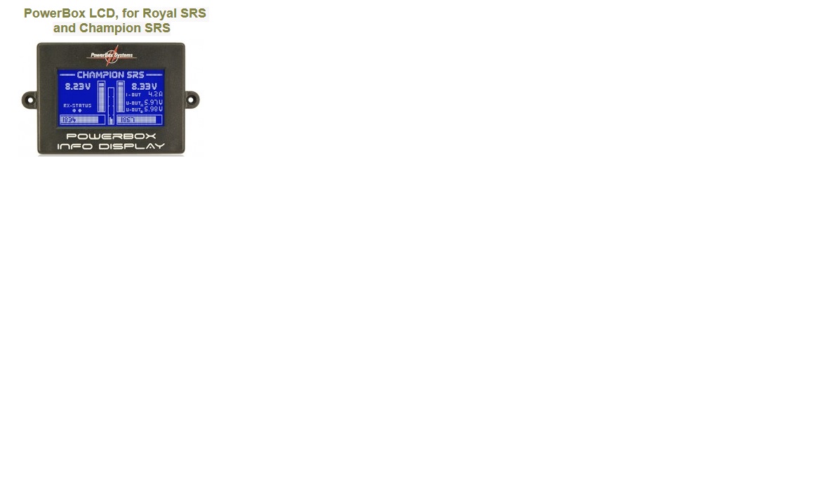

Anyone know if you can use this Powerbox LCD with the MERCURY?
