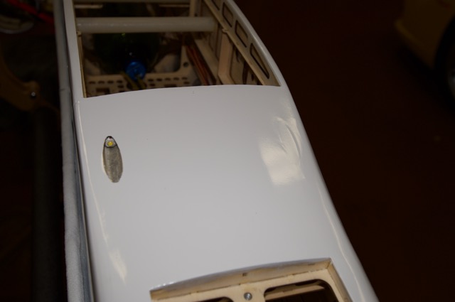

aehaas 04-15-2016 11:53 AM
2 Attachment(s)

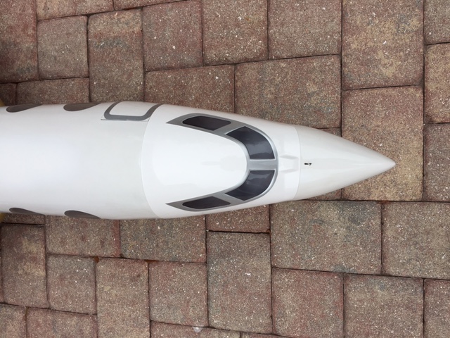

Here are some canopy pictures. The actual unit is balsa wood with the outside being a thin shaped plastic. There is room inside for pilots if you wish. The thin plastic actually drapes over the outside of the fuselage for a really good seal. The fit is good but the color is off slightly. Maybe I can paint it over for a better match if it bothers me. For now, I am not worried.
The main cabin windows are a cut out of silver plastic, slightly recessed. I prefer this to clear. It is realistic and you do not have to see inside that is just full of "stuff".
http://www.rcuniverse.com/forum/atta...mentid=2157497http://www.rcuniverse.com/forum/atta...mentid=2157498

FalconWings 04-16-2016 05:41 AM
Originally Posted by aehaas (Post 12202839)
The front will be the easiest place to put things you need to access like the receiver on-off switch, battery charging points, air fill points and gauges, controller board for my iGyro, fuel cell filling points, stopcocks, et cetera. I am not sure where I will put everything just now but the front seems like the best place to put a lot of these things.
aehaas
I'd put it anywhere else to avoid having that horrible cockpit hatch. I'd glue that thing and seal the edges, and figure out where to place the equipment.
FalconWings 04-16-2016 05:42 AM
BTW the lower hatch seems ideal for installing equipment.

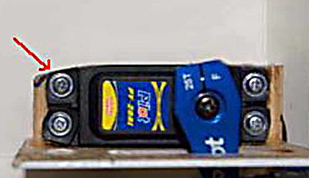

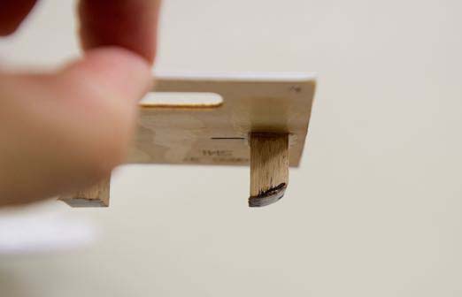

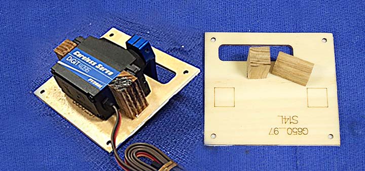

Assembly: Elevators:
Assemble the servo to the cover plate using the wooden blocks and metal servo arm. Rough sand or drill small shallow holes in the bottom of the wooden blocks to increase the surface area of contact. Use a fillet of glue on the mating edges of the blocks to further reinforce adherence to the servo cover plate.
http://www.rcuniverse.com/forum/atta...mentid=2157676
Shave the block where it touches the hinge point inside for a better fit. Pre drill the 4 servo recess corner holes on the horizontal stab, tap and add a drop of thin CA glue to strengthen the holes.
http://www.rcuniverse.com/forum/atta...mentid=2157677http://www.rcuniverse.com/forum/atta...mentid=2157678

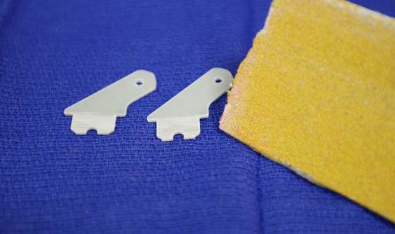

aehaas 04-16-2016 06:01 PM
4 Attachment(s)

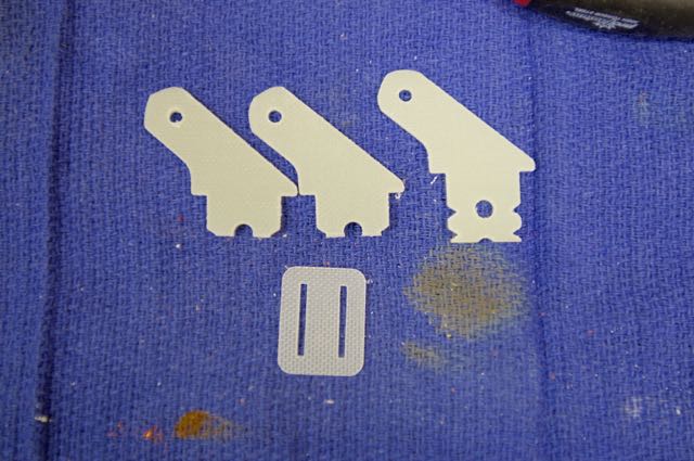

The elevator servo horns need to be shortened, then sand them ALL so that the glue sticks to the inserted portion.
Remove the Oratex from the area where the servo horn plate is to be glued down at the base of the horns.

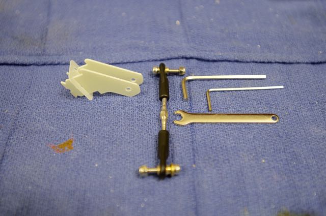

Use the connecting rods supplied, note the adjustment tools are provided. They will be adjusted later.
Similarly install the other servos. Note that there is a single longer connecting rod. This is for the rudder.

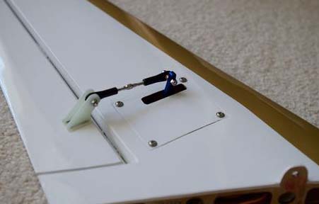

Wing servos:
The flaps are just like the elevators. The rear most portion of the aileron servos must be up against the servo hatch door and you may have to sand down the most back end so that it does not hit the top of the wing when inserted into the aileron recess. Be careful. Space is limited.
http://www.rcuniverse.com/forum/atta...mentid=2157796

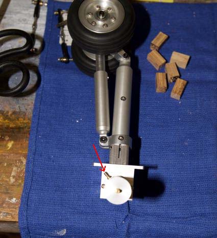

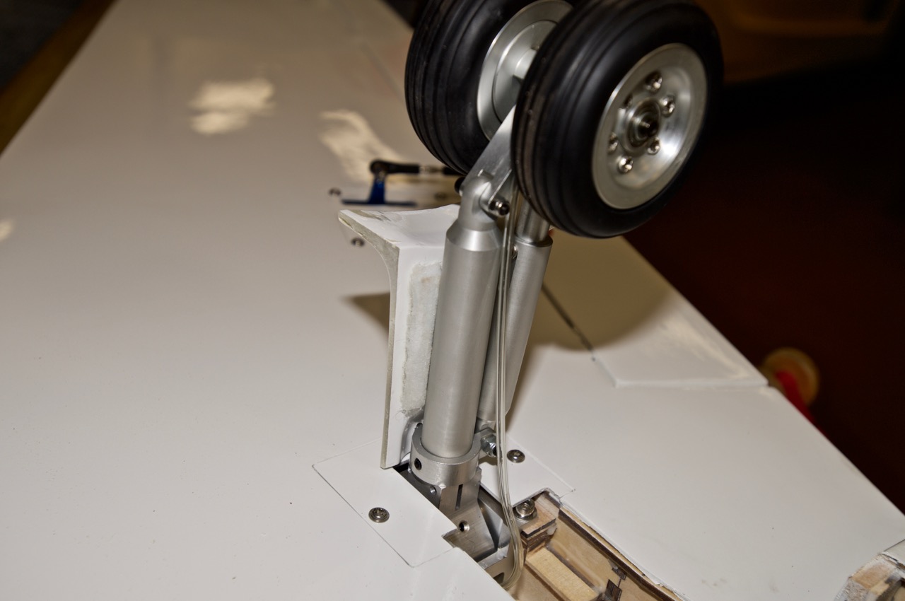

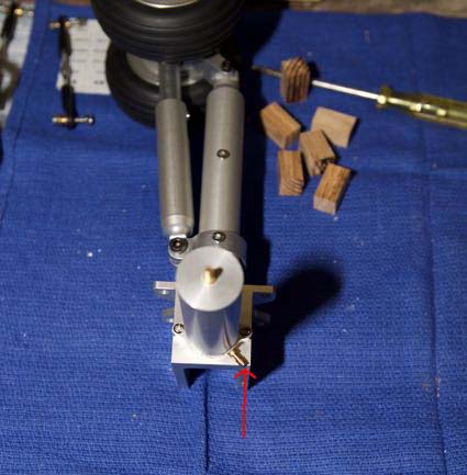

Landing gear, main:
You may need to first turn the cylinder around 180 degrees in order for the side nipple to be pointed towards the ground in the installed position. It hits the inside of the wheel well and kinks if it is pointed in the direction of the upper surface of the wing. Loosen the two cylinder screws, turn the cylinder around and screw in:
This is bad:
http://www.rcuniverse.com/forum/atta...mentid=2157797
This is correct:
http://www.rcuniverse.com/forum/atta...mentid=2157798
Temporarily place the main gear into the recess of the wing. There are hole marks already there but they may be off a little so first line up the gear to fit the opening with some space on all sides. Mark the hole locations with the gear in the retracted position. Pull the pre installed tubing out and cap the ends so wood chips do not get in. Drill the mounting holes, tap for the screws then reinforce the holes with thin CA glue.
Attach the air lines to the cylinder but not the brakes, just have plenty of line pulled out for hooking it up later. Now put the gear in and bolt it in place. Make sure all of the lines have some back and forth movement. Test the lines for operation to make sure there are no kinks then give the screws the final tightening, test the lines again. The gear should move with minimal air line pressure. Run the air lines to the dorsal wing air brakes. Test function.

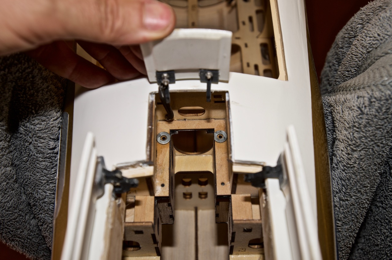

aehaas 04-19-2016 06:28 PM

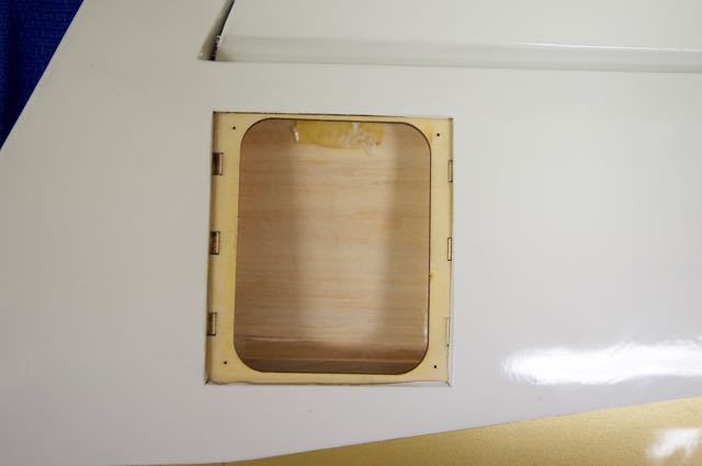

2 Attachment(s)

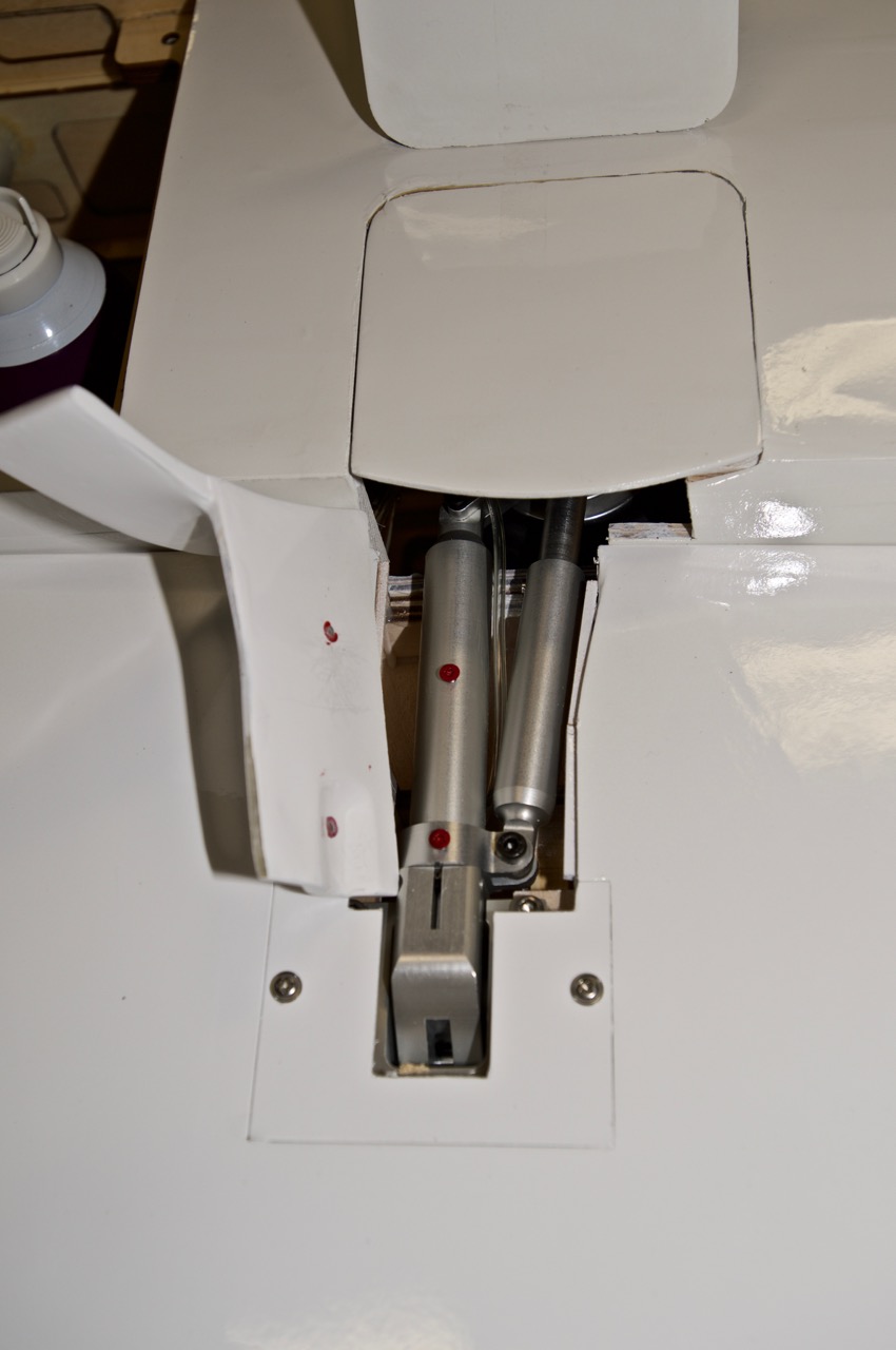

To mount the outer gear doors to the main gear the wings need to be mounted to the fuselage. With the model inverted retract the gear door mounting screws from the gear until the outer doors just touch when aligned properly. Make sure there is clearance all the way around. You may need to sand down all sides for a relaxed fit. Make sure the part that touches the wing with the gear down for landing is clear of the fixed door next to it.
Put a drop of paint on the dear door mounting screw heads then put the gear door in place with the gear retracted. The paint will show you the location to drill the holes for mounting. Drill the holes then bevel the outside so the screws are recessed. Gently move gear up and down to make sure there is clearance in all locations.
http://www.rcuniverse.com/forum/atta...mentid=2158180 http://www.rcuniverse.com/forum/atta...mentid=2158181
The gear door needs to be sitting off of the main strut. You cannot just tighten the screws down. Use thick felt or some spacers to hold the door away from the strut. Again, make certain the top of the gear door does not hit the wing when the gear is down for landing. Now you can run the brake line between the strut and the gear door. This way it is mostly hidden.

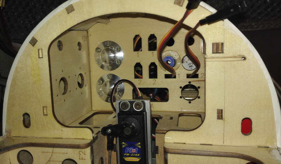

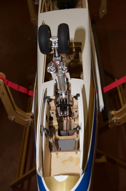

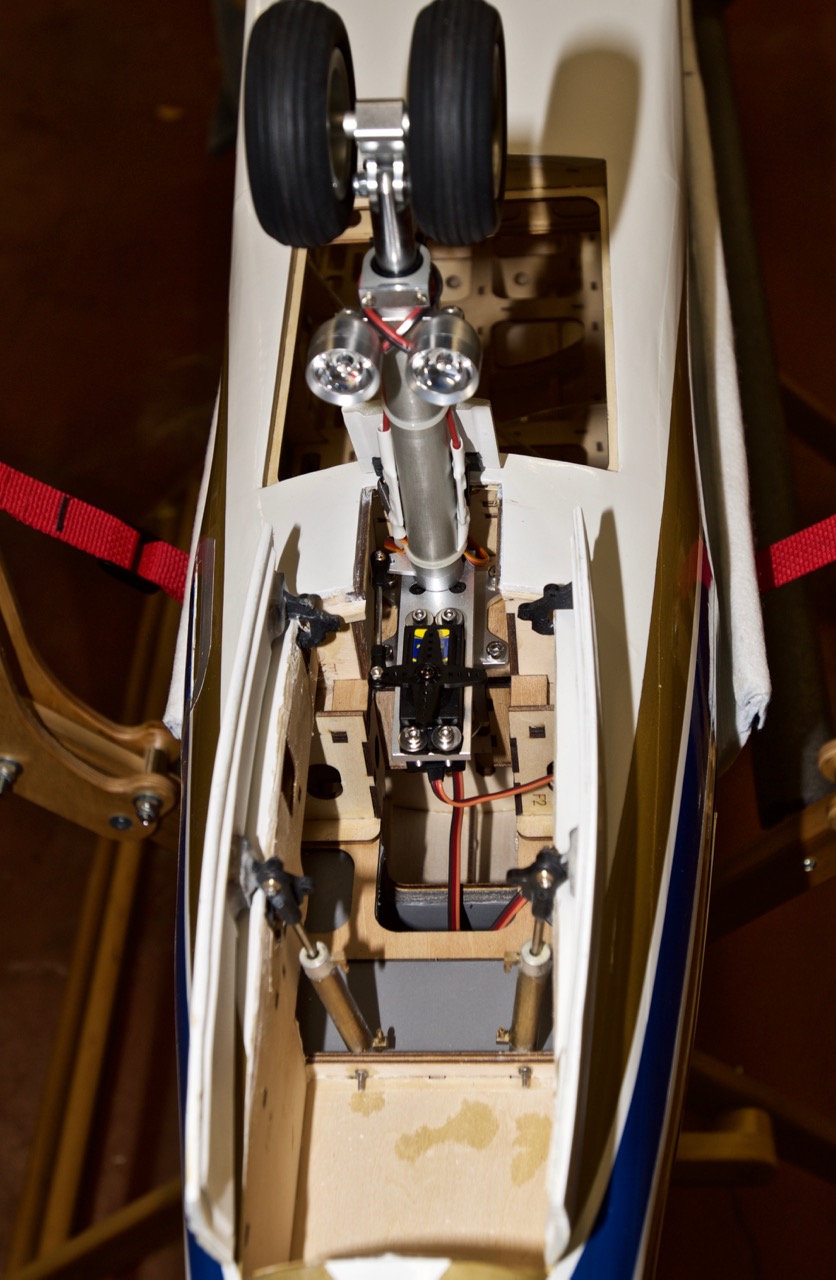

Nose Gear:
Mount the servo inverted under the steering servo tray. Use the rubber cushions on the servo but not the metal inserts. The mounting screws will not go through these. Use washers. Flatten one edge to have a better fit up against the servo, it may otherwise be too tight.
Mount the plastic servo arm then the smallest, thin connecting rod to the strut steering arm and then the servo arm. One end is on the bottom the other end on the top so that the rod is mounted level when completed. Attach air line to the cylinder.
The metal washer shims on the fuselage mounting recess may need to be trimmed to the opening. Use a drum sander on your Dremel. Place the mechanism into the recess then locate the holes, they should match up pretty well to the starter holes already in place. Drill, tap then strengthen the holes with thin CA glue.
Mount the nose gear to the fuselage. Connect air lines to the gear doors. Test the nose gear function and the gear doors.
http://www.rcuniverse.com/forum/atta...mentid=2158293 http://www.rcuniverse.com/forum/atta...mentid=2158294

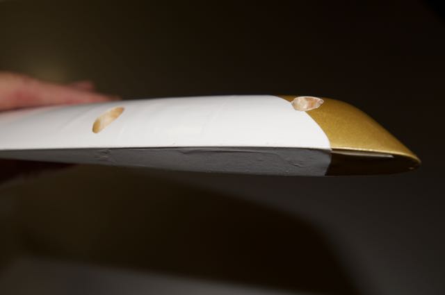

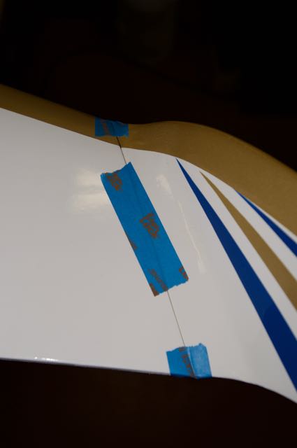

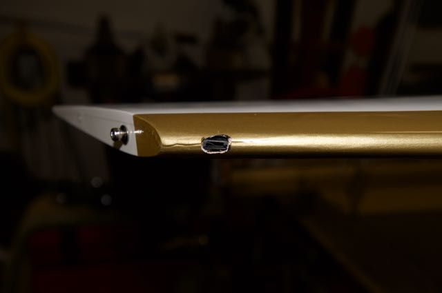

Wing Tips:

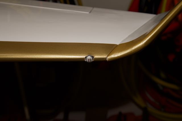

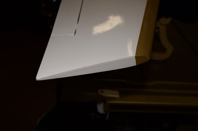

You may need to widen the holes in the wing tips to allow the allen screw to go through smoothly. Tape the wing tip to the wing then drill into the wing just enough to locate the holes already there but covered with Oratex. Remove the wing tip and cut the holes fully to allow for the screws to pass through into the blind nut inside. It is down the hole a little ways. If you cannot easily screw in the bolt then you may need to tap the nut removing the glue or whatever clogged it during construction. If you loosen the blind nut too much then push it further in to get rid of it. Epoxy into the hole to make it solid. When dry drill and tap the entire hole. Strengthen with thin CA. Now you can install the winglets.
http://www.rcuniverse.com/forum/atta...mentid=2158889http://www.rcuniverse.com/forum/atta...mentid=2158890http://www.rcuniverse.com/forum/atta...mentid=2158891

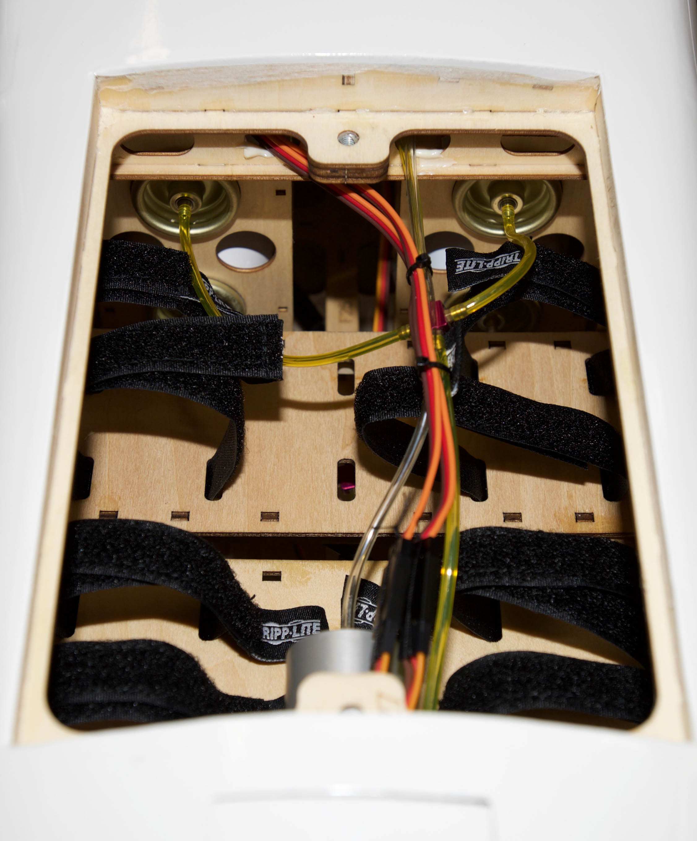

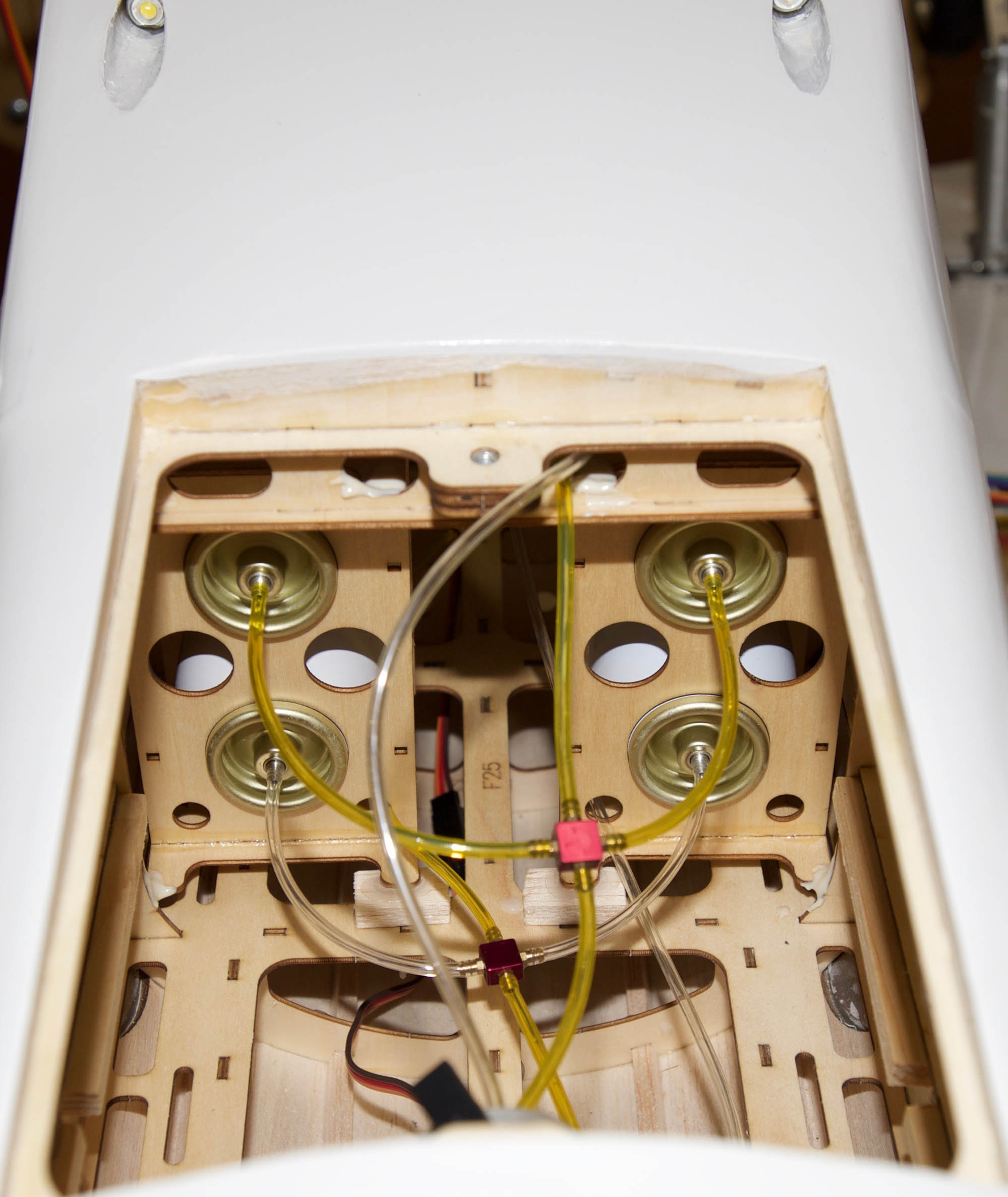

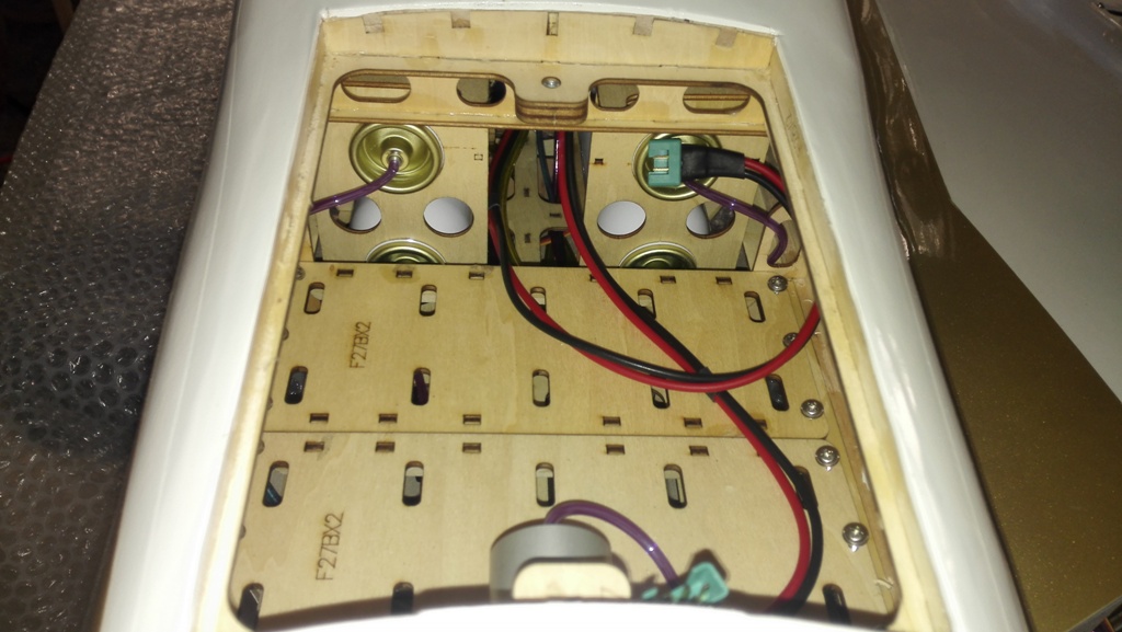

aehaas 05-03-2016 03:57 PM

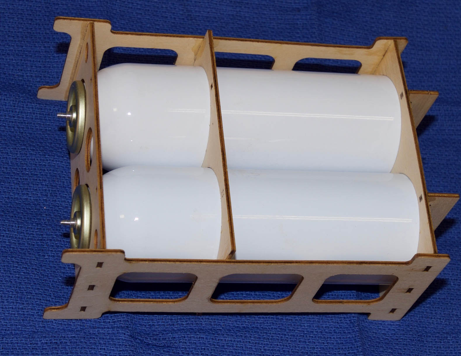

6 Attachment(s)

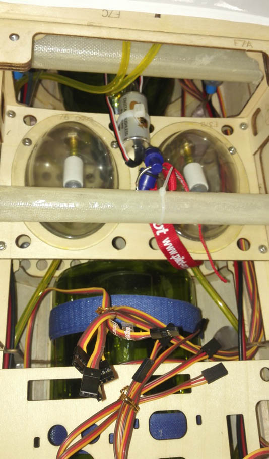

Make 2 pair of air banks using the supplied wood. The tabs on the rear should be glued lightly to allow for removal in case the cans need to be replaced by backing them out to the rear of the installation.
Install fuel cells onto their cradles and secure with Velcro. Install the air banks just behind the forward battery compartment. Make sure they are against the sides so that they do not interfere with the fuel cell cap.
Run your air lines. Some may use a dual supply while others may choose a single larger supply. The pressure guage(s) and filler port(s) are in the foreward canopy compartment area, the lines going to the rear go to the various controllers.
Run air lines from the nose gear and nose gear doors at this time. These run back to the controllers in the main compartment midship.
Install the battery platforms between the air cans and the nose gear former. Install Velcro straps to hold the batteries.
http://www.rcuniverse.com/forum/atta...mentid=2160726 http://www.rcuniverse.com/forum/atta...mentid=2160727 http://www.rcuniverse.com/forum/atta...mentid=2160728 http://www.rcuniverse.com/forum/atta...mentid=2160729 http://www.rcuniverse.com/forum/atta...mentid=2160730 http://www.rcuniverse.com/forum/atta...mentid=2160731

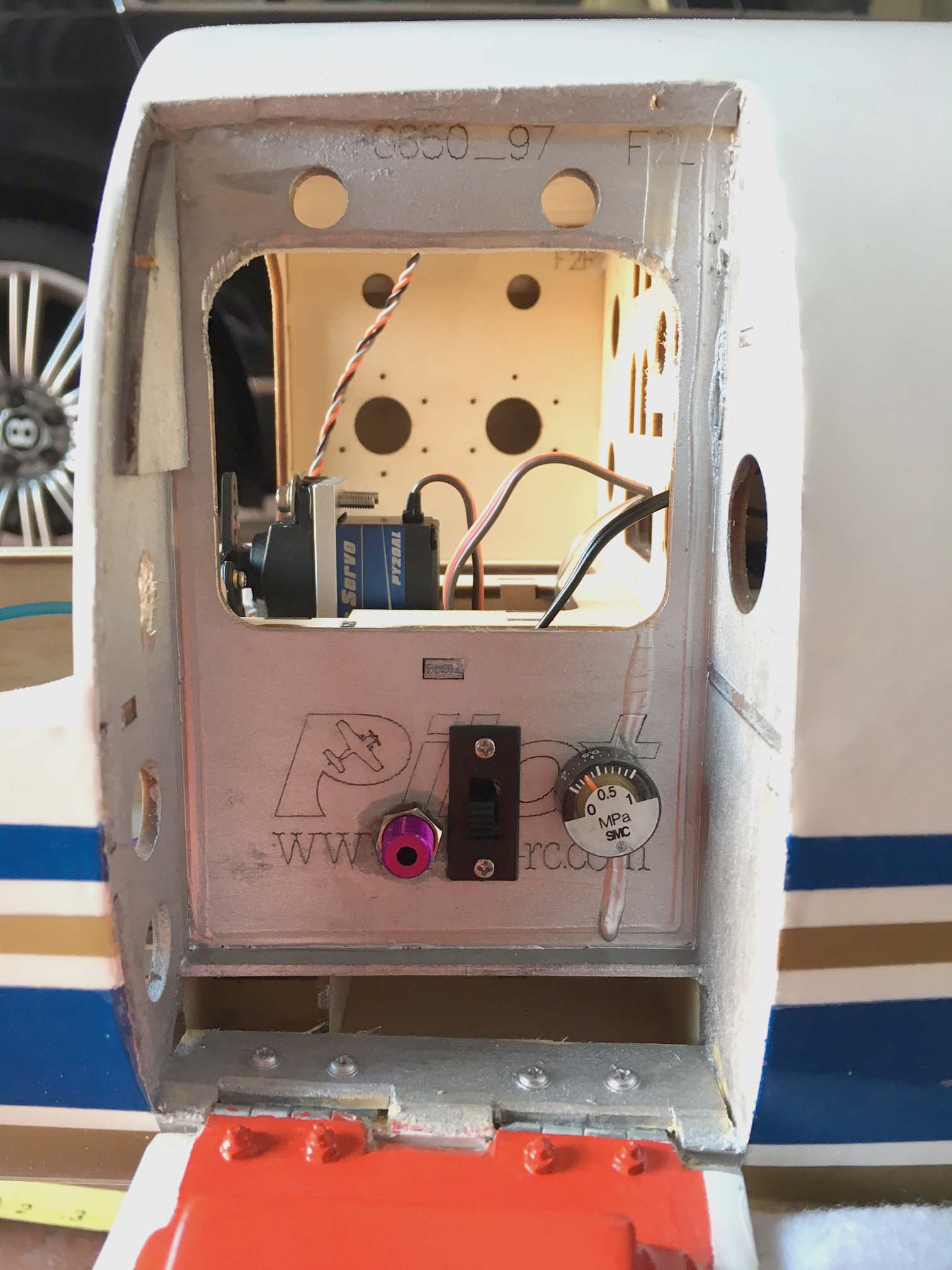

You can also use the cabin door area for electronics. I added a BVM air filler, the switch for the AR12120 Spectrum receiver and the air fill pressure gauge to this area. The fuel fill lines are going to come out of the most rear hatch to fill the fuel cells,
http://www.rcuniverse.com/forum/atta...mentid=2162057

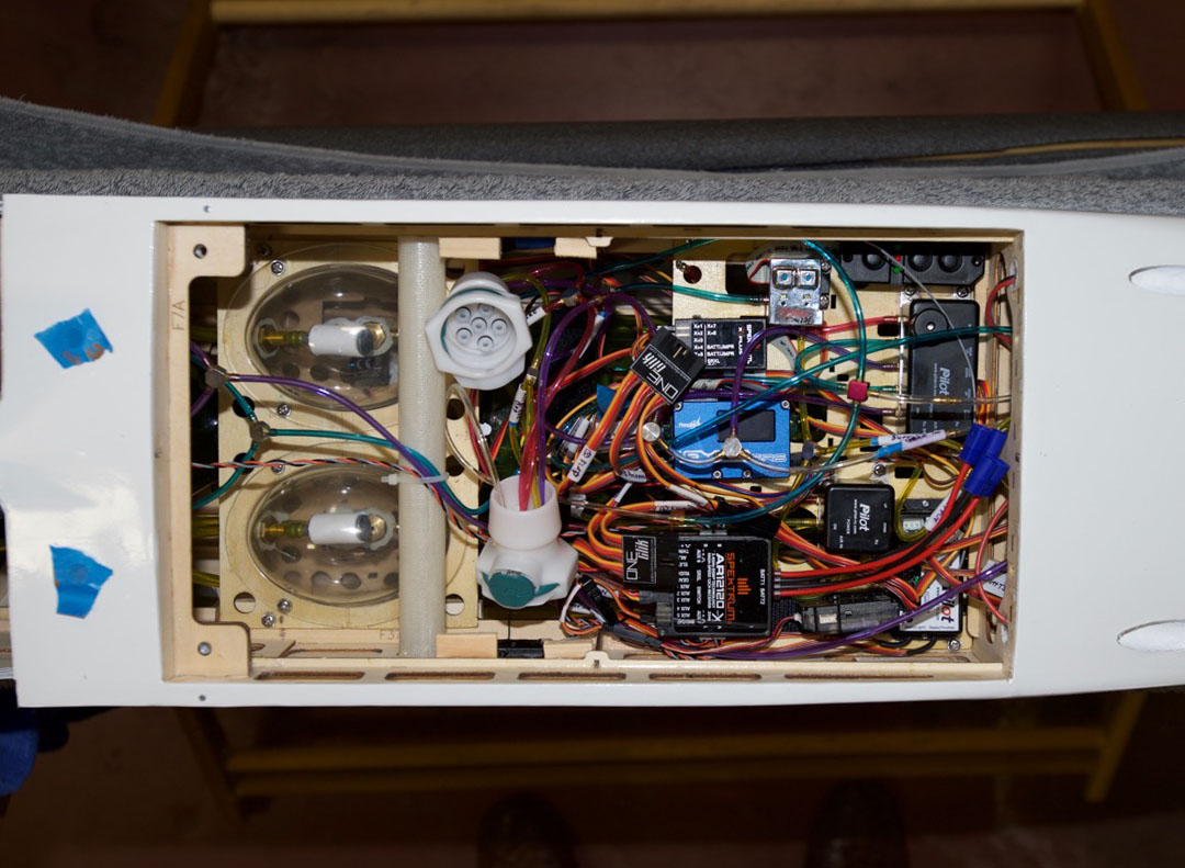

aehaas 05-15-2016 09:56 AM
1 Attachment(s)
Install your electronics. You may want to use optional items as the Jetronics proportional brake system and the iGyro SRS gyro. Also shown are ONE Clik multi servo line connectors and multi airline connectors as sold by Dreamworksrc.
http://www.rcuniverse.com/forum/atta...mentid=2162530
