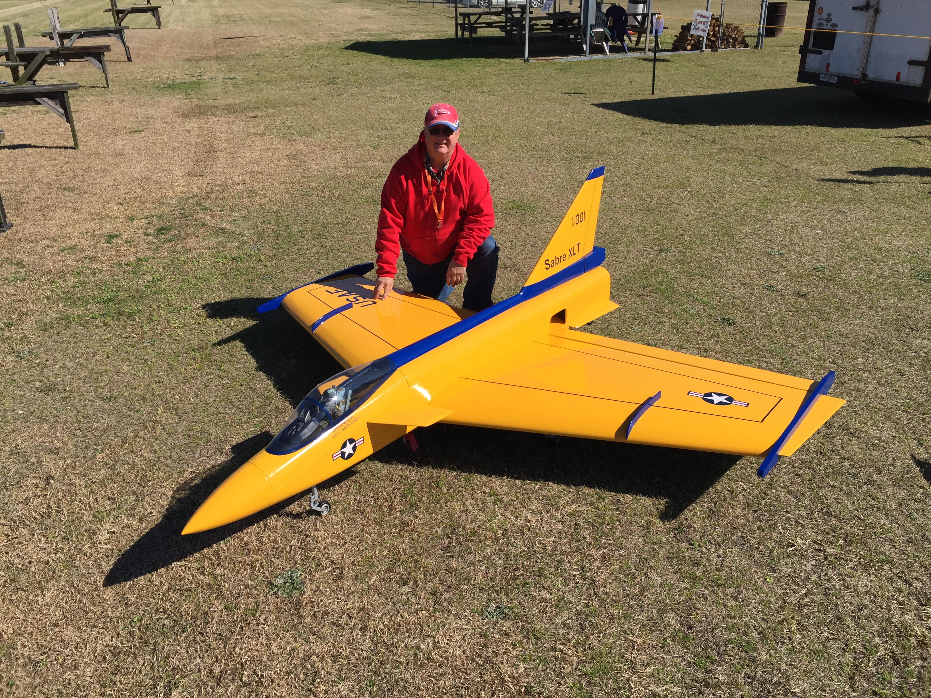

Viper1GJ 01-15-2017 05:36 PM
1 Attachment(s)
Thomas,
I just got my ER-50s and GS-200 installed and programmed this week in my scratch built sport jet called Sabre XLT. See pic below. It weighs 65 lbs at T.O. Currently I have the brake pulse set at 1/3, steering mix at 20%, and gyro mix at 50%. These are mostly 1st guess settings based on nothing.
So far everything works ok except for 2 issues.
First the Power Up program will only operate in "Immediate" mode. I wanted to use "Check Switch" but no matter what I do it goes to the selected position when turned on even with "Check Switch" showing.
Second my right brake is much more powerful than the left brake. I had both brake limits set to 100%. I have the the new design brakes with the all metal discs with no brake pads. No matter what I programmed for brake steering or brake gyro assist it would pull hard right when brakeing. I had to drop the right brake limit to 65% to get controlled braking. Stopping power is less than 100% but it should be ok to test fly.
Xoel and Maria at Electron have been 100% helpful and fast when I had questions about ordering and exchanging struts for a different size.
http://www.rcuniverse.com/forum/atta...mentid=2196876
Hope this helps.
Gary
