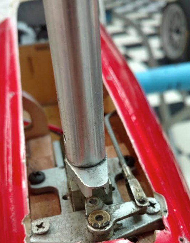

Looking for a replacement of this nose gear w/ a broken steering mechanism....We don't believe it's a BVM product...All help would be greatly appreciated!
Attachment 2240923
RCISFUN 10-11-2017 04:04 PM
Could be MAP, they used to make a steerable mechanism that look like that.
https://modelaviationproducts.com/pr...anding-gear/10
DelGatoGrande 10-11-2017 11:33 PM
easy fix IMHO if drill thru and screw just the ball from a ball link.
my2c
flyinwalenda 10-12-2017 02:37 AM
I agree. Find a ball stud that fits or mill the opening a bit wider to fit a larger ball.
