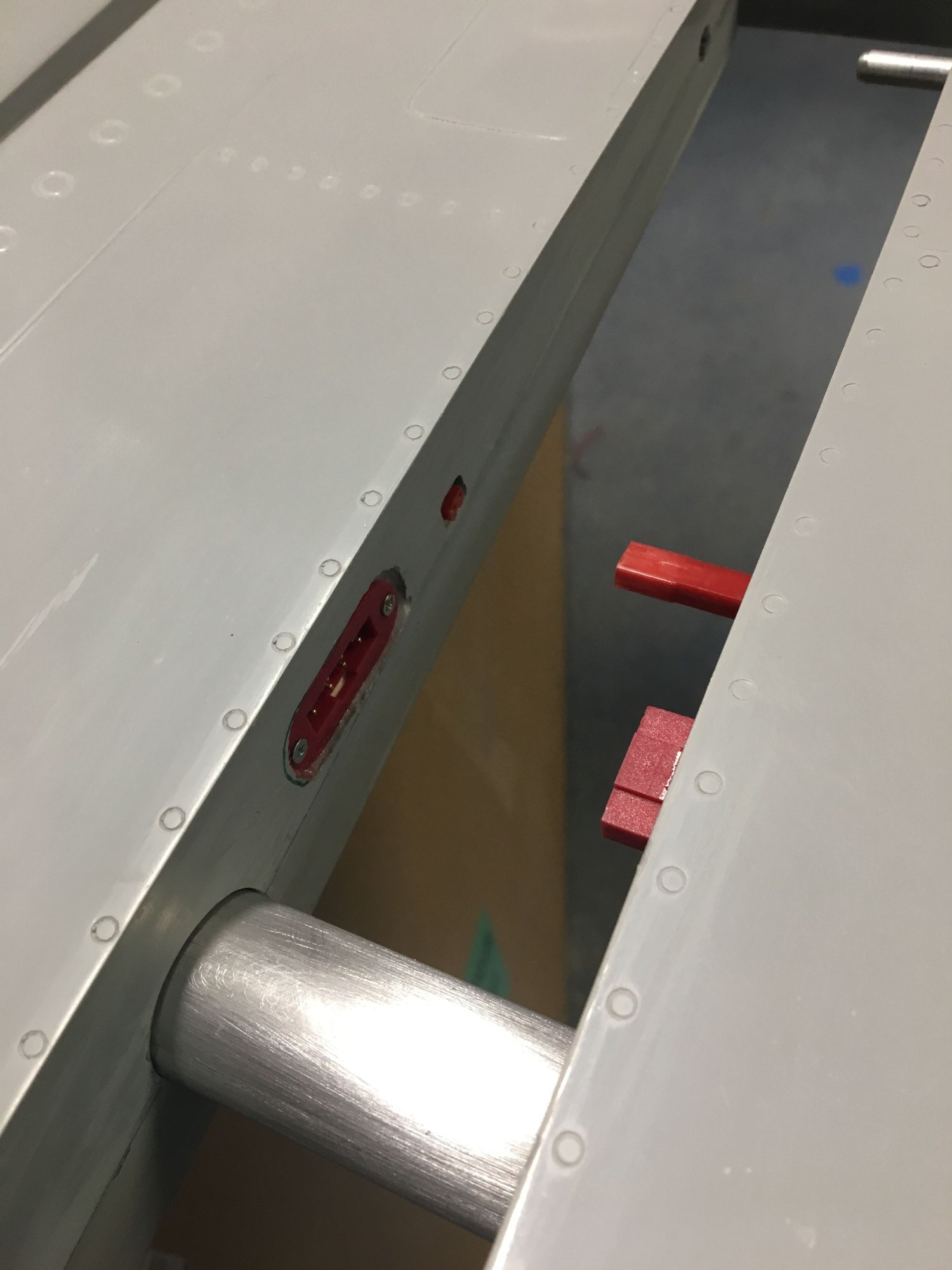

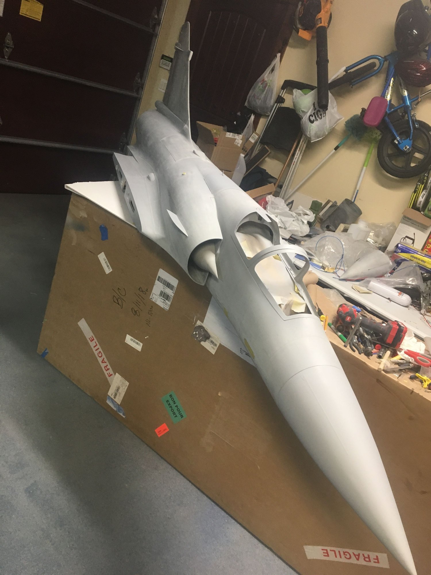

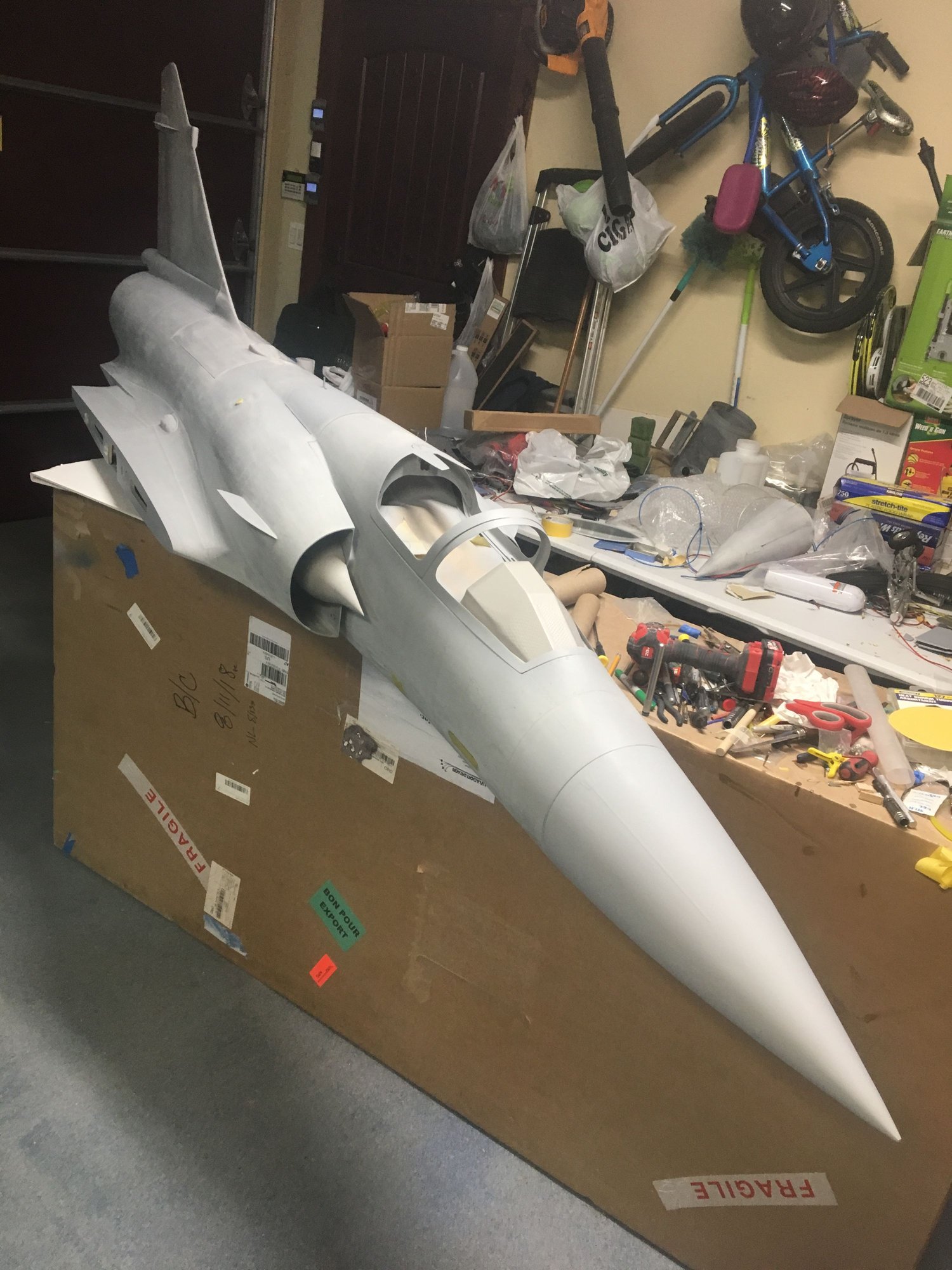

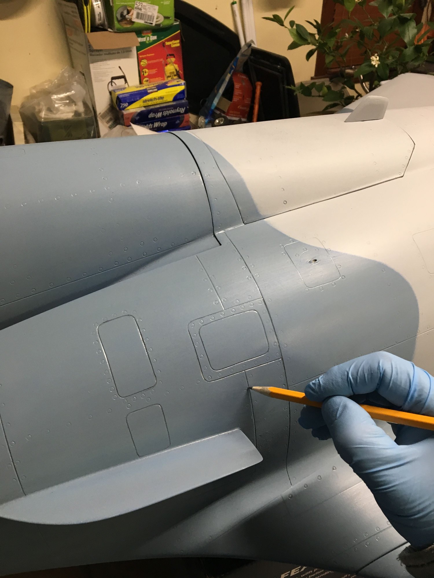

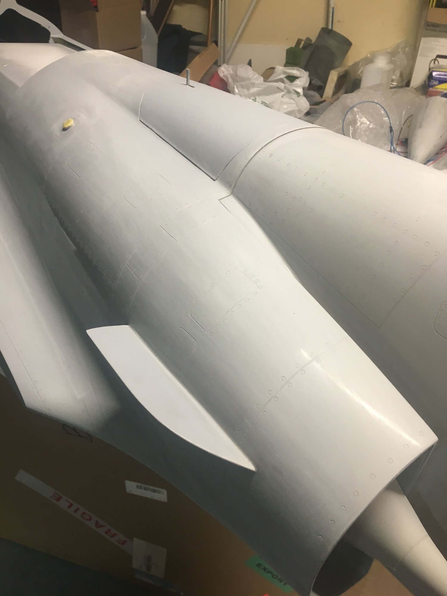

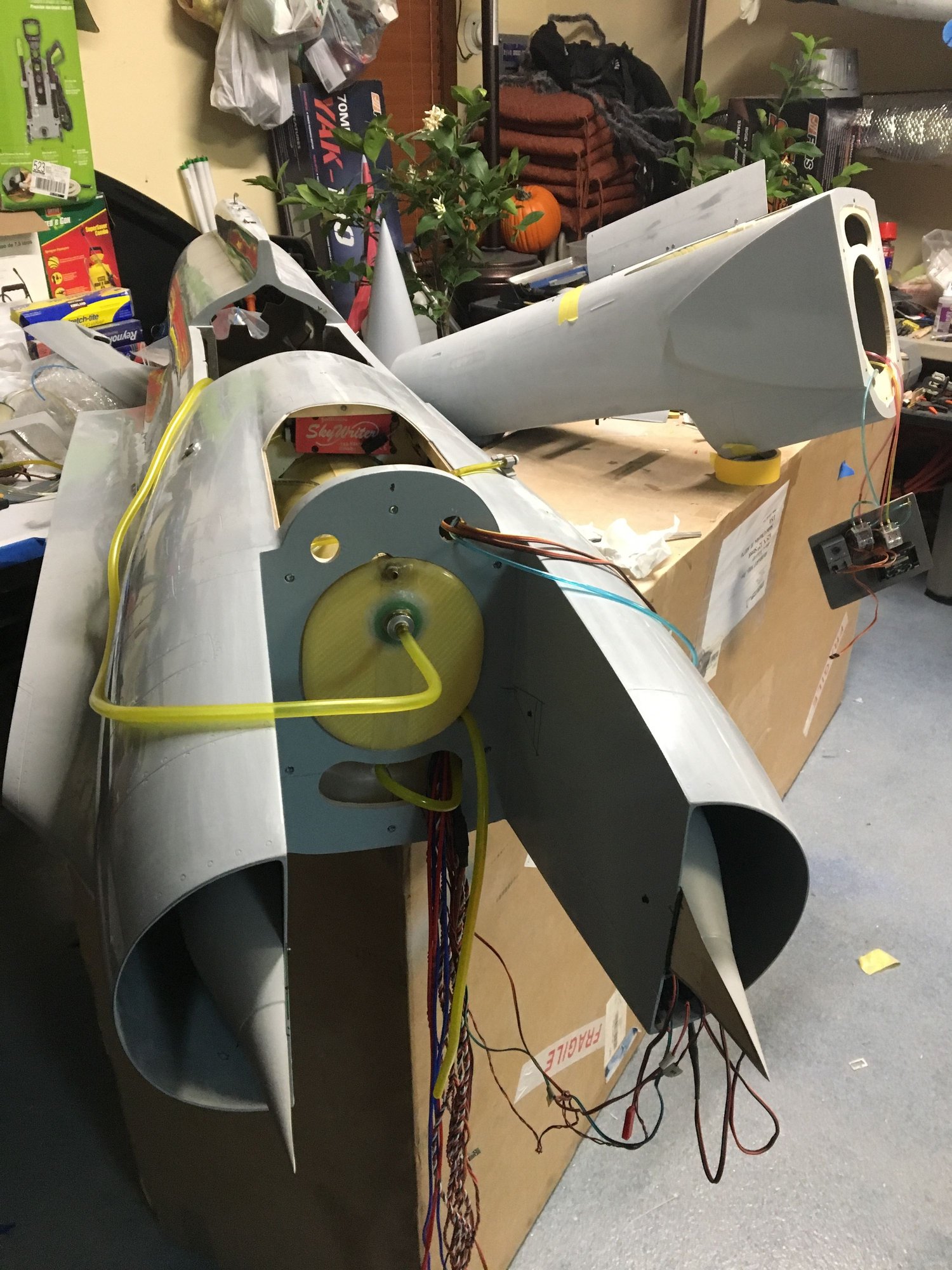

Most of the details is complete and both halfs are joined so right after here we’re going into the painting process which I’m about to do most likely or start next week.https://cimg8.ibsrv.net/gimg/www.rcu...b6af8036c.jpeg

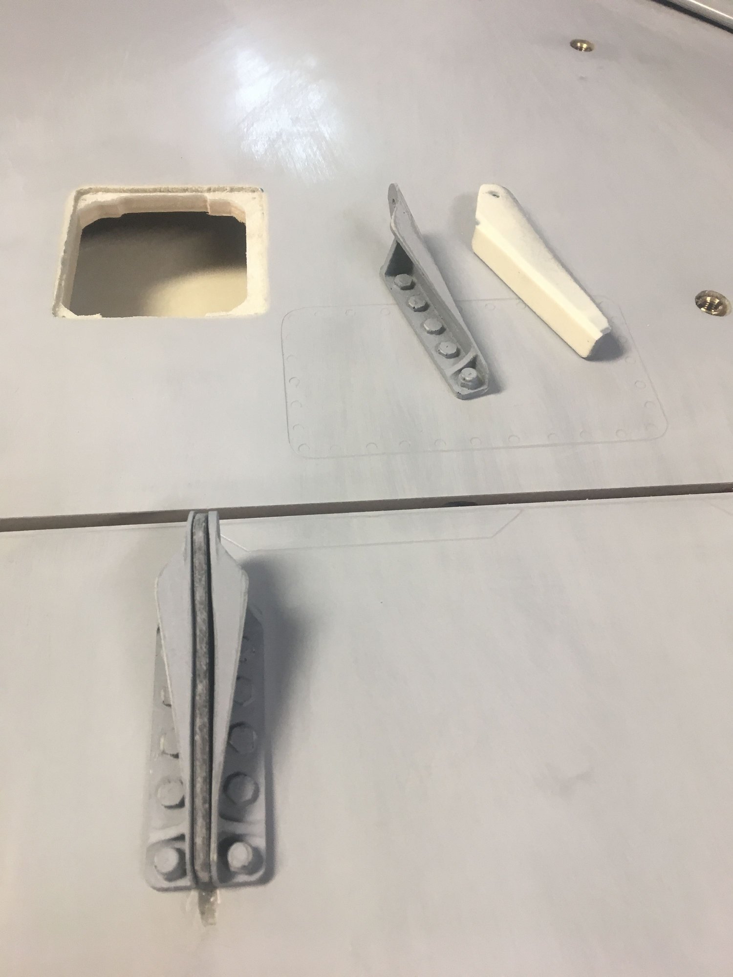

Can you go a bit into detail how you found the location of the hard points for the drop tanks and missile locations?
I have my HAWE landing gear back now. WIll post pictures later.
thanks!!
spaceman 01 01-15-2019 05:04 PM
Hello Tuggs,they had some dimples into the wing one was a little bit off but I figured it out by measurement and by trial and error with Dreiling with a very small dreiling bit .

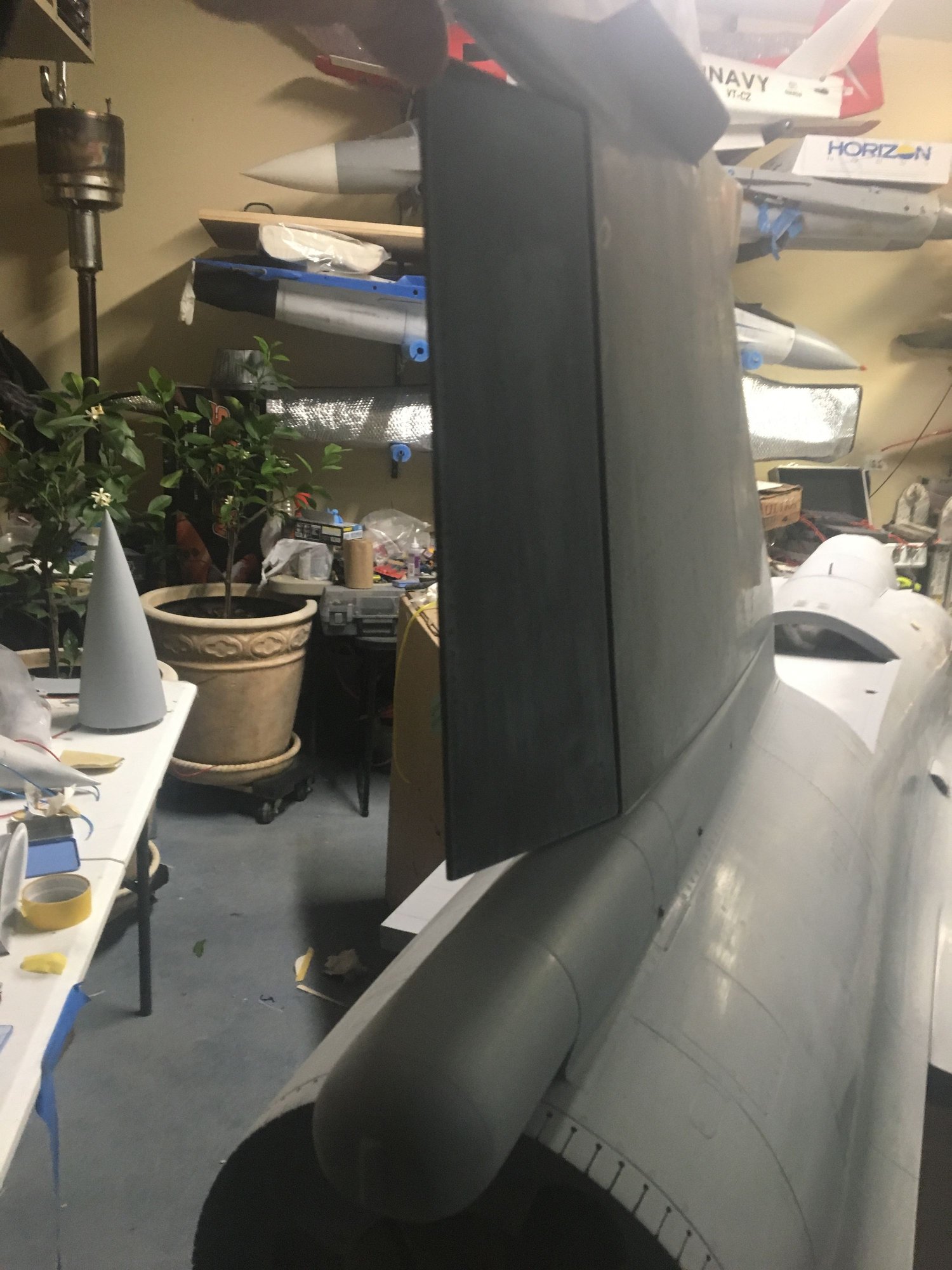

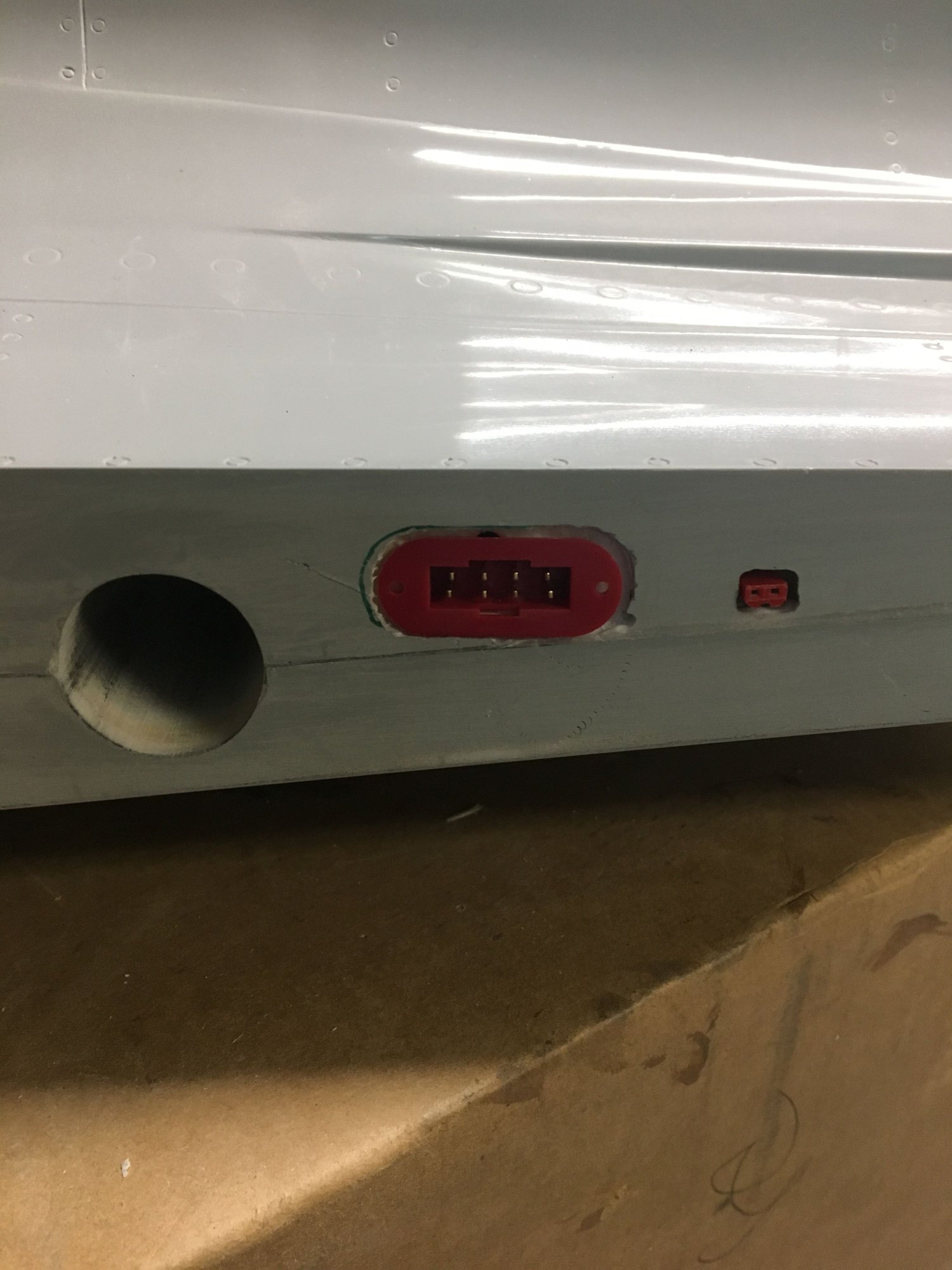

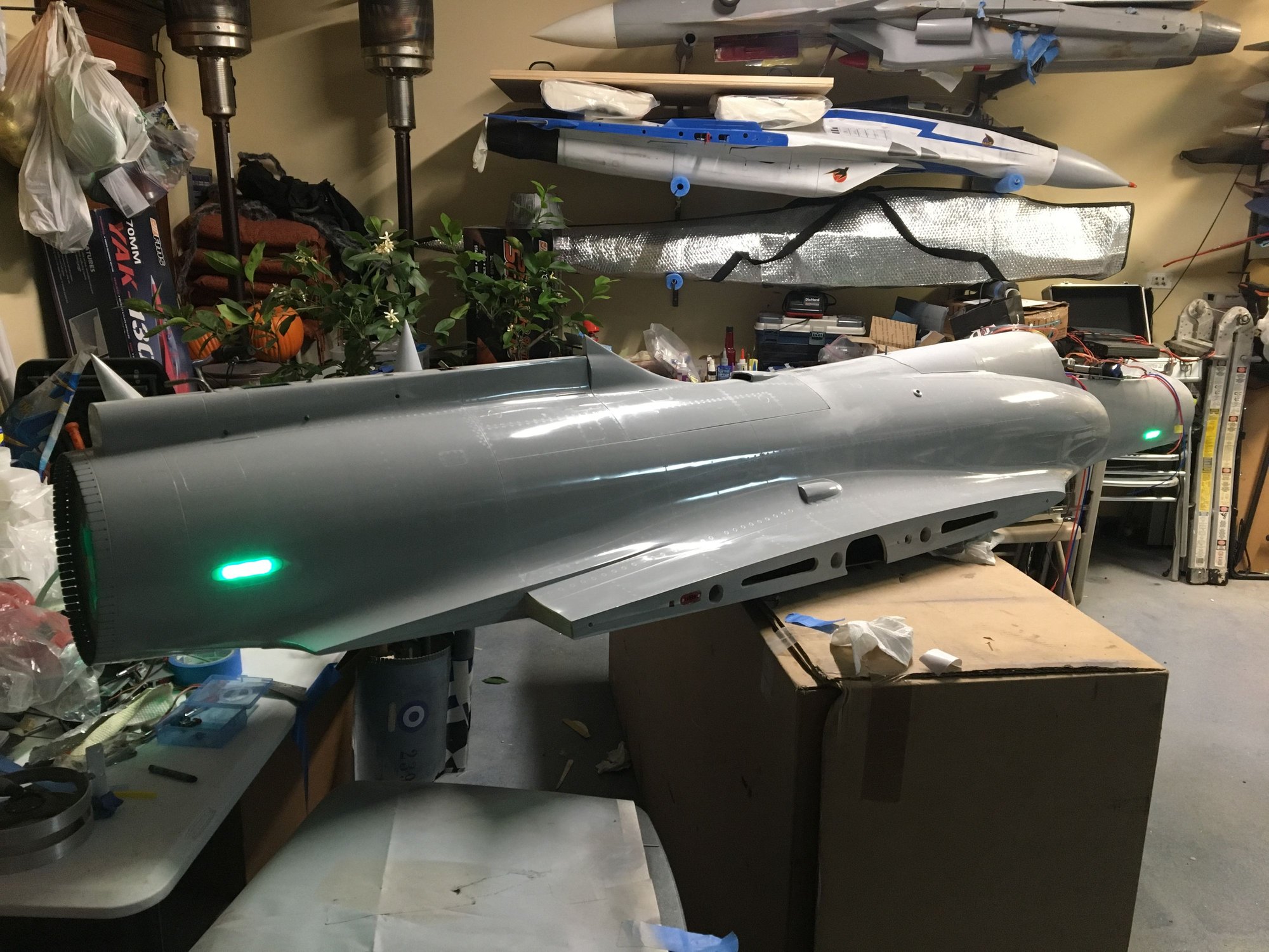

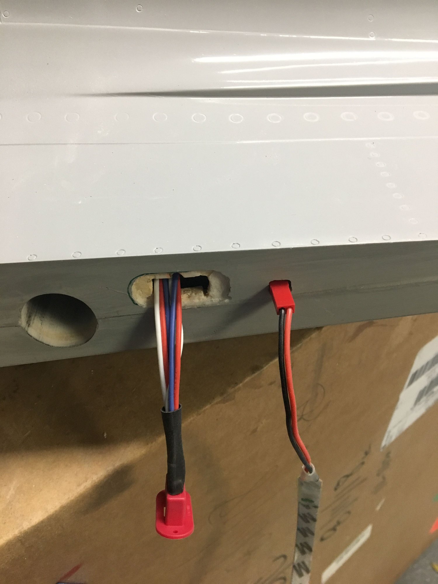

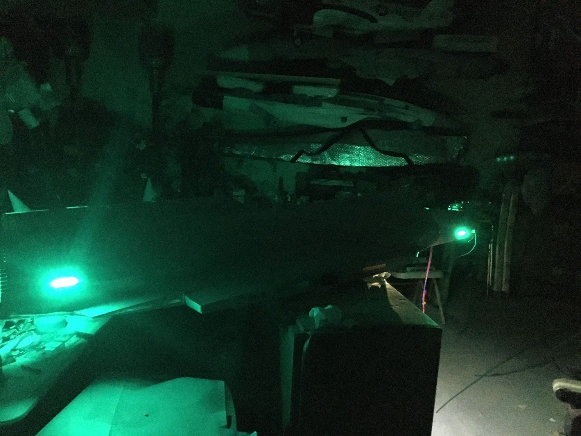

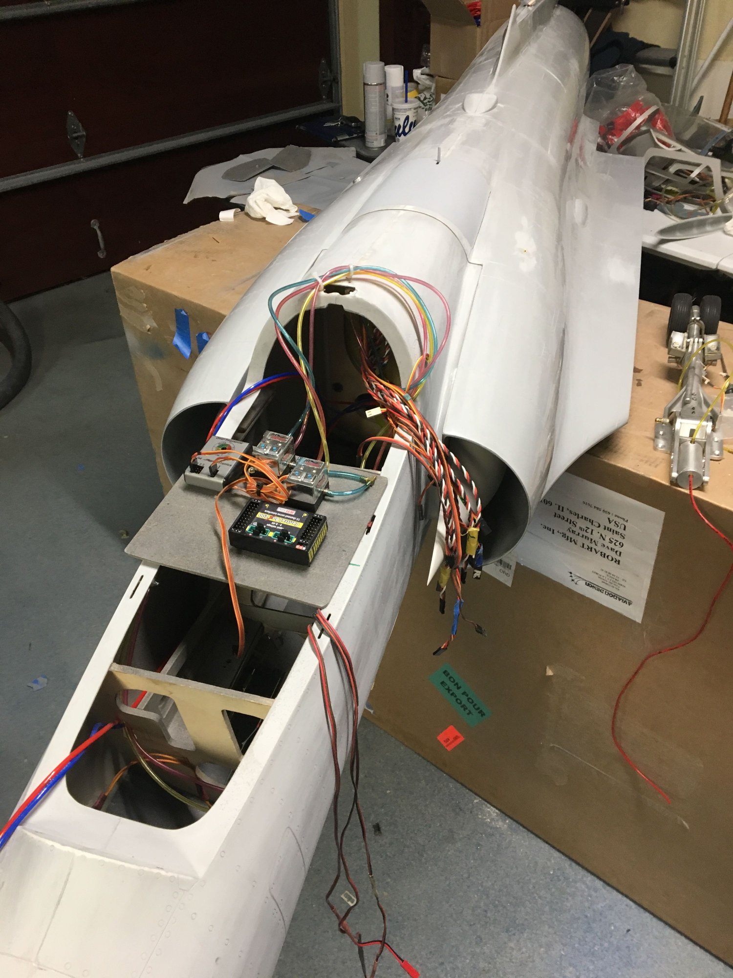

I finished with the lights and all the details before painting I will not install yet that details because I’m waiting to find the drawing which I will do it at the bottom of the airplane and also on the vertical fe I finished with the lights and all the details before painting I will not install yet that details because I’m waiting to find the drawing which I will do at the bottom of the airplane and also on the vertical fin https://cimg0.ibsrv.net/gimg/www.rcu...a4603cfa2.jpeg
spaceman 01 01-15-2019 05:14 PM
spaceman 01 01-15-2019 05:19 PM

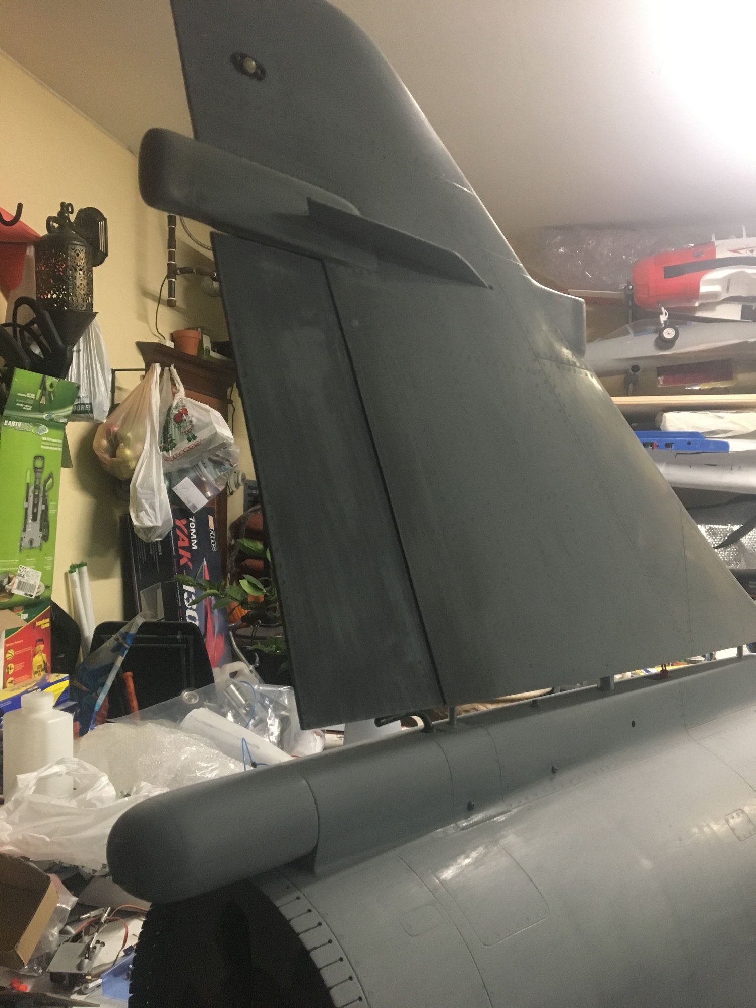

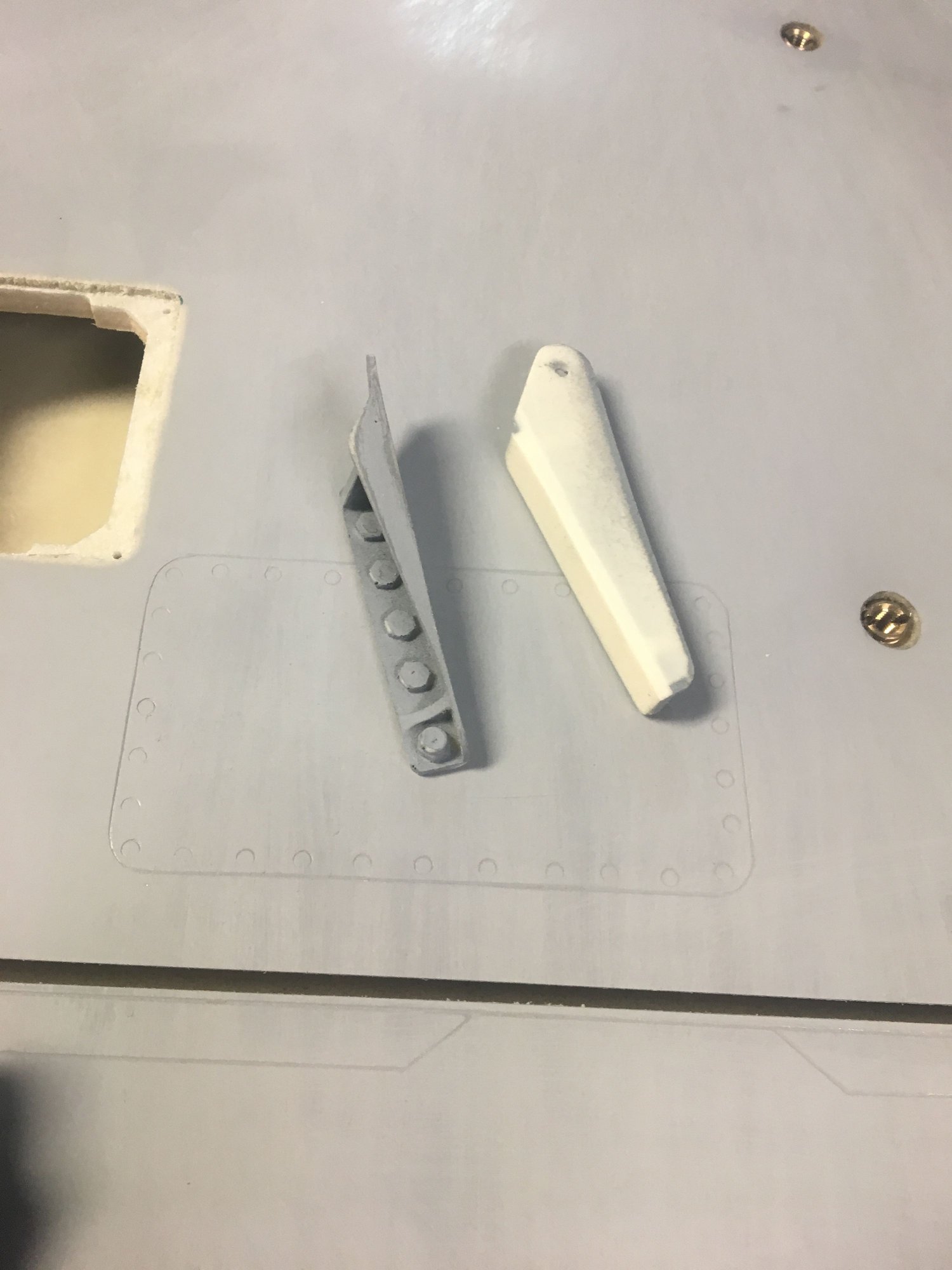

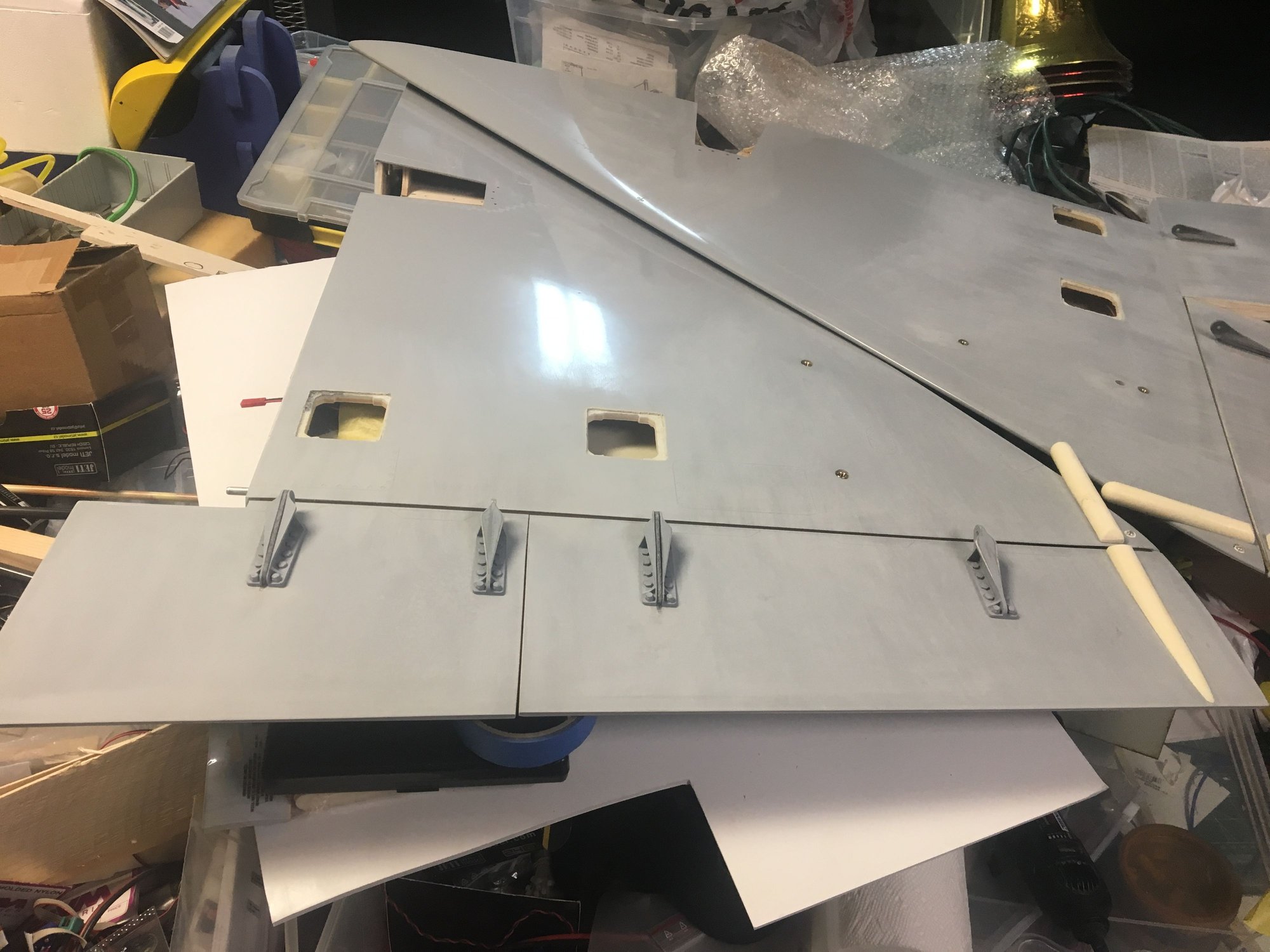

I also finished the vertical fin which I get about 25° deflection either way I think it should be OK,https://cimg1.ibsrv.net/gimg/www.rcu...95943662d.jpeg
https://cimg2.ibsrv.net/gimg/www.rcu...222fda09d.jpeg
https://cimg3.ibsrv.net/gimg/www.rcu...dd0400a41.jpeg
https://cimg4.ibsrv.net/gimg/www.rcu...71d544b6f.jpeg
check out the pictures how it will be attached

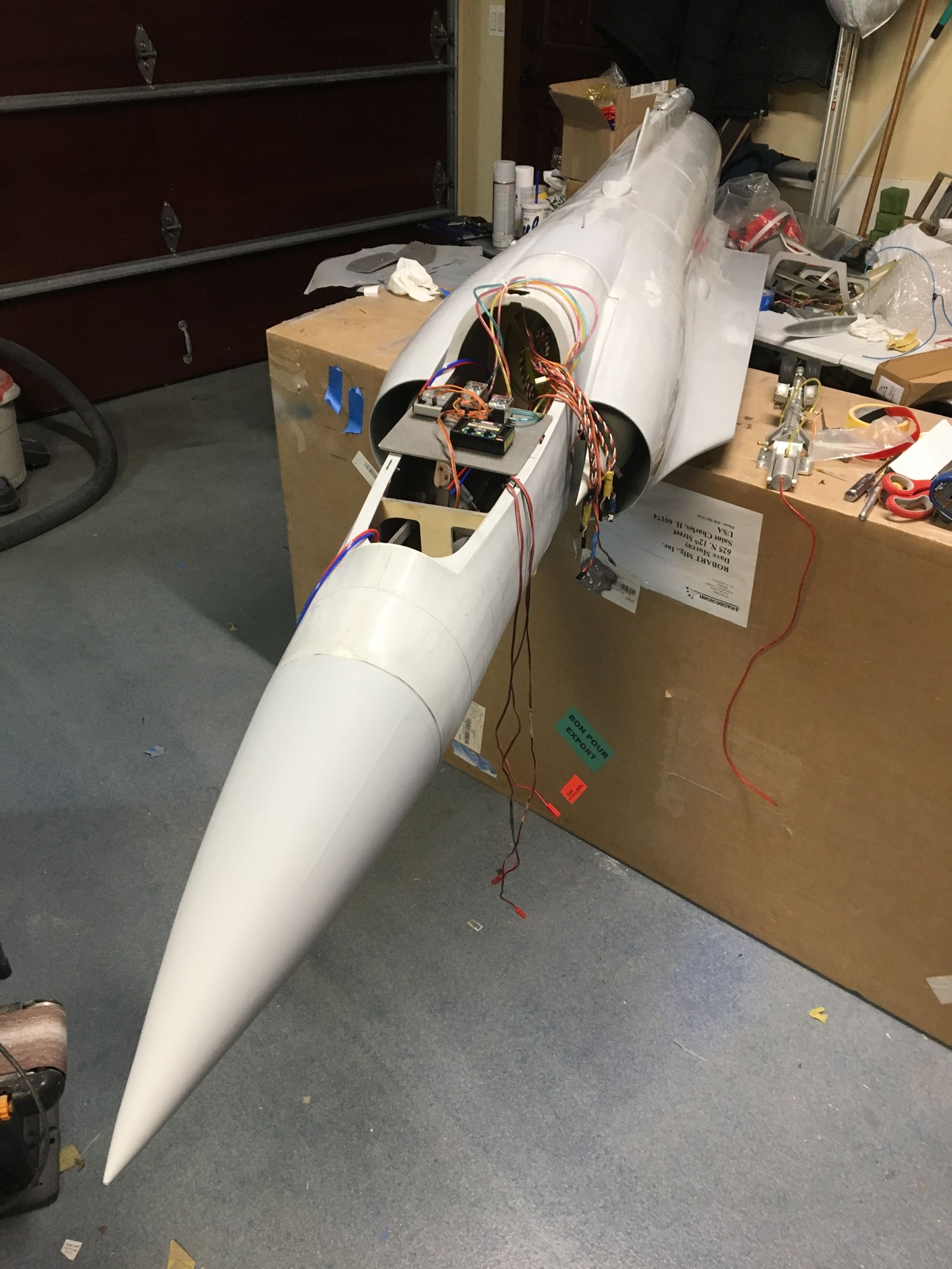

Following pictures are before painting the whole fuselage is scuff down and sanded for painting

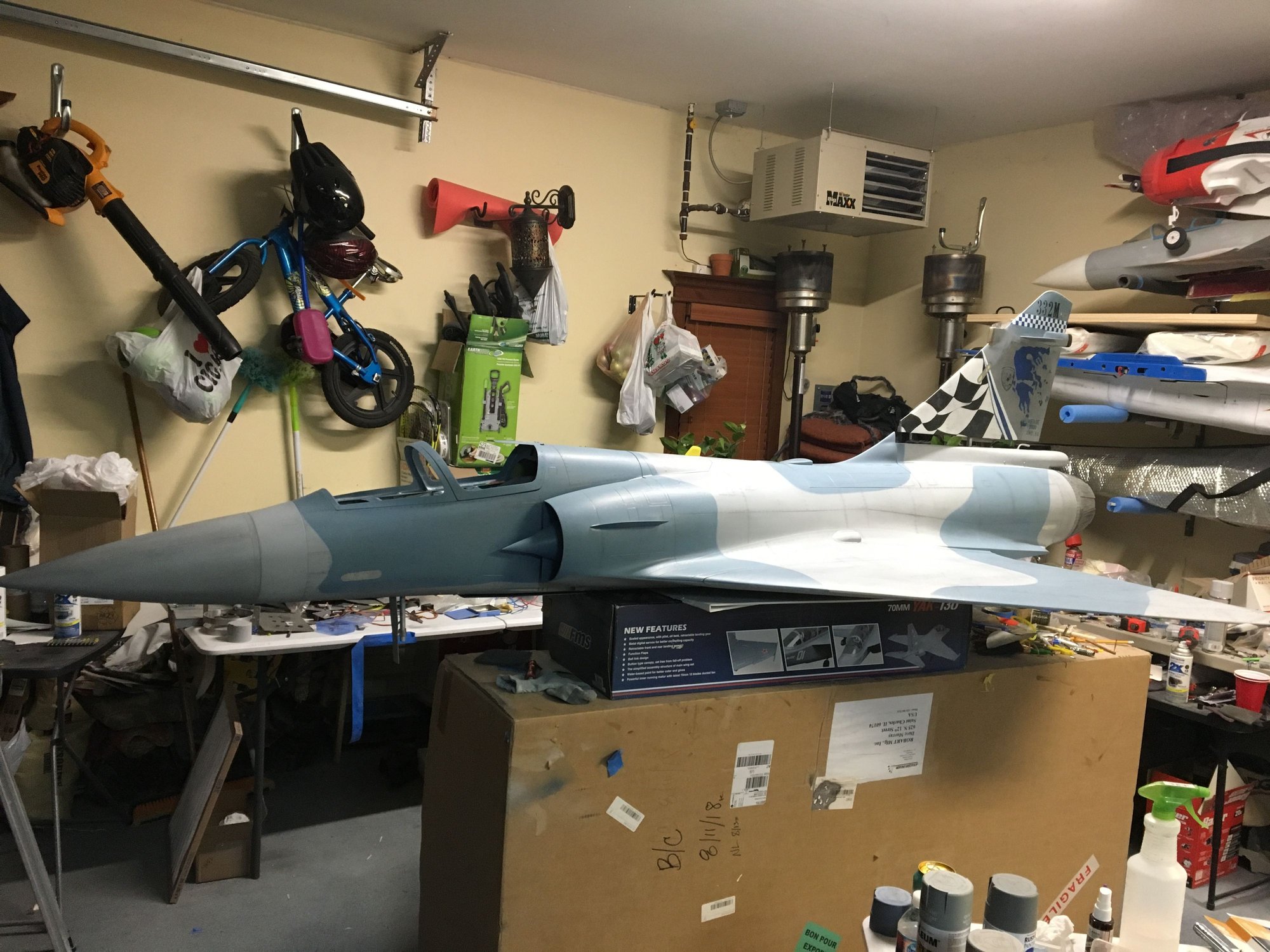

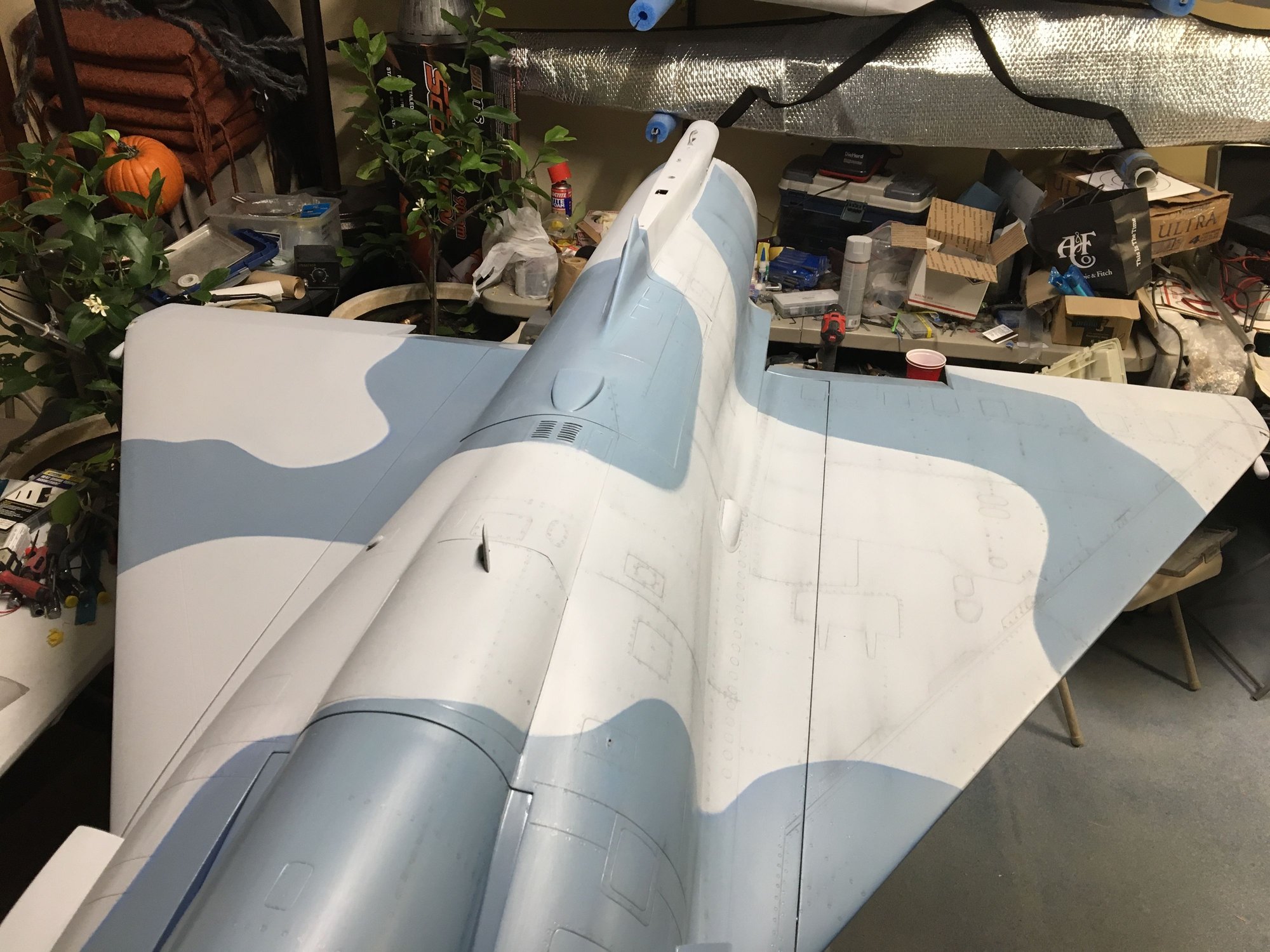

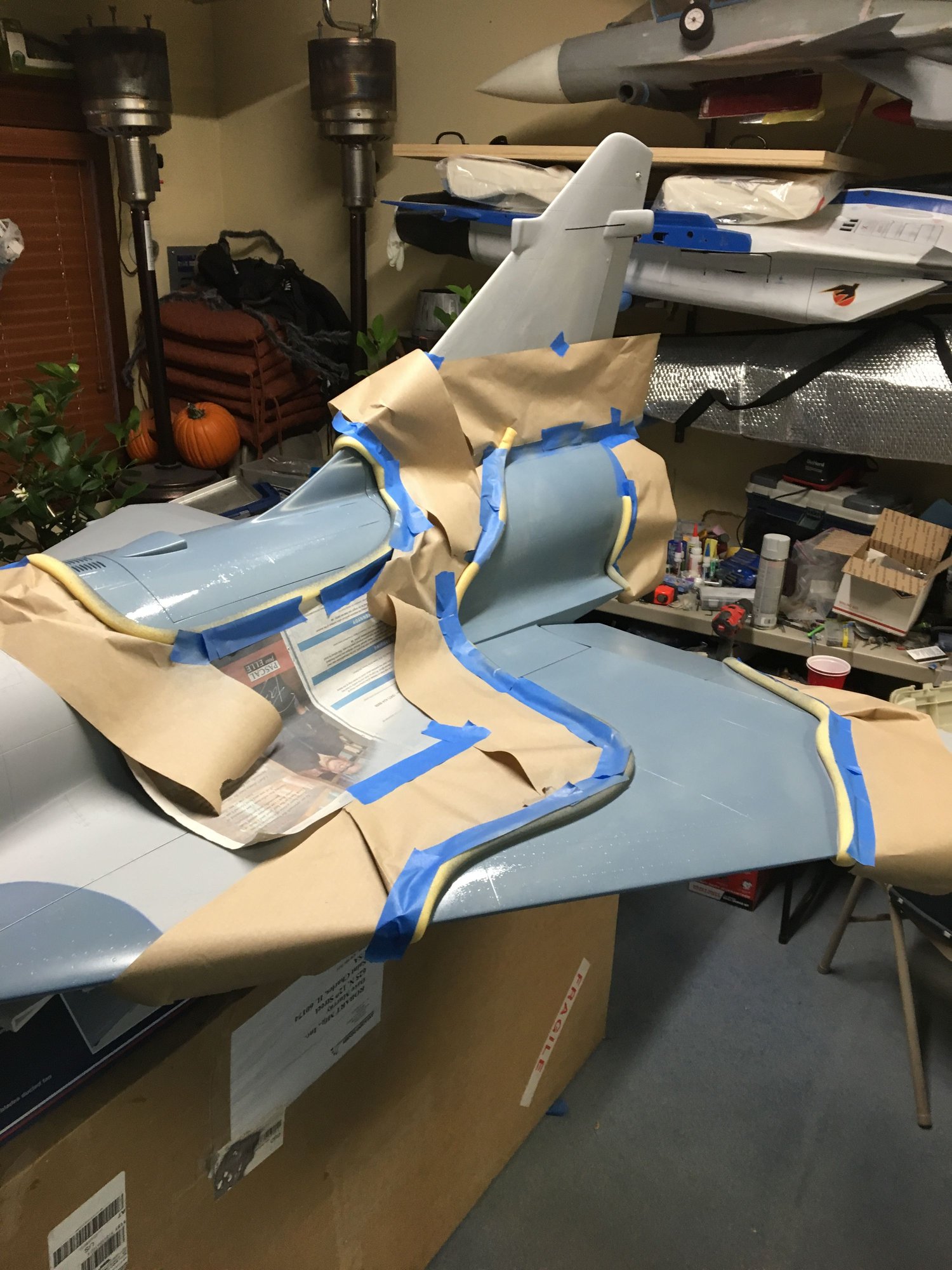

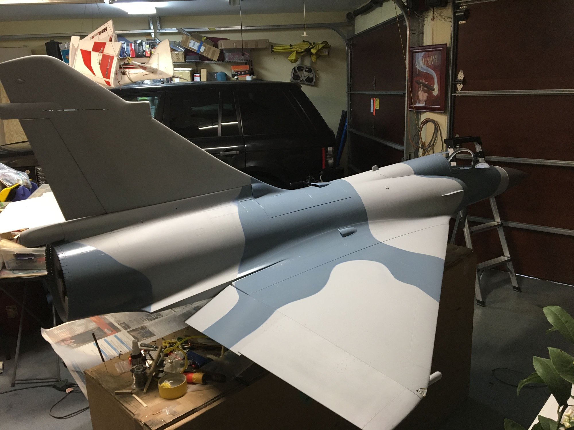

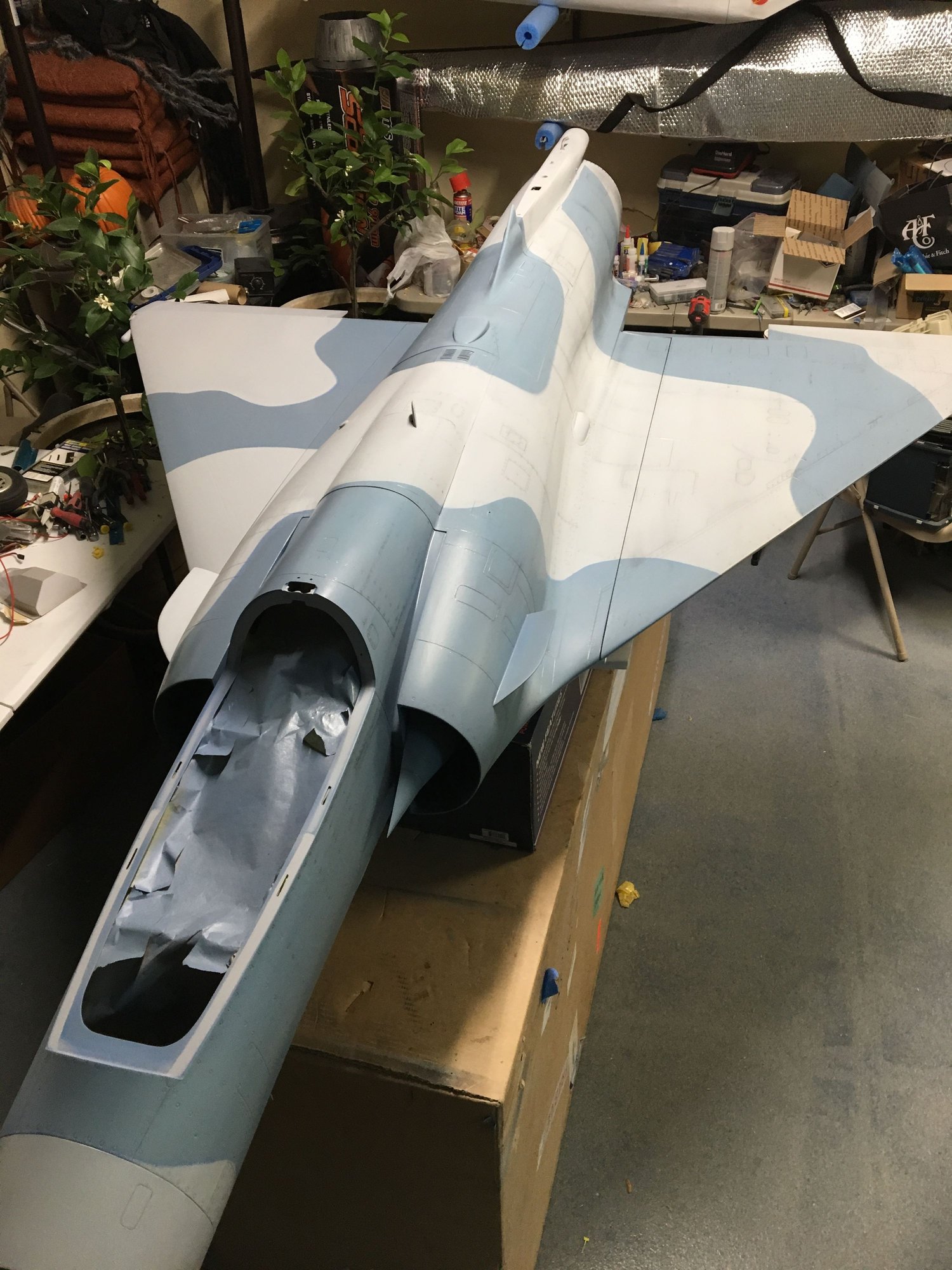

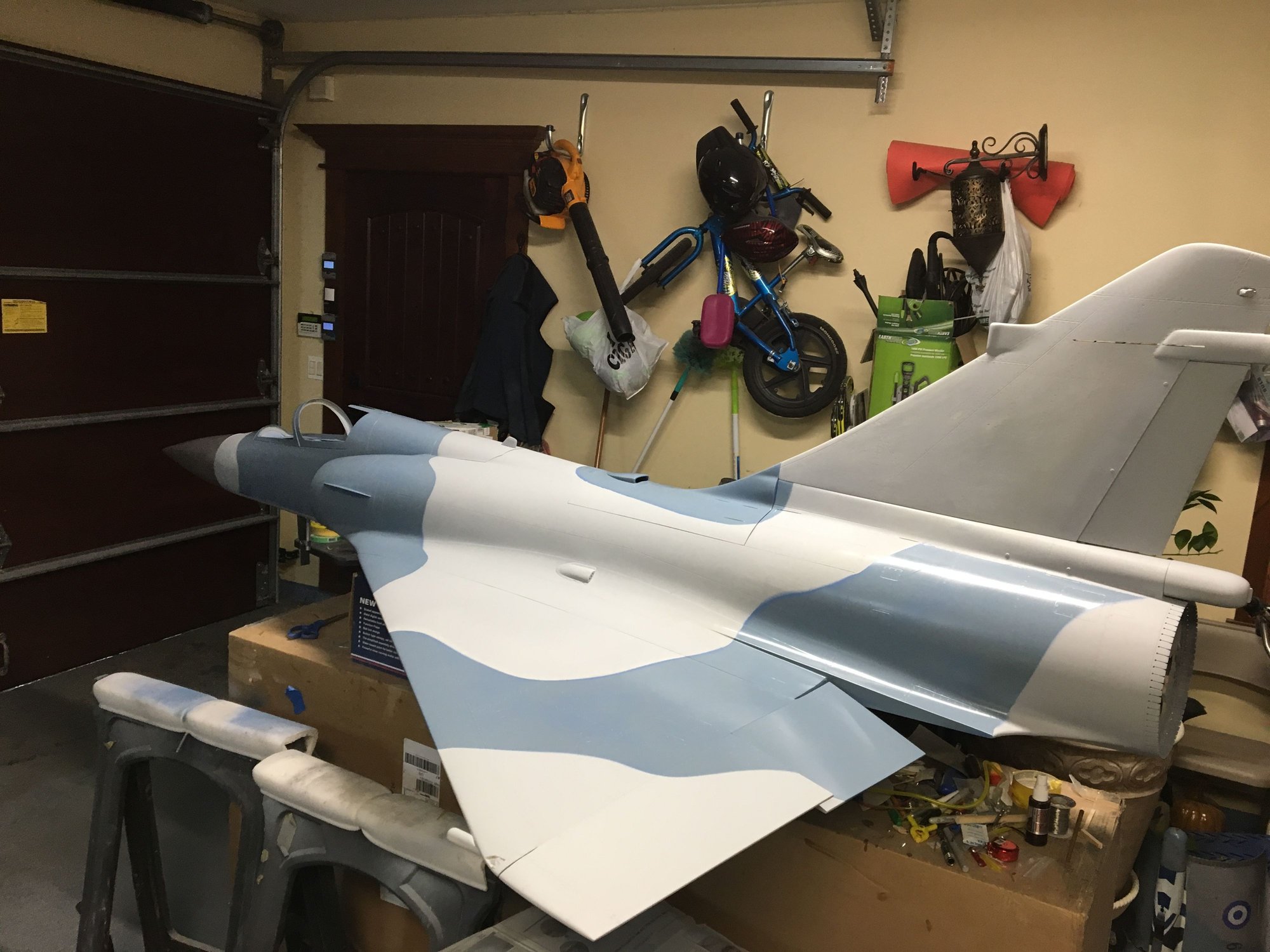

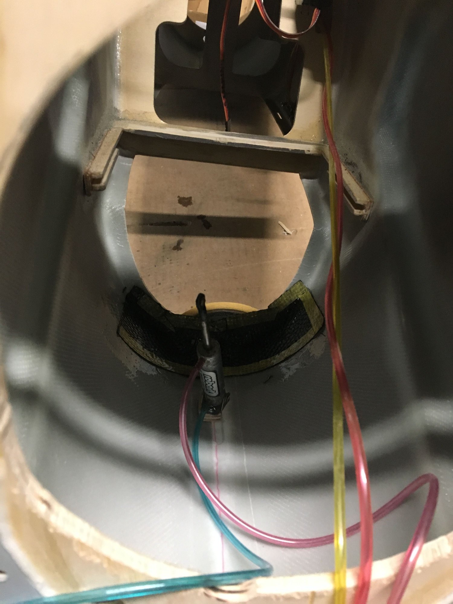

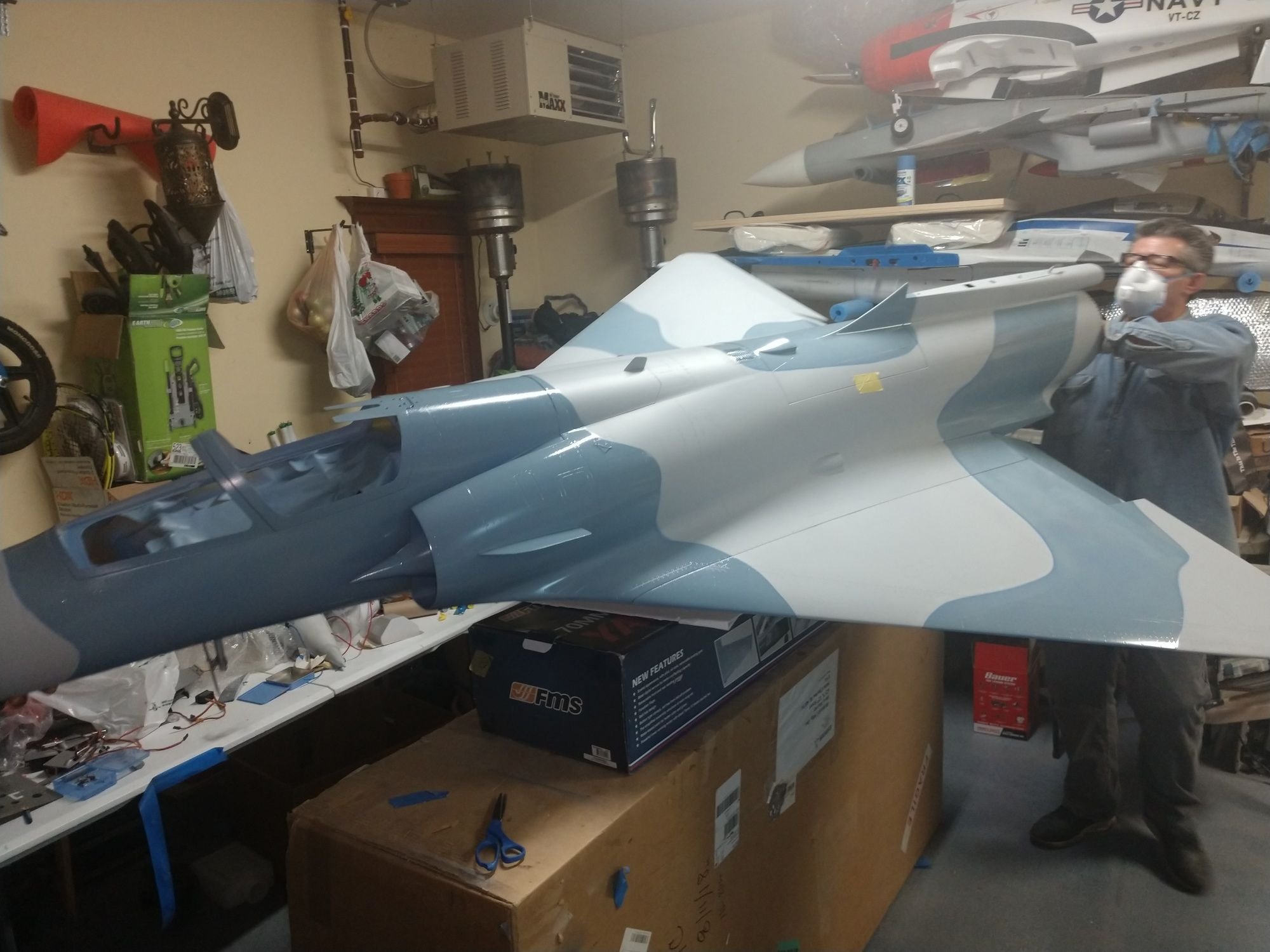

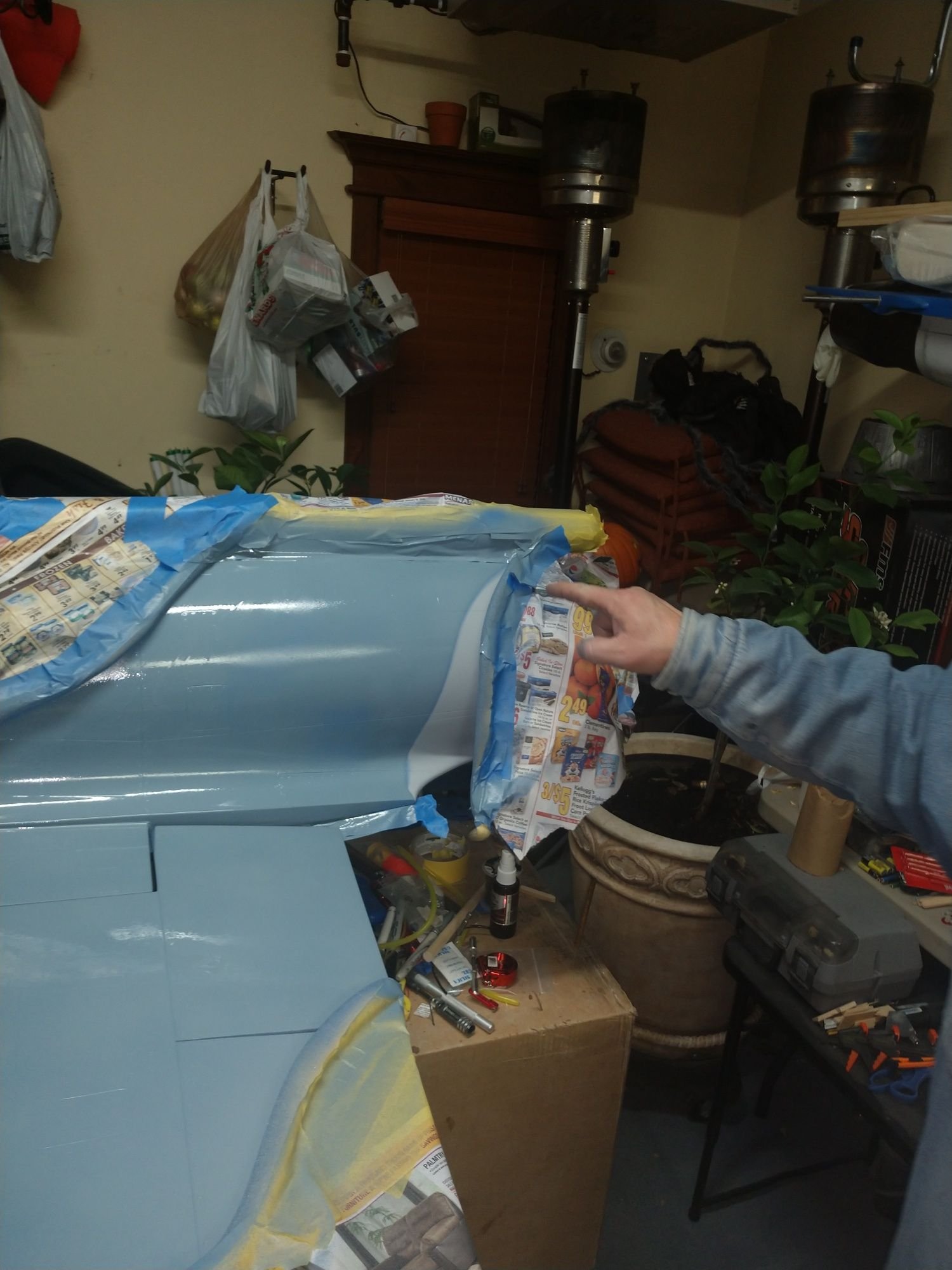

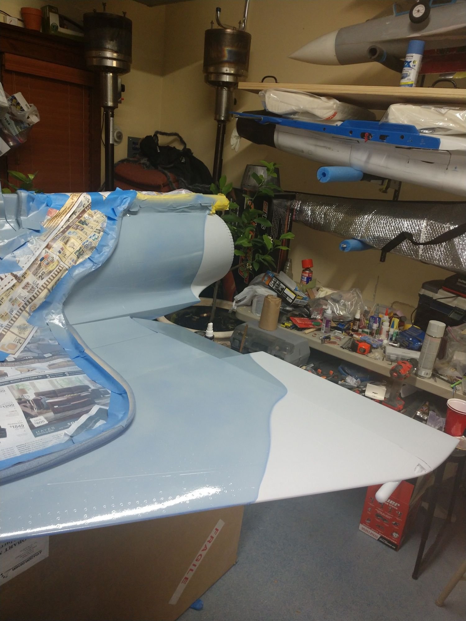

I just completed the first stage of the painting to do the camo I used the 3M foam rope. I bought the box about six or seven years ago and it still works.https://cimg0.ibsrv.net/gimg/www.rcu...d0a5c1e03.jpeg
https://cimg1.ibsrv.net/gimg/www.rcu...5e6cac172.jpeg
https://cimg2.ibsrv.net/gimg/www.rcu...337961f89.jpeg
https://cimg3.ibsrv.net/gimg/www.rcu...84225cb1a.jpeg

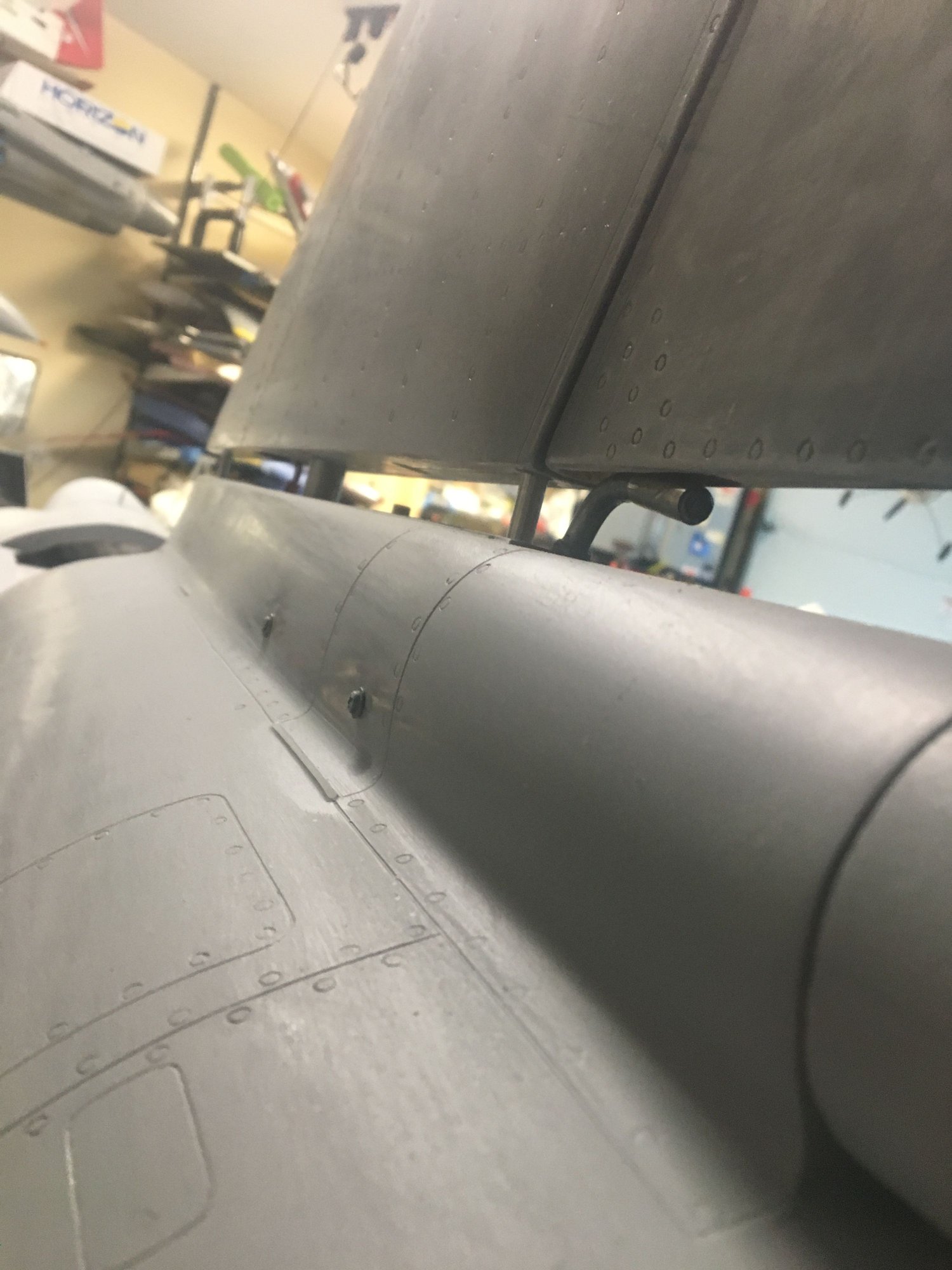

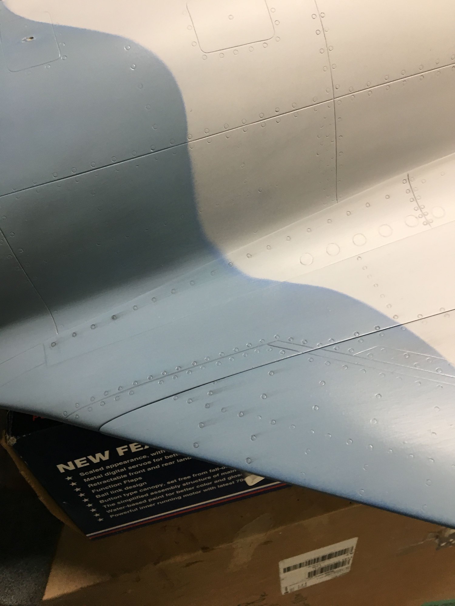

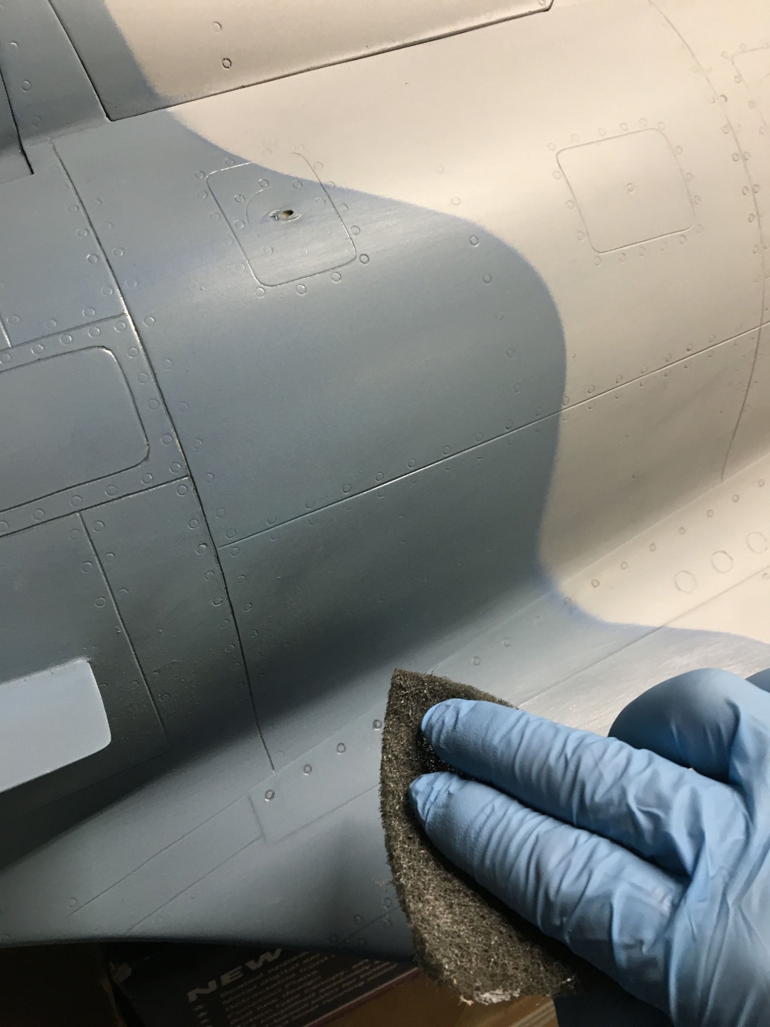

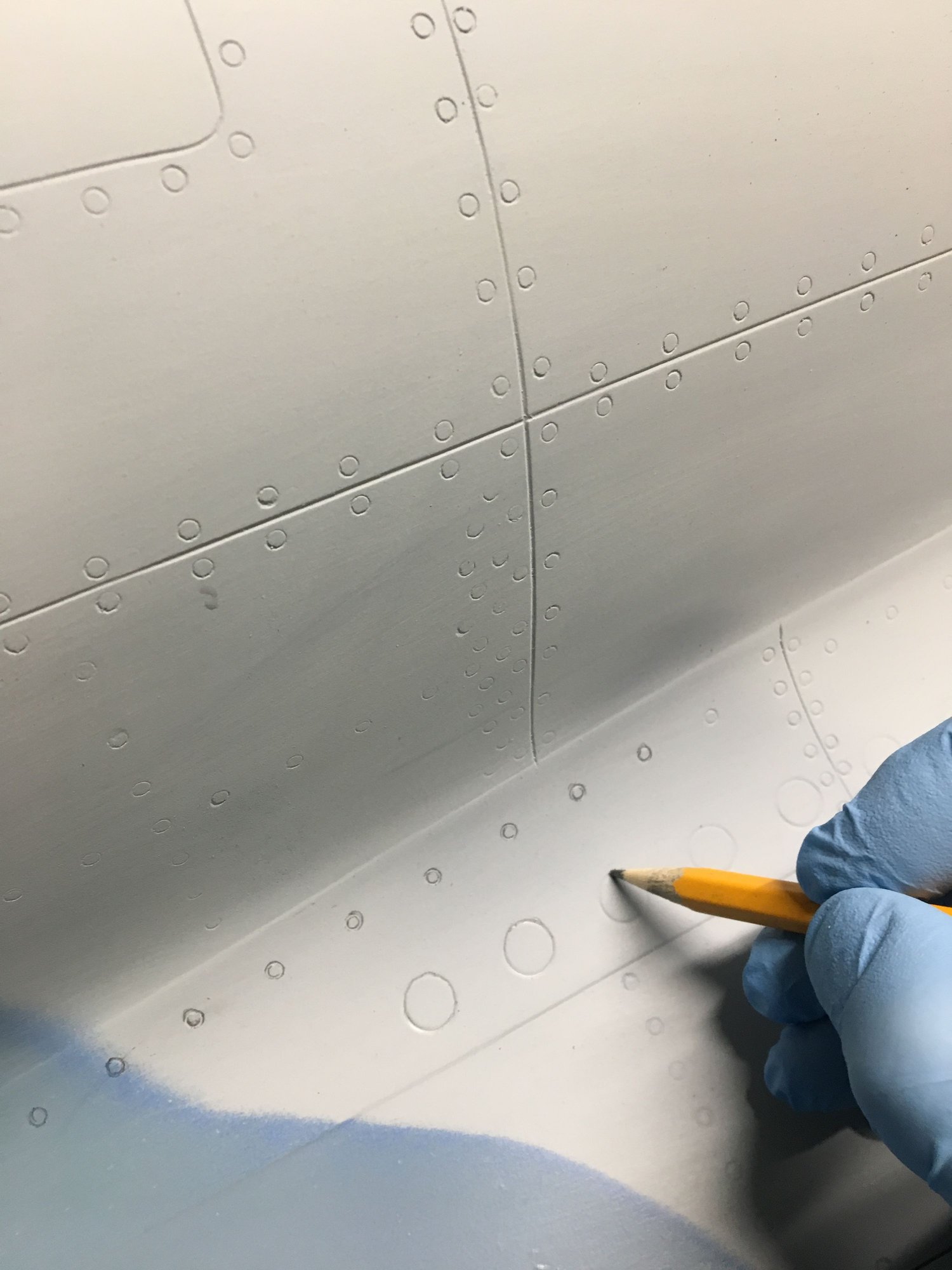

Now we are moving to the second stage which took me about two hours to complete one side of the top half of the airplane it’s the weathering. I just used a pencil and a gray or burgundy type abrasive pad, tried to enlarge the picture to see the difference from one side to another. https://cimg7.ibsrv.net/gimg/www.rcu...a90939150.jpeghttps://cimg6.ibsrv.net/gimg/www.rcu...d86dca7cd.jpeg
https://cimg0.ibsrv.net/gimg/www.rcu...ea29b5a31.jpeg

Tuggs 01-22-2019 02:54 AM
hey, just a quick note on the weathering / detailing. Have you considered to use oil paints to highlight the detailing? the pencil detailing looks really nice but i guess you have to apply a clear coat afterwards to make it permanent?
spaceman 01 01-22-2019 04:36 AM
Yes Tuggs, I know but I still have to apply the decals and then I will do the clearcoat.
when you use the oil you must have a gloss finish and come out nice but since I'm using a matte finish it's very hard for me to work with it .
thank you Nick
Tuggs 01-22-2019 05:48 AM
Hey Nick,
From my experience, the best way to work it:
- Base coat & all paint job markings
- Oil paint weathering with linseed oil
- waterslide decals
I tested this on several models and it worked out great. Also there is no milky shine-through on the waterslides as the linseed oil is filling all micro-holes :)
However I never tried to apply a matte flat coat afterwards. I always found the finish with oil very realistic when it is rubbed down a bit with scotch pads
Cheers
T
Your build motivates me to continue my Mirage, but I am super lazy at the moment :(

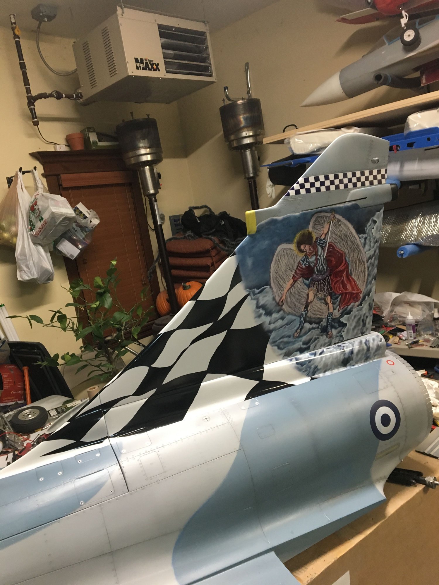

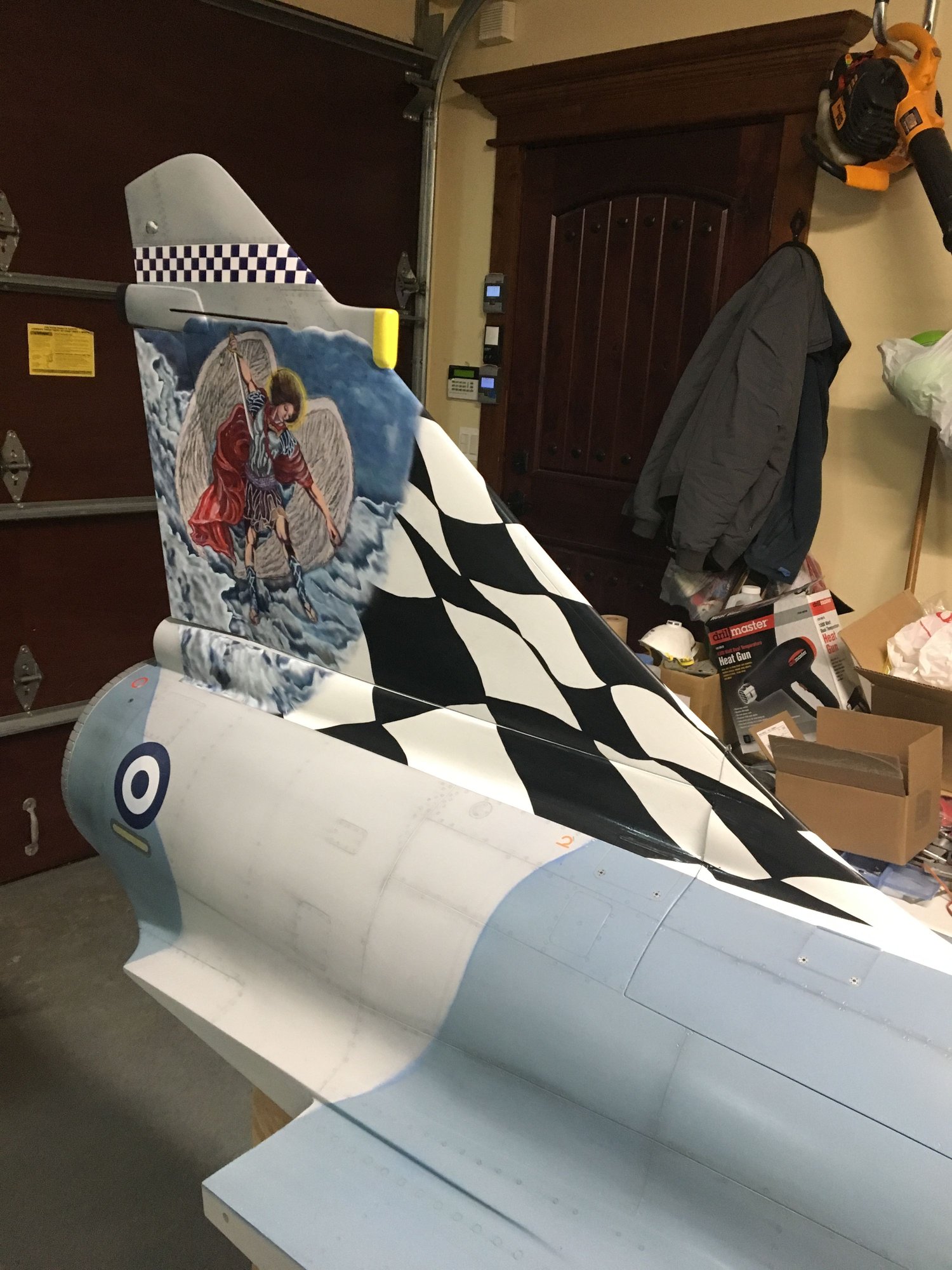

spaceman 01 02-10-2019 02:16 PM

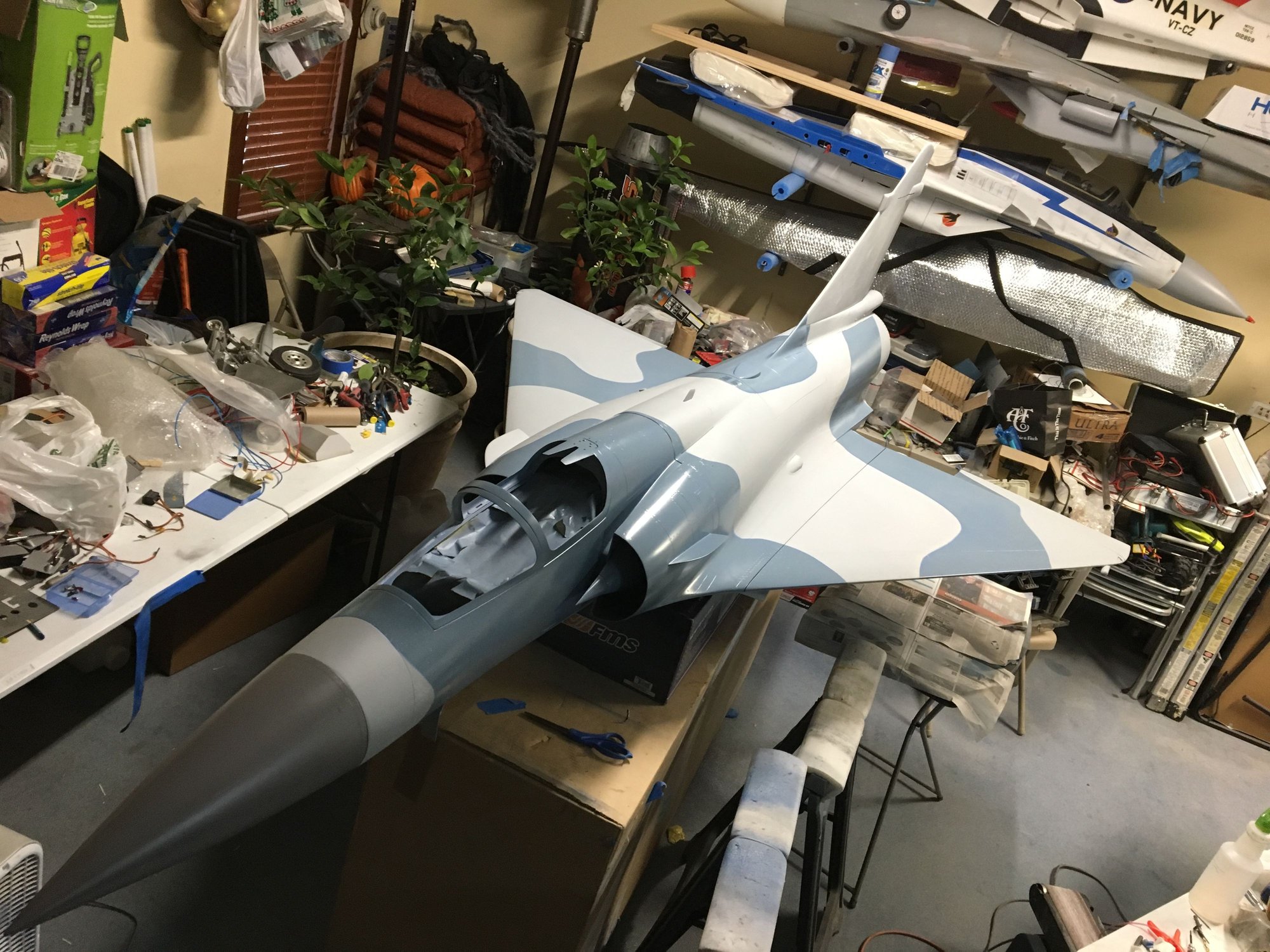

Moving along with the built I got my art work done and installed it on the vertical fin also installing the decals before final coat .https://cimg9.ibsrv.net/gimg/www.rcu...290a12f6e.jpeghttps://cimg4.ibsrv.net/gimg/www.rcu...7c89ca293.jpeg
https://cimg5.ibsrv.net/gimg/www.rcu...29cb33f5b.jpeg
