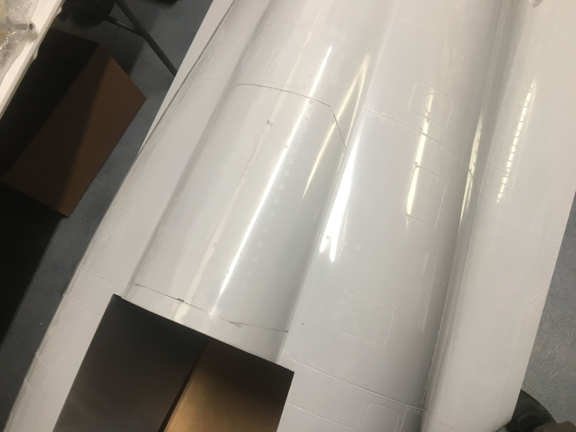

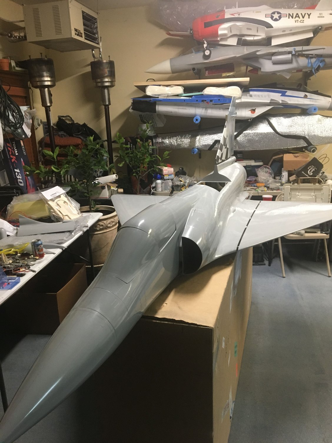

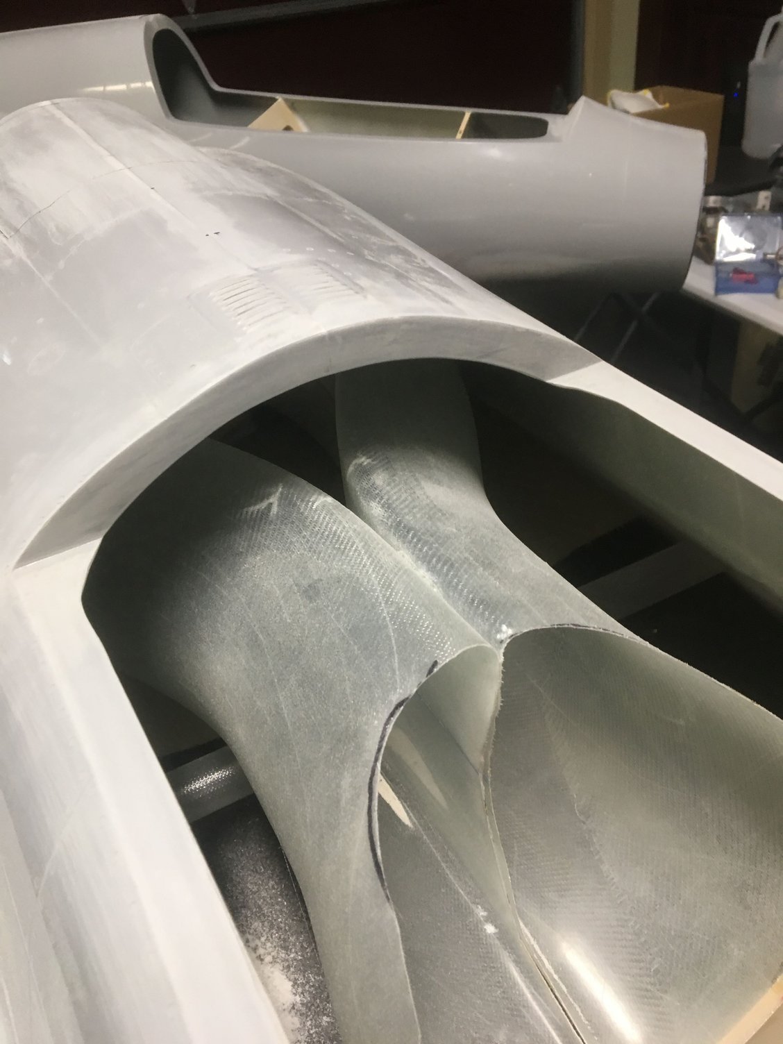

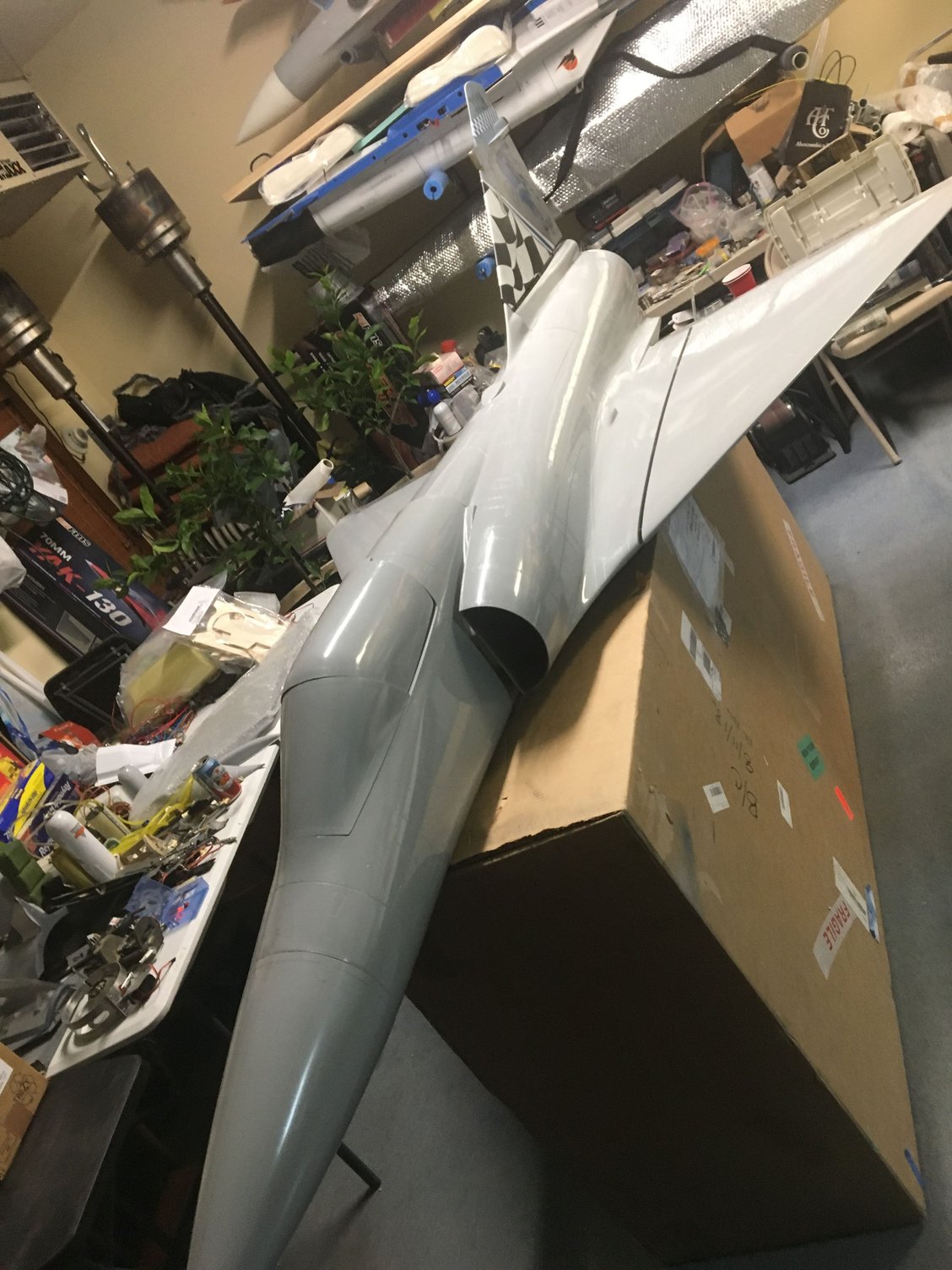

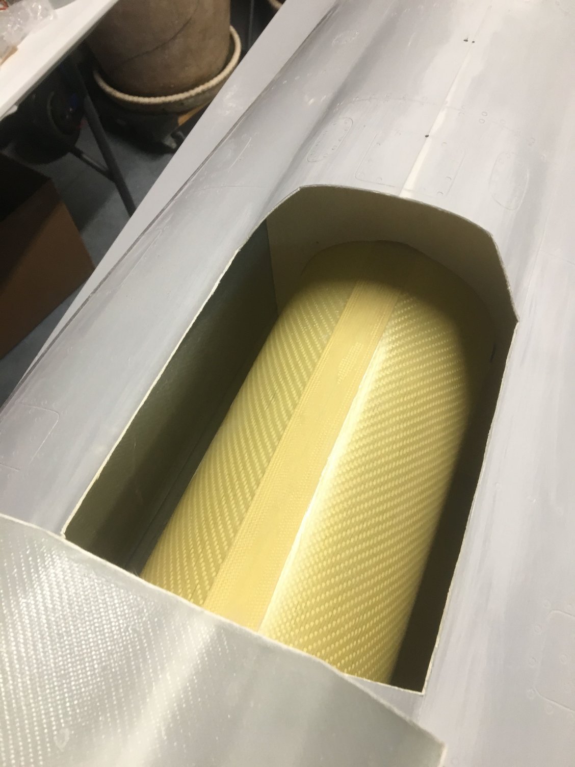

I just started on my Mirage 2000 from aviation design so I will like to give everyone some pointers of how to go about building one of this.If you like you can use my techniques or we can share yours thank you, Nick. Here are some pictures.
First you need to cut all the openings for the doors and also I opened up an extra access panel right behind the main blockhead, close by the CG point these will help with the smoke system and also to incorporate and extra fuel tank under the main one to get a couple more minutes of flight.
I am running a P300 Jetcat and that tends to suck a lot of fuel

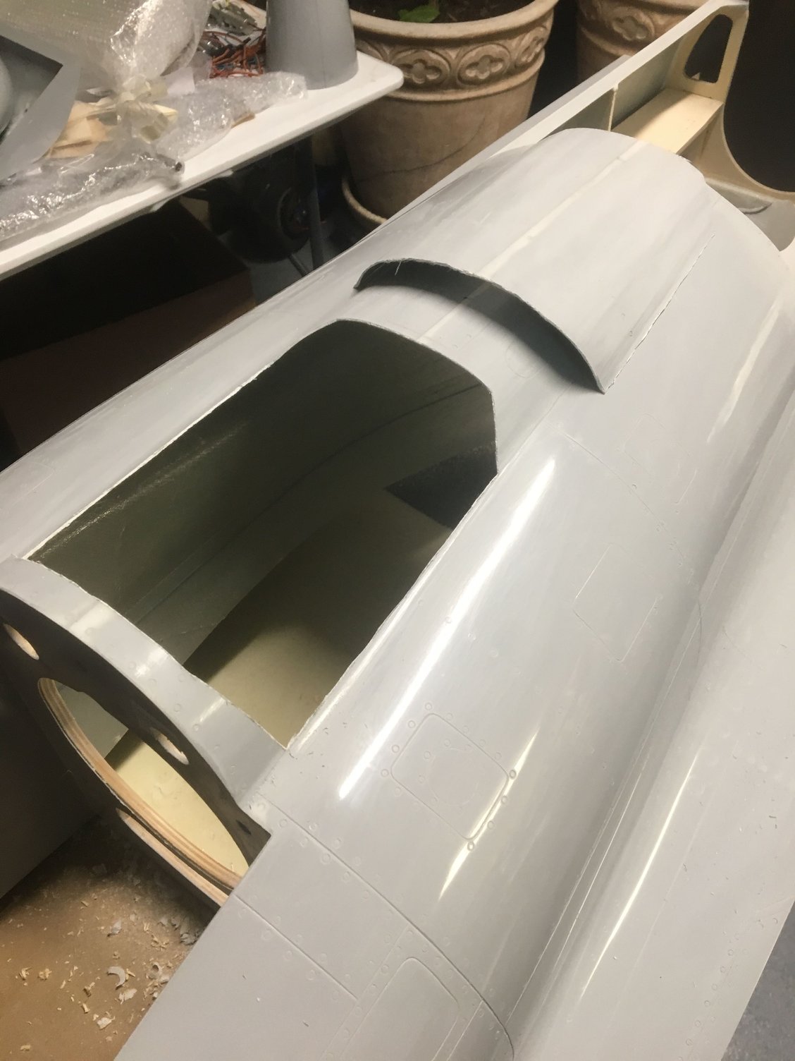

To do the cuts I use a diamond blade on my Dremel cut all the way to the corners and then use the X-Acto knife to finish the cut he works pretty good

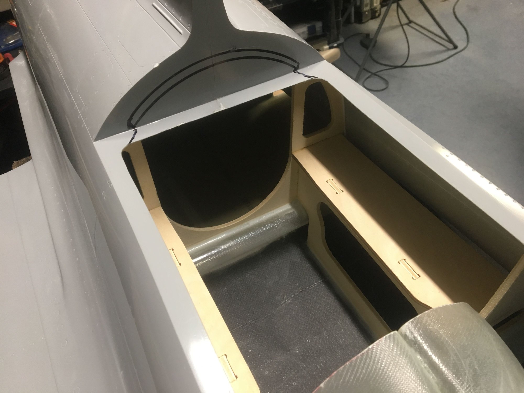

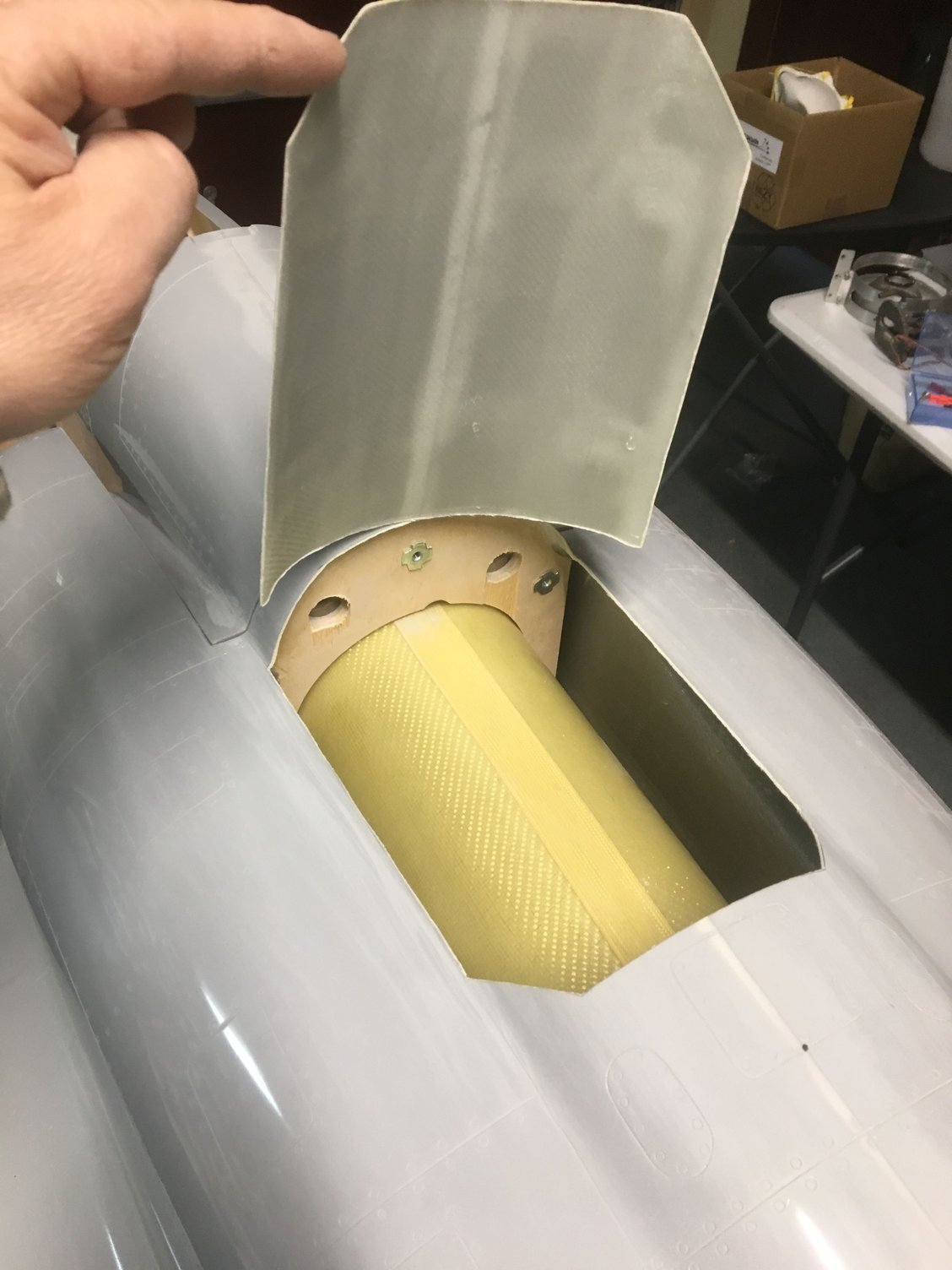

Here is also the access panel that I spoke about earlier it will come very handy and I also drilled two 3/4 inch holes right on top of the fuel tank in the bolckhead so I can have access for extra wiring or tubing .

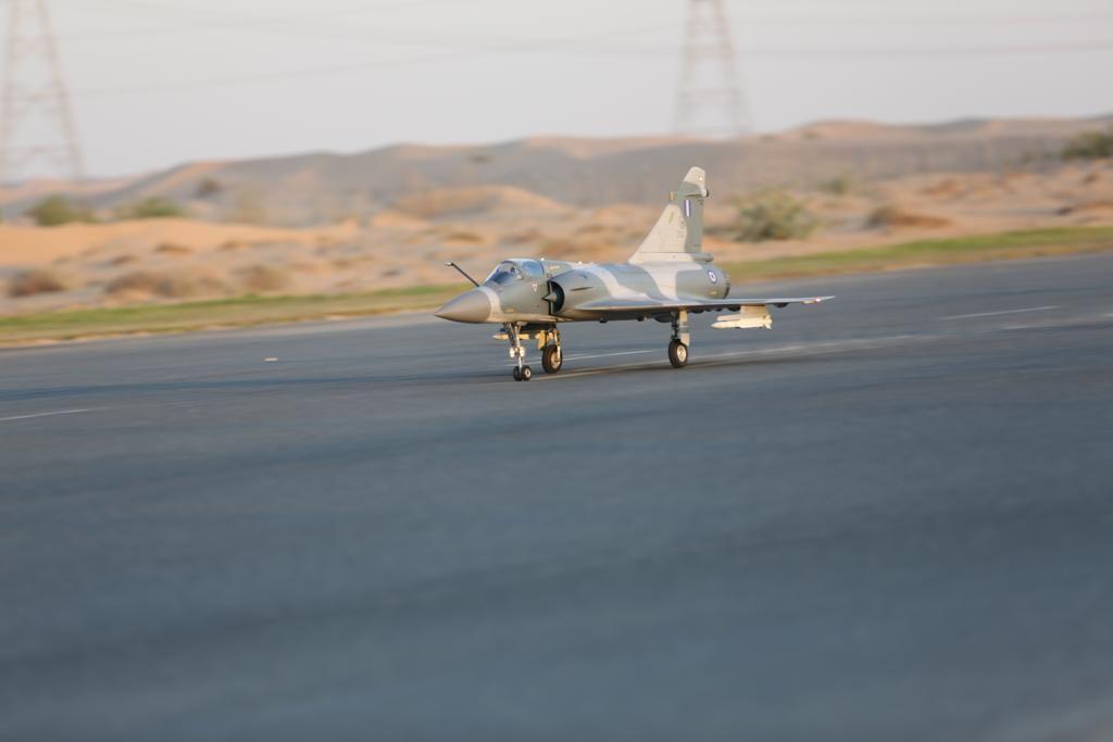

Hey Niko,
What happened to your last Mirage? I've upgraded the L/G to down and locked - perfect. Still however need alum struts. Do you think you can get your guy to make us a few more pairs?
Pics from a couple of weekends ago:
Thanks, Tassos

Hello Tasso,
your Mirage looks nice . My last one I did a slight maneuver and I think my engine quit because I cannot recover at the bottom and I hit the ground .I saved the engine that retracts and a few other things,that’s why I’m building a new one now. I will try to make this one less heavy.
Old 11-27-2018 | 02:48 PM

Ooooo real pity, I'm sorry you lost that airframe it was so beautiful. I see you saved the tail though .
Yes weight is an issue on this airplane as it is with the struts - Aviation Design has no solution for the retracts so far. Hope they will soon. On the weight issue I've a P200RX on the airplane which is ok at top speed but not real push when the stick is below 50%. I was thinking for the new P300PRO but then it's a trade off - the fuel tank would be small and then if install something additional then I'd add around 2kg more of equipment and fuel.
Anyway I'll be following closely your thread.
Tassos

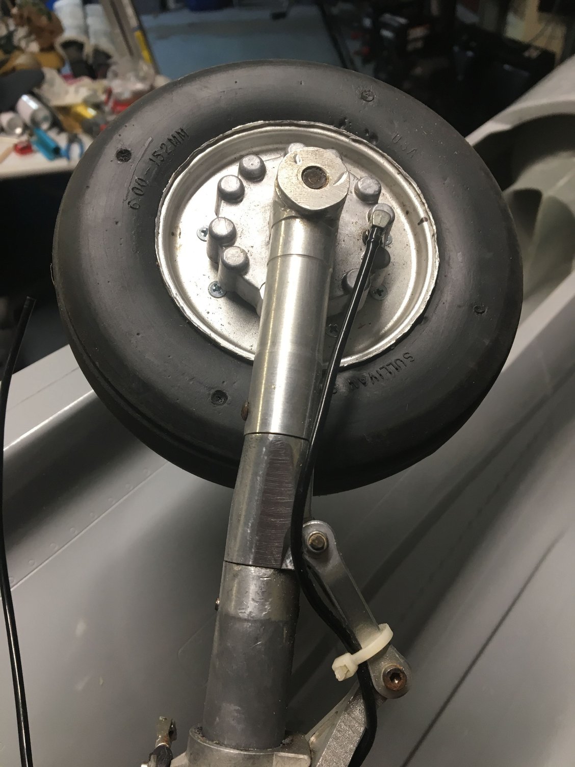

Old 11-27-2018 | 09:07 PM
spaceman 01's Avatar
My Feedback: (44)
Joined: Sep 2004
Posts: 439
From: Wilmette, IL
Tasso, here is the picture of the old and new struts. You’ll need to replace the two bottom pieces from cast aluminum to CNC aircraft aluminum this is my second set in case the first one goes bed. On my first sad I have over 40 flights and I had no issues .
I asked my friend to do couple more sets, but he declined, he told me it requires lot of work .

Also the problem with the retracts is that Eric needs to contract someone with a CNC machine to run at least the Struts from aircraft aluminum and then the issues will be solved .
check out the picture with my struts

On my main doors a good practice is before you hinge you must send about 10 mm with a 45° angle at the edge. zoom in on the picture to see
