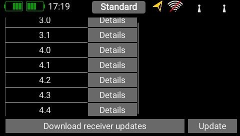

As of this evening, cannot get the update in the Western USA. My radio still shows ver. 4.2 installed, 4.2 is the latest version shown as available
This is a PBR-7S rx.
Time 19:00 MST.

Hi Zeeb...
V4.3 was released about a week ago so that should be in your list and V4.4 was recent.
Did you hit the 'Download receiver updates' button to download the new Rx updates into your Core via WiFi...?
Maybe just try again - it should not matter where you are located as their server is based in Germany and everyone accesses the same server.

AEROSHELDON 02-13-2025 07:29 AM
I an in US and did a few yesterday as well. Good luck Zeeb.

Zeeb 02-15-2025 09:16 PM
I had 4.3 show up once, downloaded it and it failed on the install. Since then I've not ever seen 4.3 show up on my list of available updates nor anything higher than 4.2.

AEROSHELDON 02-16-2025 07:41 AM
Zeeb do you have the screen like post 2029 where it says to download the updates to tour Core after you are connected to wifi?
BarracudaHockey 02-16-2025 08:40 AM
That would be weird because "download latest updates" only brings in the new updates, it shouldn't remove any from the list.

Zeeb 02-17-2025 01:15 PM
Well I got it to work finally. The issue I had is that the rx update list was not fully visible. and I could not scroll down any further. The 4.5 update just barely showed up on the list the last time I tried it and I was able to click on just a tiny sliver of the box but it picked up the update, downloaded and installed it. 'Gonna have to watch that issue of not being able to scroll down the page on the listed "update" section.

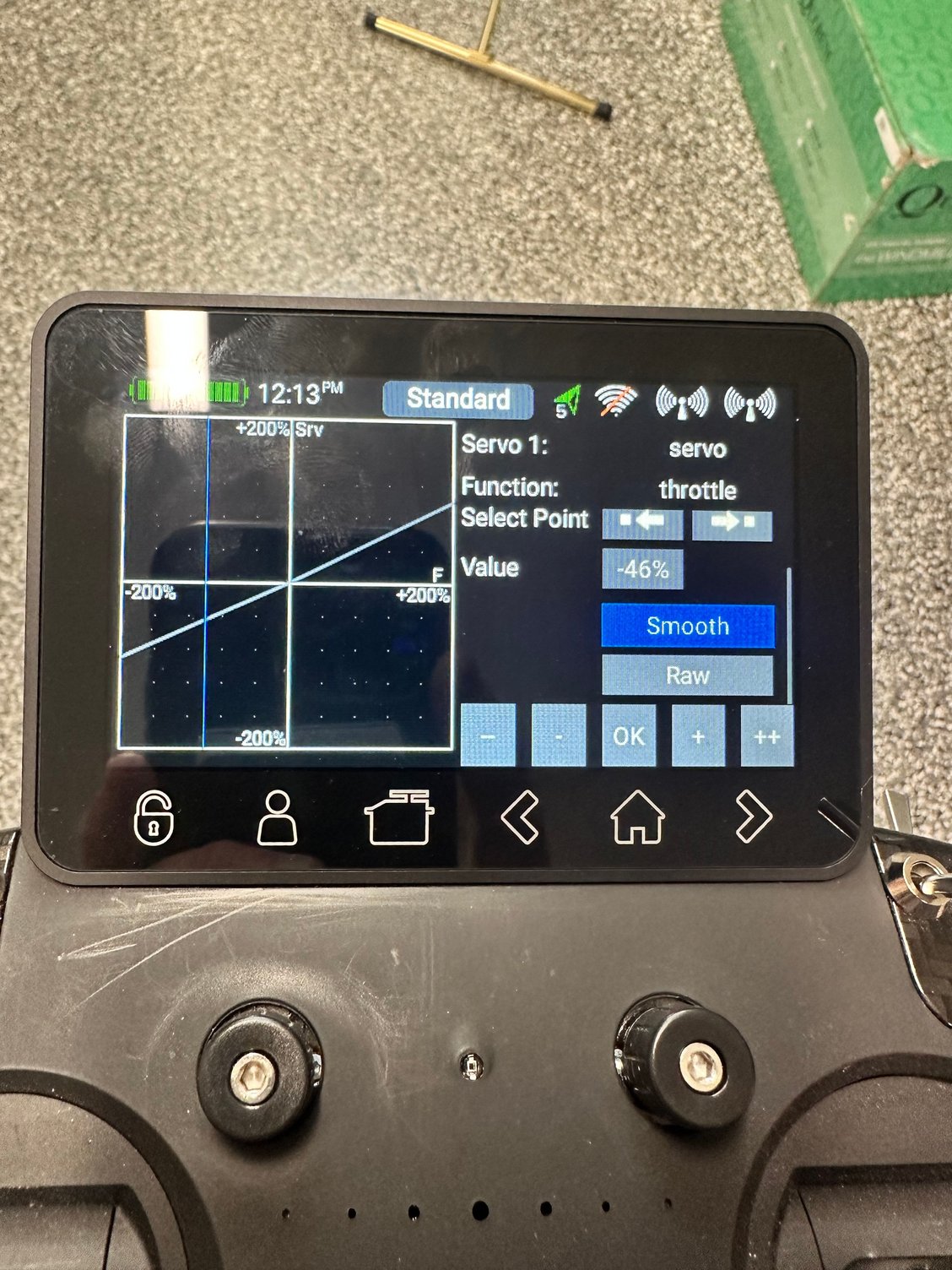

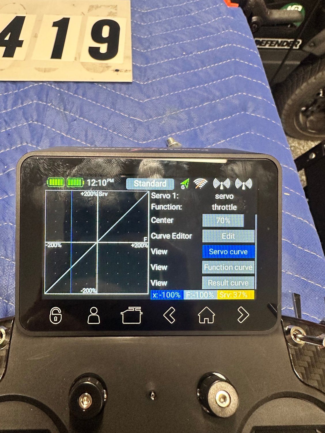

I am having an issue programming the throttle for a dualsky and jeti setup in my F3a airplane. I have to reprogram it every time and it defaults to half throttle before the engine turns. I fix it to get a linear throttle curve and then I shut it down after every flight and when powering back up, I have to reprogram the throttle channel in the radio to get it to work. I know it’s me. First model on PowerBox Core. Any suggestions or ways to fix it. Below are some screen shots.

BarracudaHockey 03-28-2025 09:11 AM
What are you trying to accomplish exactly?
I know with most ESC's and turbines I have to set the end points to 80/80 or 90/90 to get a good throttle calibration, the pulse is wider than other radios.
PJFaller 03-28-2025 12:05 PM
I’m trying to figure out why when I set up the throttle channel to give me linear throttle from idle to max power it works fine. I finish the first flight and upon power up for the next flight, my programming for the esc is lost and my esc beeps that it’s not setup. I have to redo the throttle for every flight. It’s not set it once and forget it. And, the program values to needed to program the throttle are different for every setup and flight. It’s not saving the setup.
FlyJ 03-28-2025 10:08 PM
Are you seeing that something in your throttle curve changes from flight to flight? Looks like your first image shows you turned the endpoints up to 200%, which is probably beyond what the ESC wants to see. Maybe I’m misunderstanding the problem. I get that you have to reteach the ESC, just trying to clarify if this is an ESC issue or radio issue.

Can you export your model file, rename it to text and attach it here so I can see what you're doing?
PJFaller 03-29-2025 06:37 AM
Unfortunately I am in the road for 6 days and don’t have access to the transmitter and airplane. Reading a bunch and doing research, I think it is the end point adjustments doing this. I am going set everything to original settings and then try gain when I get home.
your suggestions got me going in the right direction looking through the manual. I will let you know when I figure it out. Or need more direction.
