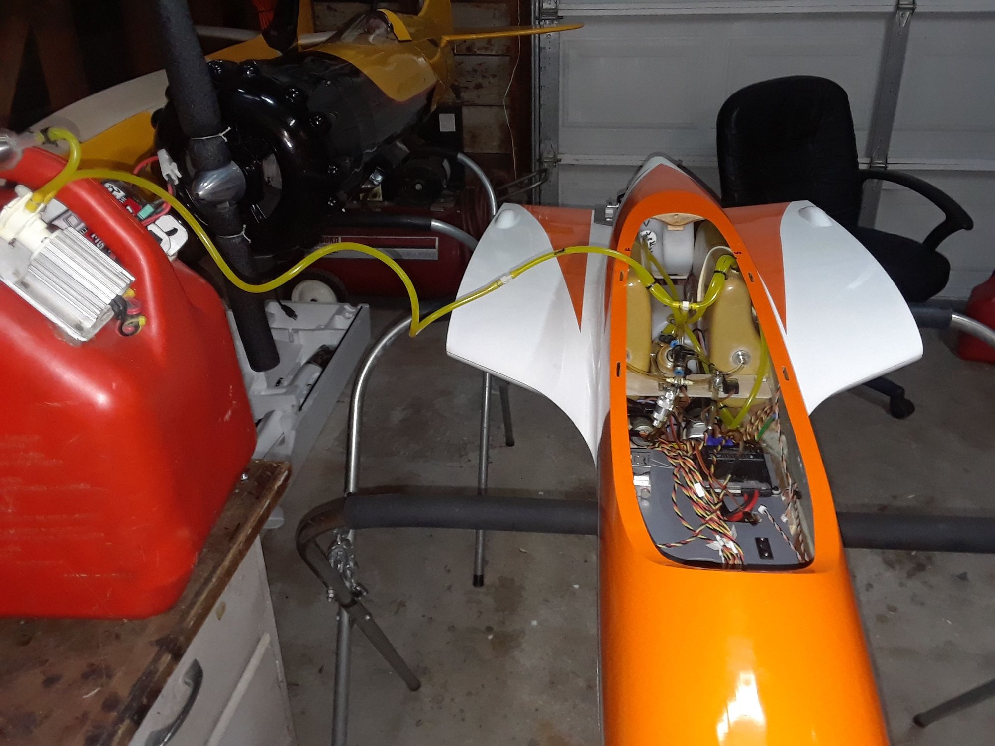

CARS II 06-26-2019 04:16 PM
https://cimg9.ibsrv.net/gimg/www.rcu...ed6431c94f.jpg
Ok, so about two hours and two Lagunits later and some fuel on the ground and on my shirt and shorts, I have some good info on CG and TO weight.
TO weight will be 39 lbs, this is with full fuel, main tanks and UAT + 60 oz of smoke, CG at TO is 1" forward from the recomended CG point ( holes on the booms )
CG without fuel ( in case the smoke pump doesn't work after TO and he still want to fly ) is 1" after the recomemded CG with the main tanks empty ( again, the holes on the booms )
Lifting this monster by myself? heck no! I had to ask my daughter ( who will be taking rc flying lessons from me soon, YEAHH! ) to help me lift it of the stand.
Time to run the engine before wife arrives :)

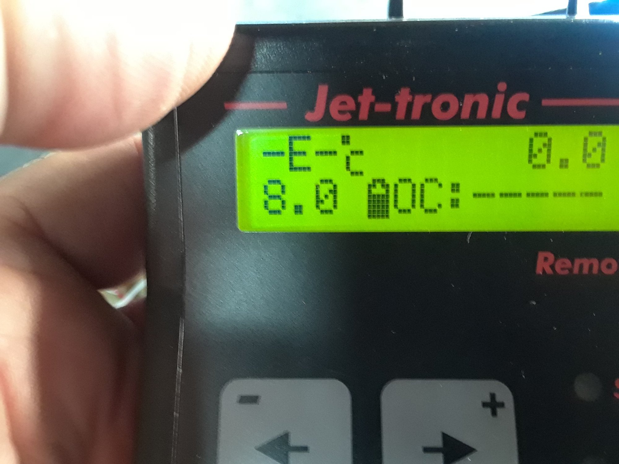

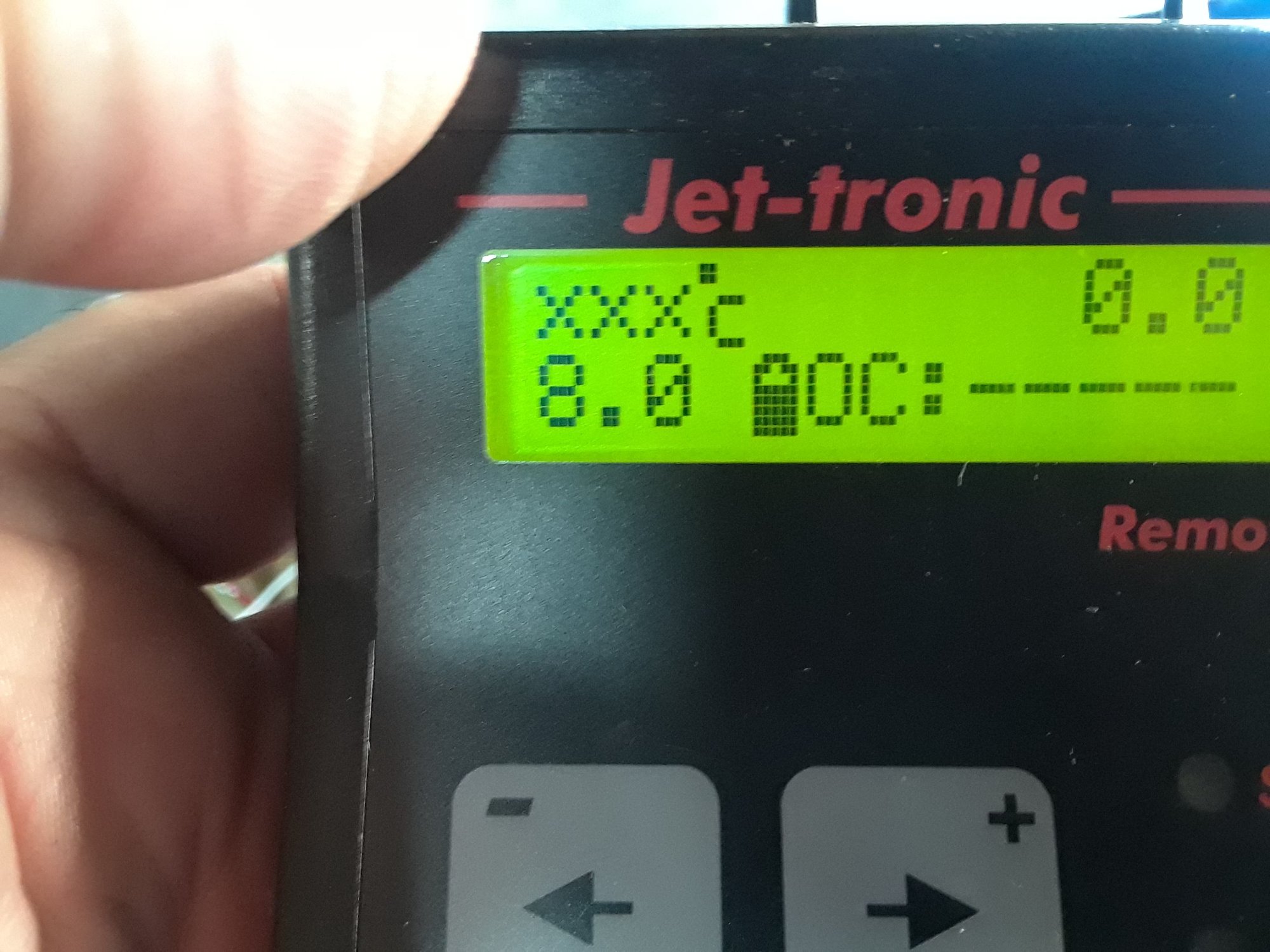

Ok, I'm about to run the engine BUT, I'm getting this massage on the GSU, it is temp prob related?
CARS II 06-26-2019 05:42 PM
I had a temp fail on my TJT years ago and it was something like this.
CARS II 06-26-2019 11:21 PM
I posted my findings and questions regarding this problem on the JetCat engine forioums.
I also send George the question with the photos.

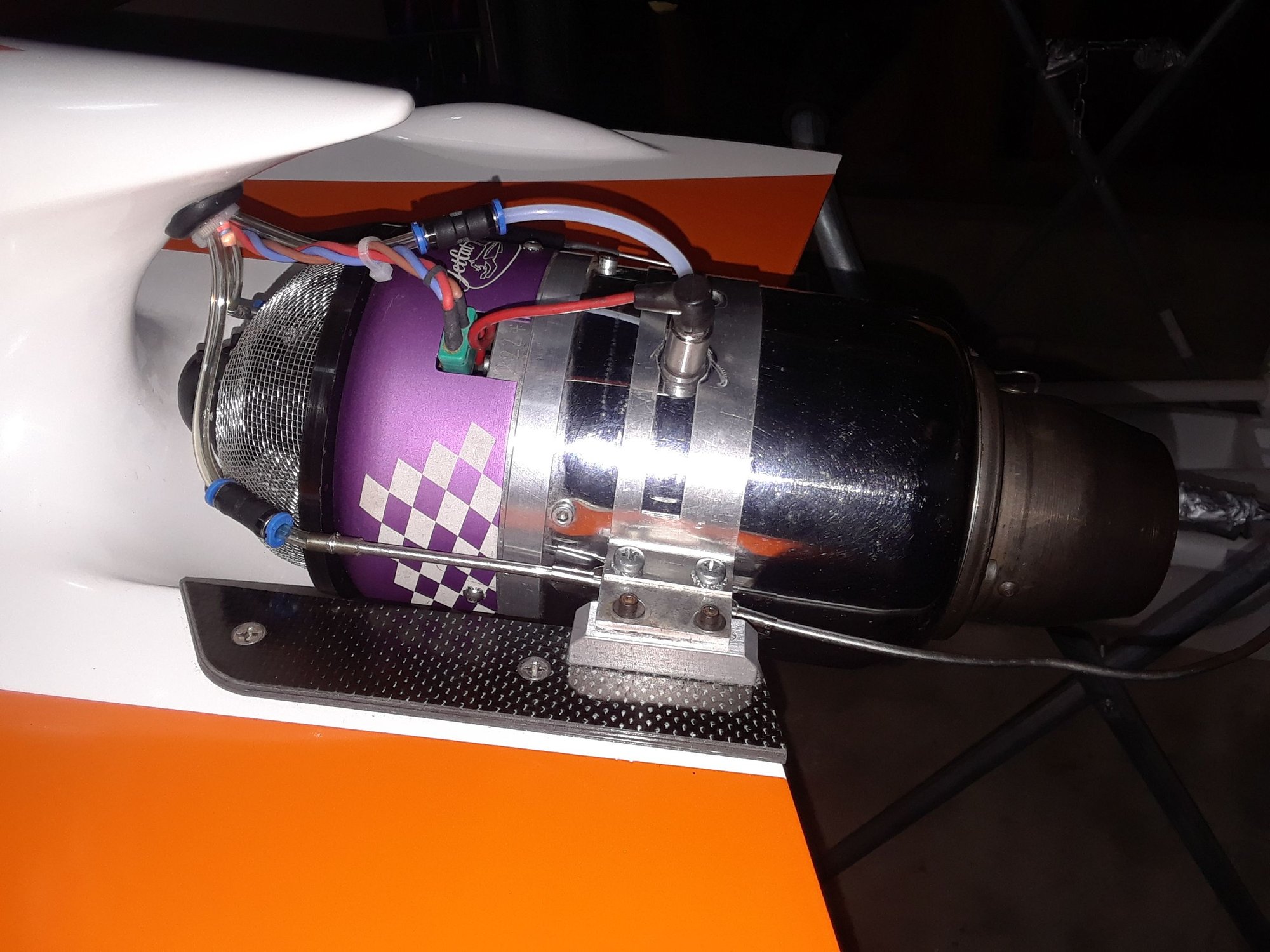

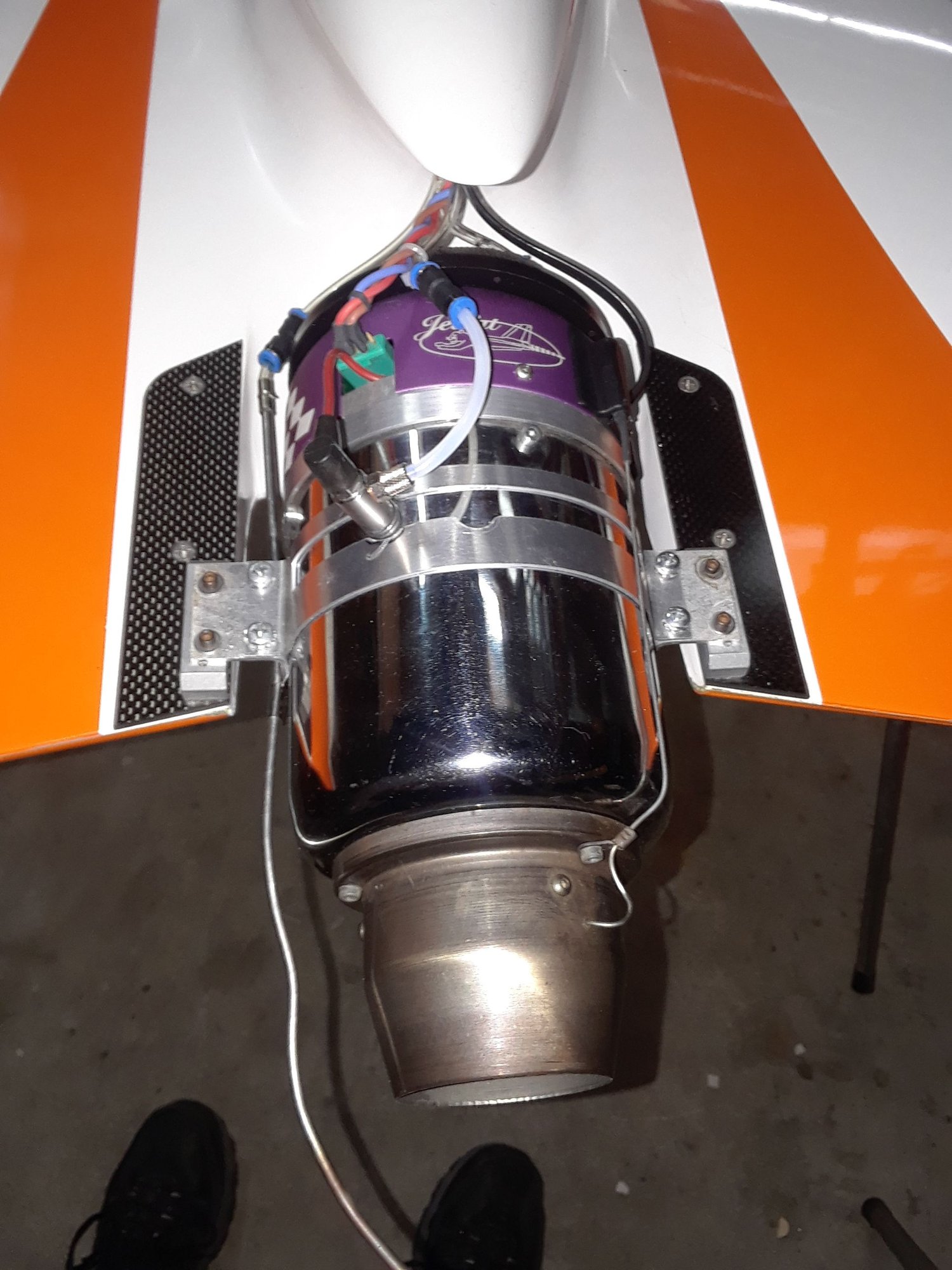

CARS II 06-27-2019 11:43 AM
After doing more testing, I decided to order a new temp prob from DW ( here I go again ) good thing is that they have the parts.
CARS II 06-27-2019 04:27 PM
https://cimg9.ibsrv.net/gimg/www.rcu...f96e55757e.jpg
https://cimg2.ibsrv.net/gimg/www.rcu...c6782edd07.jpg
This engine is mounted permanently now that is has the FOD screen on, I can swap the temp prob without removing the engine from the mount.
