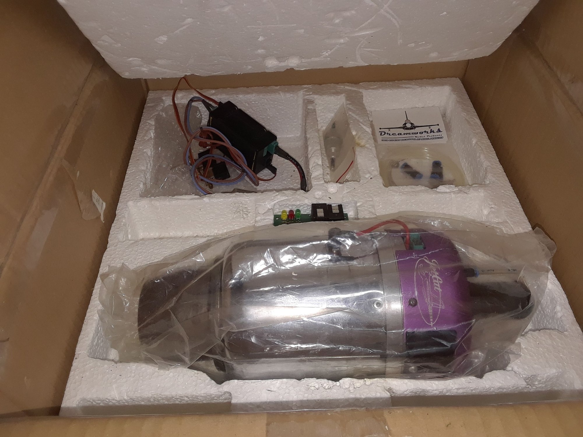

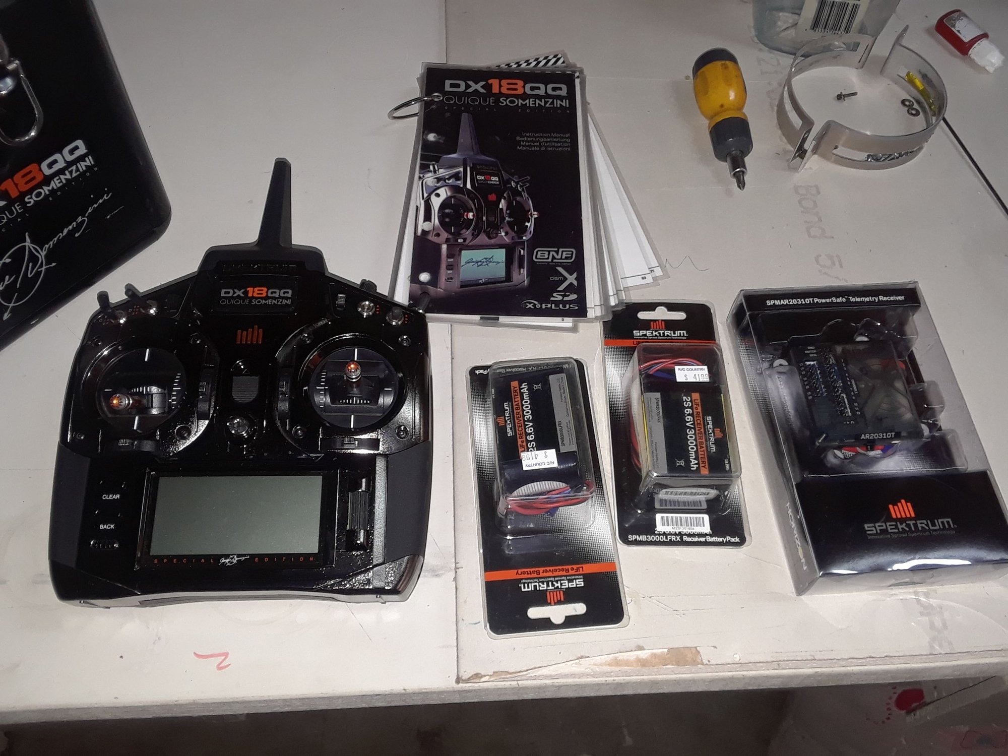

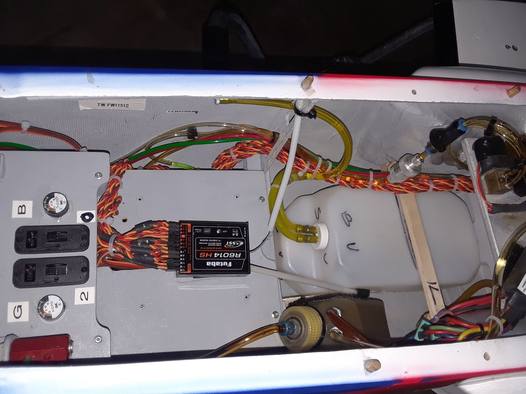

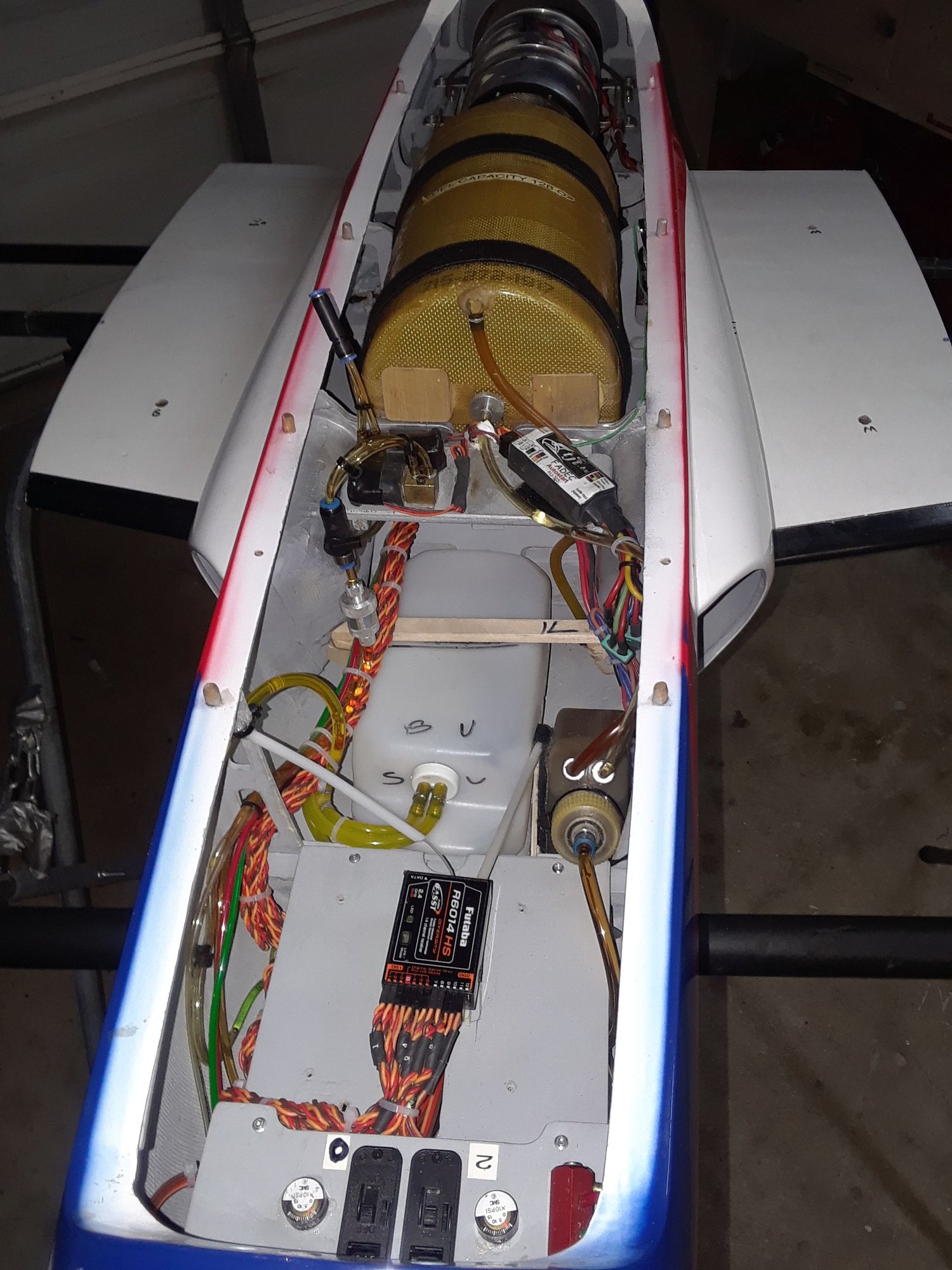

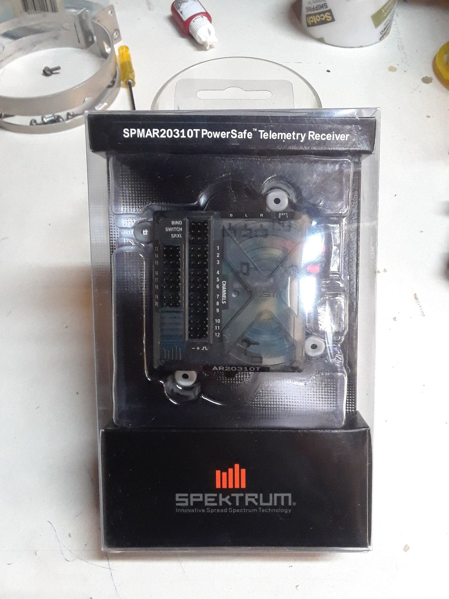

On this rebuild I'm going to go over the entire airplane ( as I usually do ) and will be changing, swapping and adjusting as needed, a low time JC P120 SE is goin push this Cat, I will be adding a TamJets smoke system ( yah! we still have a few around including mine ) single sprayer, it looks like it has a single and dual jetronics brakes and retrac valves ( never had one of those ) and a few other things like new metal servo arms to replace the plastic ones it has right now, this Cat has to be solid when he pushes the pedal to the metal ( as he usually does )
Over all, something different for me to do in between my wood jets don't get me wrong, I've had my shear of building ( ahem, assemble ) composite jets

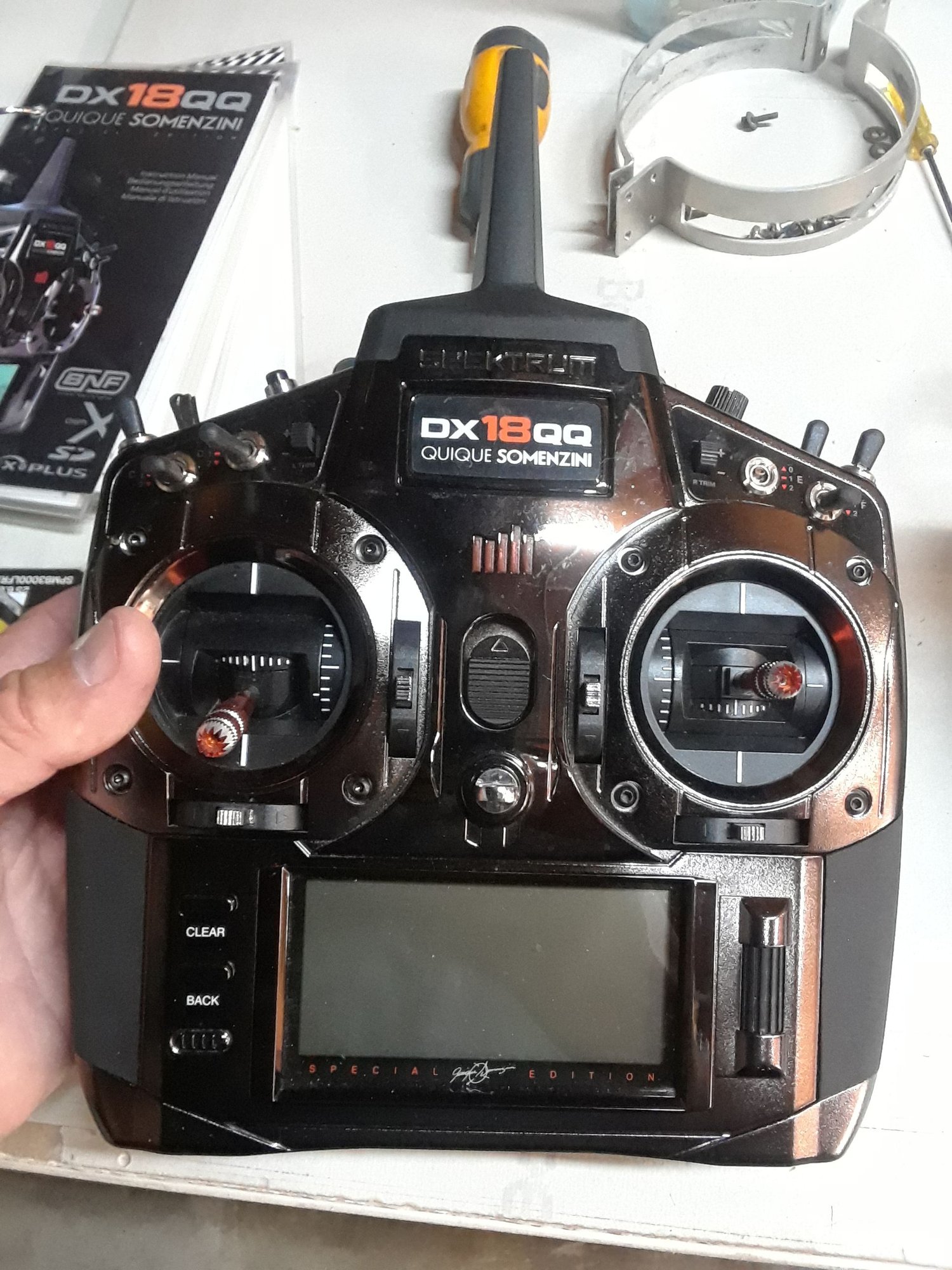

A QQ 18 Spektrum togather with a 20310 power safe with telemetey will be driving this baby, we even have a KC manual
I've used Spekteum before but, none of the newer radios like the 18, I will probably need some help with the programing.

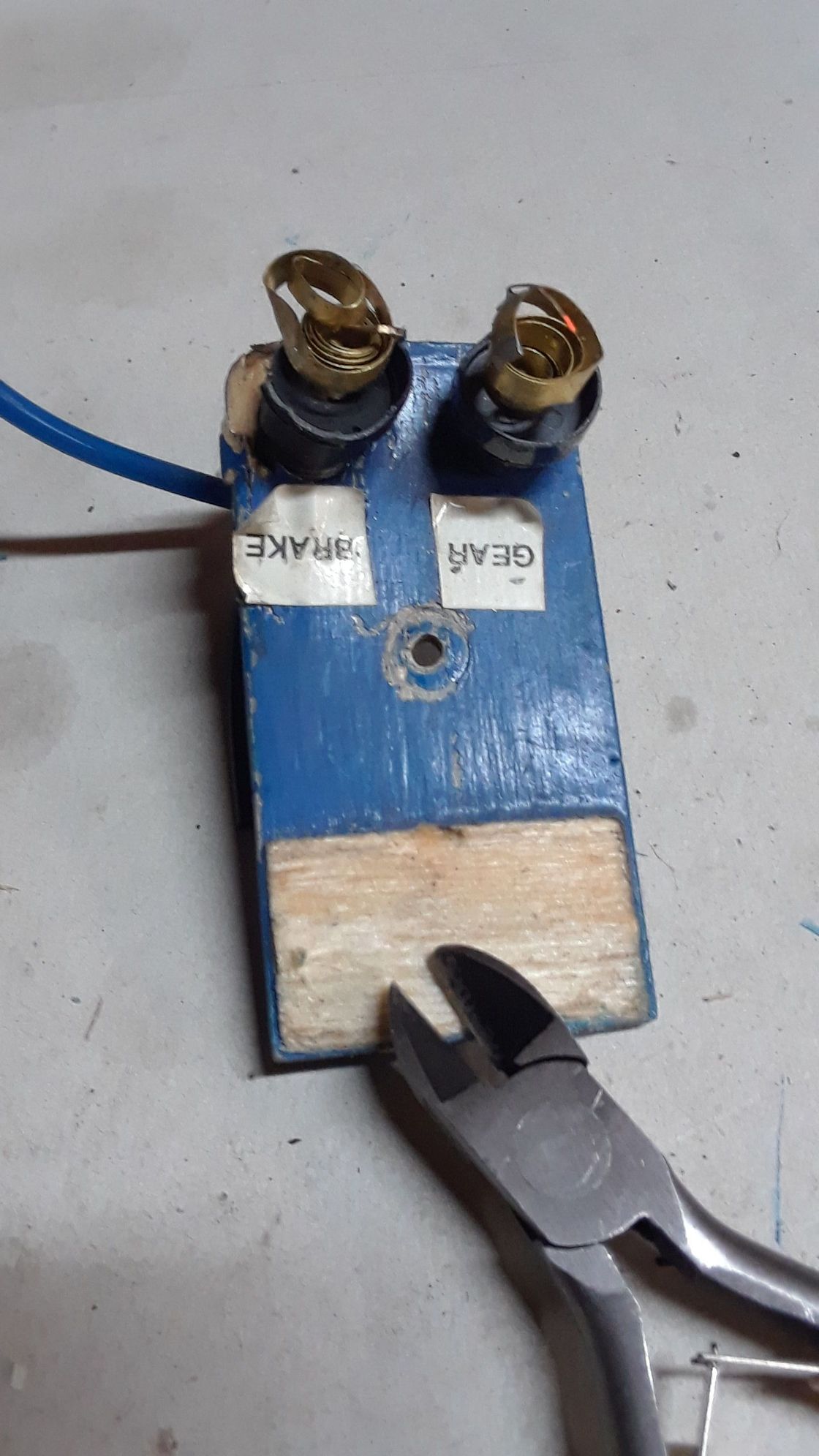

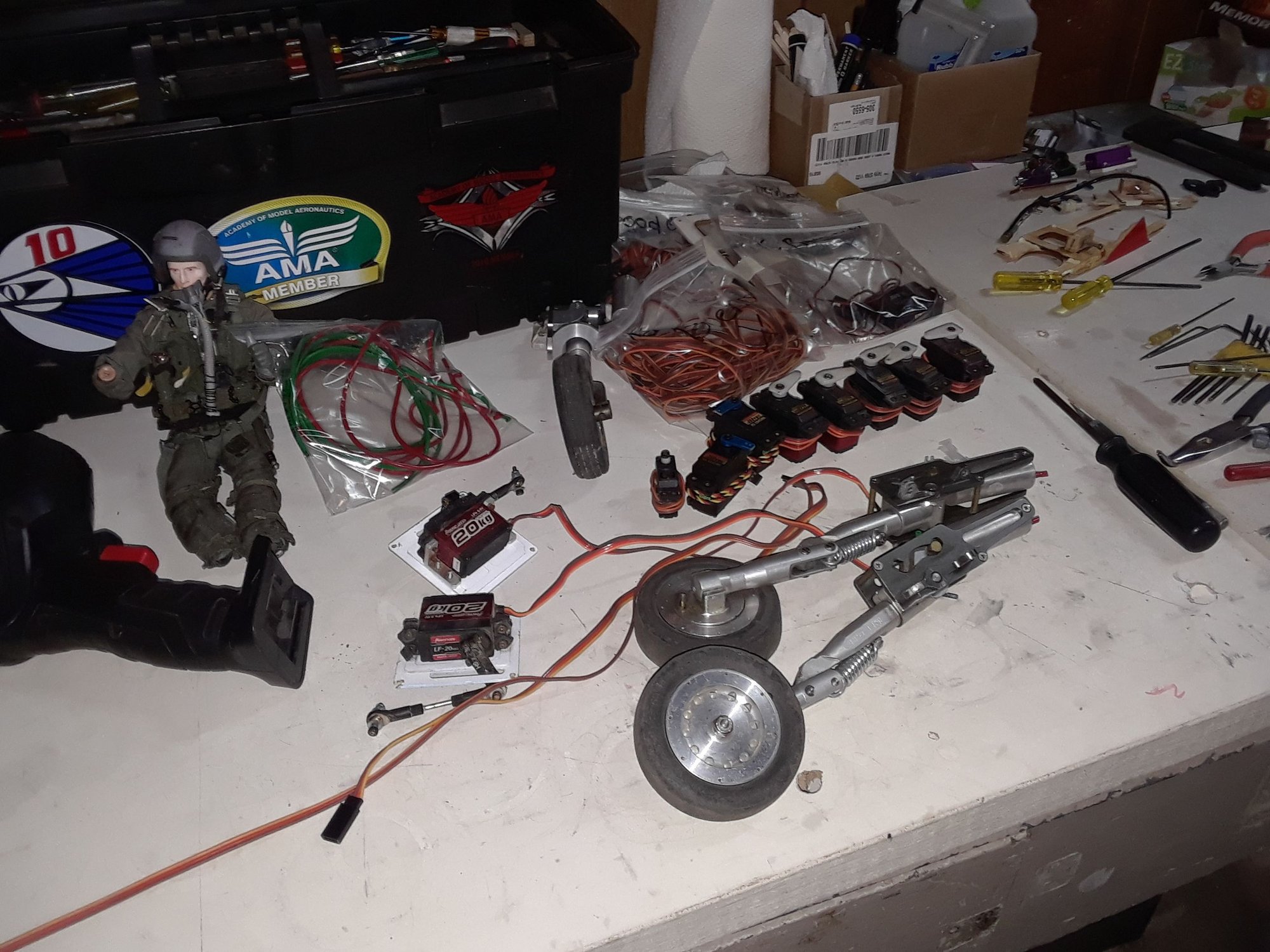

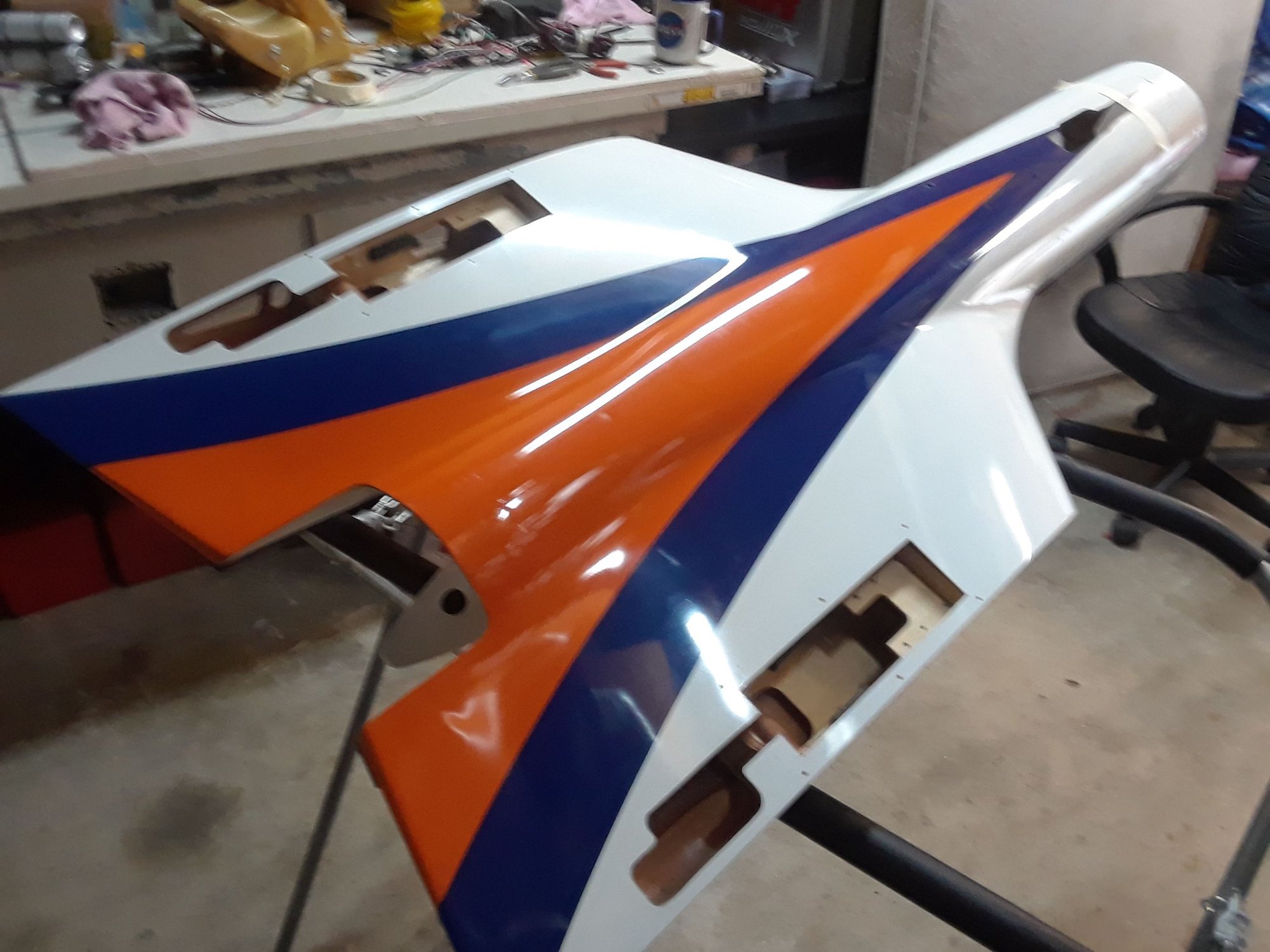

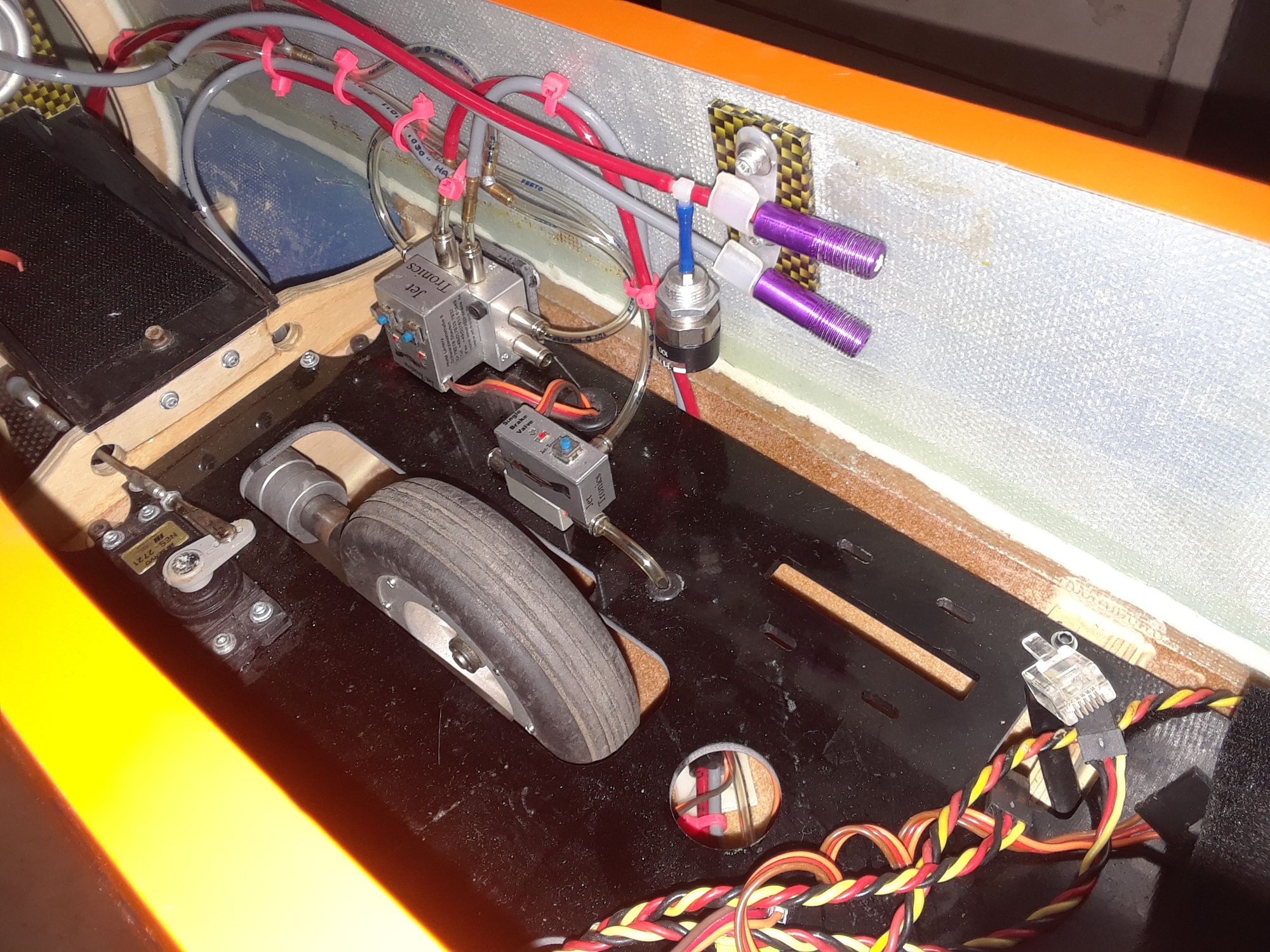

Well, I got almost all the parts out of the fuse, as I said above, will need to change a few things, overall, it's in good conditions but it needs some TLC, will be ordering a few things to put it back together, with all the work that is needed to get it back in the air, it will most likely take a month to complete.

Old 04-18-2019 | 07:42 PM
CARS II's Avatar
My Feedback: (7)
Posts: 6,658
Received 137 Likes on 120 Posts
From: Sacramento CA
Jeremy
Do you remember if the try in your Cat was made out of G10? this one that came out is incredible heavy.

They were plywood trays originally. KC come out a bit nose heavy, so it does not need a G10 tray!

You ought to go through the air system. If the retracts leak, you can order new cylinders or try the o-ring lube. I second the suggestion to get the trail-in-link struts!

Yah! the tray is so heavy I want to use it as a sinker we are going to use the tray from the broken Cat if it is in good conditions or I will make one out of 1/8 plywood.
Thank you for that piece of info David
On the broken Cat we installed two sets of flex plates, if they survive then I will use those to double the flex plates.

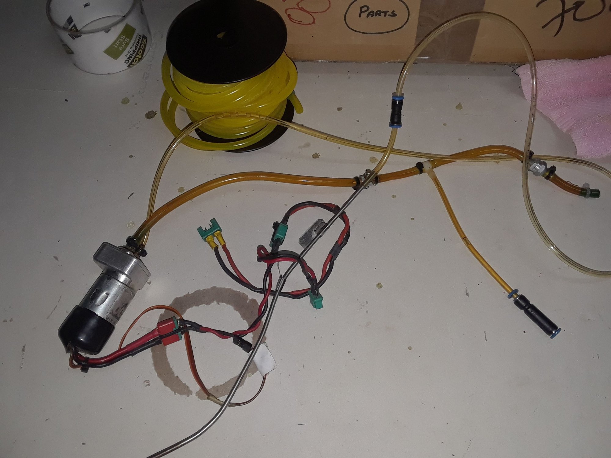

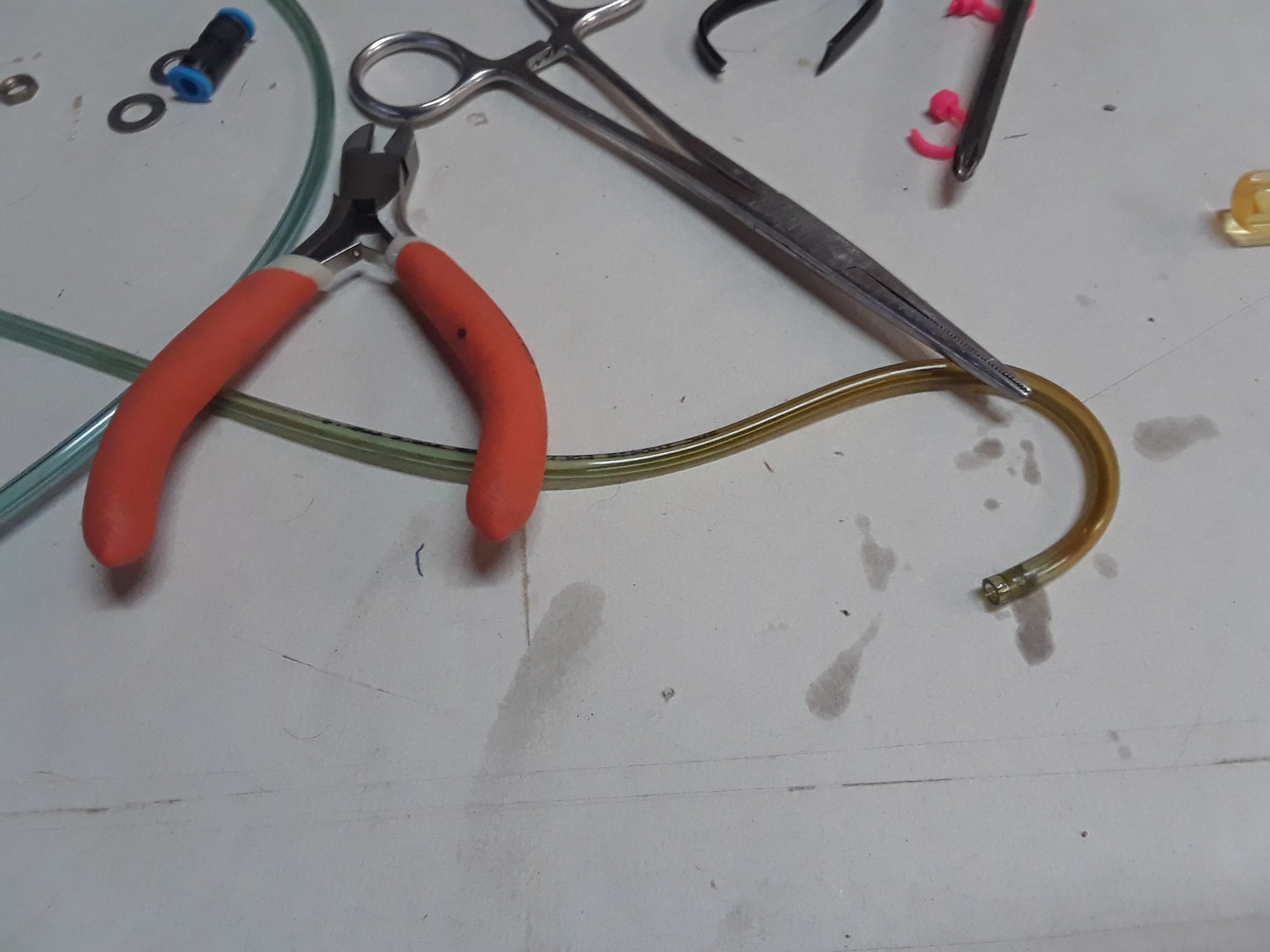

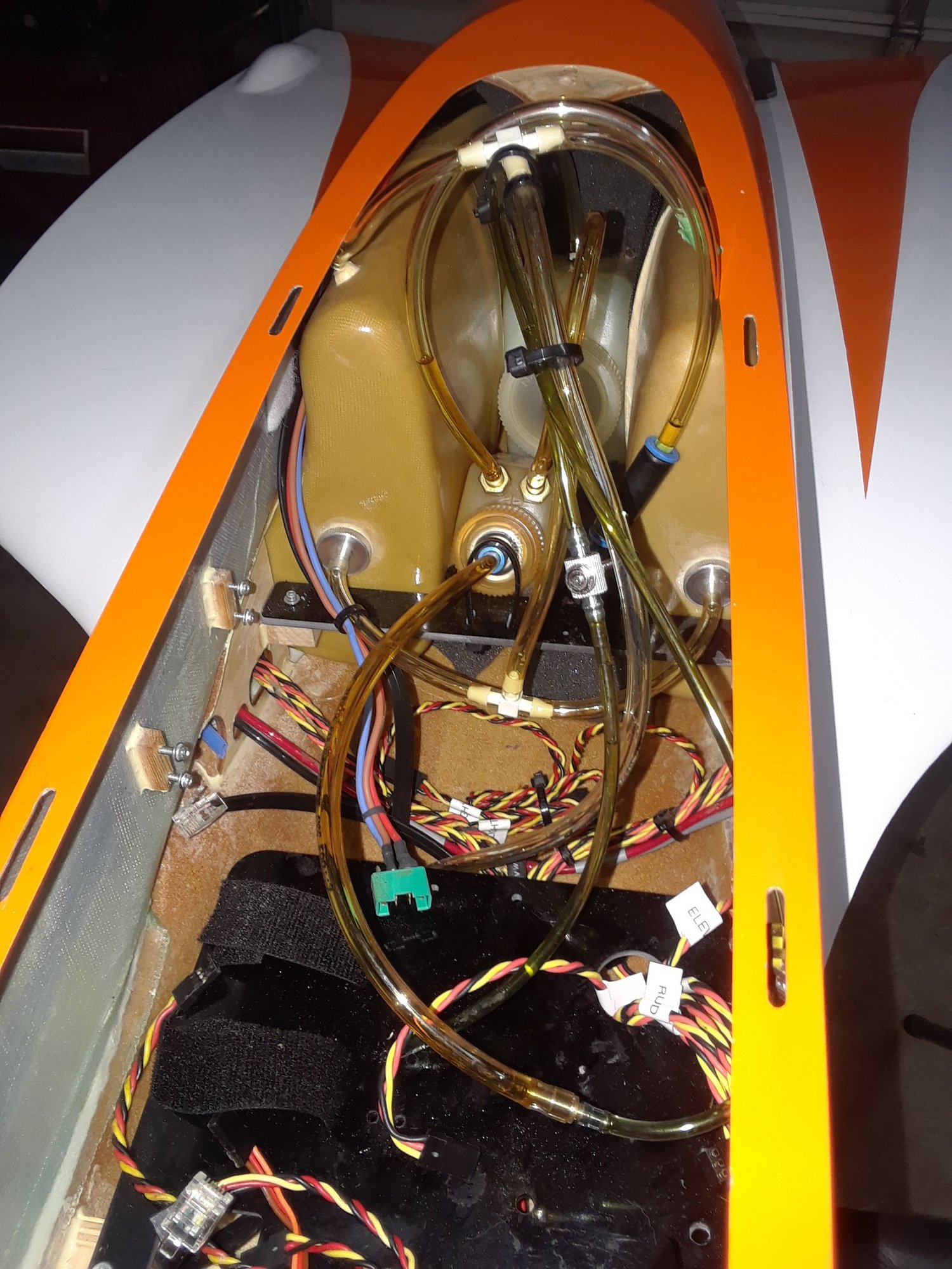

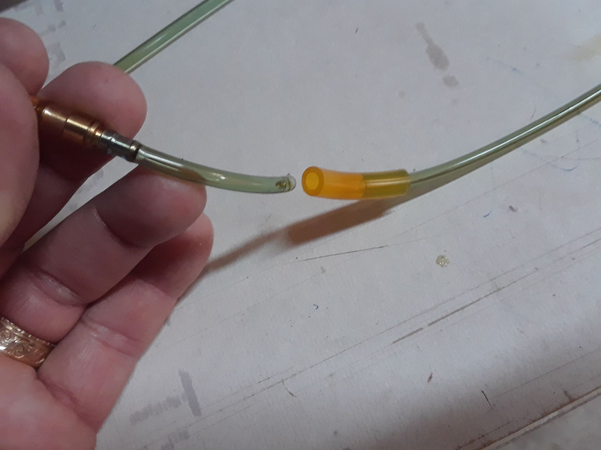

The suggestion to go over the airlines and retracts is good, I wasn't going to BUT, after looking at how the fuel lines came out, I decided to redo every system in it, I will service and test the retracts outside the airplane before they are back in, I use the rc car shock oil #25 weight to refresh the O rings in the retracts, the brakes also need service.
Thank you for the suggestion.

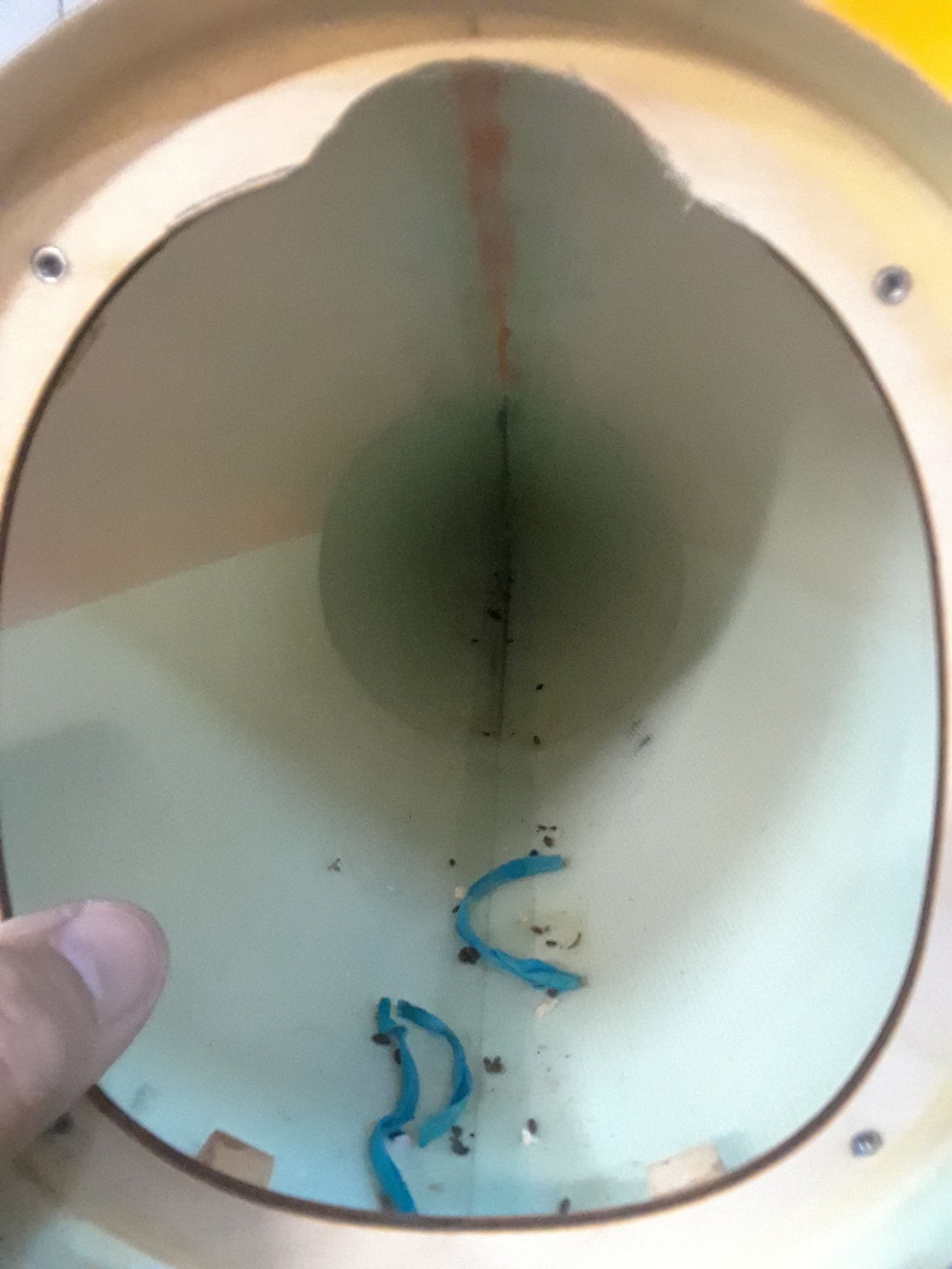

Since you mention that his Cat hasn't flown for a while, check this out and tell me how long this Cat hasn't flown for ( picture ) mice dropping in the nose cone and also found some in the center of the fuse.

That is kind of sad. Where did he have that thing stored? My friend keeps his in his house in a spare bedroom. I "hope" that it does not have mouse droppings. He has not flown his in about 6 years. Thinking about it..I have to tell him to get new batteries for his so I can balance it properly.

What I know about this one is that it came out of a state sale, don't know exactly where it was but I think it came from somewhere in northwest, I presume it was stored in a garage for a long time not been flown then sold in a state sale sometime last year.

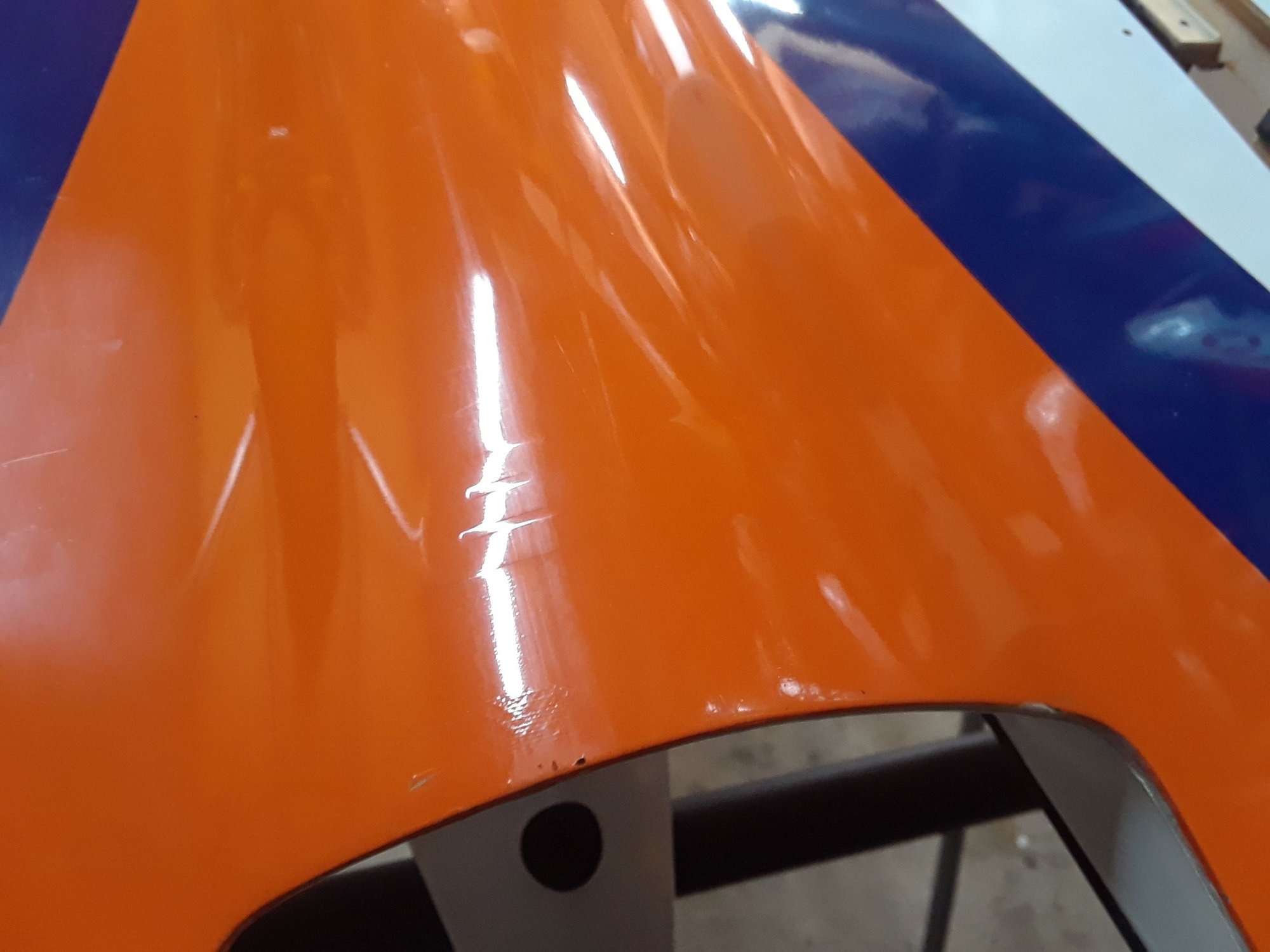

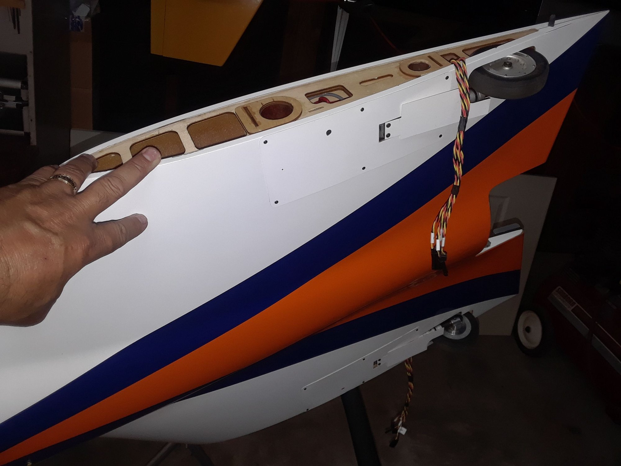

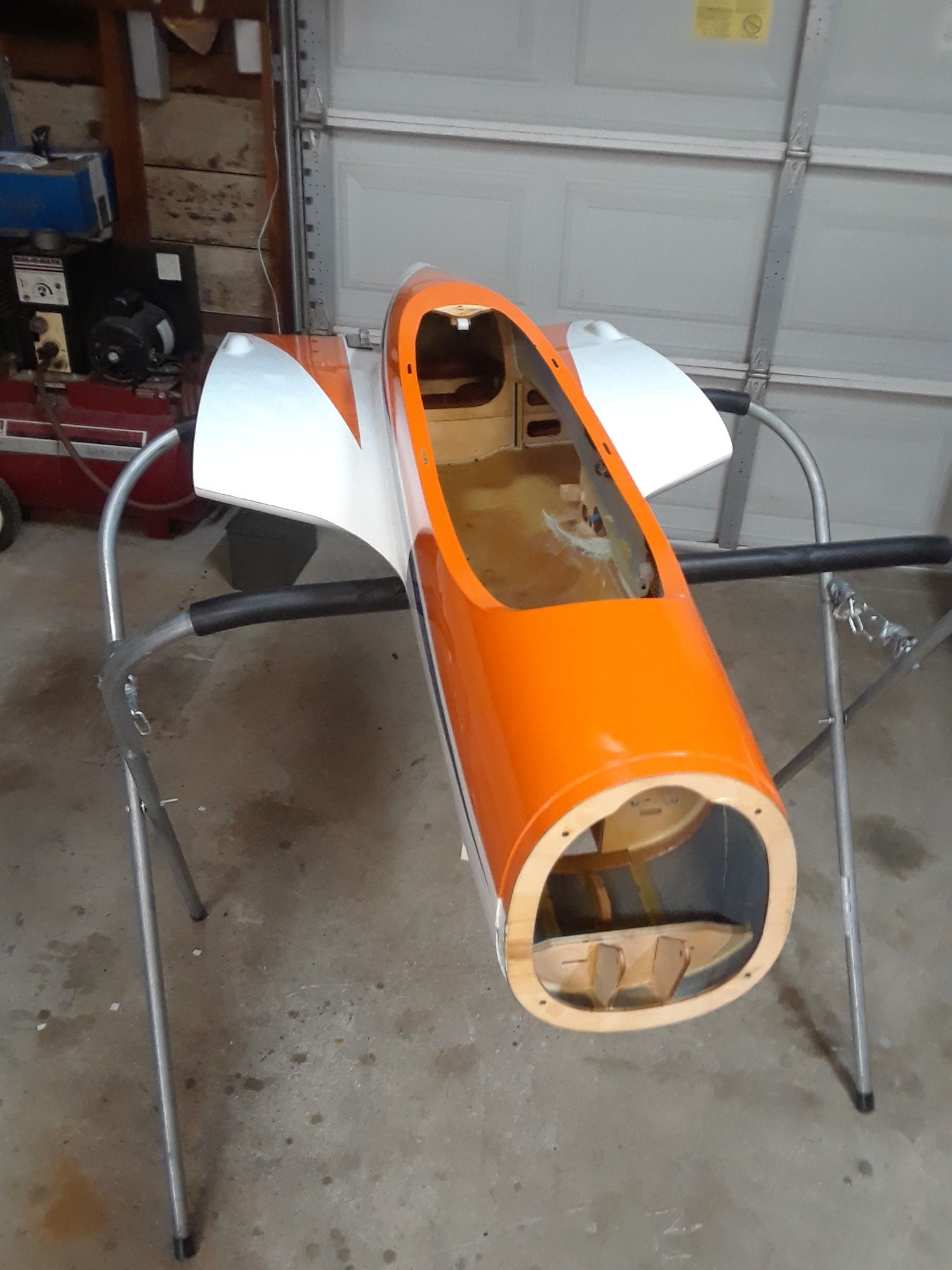

All has been removed from the fuse and bagged, I found a spot on the nose bulkhead that will need just a bit of glue, other than that the fuse is in excellent shape, I also found a main and a nose flex plate that were stressed a bit but 100% usable.
Soon I will be getting new airlines, fuel lines and other goodies to start the assembling, in the meantime I will service the main gear parts ( retracts, struts and wheels )
If you look very closely to the rear bottom of the fuse you can make up the three BVM letters that are build into the mold

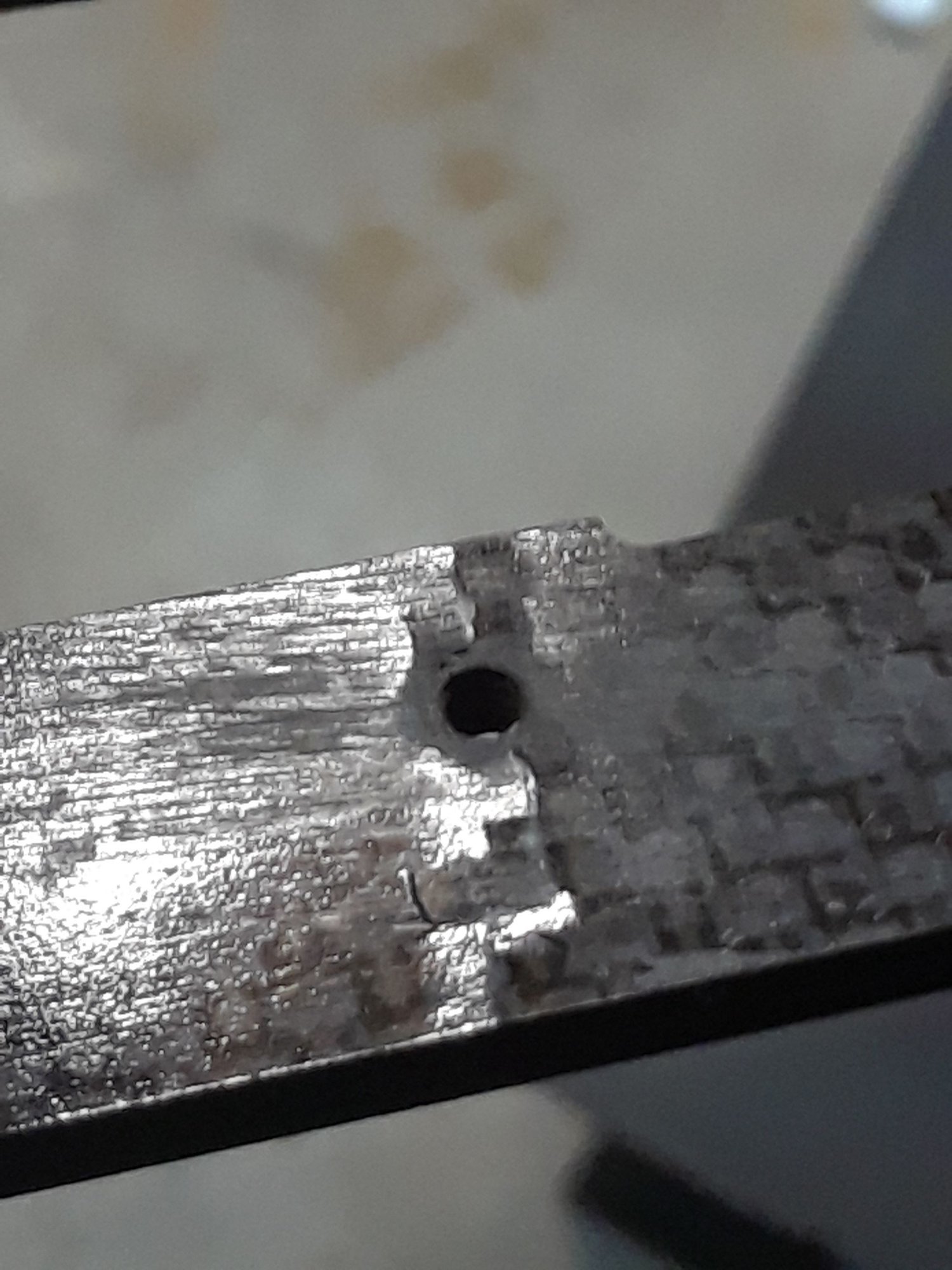

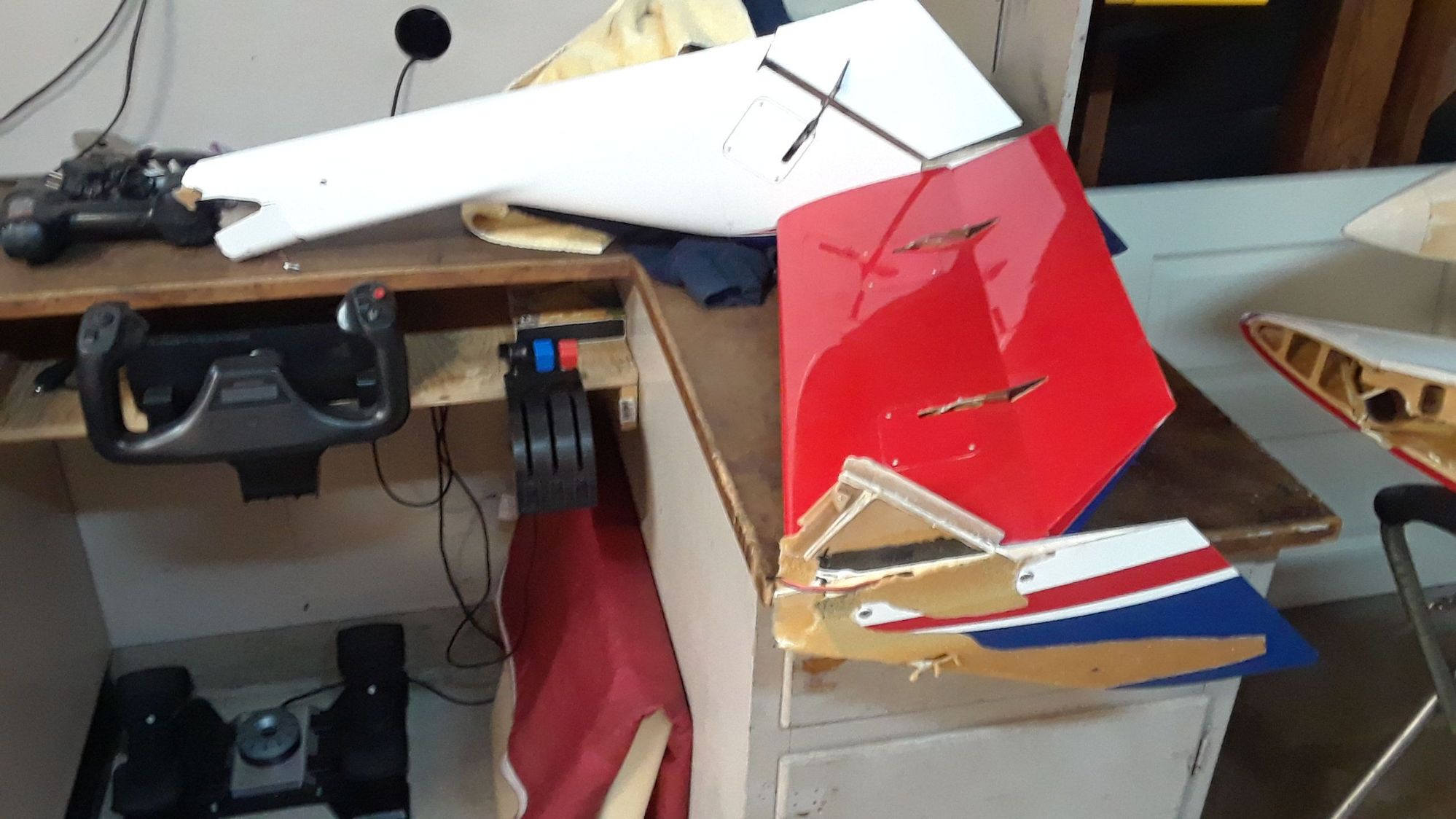

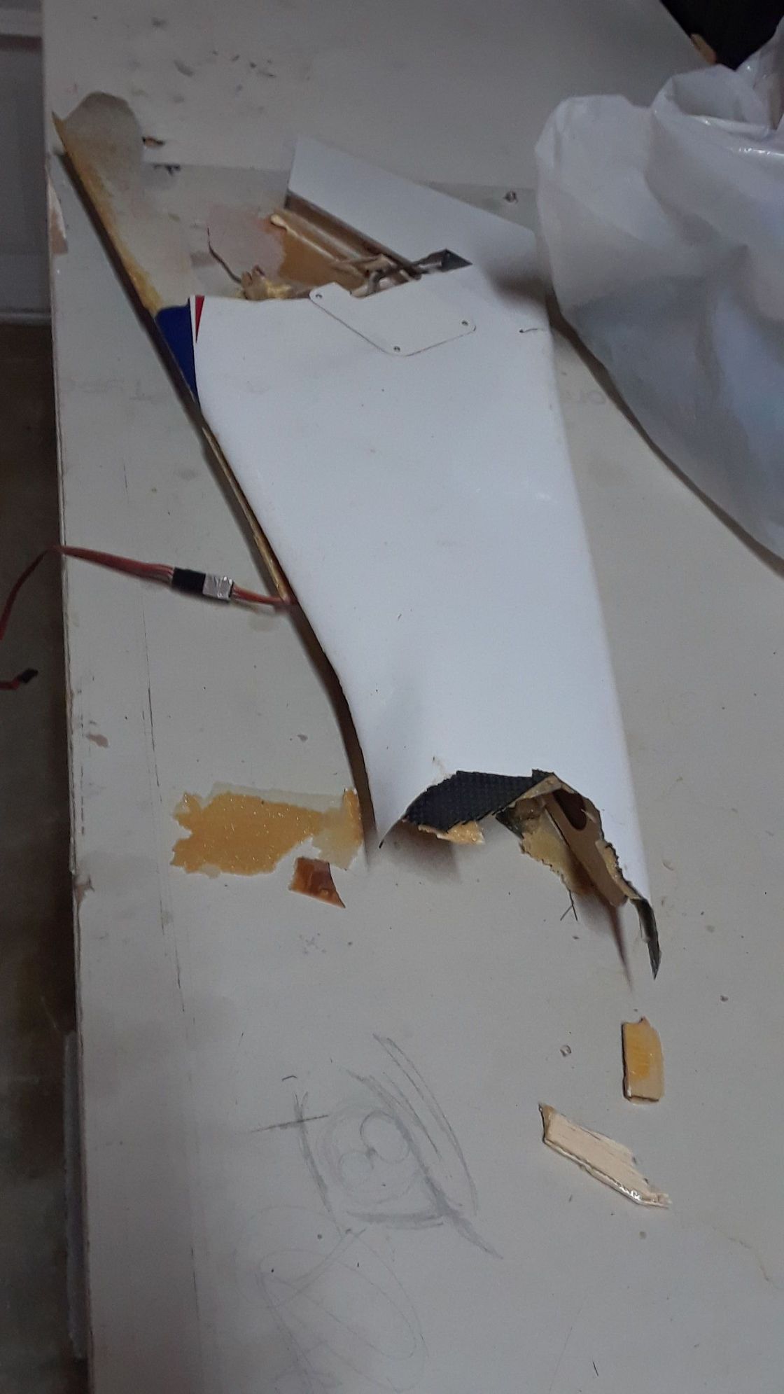

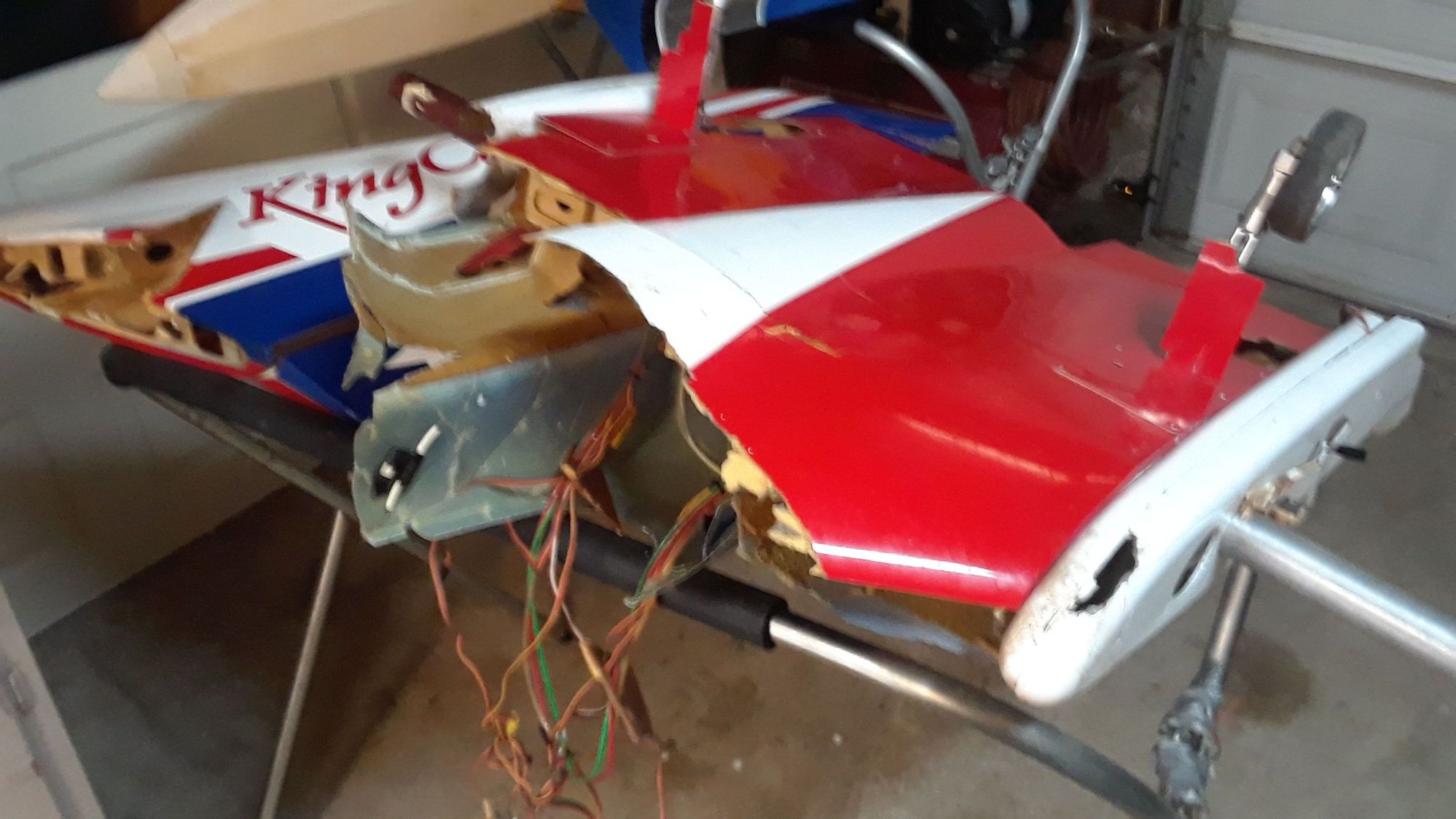

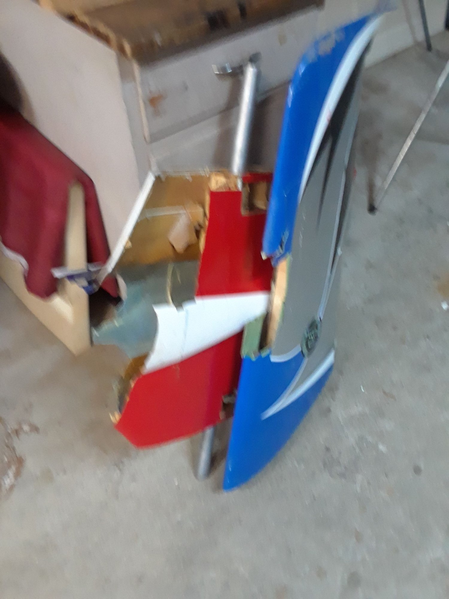

I got most of the broken Cat, took all out, I saw a small piece of the radio tray, it was made out of 1/4" plywood, I suppose I will make a new tray for this one.
The only parts the survived are the right wing with some damage and the HS intact, nothing more.
I also have a T1 left wing, took the electronics out of it.
Any interest on the KC stab and wing or the T1 wing, let me know.
