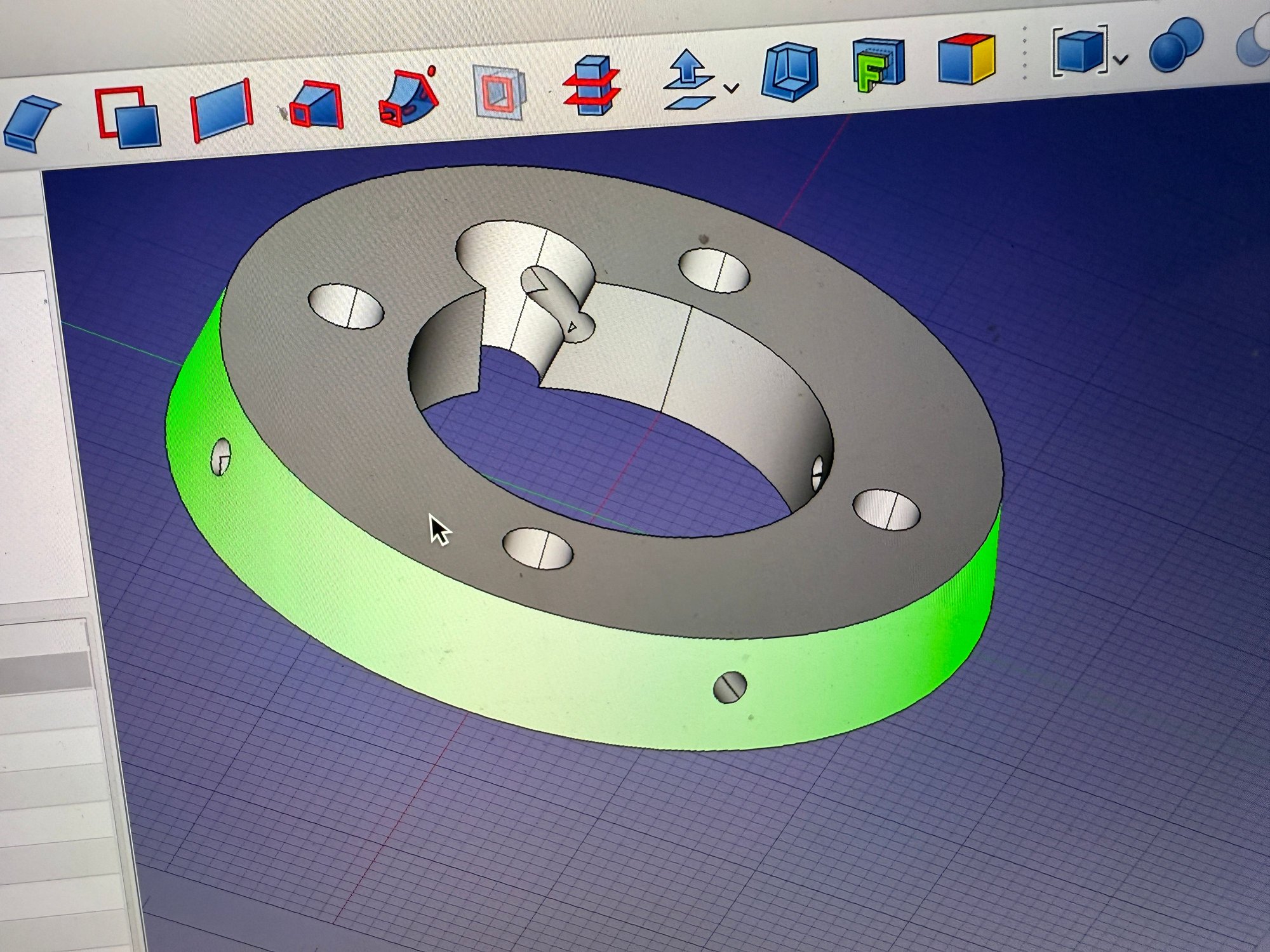

mtwargo 02-20-2025 07:27 AM
Just FYI... My mount for the front light Broke into pieces. I designed and 3d printed a new one becasue the part is not available. So if anyone needs one, please contact me. 321-297-2420
https://cimg0.ibsrv.net/gimg/www.rcu...52256fd9ec.jpg
