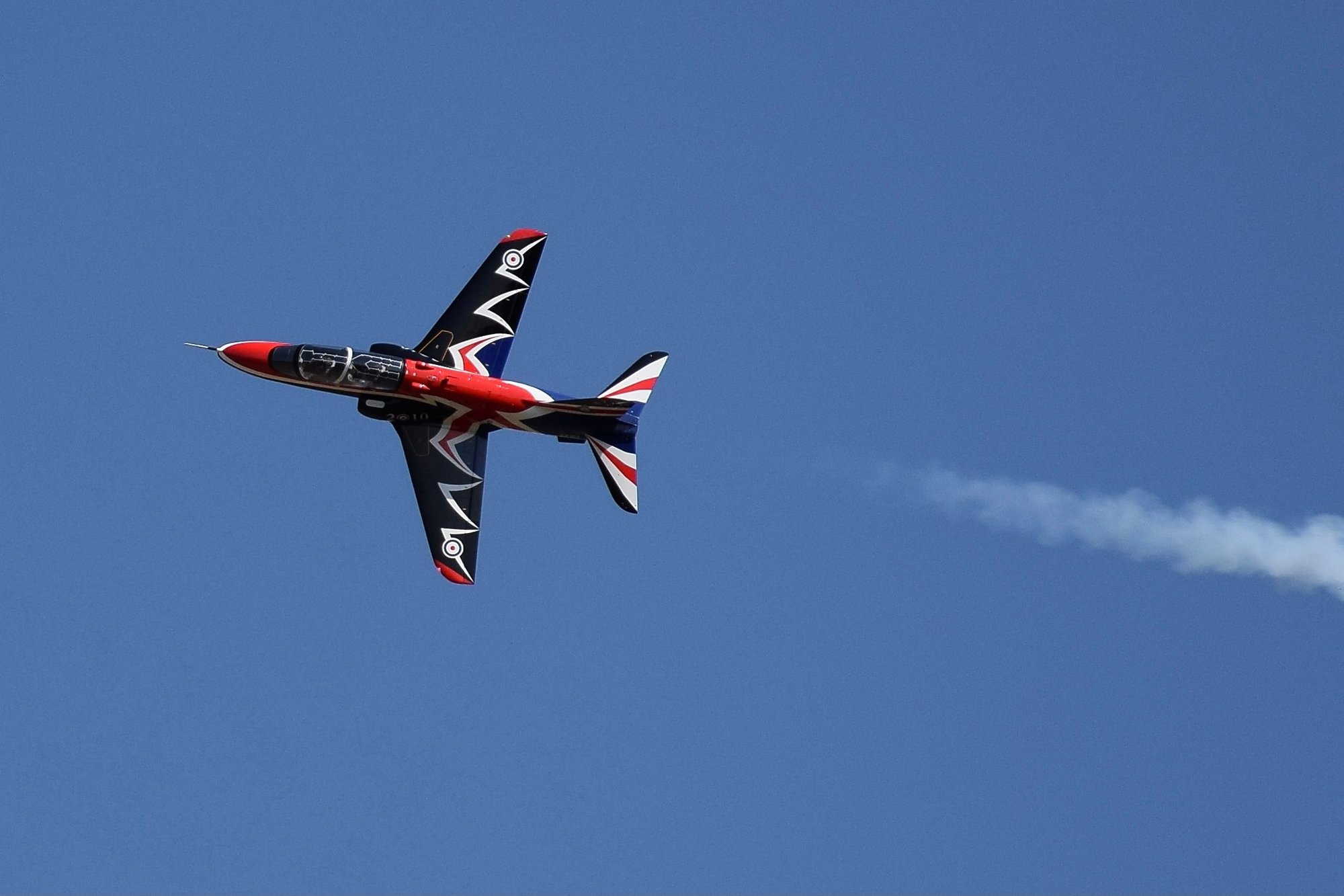

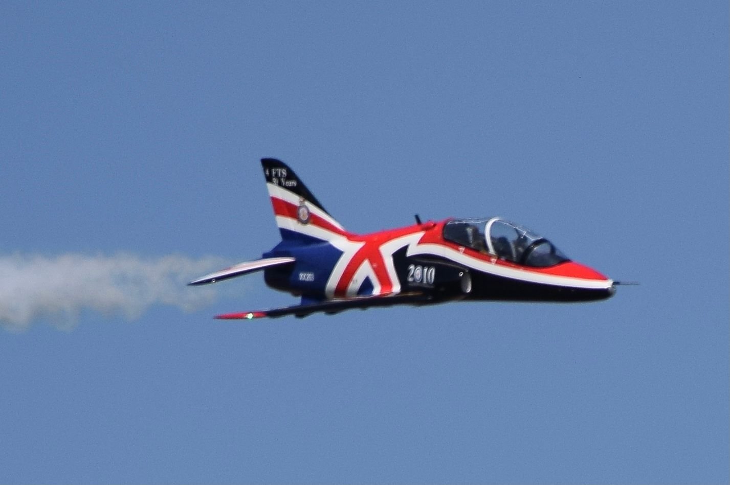

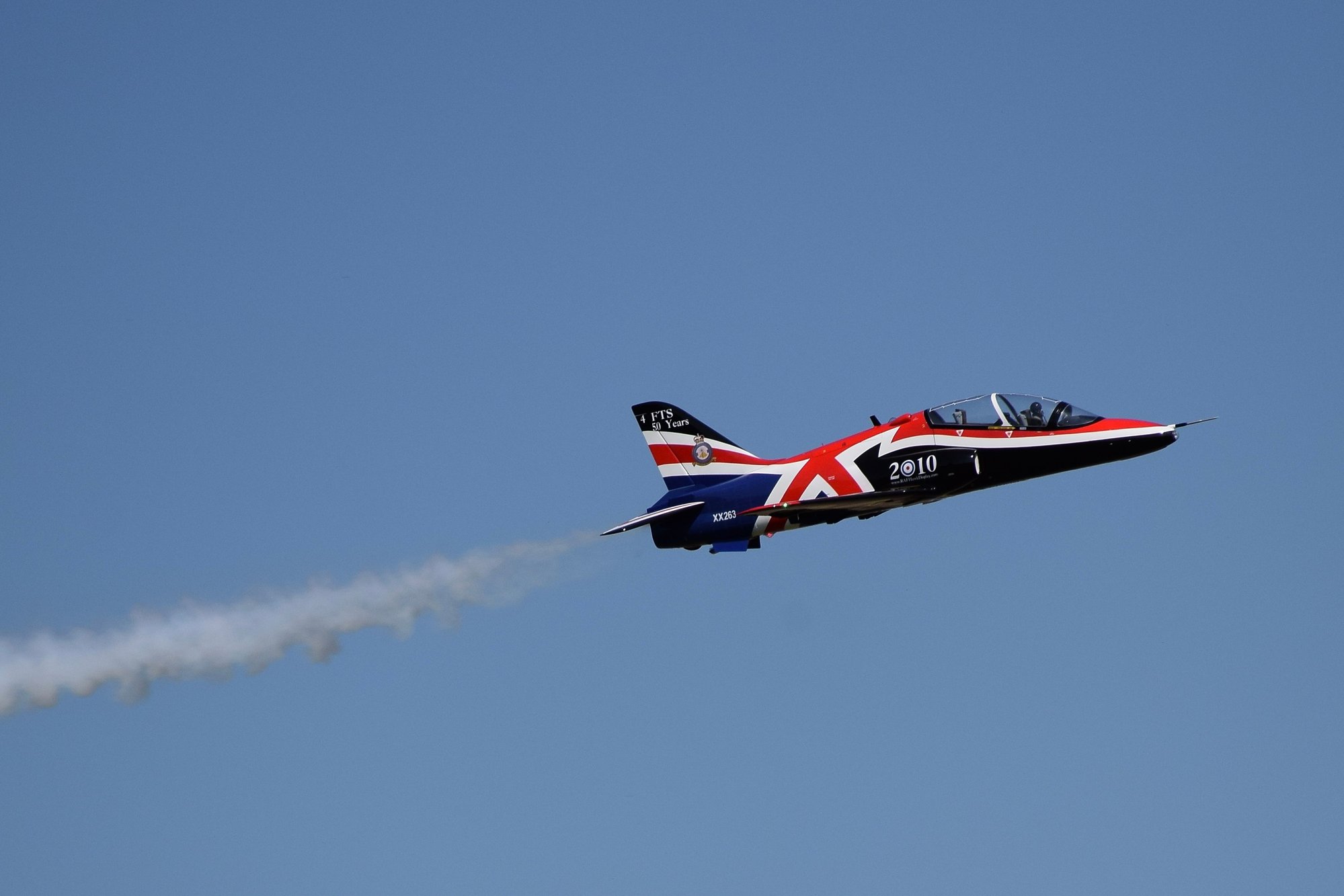

Erik R 01-28-2024 01:53 PM
Dry weight is not an issue. I believe mine had a 160, which pushed it very well. Plenty of room for smoke.

Sparhawk 01-29-2024 08:13 PM
Dry weight is important. In Canada, the basic cert is limited to 25kg, so above that I would need to do another bunch of tests and costs.
Dan
Erik R 01-30-2024 07:45 AM
Ok. It’s nowhere near 25kg.
