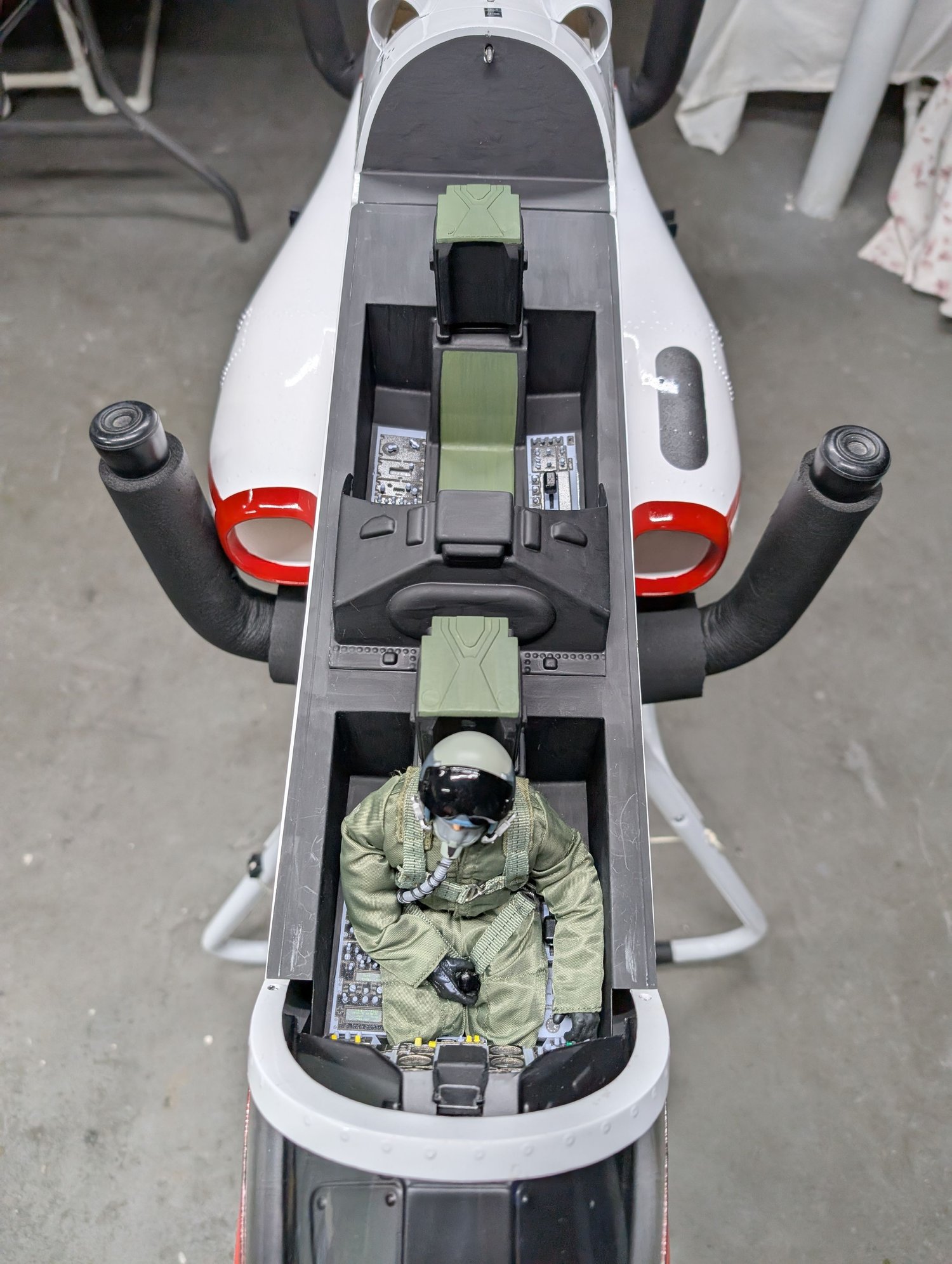

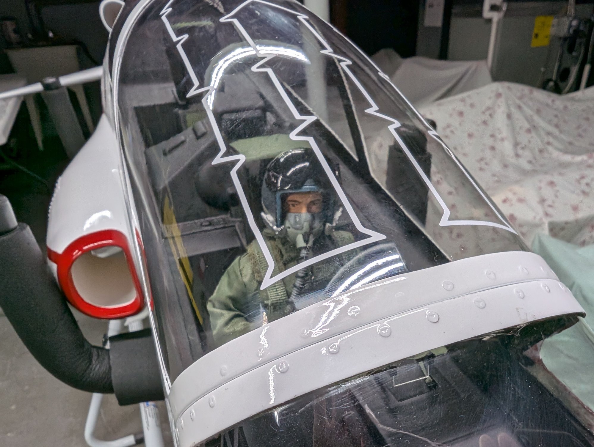

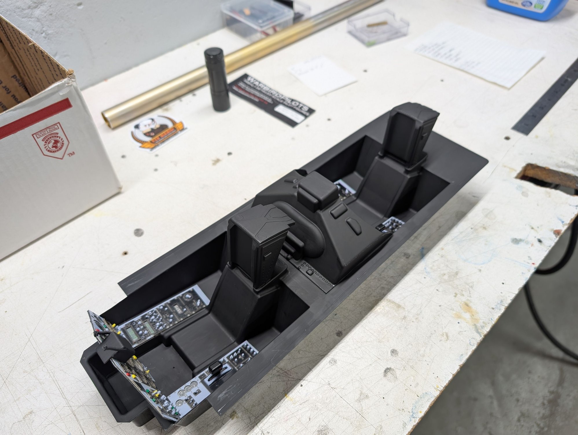

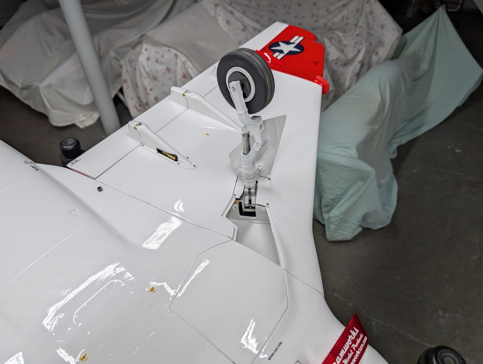

Finishing up my mini hawk and have it balanced at 160 mm back from the leading edge of the wing at the root, gear down, full uat, little over a quarter tank of fuel to represent the landing configuration. I was happy that I only needed to add 2 oz to the nose to get it to balance . When I put the plane on its gear with the canopy and cockpit removed, and has a hard time keeping the nose wheel on the ground and most of the time the tail falls to the ground. I think it has to do with the main gear location relative to the CG. Anybody else experience this and has it been a problem?

Hornetrider 01-02-2025 01:06 AM
Cog
Hi
The COG at 160mm is correct. Unfortunate the front wheel is pretty light with and w/o the canopy and cockpit.
You havemade a very nice and clean build.

MaJ. Woody 01-02-2025 03:19 AM
Hi.
Thank you for the reply! I suspected it was the main gear position but I feel a lot better knowing it's not just my model and that I have the correct CG.
