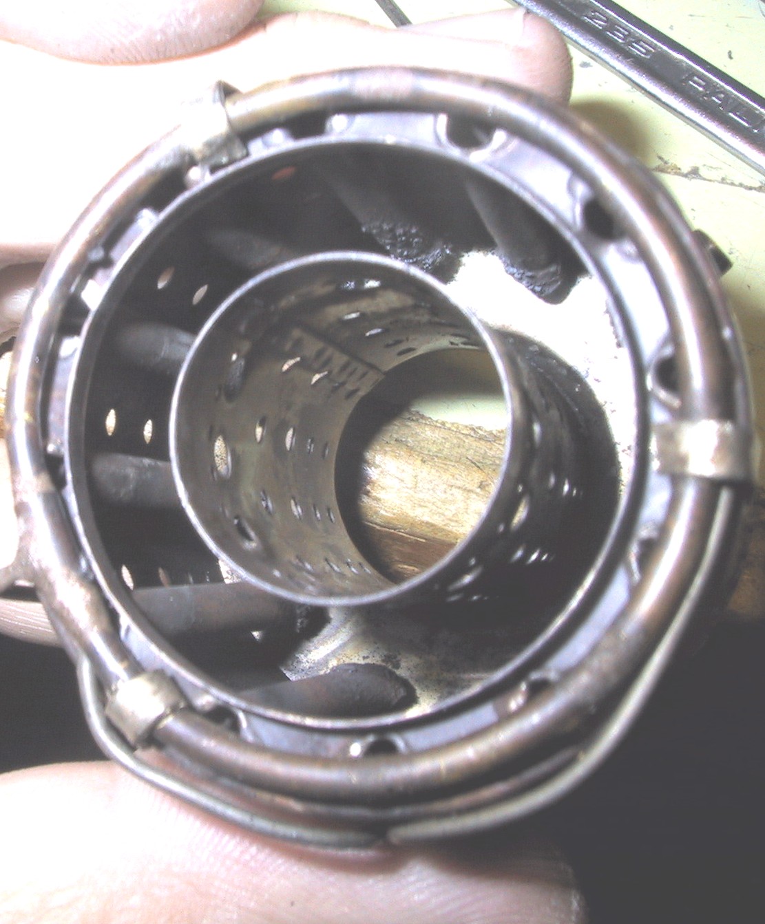

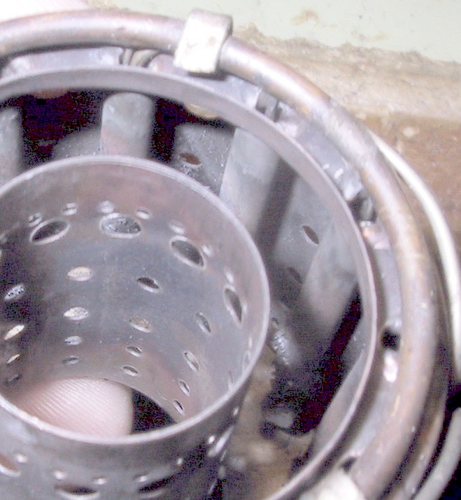

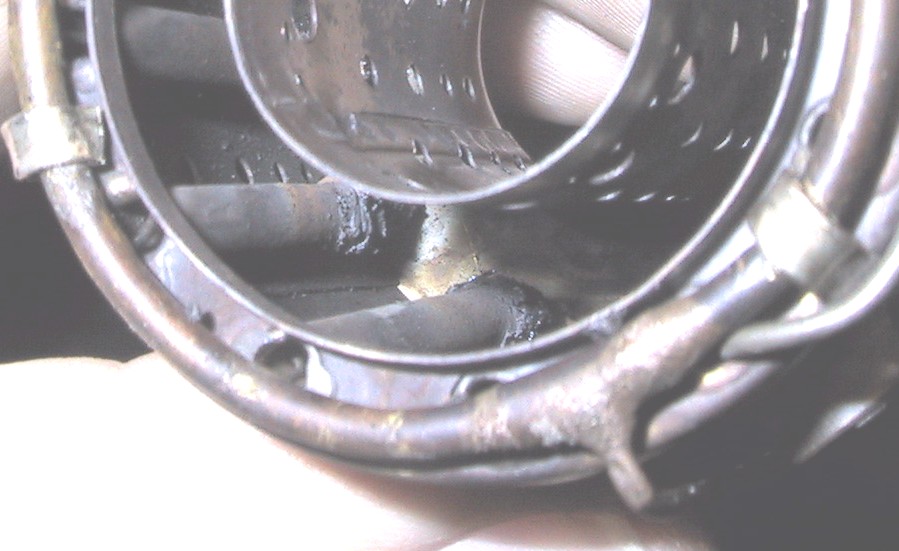

Below some pictures of a JJ combustion chamber. Engine bought around 6 month ago. About 4h of run time. Please explain me how a costumer with a IQ of high level and some fine fettling and setting up can prevent that the metal used in these tubes hold for the time that it is supposed to stay.
http://www.xicoy.com/jjj1.jpg
http://www.xicoy.com/jjj2.jpg

andy boy 11-21-2009 05:18 AM
RE: JetJoe OWNERS thread
  hey gaspar which size engine is the CC from?

A) i dont agree with copying someones work for profit. I didnt realise that Wren owned the MW54 design since plenty of us were building them many years ago before I heard of wren turbines and buying/swapping parts etc. But I already have it now and it was actually aquired in a swap with a Solent Gas Turbine Starter (Plessey Dynamics) and under a different name (rebranded) anyway. At that time I never heard of JJ either!
B) Have no idea why that turbines CC has deteriorated but it could be any number of reasons including not running correctly (too hot) for some time for whatever reason. Or it could be a faulty / inferior material etc in which case I would expect it to be swapped FOC anyway. For what its worth mine looks as good as new apart from not being as nicely made as the wren one from the start. I have a wren one here too. The difference in running quality and temperatures are noticible although minor with the wren one being best. Both work fine though. I have a melted piston from my GSXR1100 here too. Does that mean all suzuki pistons are crap? Or was it caused by a weak mixture? (in this case it was a partly blocked jet). I have seen some melted bits in other engines too... So on its own it doesent really prove anything.

My views have always been that the JJ1400 can be a good little turbine if set up properly, mine has never failed to start or run and has about 50 flights todate in my bobcat.
I have spoke up in the past on this thread saying that the later engines are now made from the proper materials etc and all the past problems were due to faulty components which everyone knows. Also I can only comment on the 1400 which I have personal experience of.
The Combustion chamber shown above does not have inconel vapour tubes, all 1400 are supposed to have had inconel tubes for nearlly 2 years now so maybe this is of a different engine or a earlier model.
