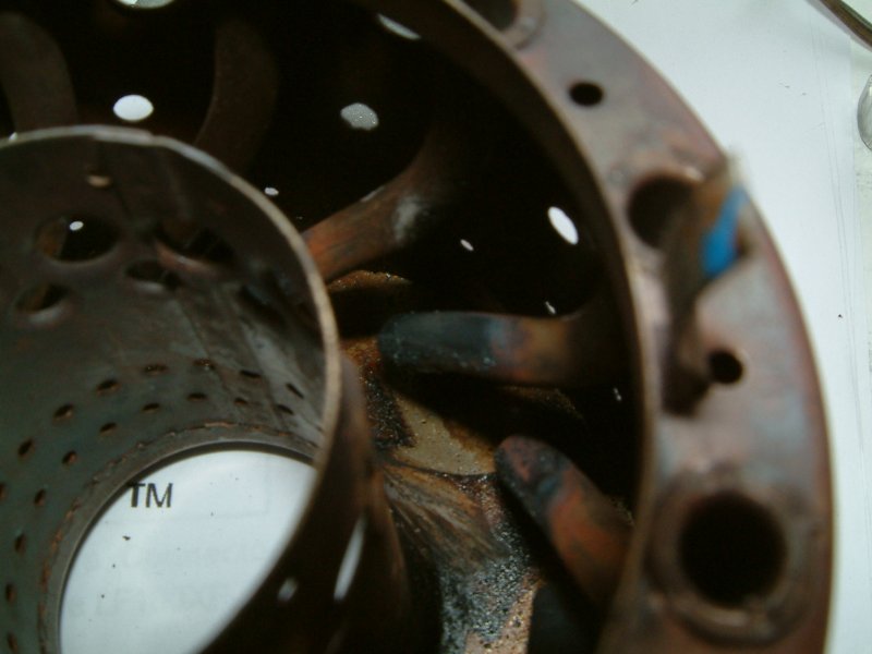

I thought about buying one, does that count?
I got so see one up close last week. It looked good, but it wouldn't run. Lots of fire.
I think alot of the problem was the autostart though.

Sounds like the pump or the battery pack, the original JJ pumps have been known to give problems,Have a look at the power reading on the FADEC,

It was my JJ-1400 at that you saw Shok. Soon as I know what exactly it was I'll post it on the this board. Most likely a failed RPM sensor or the Fadec.

Luis, Talked to Sean last night, your motor is just now getting shipped because he forgot that he didn't have my address.
ET - Yeah either your Battery is discharged or your pump is junk, the chinese pump just dosen't have what it takes, also try putting your pump ramp value around 10.

The RPM sensor is easy enough to diagnose. Spin the turbine with the ECU on and see if it reads RPM.
What exactly is happening? Beware of some of the advice given out, don't do anything just yet.

No you can't adjust pump voltage past the start ramp proceedure. If it more than likey the FADEC on Luis's motor with eratic RPM readouts which will quickly be diagnosed and repaired. With the Stock pump you may have to run a pump ramp as high as 15 for fast startups where the FW pump is around 5.

Hey guys, sorry to just get into the thread but I wasn't going to go public unless someone brought it out first.
Here are my thoughts on the Jet Joe engine I had in Austin.
In my opinion, the engine is good thus far. I think the upgraded fliteworks pump that was sent is good. I'm fairly certain that the RPM sensor that was in the one I ran is NOT GOOD. Easy enough to replace I suppose, but certainly something that I was surprised to see.
I did get the engine to run really good on one run out of about 20 attempts, I ran it up to half throttle and when I brought it down from half it shut off.
I am fairly certain that the problems I had getting it to start were RPM sensor and/ or Fadec related, not the engine. I gave the newly boxed engine to my assistant a couple days ago to send it back and I didn't realize I didn't have an address to send it to, so Justin is sending me the correct address to send it back today to get checked over. I should have it back next week and will run it up next weekend.
Based on my experiance thus far there is no reason not to get one if you have an application for it. It looked and when it ran, ran like any other turbine I've ever run.
Considering that I've had problems with just about every turbine manufacturer for one reason or another, including RAM, Jetcat, and Merlin, I think the problem I had should be easy to overcome.

Seems unusual, that the RPM sensor is bad, but not impossible. I would check that it is mounted properly, and that the magnet in the spinner is mounted as it should be, and try running a magnet around the inside of the intake to degauss it. I had a RAM that would not run until that was done, as it had gone through an airport scanner when it was shipped that changed the magnetism there. If you are running an optical sensor, who knows?
When my Espeill ECU went bad, it was due to a bad solenoid provided by jetjoe. It manifested itself very clearly with a burned out MOSFET. It was no fault whatsoever of the ECU itself. I would tend to think that a solid-state piece of electronics like that is unlikely(but not impossible) to give false readings like yours seems to be doing, I would look at the sensors attached to it first, for sure.
I agree about teething troubles being pretty common with all brands, been there, done that, but I would just as well let that subject drop, lest we have yet ANOTHER one of "those" threads.
What SN is your engine?
My Feedback: (60)
Engine is already boxed up. But as soon as the starter motor engaged, the RPM's would go from 0 to 60 something thousand. Every single time. As far as magnets go, etc. I've bought and owned somewhere close to 10 turbines in the last three years, currently own four. I don't own the Jet Joe engine I ran, it belongs to Luis of this thread. Sent to me to run and provide an opinion. Anyway, in all my turbine experiance, the one thing I've learned is to demand that the engine run as it was advertised to be. While a manufacturer has every right to expect that I will follow written directions and that I am someone knowledgeable of how a turbine engine operates, they do not have the right to expect that I am a "technician" or someone who would be able to diagnose why an engine is not performing as it should.

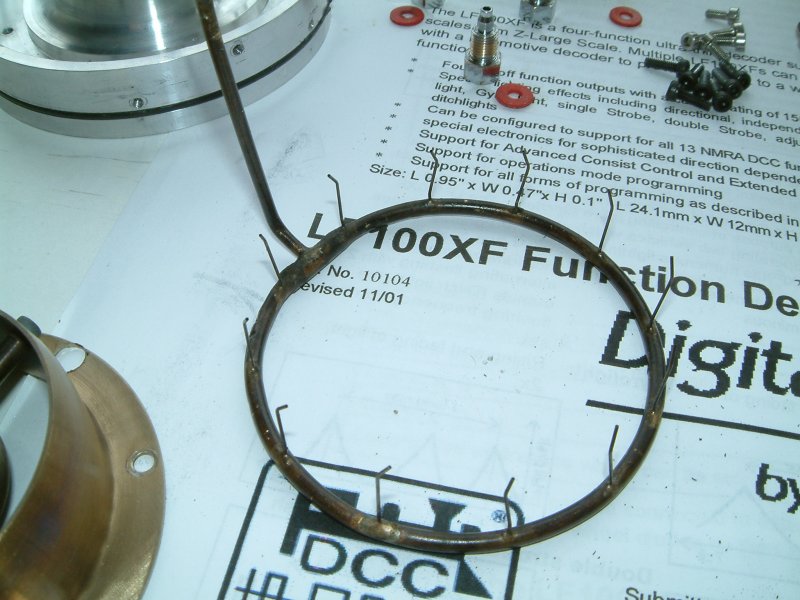

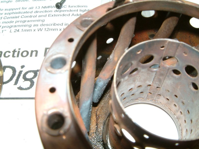

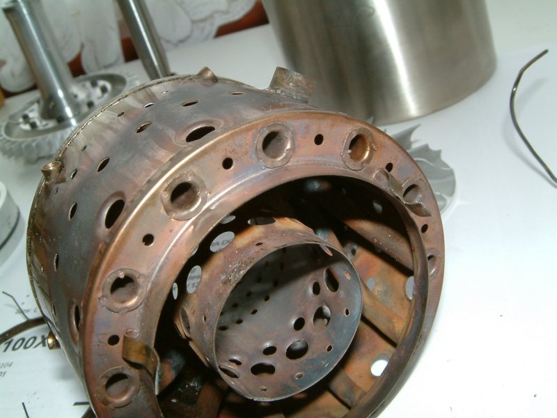

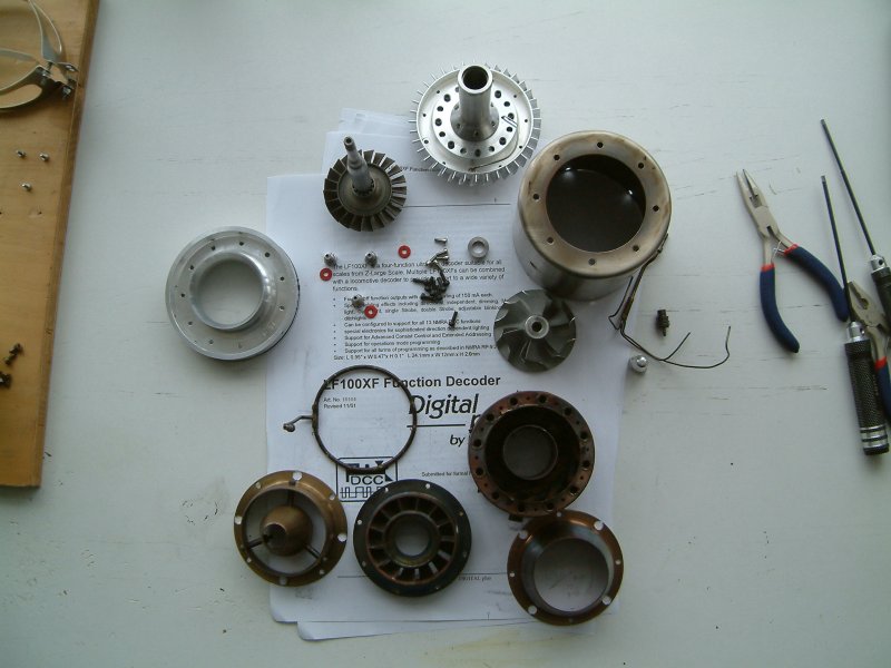

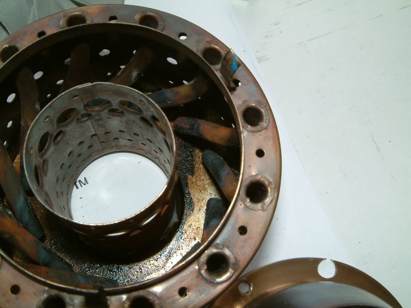

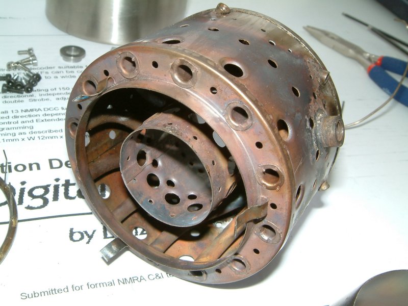

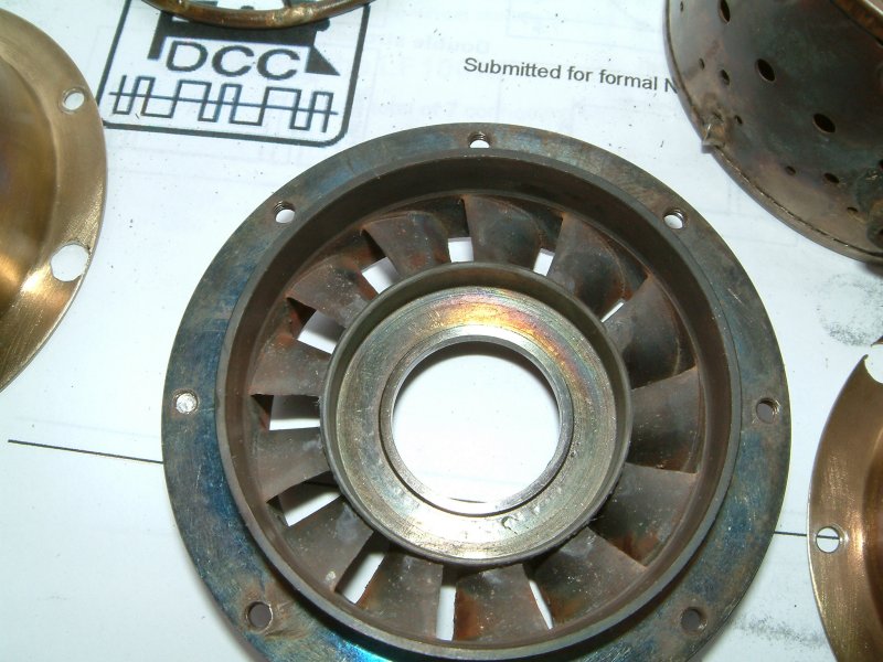

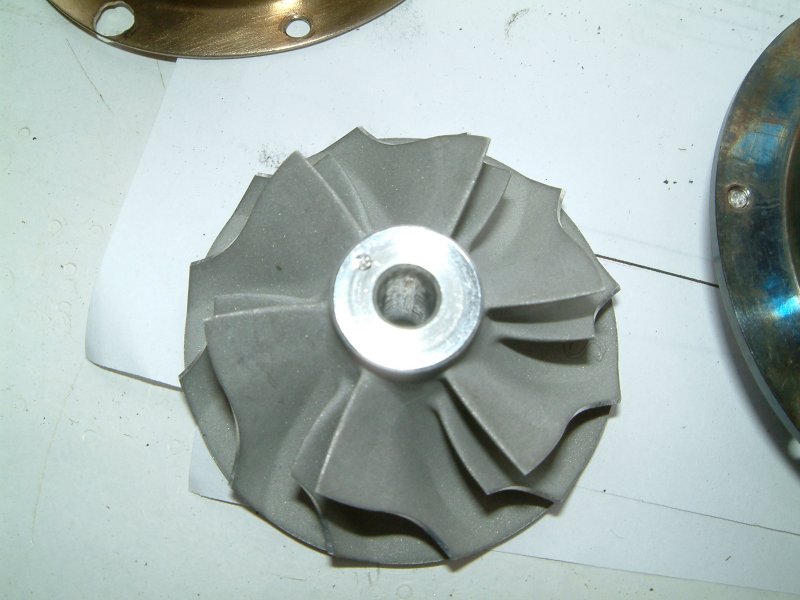

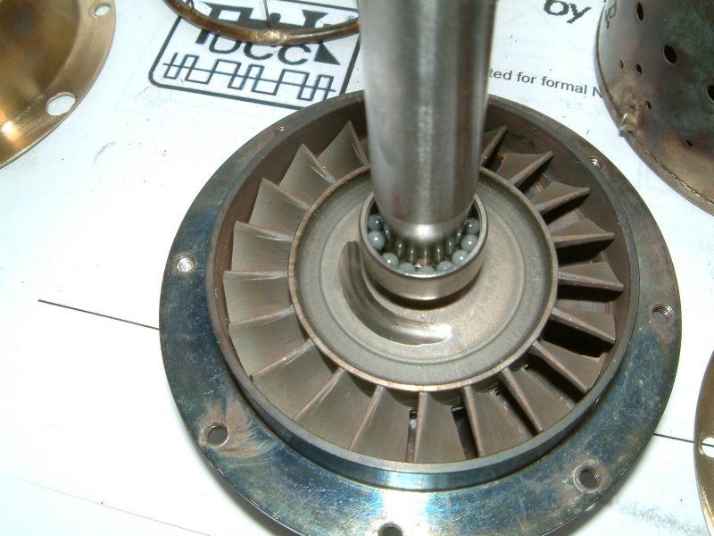

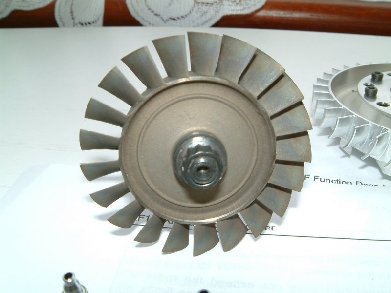

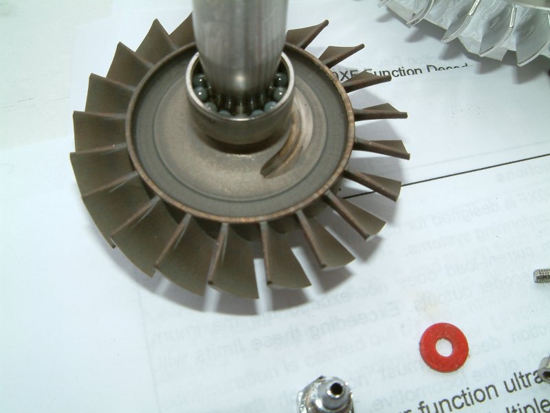

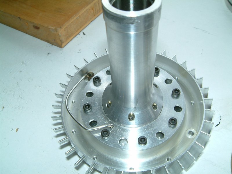

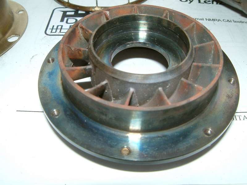

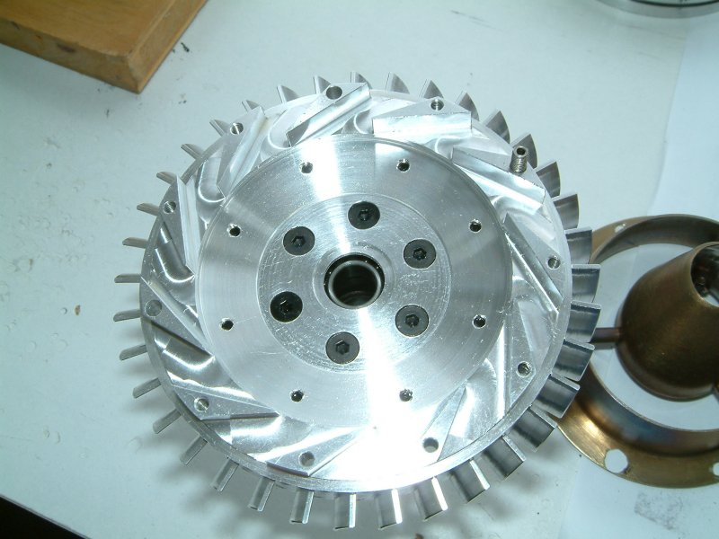

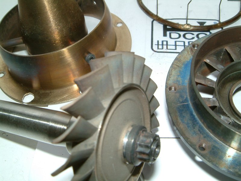

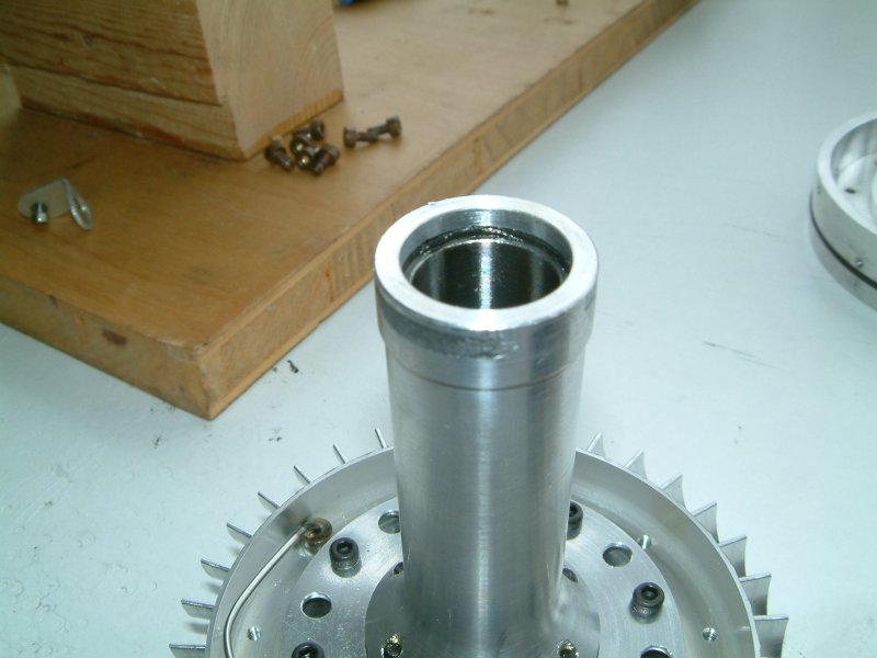

I've had my JJ1400 for a little while now and it has been starting and running really well, I've posted a couple of videos of it starting and running in a previous JJ thread.
Last Sunday I changed to the single piece tail cone and ran the engine for about 4 cycles, the noise is a lot louder than with the two piece tail cone and you can actually feel it in your chest when it is flat out
I had a few problems with it though on the last couple of runs, it seemed to vibrate a bit more and I could see the bendix unwind and touch the spinner very slightly a few times. It also flamed out a couple of times when going from high speed to idle, the error message on the data terminal was "speedlow" even though it was running at idle (50000 RPM) I think (as I was not looking at data terminal at the time). on the last flame out after it had cooled down I checked to see if there were any obvious signs of either the compressor or turbine wheel rubbing, there was not but I did find that the bearing(s) had become stiff as the rotating parts would slow down very quickly when spun by fingers! Total running time so far 56 minutes and 6 cycles.
To investigate the matter I've taken the engine apart to examine if the bearings are the culprit and here are the pictures. By the way the other thing I noticed when using the single piece tail cone is the difference in the PWM needed to drive the pump. 160000 rpm; two piece pwm 400; single piece 280.
When inspecting the bearings I found that the front bearing was in excellent shape but the rear bearing was very sticky like it was gummed up. I cleaned the bearing out in situ and put a drop of lube on it and it was nice a free again no tight spots or any sign of damage.
I am using Jet A1 mixed with 4% synthetic two stroke oil (Castrol TTS) whereas when running with the two piece tail cone I was using 3% castrol TTS. It looks like the oil was gumming up the rear bearing, also the shaft tunnel was a very very tight fit in the NGV and had score mark on it where it was such a tight fit. The other thing I noticed is that the CC is not attached to the diffuser like on the other "turbine" which is why I had a lot of difficulty changing the glow plug as the CC moved once the plug was removed[:'(]

I have never seen that difference between the one piece and two piece cones from the engines that I have ran.
To set the fact straight to motor Sean is referring to is Direct from Joe to Myself then to Luis/Sean.
If the Engine is assembled correctly you will have absolutely no problems in changing the glow plug, Did this engine come from Andy or did you buy it Direct? I would not suggest using 2 Stroke oil however, If you noticed PST will not even warranty a motor that has been ran on 2 stroke oil. I run 5% oil here on all my Jet Joes and my original engine that I received is past the 350 minute mark and still ticking along.
I have Talked to Gasper in the past and you can "Degauss" the RPM Sensor all you want but FADEC version doesn't require it nor will it work any good on it.
The Issue on the engine with Sean/Luis can be a couple of different things with the electronics but we won't know for sure until it reaches my door step so we can evaluate the situation.
Greg,
Your problem with the low speed error and the engine shutting down on decel could very possibly be the Deceleration Delay being to low, try increasing this value a couple of marks and give it another go.
Greg,
