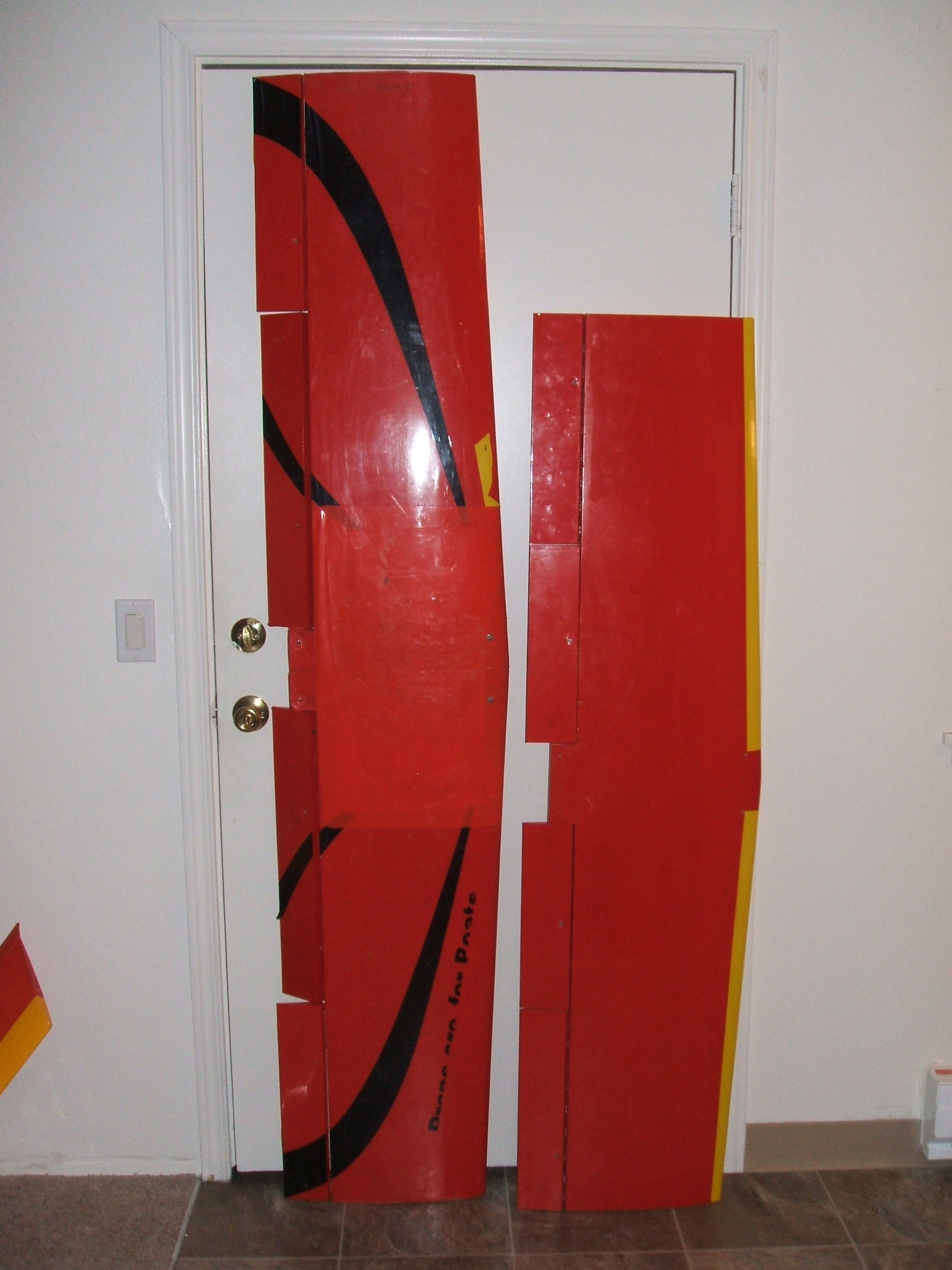

Just glass the hell out of the wing joint and you'll be fine. I flog mine fairly hard and it's still solid as a rock. When I glassed mine, I had already stripped the wing for the clipping. It was brand new. The first layer was 6" wide. The second layer was 12" wide, the third was 18". The ARF's were covered with Ultracote, so they're easy to match.
rcguy59 12-07-2015 07:02 AM
1 Attachment(s)
Here's the stock and clipped wings side by side.
http://www.rcuniverse.com/forum/atta...mentid=2134614
VF84sluggo 12-07-2015 08:17 AM
^^^^ WOW!!! No doubt much 'sportier' in roll. How much did you lose as far as slow flight and increased approach speed?
rcguy59 12-07-2015 08:41 AM
Slow flight and crawling around the pattern are fine. The approach speed is noticeably higher, but that's a relative thing with a SJ. Landing speed is still lower than a lot of sport-type prop jobs. Our runway is 300 by 40 feet of asphalt and is still plenty. On grass, rollout is 25 feet and you never touch the brake. The primitive scrub brake included with the ARF is more than adequate on asphalt. As you are about to touch down, keep pulling up elevator and hold it even after touchdown. Centering the elevator at touchdown can result in a nasty hopping that's hard to stop once it starts, especially if you touch down a little fast. I have a 101oz. tank in mine and can get 15 min. flights with ease.
