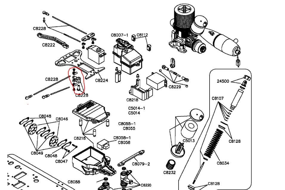

Still no photos, but I'm talking about this part, nr C8228;
Maybe someone knows some engines which are really direct replacement? I've seen a couple of guys on google who put some big blocks as LRP .28 and axial .32, but pix and even more infos are quite hard to find.. This truck is really fun to drive, pretty torquey even with the .26's, can't imagine with some .32's..
Thanks!
