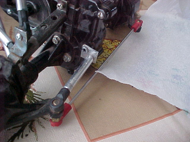

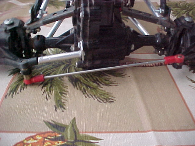

gotta problem, i have a juggernaut 2 with espps juggular conversion, that i just received in trade, i dont want to spend money to just lock the rear steering, so is there any way i dould diy it? and if so is has anyone found an easy way to do it that i dont have to spend money on it im just a kid and i dont get paid til monday, and i wanna drive it so lemme know

Well iyou wil ahve to spend around $2 to lock it buy some threaded tube (like used on the links) aand a small piece of sheet metal.
Here is a picture of a diy on my clod.

i got it worked out, all i did was take the two screws on each steering knuckle out, remove the bushings, and re tighten the screws works perfect, and it is incredibly hard to get it to slip anywhere, but if it does all i have to do is push on the wheels hard to straighten em out
