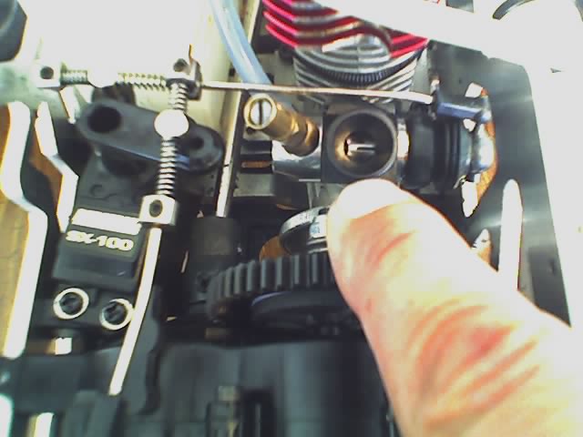

So I tried it 2WD, and now I cant get the darn thing to idle, I start it at 1/4 throttle and let it warm for 30 sec and then take of the plug, wait, then put it and idle, and dead. Any suggestions?
Old 04-03-2006 | 01:21 PM
Joined: Jan 2006
Posts: 643
From: daytona, FL
Default RE: 2WD Warhead
Just put my new pro-line`s on have-nt run it yet...I will this evening....has far as your idle goes...check the slide barrel make sure ya got about 1mm of opening...see pic
mekong....its your glowplug probably. You need a new one
