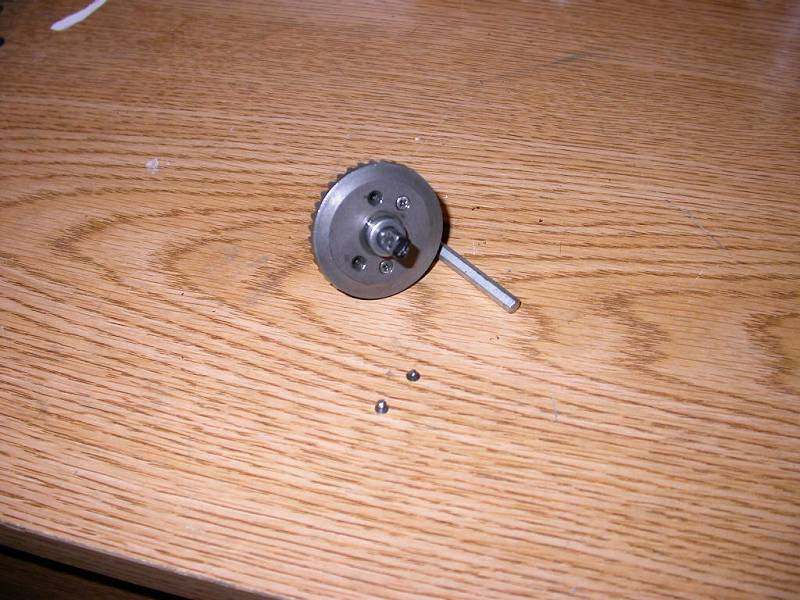

hey all, for exposure, im gonna put this here too. i need these screws? they are for my RRP ( i think its an RRP metal diff part ) Diffs and there are 4 small screws that go into the ring gear and hold the diff cup to the ring gear. check the pic. screw is about 2mm in diameter and maybe 4 mm long with a counter sunk head. Any help locating these would be VERY appreciated.

Just a suggestion and I hope it will help you. Could you try your local hobby shop if you have one and maybe compare hardware? Sorry to sound ignorant and stupid, but what is a rrp? is it a monster truck? If you can find the thread pitch and diameter, and length, there are good chances you can find a match. Try going to tower hobbies and looking up some different monster trucks and there parts list tower gives pretty good descriptions and parts breakdowns.

Ok measure the outside diameter or width of the thread portion, if its 2mm then yes its a 2mm screw.
To measure the length measure from the top of the countersunk part all the way to the end of the thread thats the total length you need.
What is this for? If it's not metric, the fun really begins.

it is to hold the Diff cup to the ring gear in a set of Robinson Raceing Metal Gear Differentials for my T-Maxx. i think it is 2mm, but the length is going to be hard to figure. the ONE of 4 that i have that gets threads is only making one or so turns in b4 its tight. i think it may be wore/broke off, my lhs thinks they are 8mm screws so if they are, i need to replace them all.. appreciat the measureing info, knew about the width but didnt know the head was included into the length.. good info to have... thanx

update. Dug into the orig diffs, found the remainder of the bolt. They are 8mm long. when both pieces are put together...thanx for all you input..
