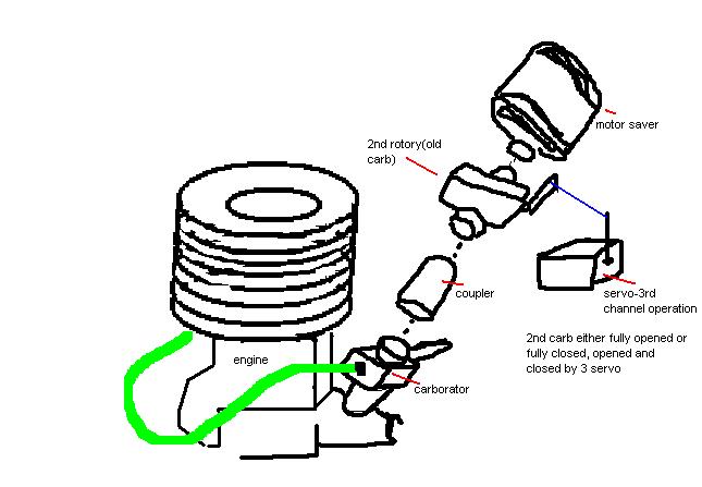

If you are inventive and not into racing you might try something like this....
