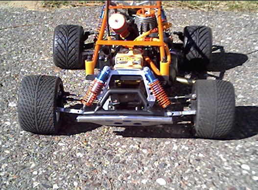

My wife keeps asking is it done yet ? but she knows me, Baby it aint ever gonna be done'' !!!
Any hoo---- heres my Rusty so far .
from this to this

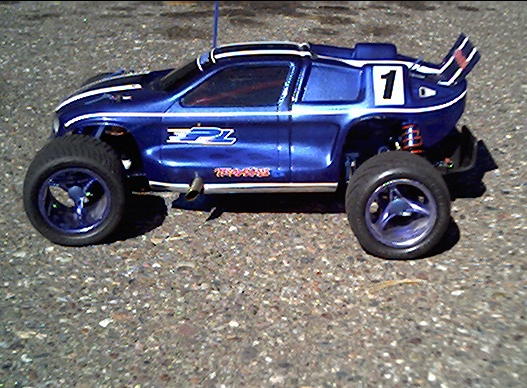

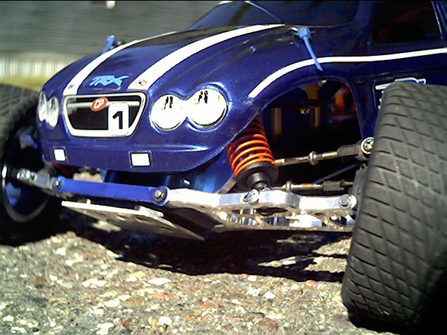

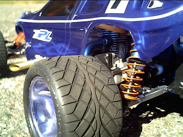

Heres some more with the body on
There is still alot to do like a pipe and a cooling head of corse more aluminum goodies and such !!!
Let me know what you think and beam us some pics of your Rustys

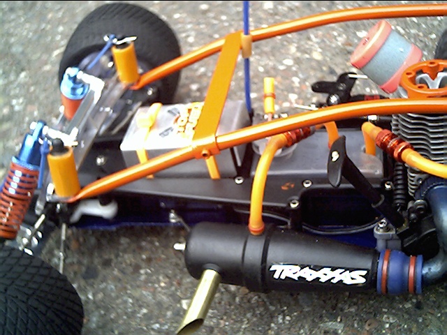

is that with the roll cage? what did you use to make it? details please

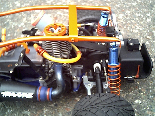

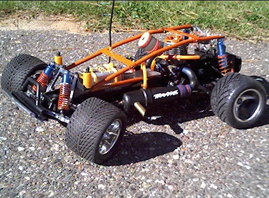

Yeah I made the roll gage .
The first one I made was of aluminum tube but I found it to be way to wimpy. I folded it up pertty good on a little roll over.
Sooooo I made this one of brass tube, it semms to be alot tougher.
I flatend out the ends of the tube about 1/2 inch on the ends and then drilled holes in those ends to mount to the bottom of
the front body mounts and to the rear shock tower where the shock mounts.
cross braces are 1/2 in. brass strap.

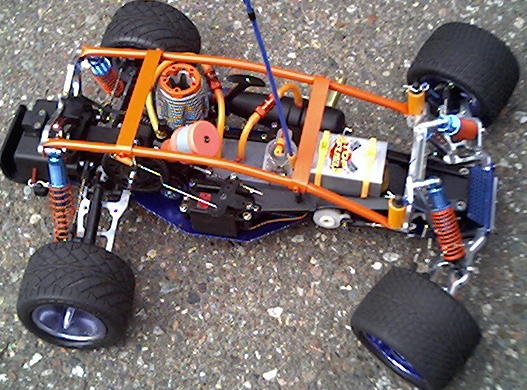

Nice truck ,take the shell off so we can get a better look at the rest of the truck, RED

more with out the shell !!!

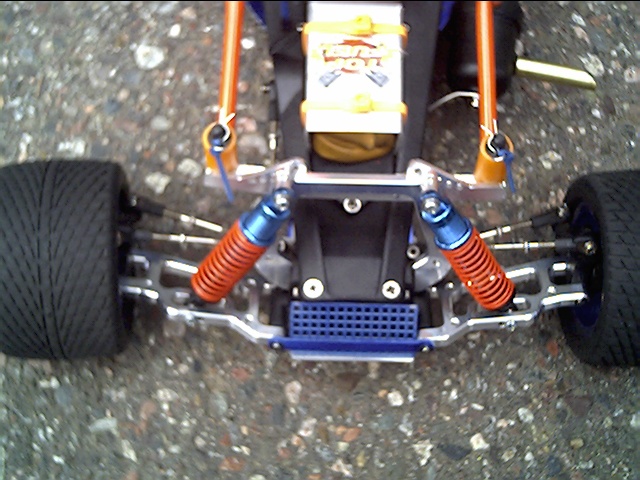

That thing looks awesome. U know wut u should do though, make the plastic part on top of the aluminum chassie look nicer. The black is kinda dulling i up. lol, still looks good like that though.

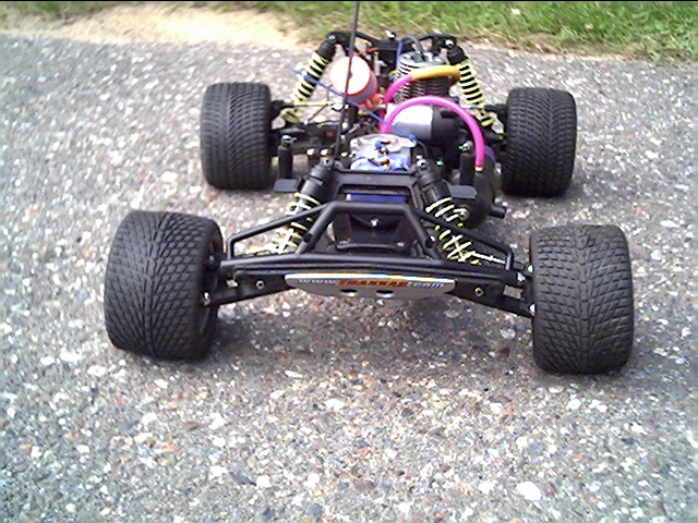

one flaw......
Your rear wheels dip in like a mother! (in 1st pic with no body or rollcage!) or is it just me?
