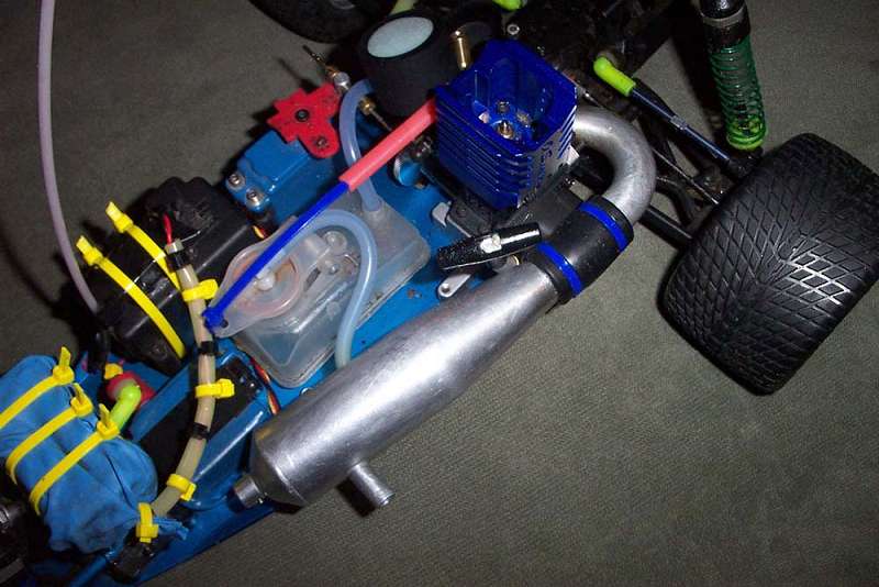

i have an RC10GT and im wondering how you other guys refuel with out taking the cover off?

Ahhh simple answer to that! You can take a Zip tie and put it on the fuel top lid, should be a hole. then put on the body and stick the zip-tie out the back of the truck and WALLA! [8D]

Heres a quick pick:

This is how we do that
Cut a 2" circle out of your windshield or side window so you can reach it with fuel bottle.
Put a long zip tie on your tank lid run it out the back window pull to open tank.
Hope this helps.

i run my zip tie out the side of the window. i goit big holes

ICrashThings,
My fuel tank doesn't have that little hole. How do I get the zip tie on it now?

ORIGINAL: youngspeed
ICrashThings,
can i see a pic? cause all the tanks have atleast 1 hole on taht lid on the very tip...

ICrashThings,
I'll have to get you the picture tomorrow due to the fact that it's not mine. But, the lid just has a solid lip and is a little curved. This link should lead you to an article review that shows a pic.

o yea u have a x-c, yea those things you most likely need to drill your own hole in them. Sorry. []

No, you don't have to drill a hole in the handle just zip the ziptie around the handle of the lid and dremel a hole in the side of the body for the tie to stick out ofthen make sure the other side has a hole and stick your fuel bottle nozzle through that hole...I have a XXX-NT and mine's exactly like that and it works.
