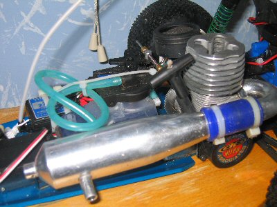

i put the megatech Q-series 1.6 engine in my rc10gt. i love the engine it is very strong and the price isnt much eaither.

maybe im loosing it but that engine looks alot like the DTX .18. is it the same cooling head or am i loosing it?

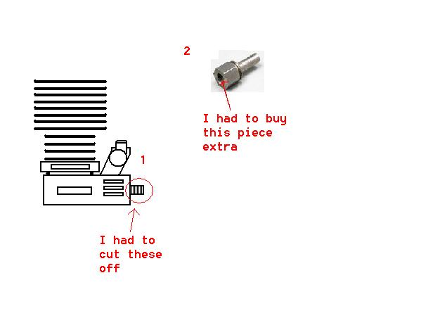

umm i think i had to cut the shaft so the flywheel can be screwed all the way down. i took off acouple of threads. and the engine cost around $119
#1 i had to cut threads to make the clutch nut tighten down on the flywheel.
#2 i had to buy a new clutch nut so my clutch bell can go on the engine.
the picture said i had to cut these off but i didnt cut all the threads off i only cut acouple off.

is that hard to do??? its not that hard... right?

its not hard at all. are you talking about my engine if so no i am positive that it is a megatech if you still dont belive me i can post pictures of the box.

no. see what happened was i screwed the clutch nut on tightened it down started the engine and gave it throttle and then i looked at the fly wheel and it was loose. i took it off and pulled out the trusty black and decker wizard rotary tool and cut acouple threads off it wasnt hard take off like 1 or 2 threads if it is close dont take a lot off to little it better then to much. it took me 2 or 3 times
