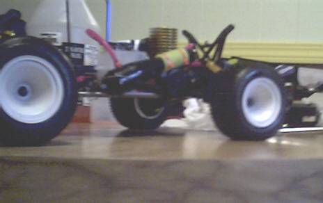

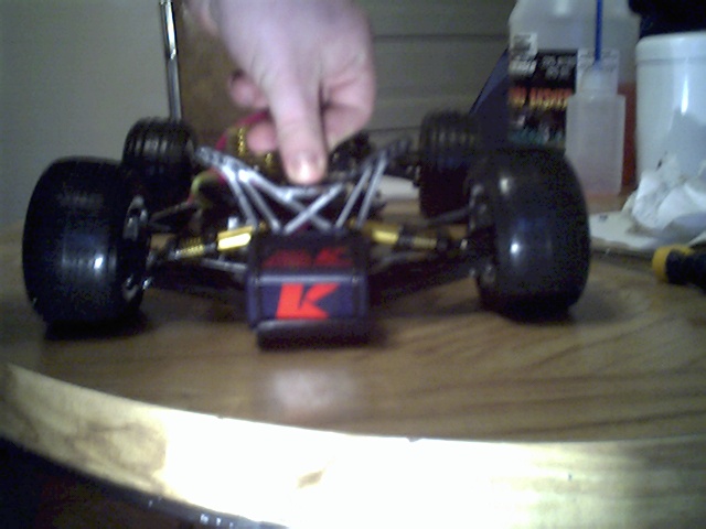

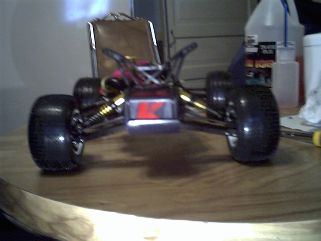

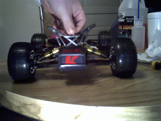

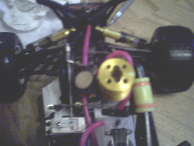

This is my customized suspention (the pic speaks for itself) i hooked up the shock right to the rear bulk head[sm=punching.gif] and now i have a lil more then 2 inches of clearance and more shock travel take a look and tell me what you think and if you have any questions feel free to ask!!

i dunt see how the shocks would work, when u push don on the truck the it pushs up on the shocks, but knowit dosnt have nothing to puch up

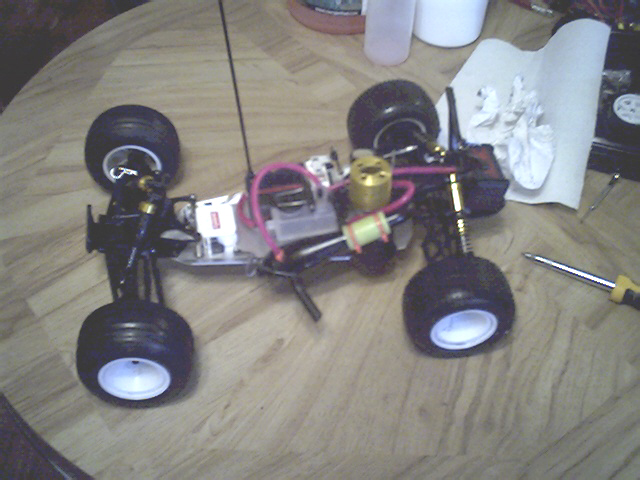

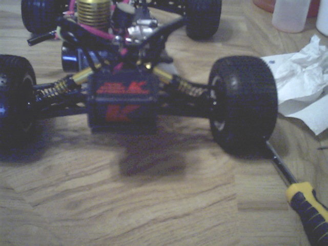

Thats because they pivot and there for boost the ride hight and give you more travel> It works alot like the traxxas revo suspention.try it on your truck it makes a big difference!

it doesnt look to good and now your shock towers are unbraced at the top just getting ready to break off...teh shocks help brace them at the top...so a little hit on them and i wouldnt be surprised ur next thread i broke my shock tower cuz my shocks suck
and if it botoms out liek in the picture that isnt too good for jumps

If you plan on running off road, you may not want to run it that way. For dirt oval it would be okay, but your rear end is going to be very stiff...

Even if i do break my rear shock tower it is not needed any more! Just try it just for a bit it works 10 times better and it isnt tight at all the more parralel the shocks are to the tire the more leverage and therefore easyer and better shock travel, Oh and when it bottoms out how would it be any different then if the shocks were set up normally??? just try it you will like the results plus u get about 1/2 inch or more of ride hight this is almost identical to the revo shock set up just the revo they are mounted the opposite way[&:]

Ok you get that extra 1/2 inch or whatever but you loose most of the stiffness of the shocks unless you fill with heavier shock oil and get stonger springs
Shock towers getting weaker? ROFL!!! Attaching the shocks to the towers does NOT make them stronger!! If you hit the shock tower you hit the shock tower and it breaks if it is to weak. It just looks weaker because it is "out there" with nothing connected to it.

I tried it it works pretty good, but In order to get the same stiffness, I had to
switch from 30 to 45 oil, and next leval springs. I dont do any raceing, just
bashin, so I cant give a "GOOD" answer on if its "BETTER"...

Don't you want your axles to be as close to parallel to the ground as possible?

O.M.G. & tee-hee[sm=bananahead.gif] Have fun putting in new CVD"s in all the time . You'll see tryed it , done it , stupid , Will not EVER do it again

I've set my shocks on their farthest in setting on the towers and they do not work efficiently at all. Suspension will come down and not want to pop back up. Can't even imagine how it'd be with them sitting basically parallel to the ground.

2. By raising the center of gravity, you are degrading your handling, this is not debateable. Another degredation comes from effectively bring the rear wheels "in", thus narrowing the rear footprint.
