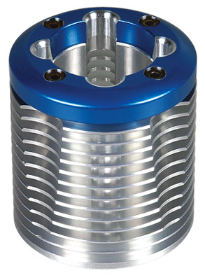

Of these two heads, which one proforms the best. (DuraTrax Stage II Performance Head Blue DTX 18) or (Golden Horizons Aluminum Cooling Head Nitro Evader).

The stage 2 one... it increases compression and cooling, while the golden horizon one just offers better cooling but i believe does nothing to help compression.

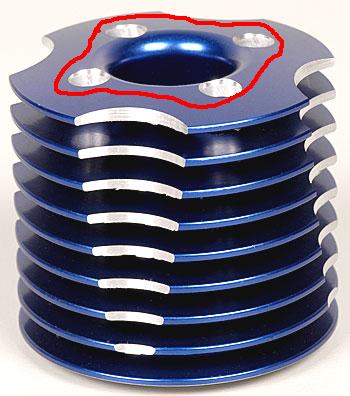

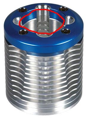

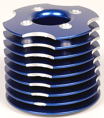

i mean GH isnt a bad head but stage 2 is i think half the price and it hase more compressions ill get pic and show you why there is more cooling VS stock
ok as you can see GH has a taller fin set witch can be good and bad less clerence you would have to cut a hole in top of bod to get clearince more fins = more surface area more coling but if you live in cold place you want less fins so heat can stay in cuse ABC's need a strict running temp
now the stage 2 has maby 1 2 fins not that much of a problim
has more compression= more HP and it has more surface area but if you live in cold still not a good thing cuse of a bove
yes there are things you can do like cut 2 3 fins and call it your winter head and have a GH as a summer head
or get some insulating to help keep it wormer
o ya the red on the stage 2 head(blue) shows how much of a gane than stock
GH has more fins but same surface ariea at top as the stock one hope that helps
ps there same $$$$ sory
