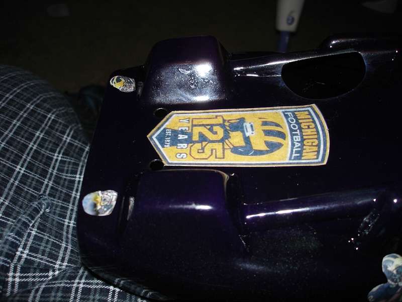

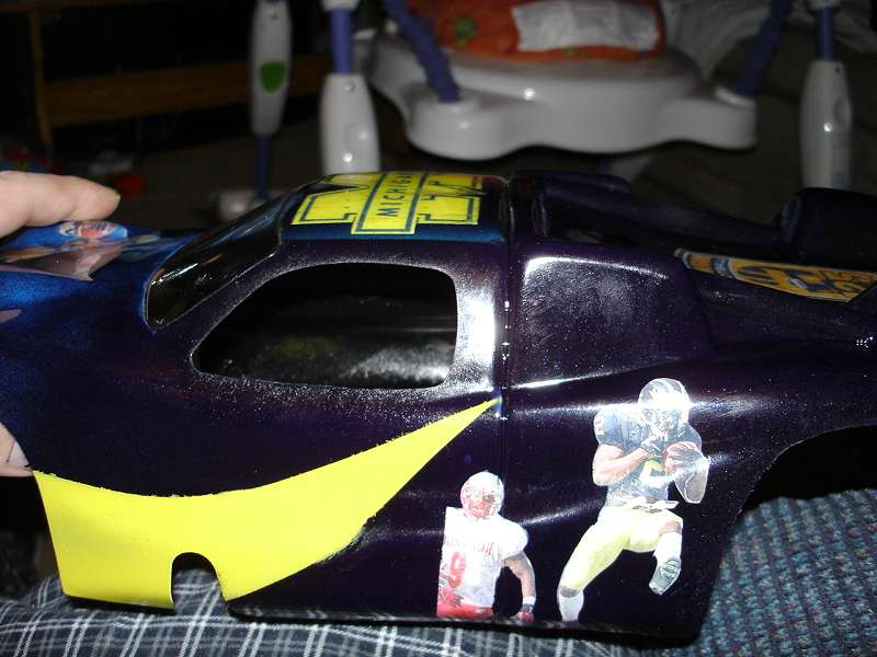

here is one i did today for my brother

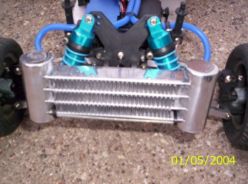

Yea there have been many topics on liquid cooling and turbocharging, BUT i did it and its fully functional. Talk is cheap, just do it.

So tell me, were you really having such bad cooling problems with your air cooled engine, that you needed to fabricate, and add all that weight to your RC?
And not only does forced air induction not work in two stroke engines, but a "turbocharger" would interfere with the exhaust. Even having a longer header effects the performance of your truck(not necessarily in a bad way, but none the less..). Even if it is a real turbine that you are using for your "turbocharger", the amount of power it would take to propel it would be too restrictive for our engines. My bet is that your "turbocharger decreases performance, while your radiator adds alot of weight to your truck.

Yeah, you brag about all your performance... look at your air filter buddy. Extremely restrictive for a "turbo" application such as yours.

Well to explain a few things im running an airplane fuel pump to help force enough fuel when the turbo hits boost. And the turbo's exhaust compressor is ported large and smooth for full flow and yet enough to spin the wheel at a sufficiant rpm to make power. Had a problem at first, not enough blades on the exhaust wheel, so it didnt hit boost till the end of the motors rpm's. So i added 2 more blades and that cured that problem. And yea your half right about the boost blowing right through the motor and out the exhaust when the pistons down but when it comes back up i snag at least an estimated 45% out of a 100% plus the insane amounts of fuel im dumping at the same time create the extra hp i was hoping to get out of the project. And the reason for the liquid cooling is because i figured that since i was going to ram some air into this motor that i might get a rapid change in head temps so i stopped that problem dead in its tracks with the liquid cooled idea. And after all said and done didnt even notice the measly amount of so called weight that i added to my truck.

Ok, that did clear up a few things... That might accually work [&:]
