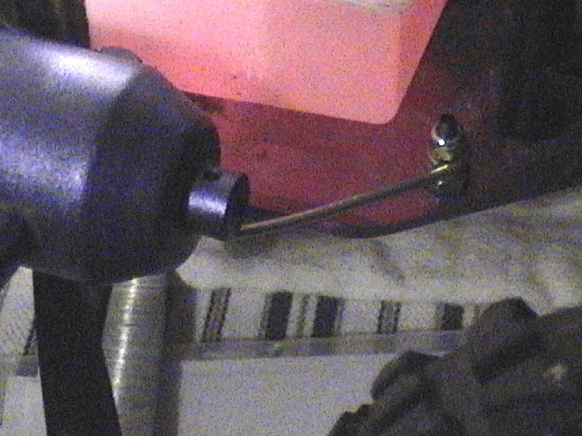

As for your noise, there is one part that will really increase the noise, and the performance at the same time! It isn't a hard install, and if you decide to get it, I'll walk you through installing it. Here's a link: [link=http://www2.towerhobbies.com/cgi-bin/wti0001p?&I=LXSP47&P=RF]click here[/link]. You may also need [link=http://www2.towerhobbies.com/cgi-bin/wti0001p?&I=LXDDU1&P=RF]this[/link] and I think [link=http://www2.towerhobbies.com/cgi-bin/wti0001p?&I=LX2476&P=7]this[/link] will work to hold the pipe on. I don't know what kind of screw head it has (Philips head, flat head, allen screw), so make sure you have an assortment of all of these before you try that. Here's a picture of how I have mine set up, I have a screw through the chassis, a bolt that doesn't fit the screw (too large) under to boost the height of the hanger wire, and then the hanger wire is set on top of that, and then a nut that does fit the screw is securely tightened on top of that. I also had to saw off part of the hanger wire using a Dremel tool (if you don't have one of these yet, I strongly recommend getting one; they are VERY handy) and bend it using some needle-nose pliars and a vice. It wasn't hard at all to do, just make sure you don't cut it too short. But I saw a great performance increase and it was relatively inexpensive, and also a lot louder too. It is definitely louder than a weed-eater now. Much louder!
If you need any more help, just ask! I'll be happy to as will everyone else on this forum.
