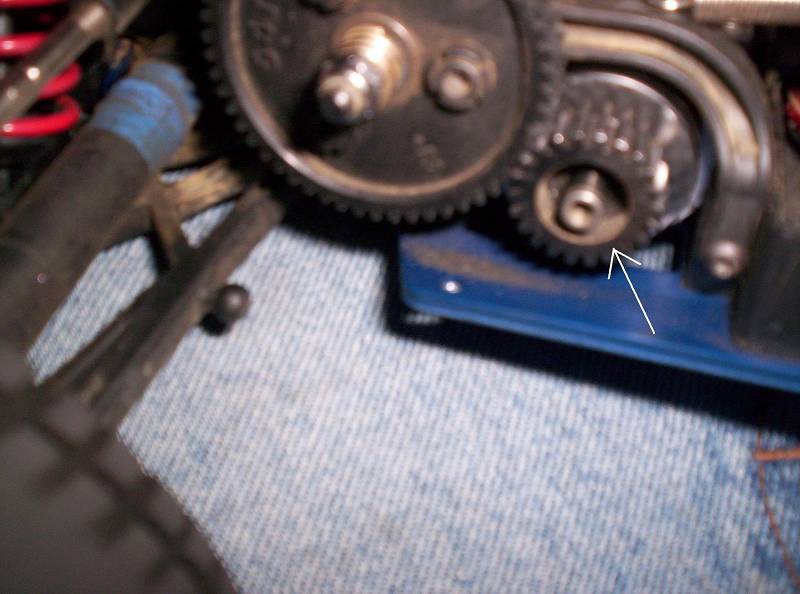

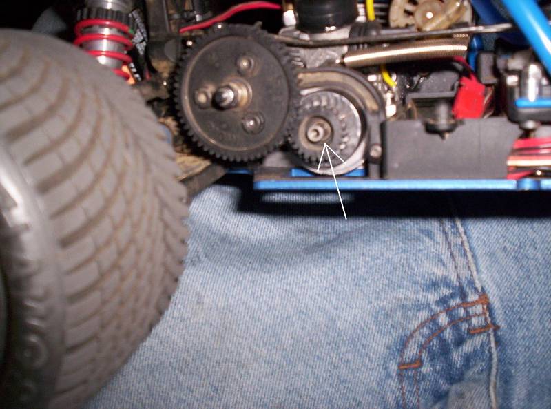

finally got everything going today...broke in my new engine and everything went well except I lost the e-clip off the clutch bell and something that goes in there as well(see pics. I didnt notice it until i got home so i ran it for a while...what
caused this and did it hurt my engine at all? What do i need to order? All in all it went well, if you just bashing definitely take a look at the .18 tm by O.S. i def recommend it...thanks alot guys

Your missing the clutch bell bearing(s), washer and screw. Happened because the vibrations from the motor backed the screw out, happened to me once. Buy new stuff and use threadlock on the screw. Doubt it messed anything up but might as well check on your clutch shoes.

It wasn't a screw that backed out, it would be something called a E-Clip

Yeah you lost your bearings and eclip...it's like a 3mm eclip...bearings almost all standard 10mm's...your lhs should have all the parts to get it up and going again...just pull clutch bell and take a peek at clutch make sure it looks alright before ya reassemble it....

Is that a TZ engine? Most trucks have a screw and not an E clip. Some where on this form I read a person had a really hot motor and could not keep the E clip on and they had some sort of a fix for it. Being I have screws in all of mine I do not remember what the remedy was.

i used an extra wheel bearing i had and it fit...the question is can it handle the load?
