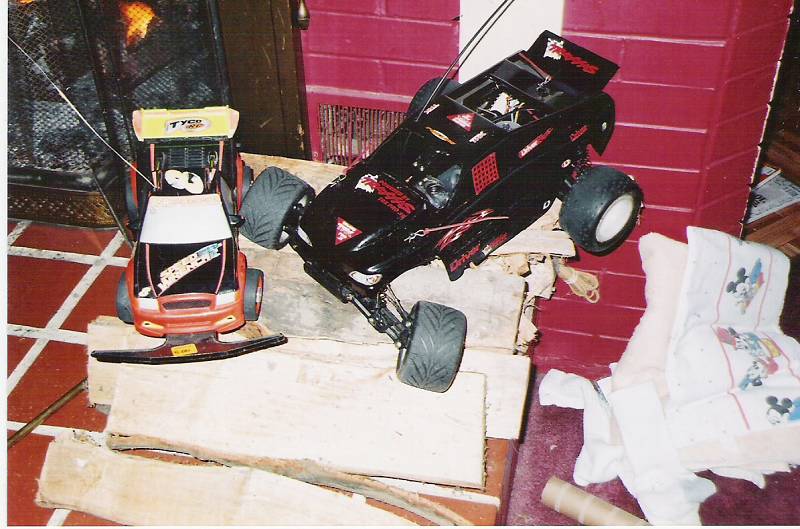

my question is why my diff yokes keep on loosening and slipping off of the diff.

i have no idea. but i broke my nylon ones and went to hardened steel. i guess the steel ones dont fit on the same as the nylon ones. is your allen screw thing all the way in?

yes ive been tightening them constantly.i also have the hardend steel.

yeah i had no problem with the nylon ones. just yesterday they loosened. the screw they include with the steel ones doesnt go through all the way like the nylon one does. and you cant use the old screw because its too small.i think i might actually go back to nylon (not really)

LOTS of licktite, or maybe a zap with the welder...

i tried lots of loctite but that didnt help. and the welding idea... no,i would rather solder them

i fixed em!i used some screws from my pullstart(i have the ez start now) and they dont come loose! ha!who would of guessed?

all right i'm gonna try them. if they come undone again. i got fed up so a put a bunch of epoxy on it and it hasnt come off yet. so i'll see
