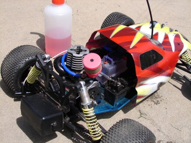

can i put lst2 shocks on this car

Depends on where you want to put them. They are almost as big as your truck.
Seriously, I don't think you would gain anything because you would have to raise the shock towers so much or restrict the travel of the Losi shock so much it would not be worth it, not to mention that you would have to space off the shock tower so much due to the increased thickness of the shock it would not line up on the arm.

The springs would be too stiff, even if you found light springs for the LST shocks. The LST shocks are designed for ALOT more weight.

The lst shocks are way to big to ever fit or function properly on the evader.
