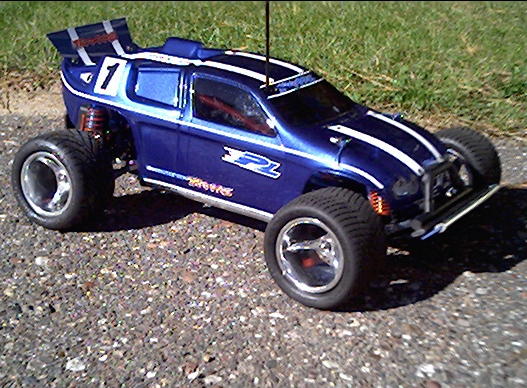

HELLLPP !!! Why dose my engine kill when I put on the brakes ? I tryed to adjust the link rod but I'm not doing something right . So I give up , how do I fix it ? Thank guys to all that help.

OOOOH -TAY !! I got it now. It was the one on the throttel arm I had to turn it almost all the in thou. That seems a bit weird [:-]
I took it out today and it ran like a scaled dog. Not to bad for a rebuilt engine. Just a bit of regearing and putting on my street meats amd all is well in my little world again. Thanks guys for the help
