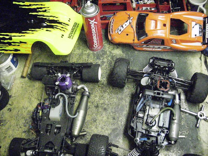

Say hello to Buggy wheels and tires...more options,more stable and more MPH!!!!

that is sick!!! what parts did you use to mount them up? I would love to know.

in another forum we are guessing he used these:
http://www.neweramodels.com/item.cgi?part_id=3244

ding ding ding......

Default RE: JATO tire problems solved....
sweet! how do you like them? Do the fronts spinn real smooth? After Nitro Maddness down at RCP next weekend I think I will take my Jato with the 3.3 and set it up totaly for street racing. May be try a few of the mods you have on your truck... I have an extra .21 sitting there waiting for me to give it a try...

you can try to make some, but you will end up spending more than the 35 bux....the new era kit is already to go....and it works very well....the fit is top notch and the fronts spin freely...

TO PUT FOAM TIRES ON THE JATO GO GET A SET OF FOAM TIRES FOR THE RC 10 GT AND 10 MM OUTER &5MM INNER DIAMITER BEARINGS AND A 5MM &10MM DRILL BIT THEY WILL FIT WITH OUT BUYING ANY EXTRA PARTS. YOU WILL HAVE TO GET THE FRONT ONES CUT SO THEY FIT BUT IT STILL LOOKS GOOD[&:]

http://img504.imageshack.us/img504/6518/jato1ve5.jpg
Search for foam tubes. Use Traxxaas rims. Cut inside ridge off. Mount with adhesive and go.
