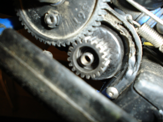

definately fix those brakes. replace that stupid spring with equal length fuel line

I have a new Jato 3.3...... How does that Brake job work? Did you have to put in a stronger servo? does it make a big difference? My factory brakes are pretty sluggish

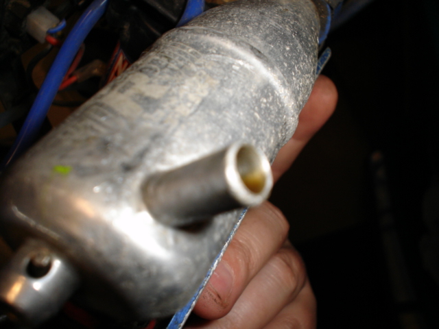

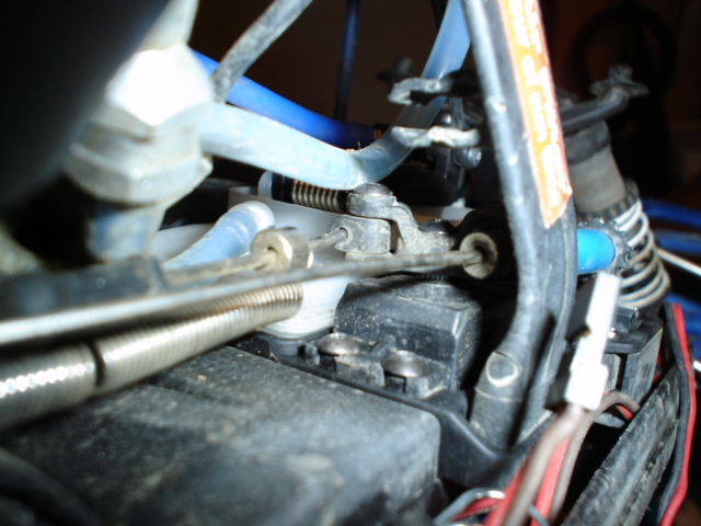

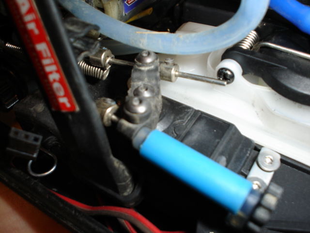

for the brake thing, take off the spring and replace with a piece of fuel line. take a papermate pen and cut it about a 1/16 shorter than the fuel line and install over the fuel line.(alittle spit helps). take a dont know what they call it, but its a like a collar with a lock screw. I found mine in the airplane section. put that on the brake rod behind the servo horn, so that when you hit the gas, it releases the brakes all the way see pictures. also I drilled out my stinger. retuned it, and has more top end. just drill it so that there is still astinger there.
also notice my missing clutch beaing. dont know when it happened. prolly 4 tanks ago. oh well

I put the air line over my spring and left just a little play~ It works great! I can actualy lock up the brakes if I give it full brake! It is awsome!!!!!! Make syre that you all go to the Official Jato thread, there are like 90 pages of info !!!!!!!!!

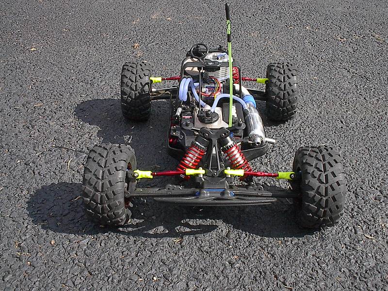

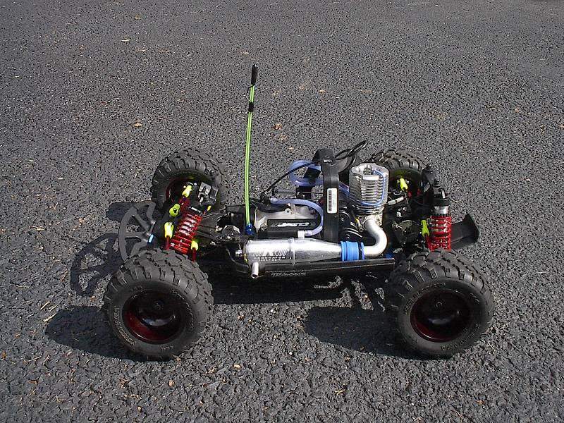

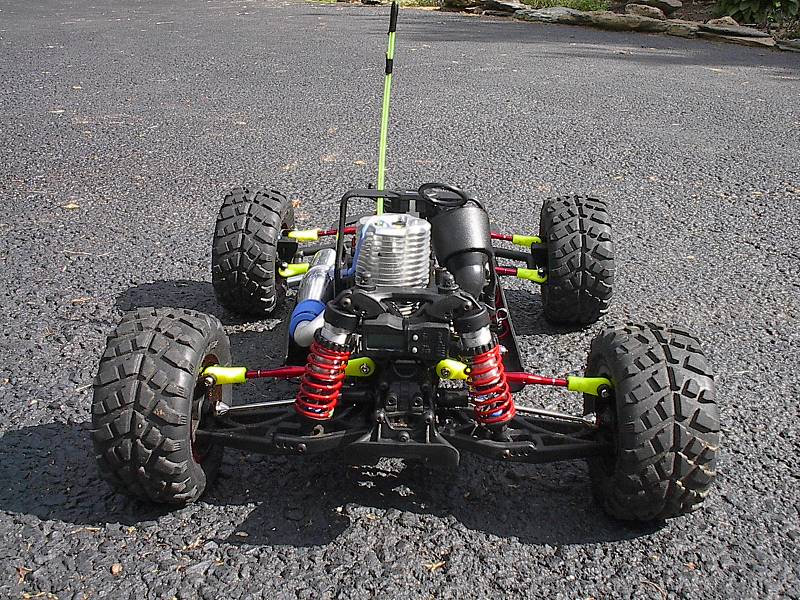

Mods,
built for dirt track
2.5r moded
center mount battery
Revo aluminum body shocks w/ Jato valving
single speed conversion
rpm arms
rpm wide front bumper
chassis brace
2.2 black dish wheels w/ yokohama geolanders
traxxas single chamber resonator
mip cvd's
titanium turnbuckles
high torque steering servo
