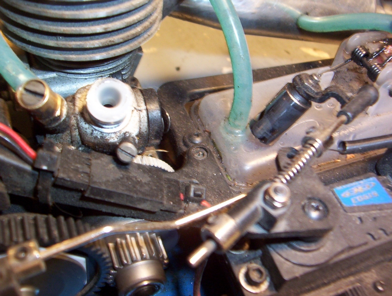

ok, so I was driving my gt2 rs around in the backyard and I hit a small rock wall at about 5mph and the car goes full throttle, so, i shut it off and took it inside and the carburetur ( sorry can't spell) is pretty messed up. so- do I need a new carb or what? please help, thanks[8D]

just clean out your engine. You will find a screw like piece on the end of the carb piece that fell out, just screw it back in. Also before you put it back in, put the spring over that piece that fell out

take out the white piece while your at it
