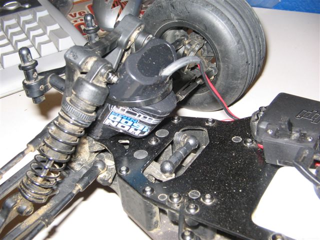

I put a hump pack on the front shock tower and now when I turn sharp on of the back tires lifts up. What should I do to keep the tires down? Should I add some weight to the back?

put the hump pack in the back where you need traction...

I personally like the pack in the front, I softened my suspension for low clearance and it is awesome, I don't have any tires lifting off the ground at any time...I played with the suspension alot until I found its current setting...

I just measured mine and the front is 3/4 inch off ground, and the rear is 1 inch....I had a problem with the truck spinning out very very easily with the pack in the rear....I moved to the shock towers and it handles great
