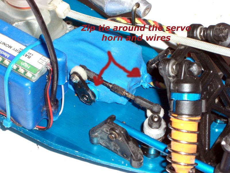

can you send a picture cuz i have no idea how to put balloons on the servos
Old 04-08-2008 | 09:02 PM
Joined: Oct 2007
Posts: 350
From: SSM, ON, CANADA
Default RE: Waterproof
Cut the long skinny part off the balloon and stretch it around the servo. Then ziptie all openings.
