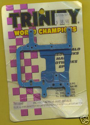

This is the motor mount you want to get.

what's the difference Toki? obviously the shape but! why the shape is like that? what those it do? I see that your car have it it looks nice.

The gt has alot of chasy flex this motor mount will give almost no flex from the spur and bell clutch.
