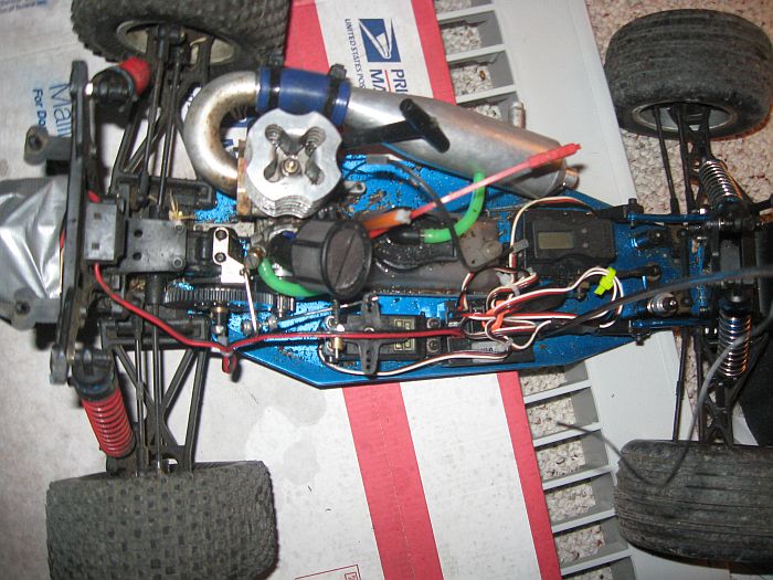

Hey guys, just wondering exactly if it would be wise to clean the foam of my air filter.. or should I just replace it? It is one of the internal kind (I attached a pic) and I was wondering if it is okay to clean the foam on these ones. Because I have seen before online that they recommend you do not clean the internal foam, only the external (which I don't have). If I have to get new foam, I mine as well get a new filter.. would this be wise anyway?

id clean it. put some soap on it get all the dirt off of it and oil. let it dry good put some oil on it and go. =)

Dont use soap, it is hard to get it all out. Simple green is way better. I have also soaked mine is carburator cleaner and just squeased it a couple times and it was clean as a whistle.
