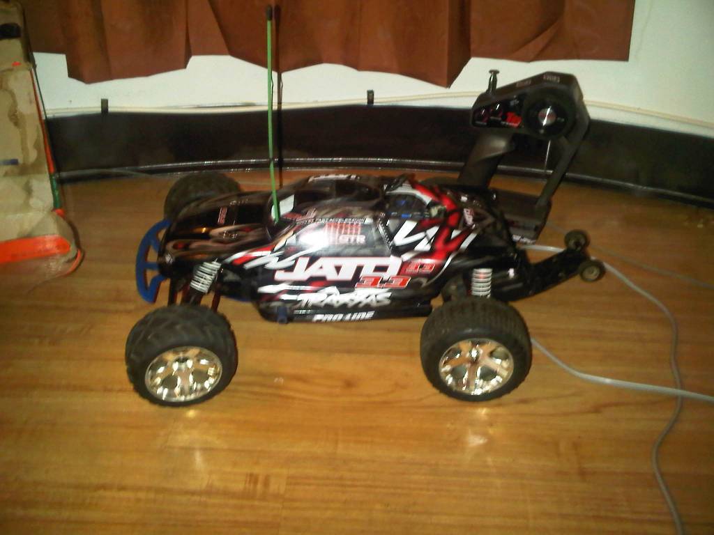

I lowered my jato 3.3 and i see alot of scratches on the bottom i really like how it looks lowered can some =one tell me what i could do to resolve this prob also i put a 56 spur on and still no poppin wheelies on demand =WHY?

Lowering the Jato all the way really takes away its potential to wheely. Due to the stock shock oil being so thin 35wt i beleive it will just squat and scrape the bottom. I use 50wt in front and 75wt in the rear. It really helps with the chassis scraping. I have mines way down.

to wheelie you gotta jack your COG as high up as possible. dropping it low is counter productive to popping em.
and lower chassis = more scratches on it

I have a piece of lexan covering my the chassis of my lowered t3 chassis, cut it to almost an exact shape, then stuck it on with some velcro.

lowering the COG, as stated above, counters the ability to wheelie. I used to use revo springs in my jato along with a high COG, and it wheelied like crazy. So you'll have to choose either lower COG or wheelies. As far as scratches, you'll never keep the chassis clean forever, but using lexan doesn't sound like a bad idea
