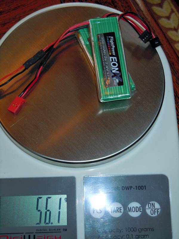

Matt,
The electric flights are about 6 minutes, plenty for the intermediate sequence and then a couple more minutes to repeat some parts. It isn't very demanding, of course, but I am flying it pretty big.
My typical flights with the gasser are about 9 to 10 minutes, so the difference in battery usage is larger because of that. I typically used about 150-200mAh per flight with the Focus II. That's for Rx and Ignition, as you mentioned.
When I went out and flew last Thursday I purposely did not recharge the Rx LiPo's for the Sickle, which means that they now have 9 flights on them without recharging. I did, however, keep a very close eye on them to make sure there was no chance of over-discharging, and the catastrophic results that could follow!
I have not had a chance yet to recharge them on the Cellpro 10s to see how much charge they take. But I was VERY surprised last time to see a recharge value of only 152 mAh for 6 flights. And very interested to see what I get this time, whether the previous number was a fluke.
However, I did just check the present voltages of the two 350 mAh packs, and after 9 flights one of them is reading 7.67 volts (7.35 with a 500mAh load, 7.00 with a 1amp load) and the other is 7.96 volts (7.68 with a 500mAh load, 7.28 with a 1amp load), so these Rx batteries could have handled several more flights.

I'm still feeling out the capacity which is why I very carefully streched the Rx battery experiment a little. I don't think I did anything monumentally moronic with the experiment, and I don't plan to make a regular habit of not recharging before each flying session. I wouldn't want to fly with batteries showing less than 6.6v under load.
Total flight time for the 9 flights is only 54 minutes, so we really are comparing watermelons and strawberries with the gasser vs electric contrast. The e-bird Rx really sips the mAh's; it is a totally different beast.

54 minutes of flying time for a total capacity that is about 800mah, right?
I'm using 2 FP 350's for a total of 700mAh. But I think I could have easily gotten a few more flights, and 12 total would have been conservative. So say 72 minutes total with a reasonable margin of safety.
Not yet recharged the Rx batts to check total mAh because between work and weather I don't know when I'll be able to fly again and don't want to store fully charged.

I just finished recharging the 2 350mAh Lipo's and they took a total of 383mAh (250+133) after 9 6-minute flights and also about an hour of being on continuosly today as I set up the new Airtronics SD-10G radio system. I was moving and holding the control surfaces in position while using the throw gauge, so I reckon that is very conservatively worth at least 1 more flight, so make that about 38mAh per flight.
That's it. It reaches the point sometimes where it isn't going to help to test any more. I will continue to carefully monitor the batteries as I normally do.
