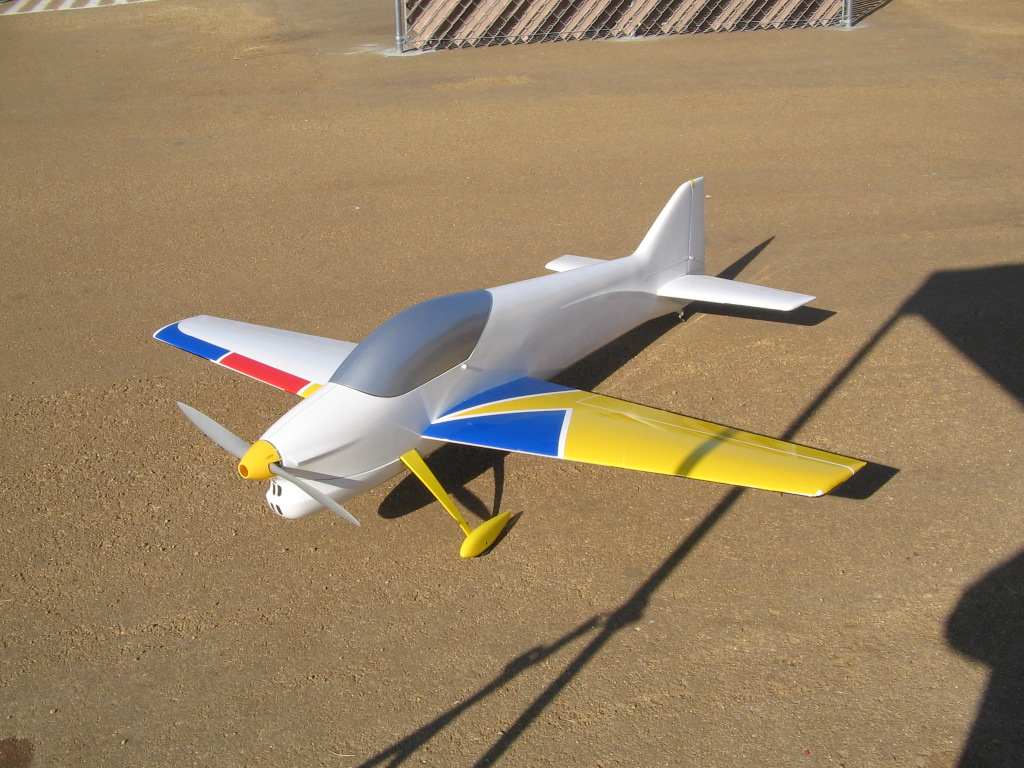

My "box stock" Integral flew great today, only did one flight, I always take a plane home after one flight and check all the nuts and bolts to make sure nothing has worked loose. But maybe that's overkill since electric's have very little vibration.
Verne, you are spot on, at the top of one hammerhead, it went left a little, so I will be doing the changes you suggested
But for now, I want to get some flights because District 7 championships are next weekend and I want to fly the Integral there. I MAY be able to take home 2nd place in my first year of Pattern.
Here's a picture of it, I used trim sheets for the color schemes to see what will work the best for my vision limitations. I can't see the "easter egg pastels" on most planes.
Again, thanks for everyone's help
Randy
Randy
