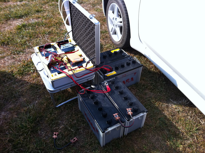

There are some things on the gas engines which have not been considered in our discussions, for example, the supercharging system in the YS engines is a great improvement on the regular supercharging found on any two stroke engine(this also depends if the engine has a front intake or rear intake), the two stroke does not create a considerable vacuum when the piston goes down as on the 4 strokes, just because the exhaust port opens before the intake, and that is why the fuel is helped to be pushed in the cylinder by the downward effect created by the piston, so, if a gas two stroke was going to benefit from that, it should have to be a rear intake, with the rotary valve and rings on the crankshaft to hold maximum available pressure, if it is front intake, then the turbo crankshaft will do the trick, but I have only seen this in racing engines like in car or pylon racing engines(all RC I mean), it is not easy at all.
YS are engines created for serious competition, so the big 4 strokes have been created for F3A, not to for lower classes or to make it affordable, so, YS knows they are fighting electrics(they know!), so if they go to a gas version, this gas version will not be as powerful as most top class electrics, and inmediatly will be degraded to a low power motor in comparison, and that is very unwise, as they take a lot of pride in the YS career, and how many lower power engines does anyone think they could sell? and after all the research done, will they get the investment back?, or will they keep producing the most powerful engine on RC instead?(comparable by size, displacement, etc).
YS opened the option to use no Nitro, actually 5% or 10% is the minimum you can get in most stores, and if some one can not cover the cost of fuel, I doubt it can cover the cost of an airframe and equipment for such engine.
I think if it even do not looks like it, there are too many variables in this game that start and end probably with the cost of this hobby, but dreaming of having the best equipment but cheap, is everybody's right.
Pattern is a specialty ( I think is more a specialty than a hobby or sport) and has its followers counted, not that many, and after a long time I came to realize everyone do the best it can to get the best equipment possible within their individual budget, but we are so few compared to the rest of the classes in the hobby, that's why we have to pay so much for everything, we are talking $5000 airplanes half the size and close to double the price of a 40% which looks scale, such dedicated equipment will always be expensive, and a multiple world champion manufacturer will not come out with a cheap version anytime soon in my opinion, of course economics will dictate decisions, always have ,always will.
Remember that not everybody has a power outlet in the field or wants to carry a generator around as it is common in the USA, when I was in Portugal, there were cars with the engine running all day long while recharging batteries during practice, and at $5 a gallon of gasoline................
Some people do, like in the attached picture(extreme to say the least)
I hope everyone can get what they need to be happy in this specialty, now or in the future.
Best regards and happy flights

Alejandro,
I couldn't imagine anyone carting 4 big batteries like that to the flying field... That is just crazy! [&:]
Here in Australia, the Honda generator is a common choice for charging at the field. At a comp, the maximum per day you would fly is four flights. I have four packs for this reason and they are all charged the night before the comp. Too easy..
Cheers,
Jason.

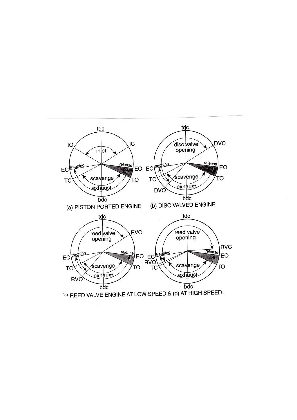

Attached you may find schetches of different induction systems. To create power it is necessay to get as much air/mix into the cylinder, and some may be difficult to utilise due to its lenghts in addition to engine lenght.
Best regards

Hey Jason!
I know what is in the picture is overkill, just tried to show how far some people could go to fly electrics in certain countries, not to say it is the standard, I know the Honda, but it is a $2000 generator in the USA still, I know there was a sale a while ago but did not get there in time at the Home Depot, I have a Honeywell 2000 but it is so heavy I just fly my 6 TP packs and go home, which at the end is about 42 to 45 minutes of flying against 84 minutes on 6 flights in the YS. You have a very valid point, the Honda generator is an amazing unit, very small and very very quiet, it is just not easy to get and expensive, and it varies from country to country, that one does not even exist in Venezuela.
Dag, exactly what I mean, not easy, a two stroke gasser to be as powerfull will waste power in carrying it's own weight, it is an option, but probably new ideas are needed and a good solid company who wants to spend in R&D, look at OS with the 200 CDI, a waste of resources, but they can afford that after all, only one was used at the WC and we all thought it was going to die on the take off on the third P round(I think). I wonder if DA had ever looked into it? Dave Von Linsowe used to fly F3A......
As to the comments of the Himax motor etc, my electric set up is $850 for the motor and ESC, 6 TP batteries at $300= $1800, plus the charger Cellpro XP $200 and the power supply $100 total $2950, a Himax can not be compared to a Hacker and never to a YS. My YS setup is $800 engine, regulator $30, battery $26 switch $15, header and muffler $200, the tank etc comes with the airplane, total it is about $1000, I can still by a sh....t load of glow fuel with the $1950 difference, and I do not put Chinese cheap options in a $6000 plane, that will not make sense at all.
My best regards to all,
Alejandro
