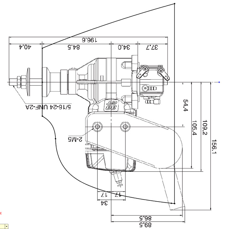

As you can see, there's enough space inside the cowl for the OS33, but you would probably need to replace the standard exhaust with a tuned pipe.
Please keep in mind that the structure was tested with electric power only.

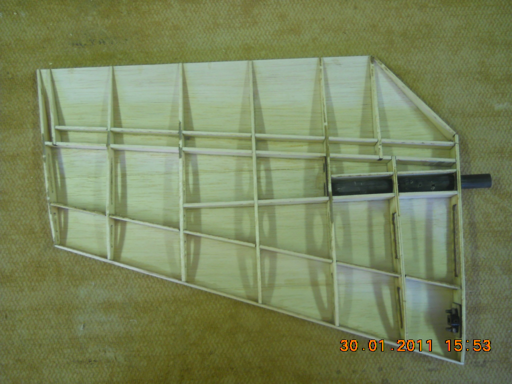

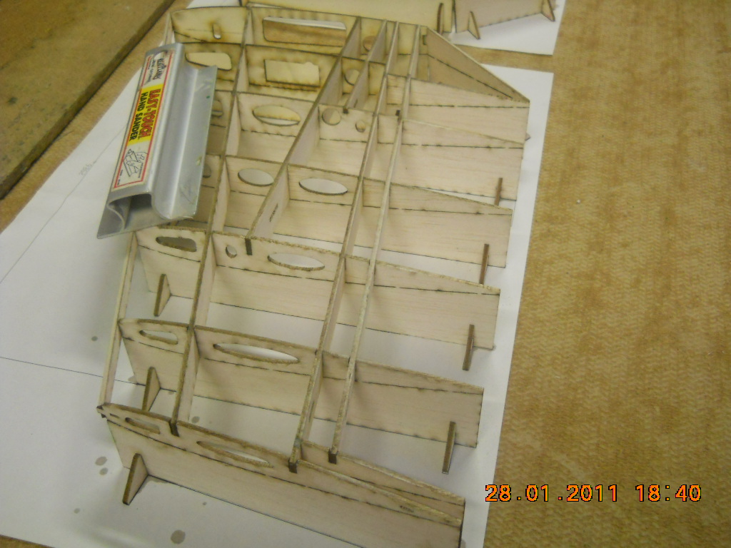

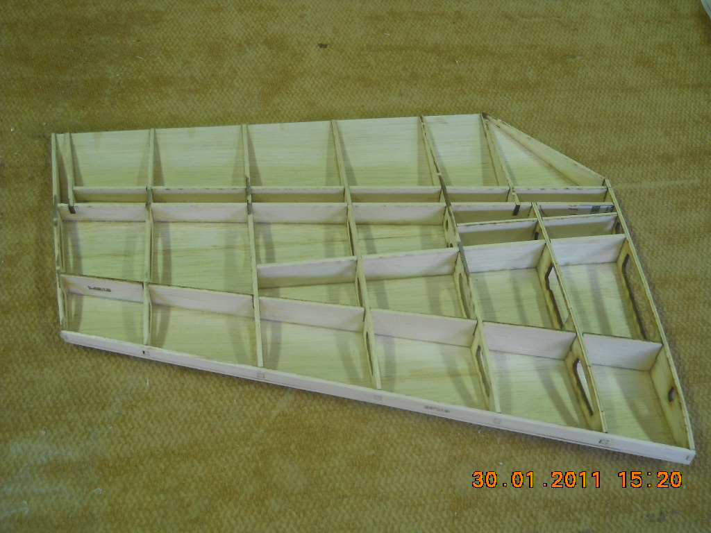

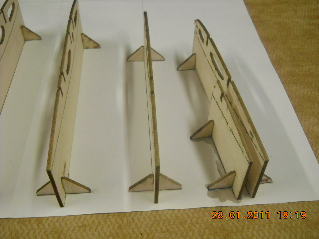

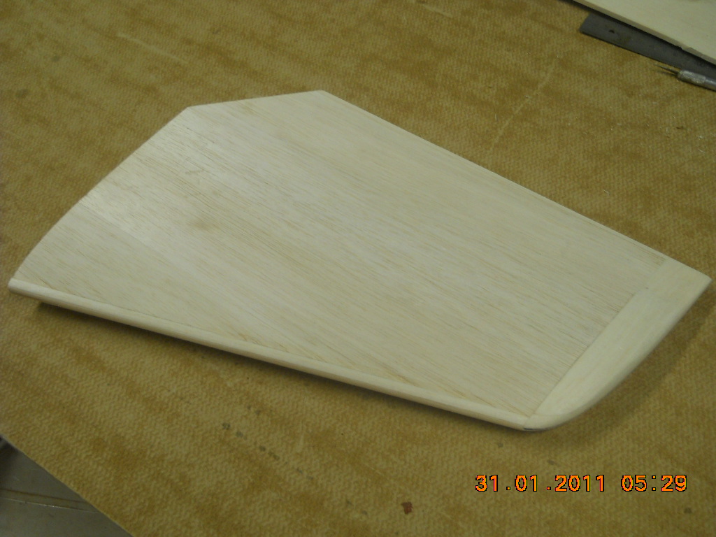

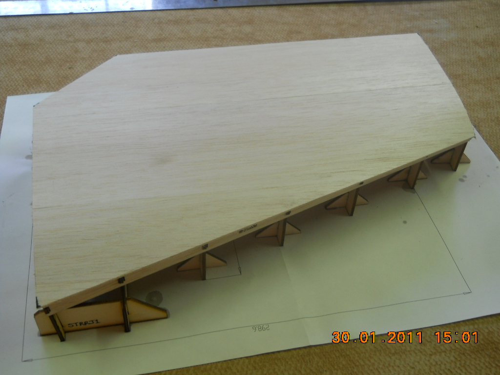

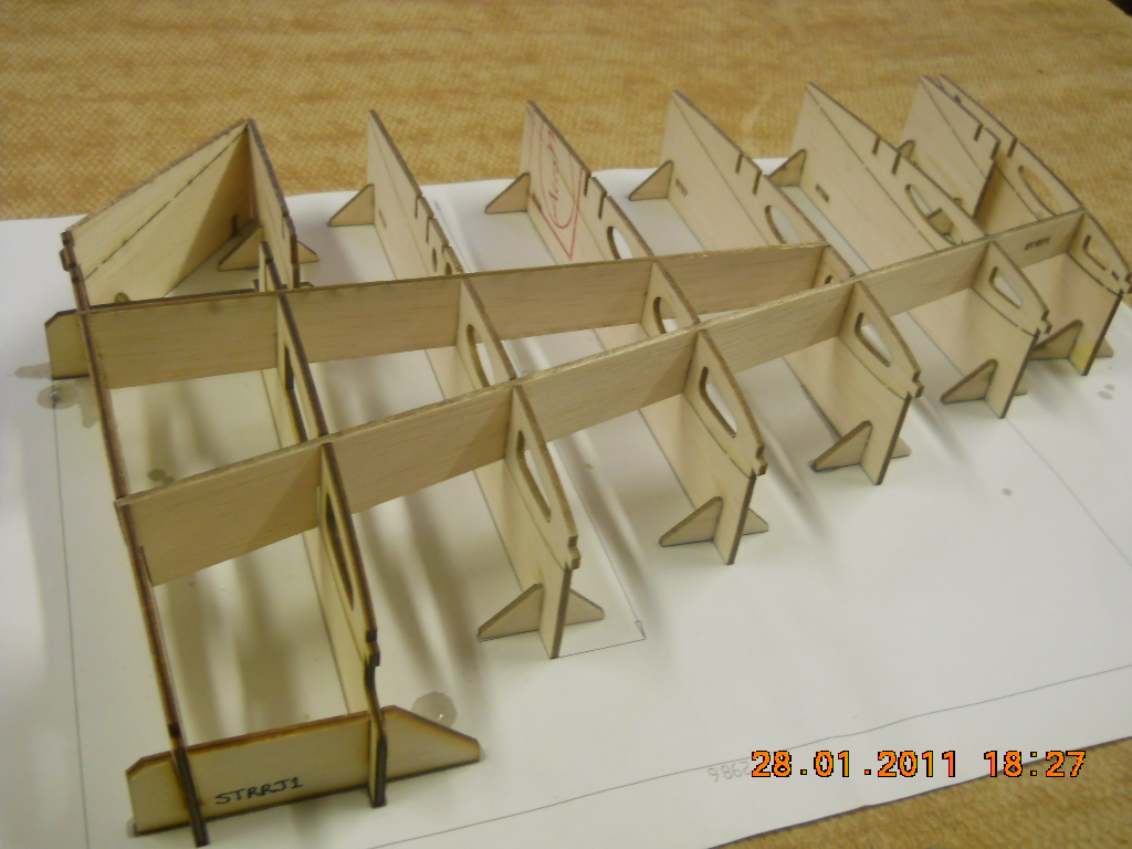

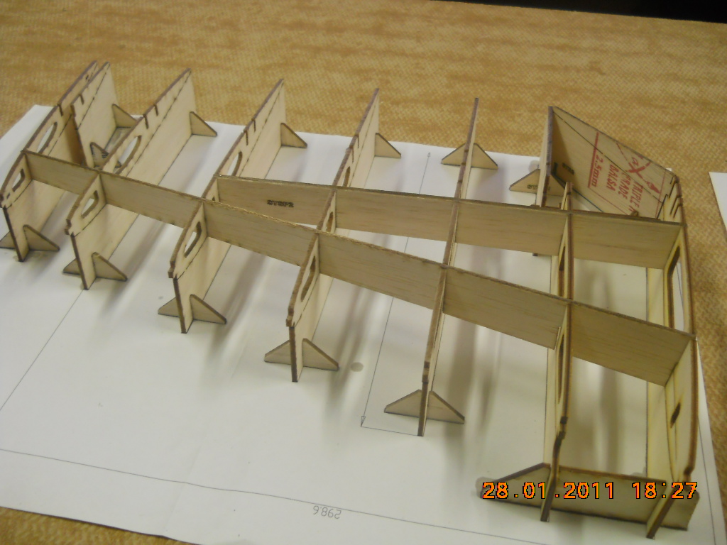

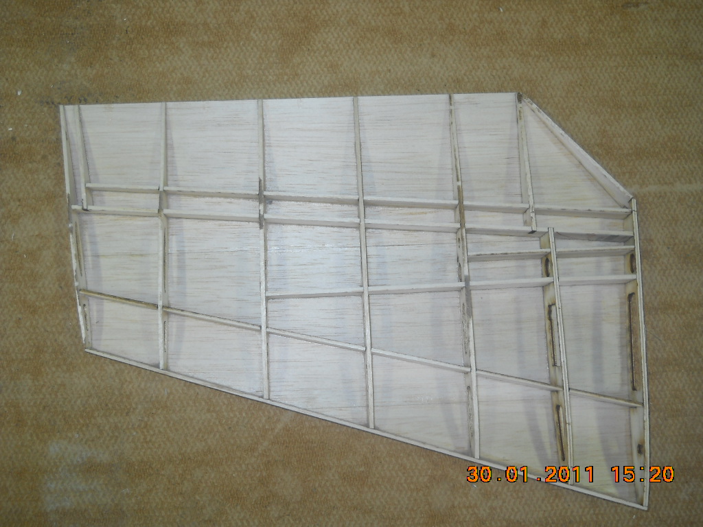

More work on the stabs:

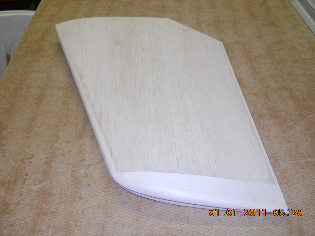

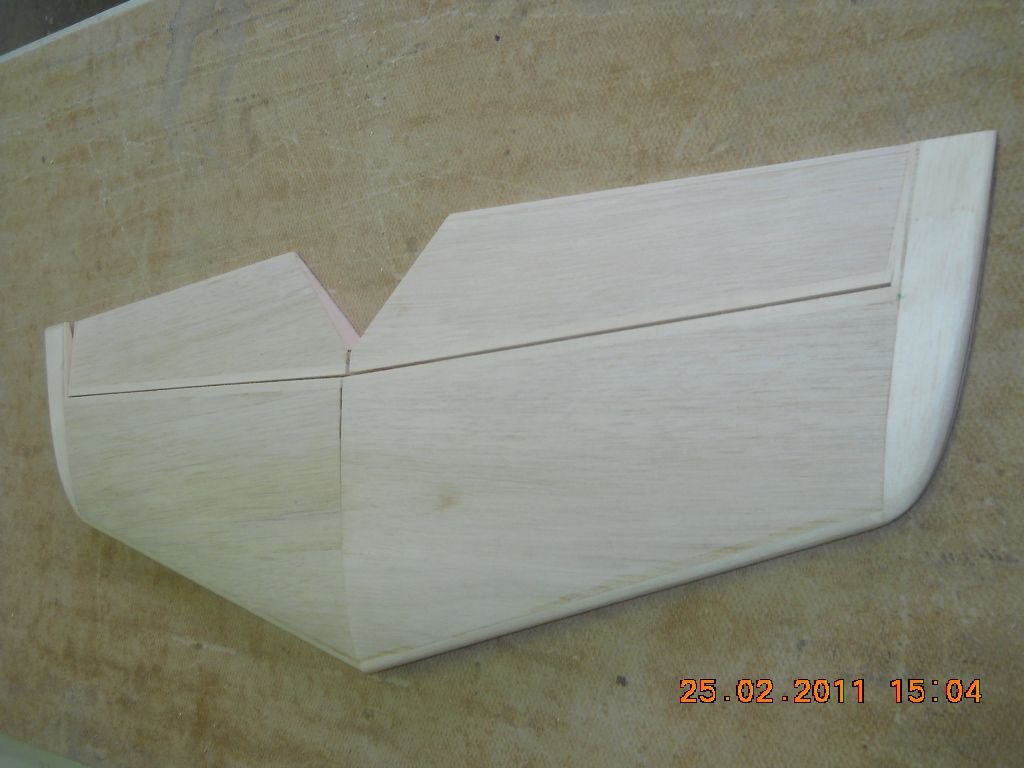

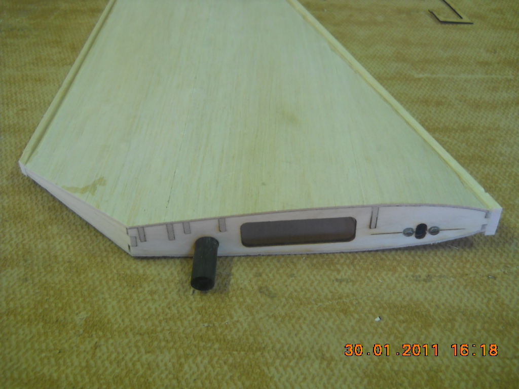

Final operations on the stabs:

The OS33GT is a powerful 2 stroke that produces considerable vibration. I would not put this engine in a plane without proper soft mounting. A hyde type mount set-up with 1" standoffs works fine. The minimum donut thickness should be 1" for better isolation.

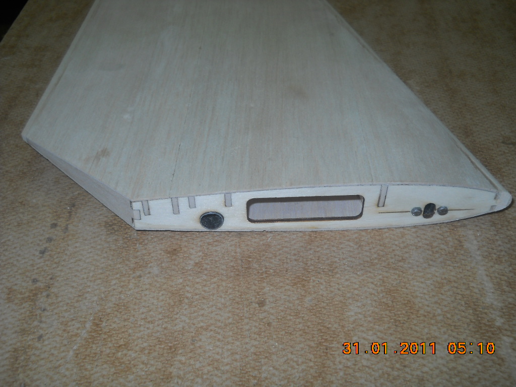

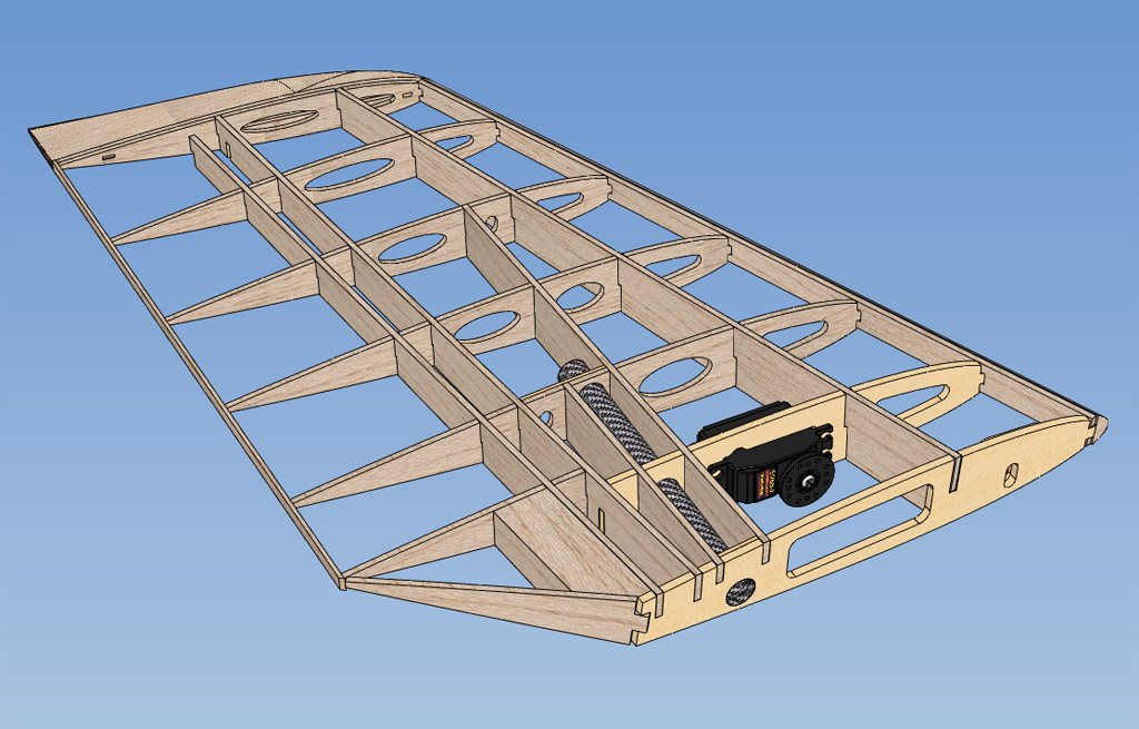

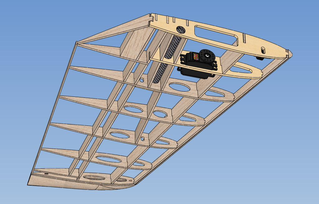

Alex; what servo are mounting on the stab? It's inside the stab; isn't?
Great Plane!!!
Old 04-03-2012 | 07:31 AM
  #56
Joined: Aug 2006
Posts: 520
Received 62 Likes on 28 Posts
From: Trollhattan, Sweden
Default RE: Radiance F3A - new pattern kit
ORIGINAL: guille2006
Great Plane!!!
Thanks Guille. Yes the elevator servos are installed inside the stab as illustrated in the attached pictures.
The hole in the supporting rib is dimensioned for the Futaba S9650 as it is probably the most popular choice for elevator servos.
It would be easy though to install any other servo of similar size.

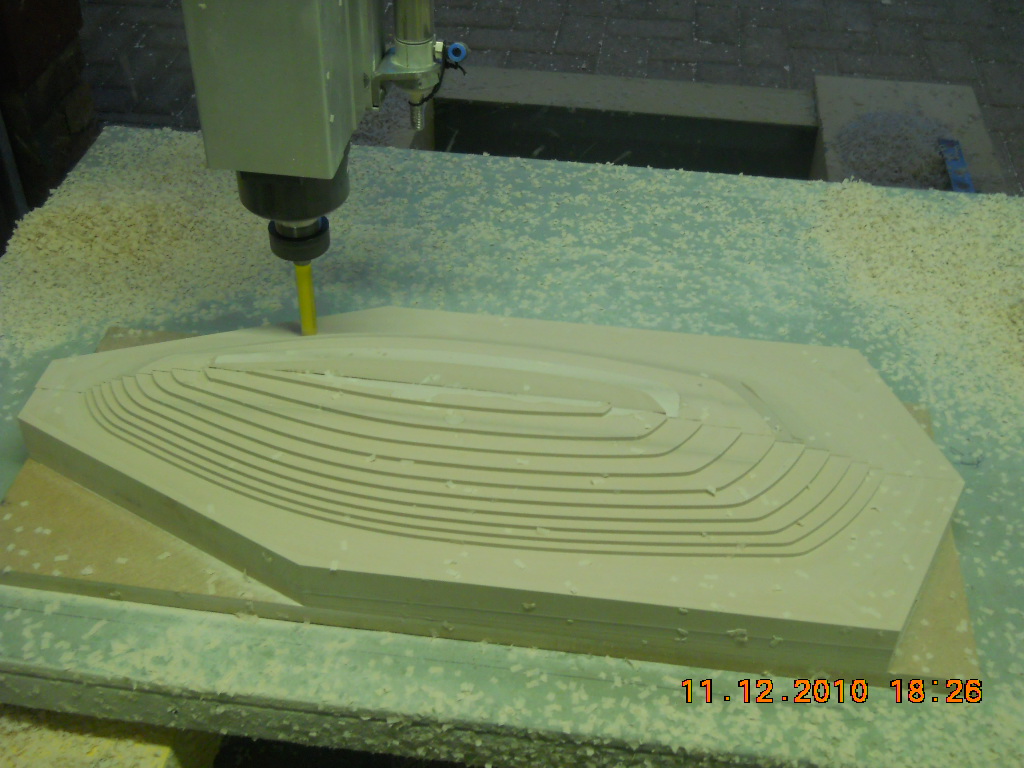

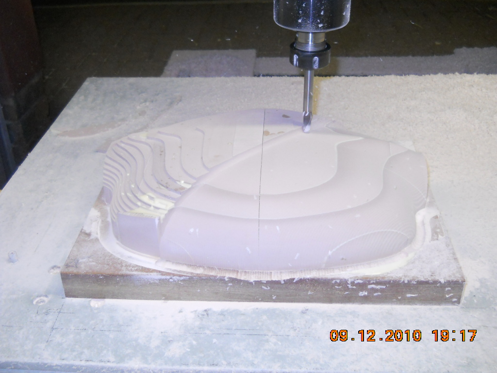

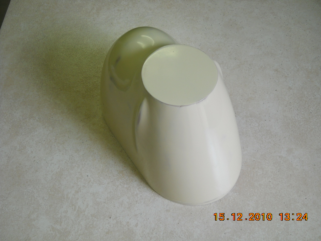

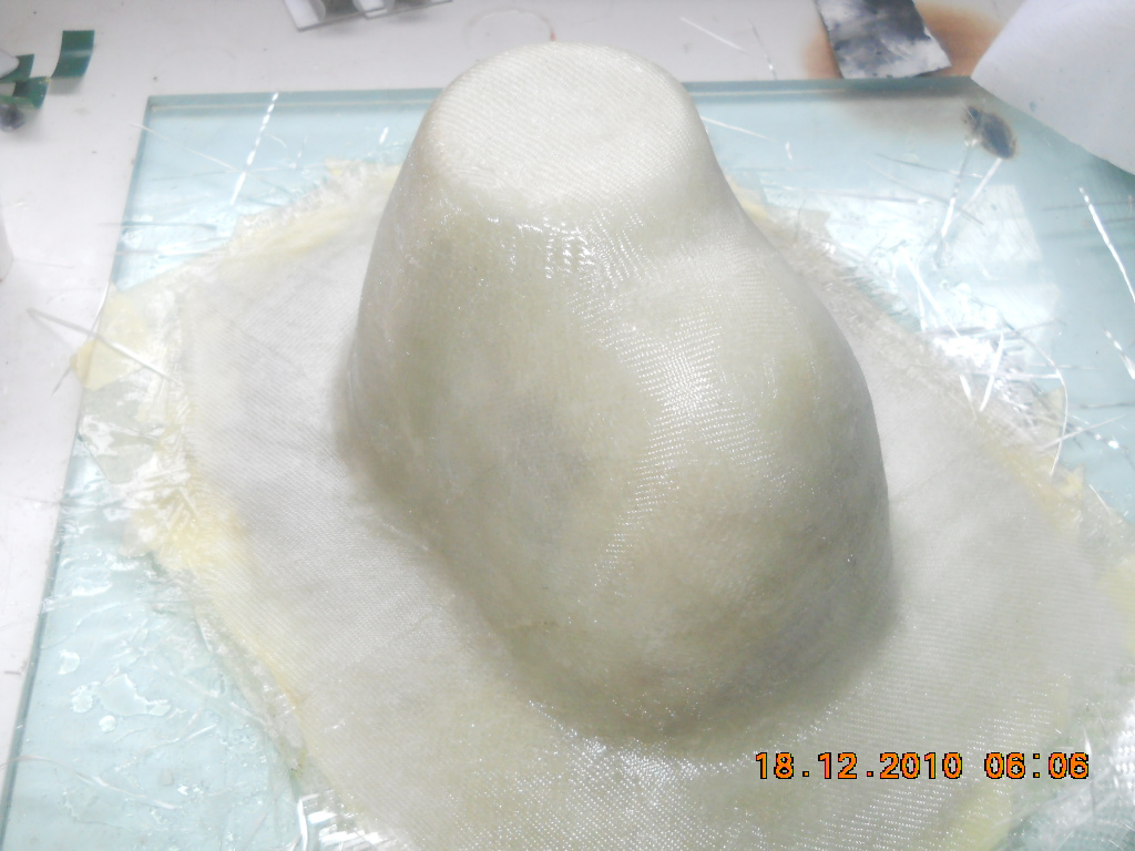

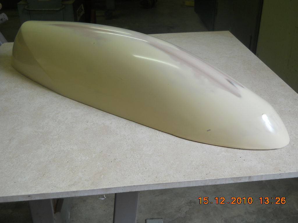

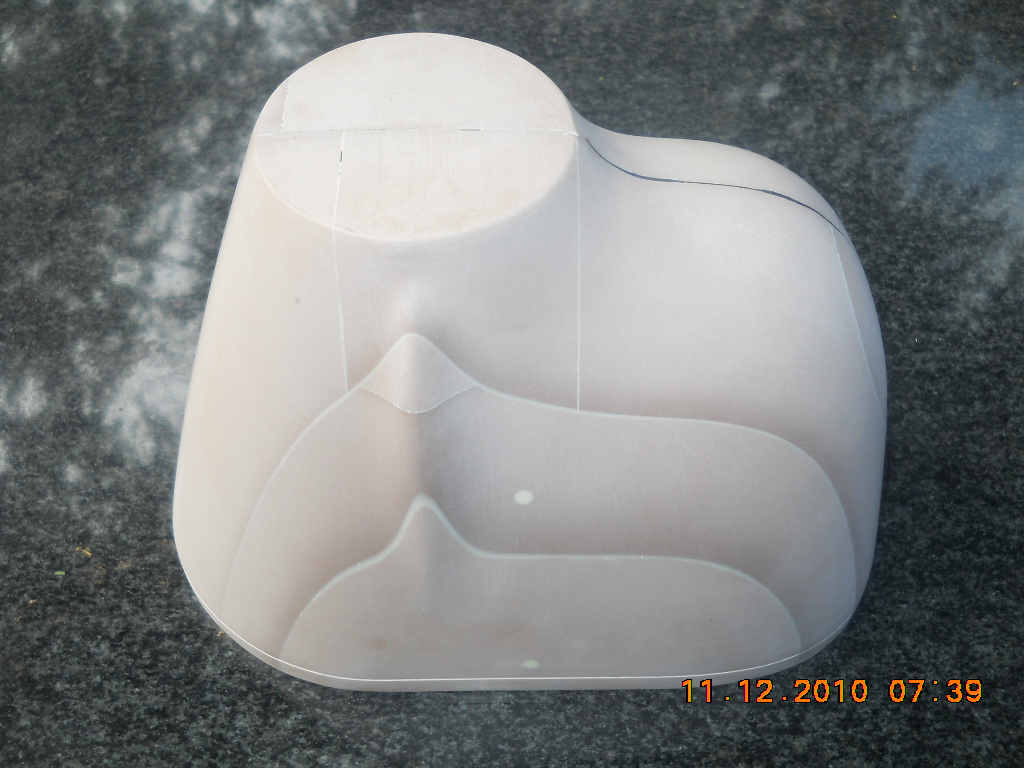

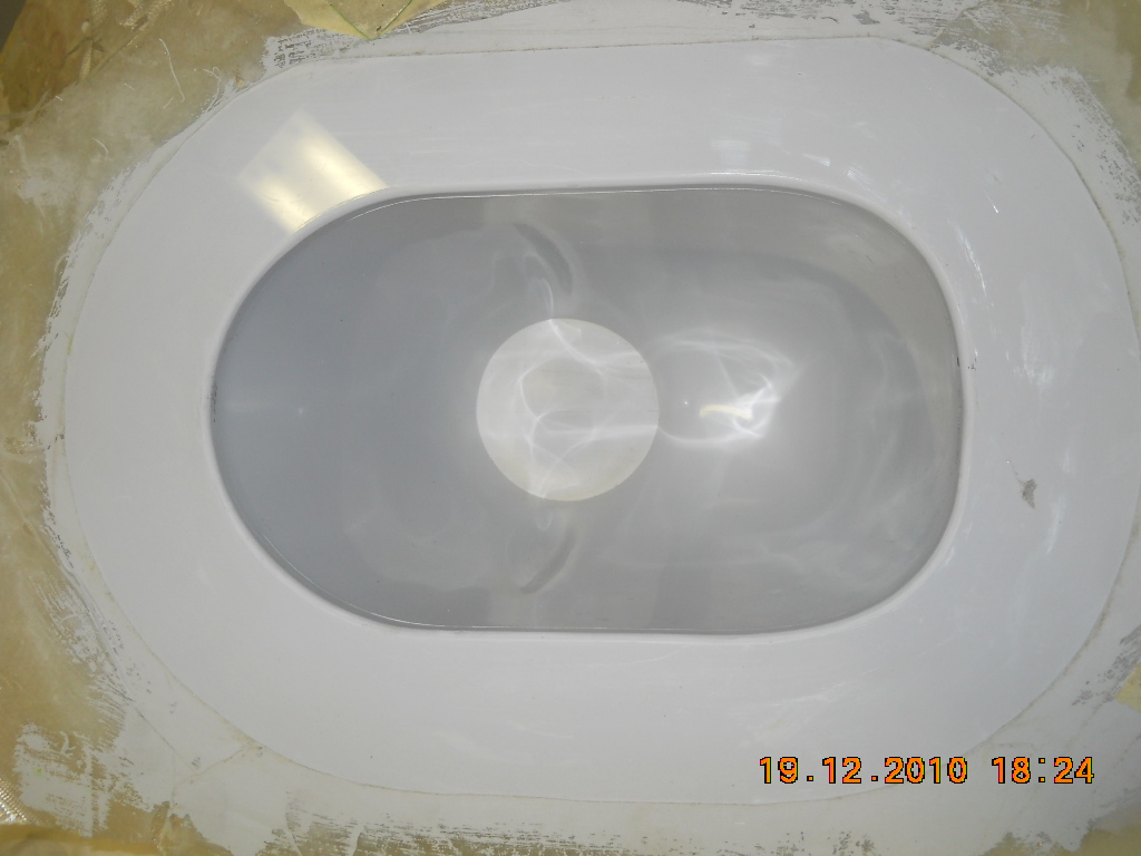

I attached a few pictures from the molding process of the cowl and canopy. The mold plugs were all CNC machined following the CAD 3D models.

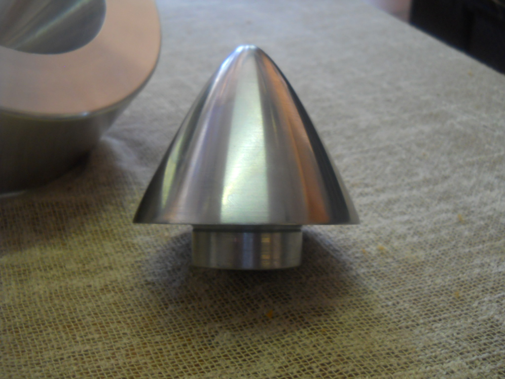

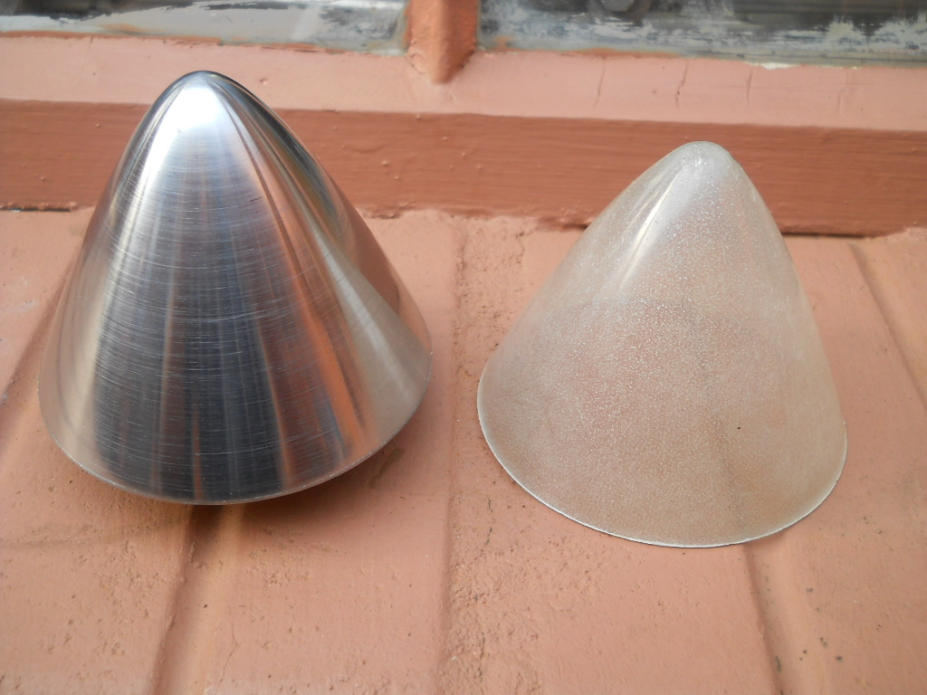

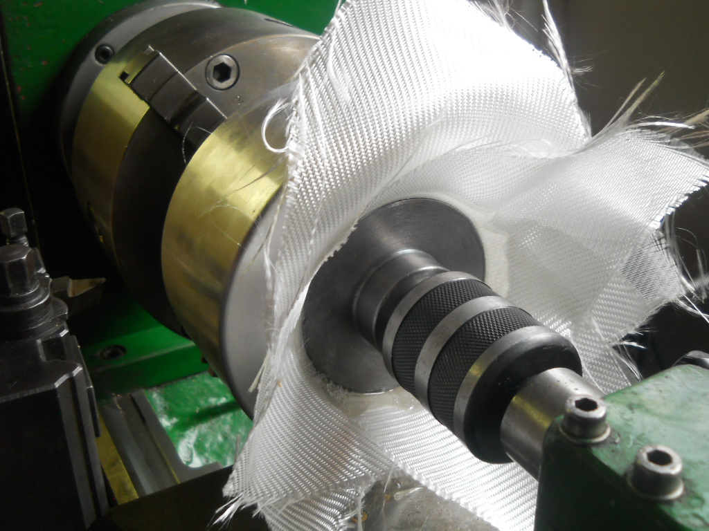

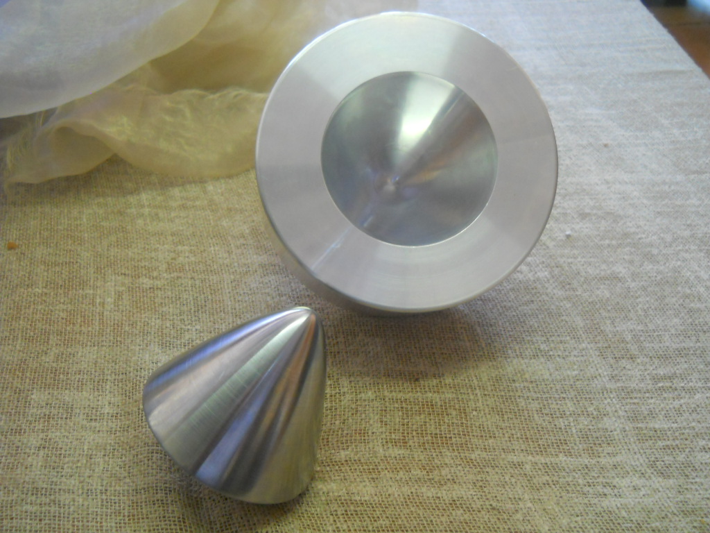

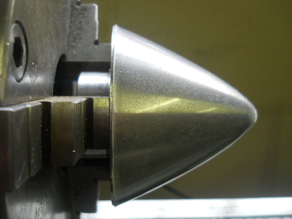

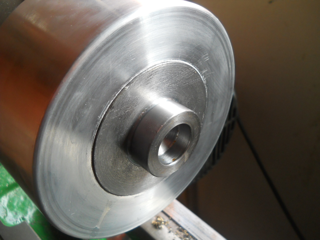

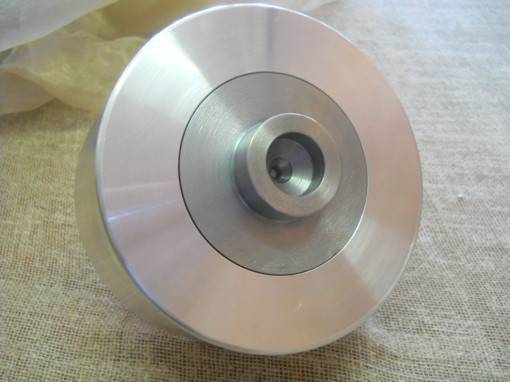

For the spinner, we decided to use a CNC machined mold and also a press tool to make sure the final part will run true without any vibrations. After the epoxy resin is cured, the excess material is also cut using a lathe.

THanks Alex for the information on fitting the OSGT33 in the cowl. Thats very reassuring.
Also good work on the moulds. This is a very professional job. Thanks for bringing this very cost effective kit to the market at such a good level of quality.

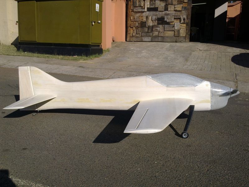

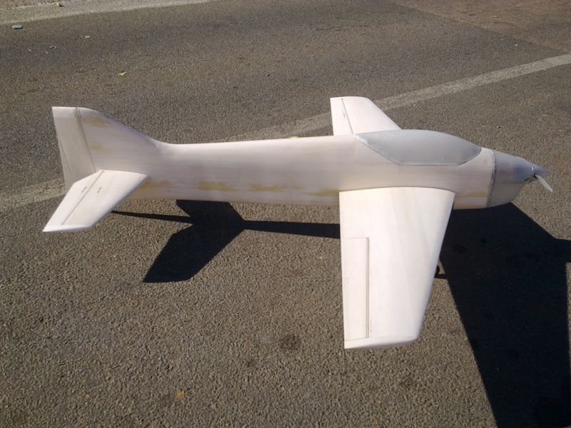

Last pictures before painting / covering, showing the assembled model with cowl, canopy and spinner fitted. Sorry for the low resolution:

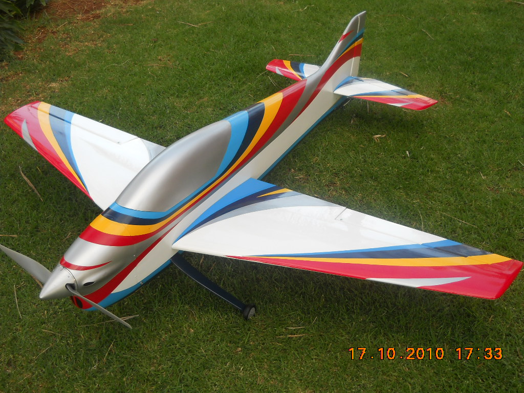

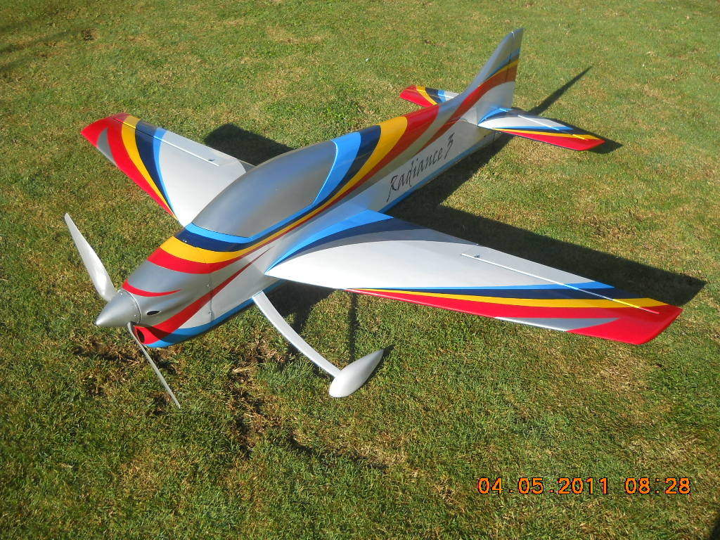

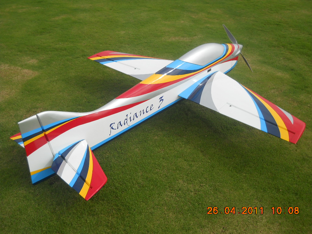

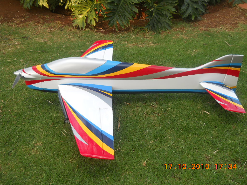

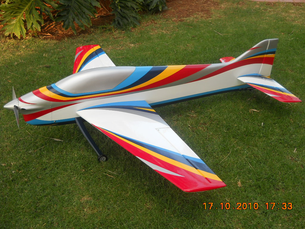

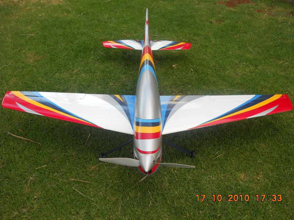

And now finally some pictures of the finished V2 and V3 prototypes. Tommie decided to switch the red and silver colors and it turned out pretty nice.
Please note that the kit version has longer ailerons and a different, better looking spinner.

Did you model the entire OS 33 in Solidworks too? If so, would you be willing to share a file?

Sorry Steve, i don't have a 3D model of the OS33. I used a 1:1 scale picture from the engine manual.
