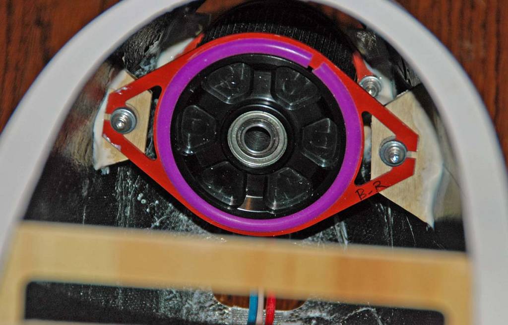

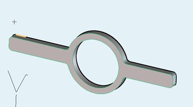

The first step is to install the gear. I'm still waiting for a custom set from Graphtech (like Bolly long with the full sweep), so I started on planning the motor. I chose the Plettenberg Advance 30-10 for the combination of weight (no firewall needed), efficiency, and low maintenance. I was seriously considering the Neu F3A but felt that I would benefit more from less maintenance at this stage of my pattern ability. The advance is a nose-ring mount. I am deciding between aircraft ply and carbon, with ply spacers. I laminated some layers of balsa to help define the perimeter, and created the mounts on Creo Elements (freeware CAD program) using some measurements and the motor technical drawing. I'm going to have carbon and ply mounts made and will decide based on apparent weight and strength.
Here are the mount, plywood spacer, and rear mount:

Hi, Joe:
Since you are "rolling your own" motor mount, you could just dispense with the ply spacer and make a nosering that fits flush with the fuse from the outset.
Could be a bit tricky getting the right thrust just right, but that's what CAD is for, eh??
For the Caelestia I used the F3AU mount for the Advance, with significantly minimized spacers because it seemed to me that a full-circumference spacer was not necessary when used in concert with a rear mount to further stabilize the motor, especially since it's and inrunner with less rotating mass. About 150 flights thus far and my theory is holding up.

Bob, the plan was to laminate the spacers to the ply/carbon nose ring that comes pre-installed in the Integral. I was going to shape them so I could also glue to the fuse around the perimeter. However after posting this thread I thought about how fast I am going to eat up the weight margin I have, and started thinking about making things a little smaller/lighter. I will consider an optimized spacer. Since the nose ring is already installed, a recessed nose ring would end up sitting just behind it.
