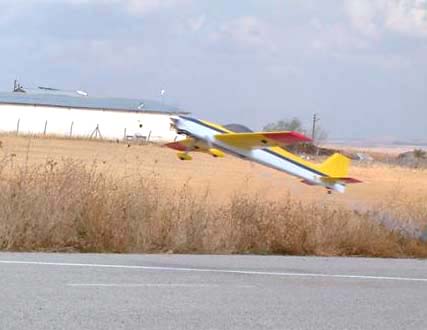

Thanks, but I think you plane is a Hydeout, mine is a Hydaway different design. I dont think that our settings will be the same.
Check ou the pic of the Hydaway below.
John

yes you right..I only want to say that hydeout wing/stab incidence is zero to zero...
which also might be helpful for you.. by the way your plane looks GREAT...nice finishing
happy landings...
oscar
