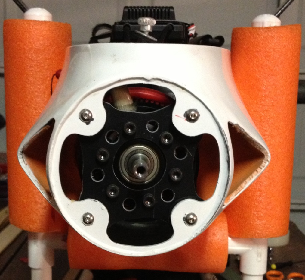

I am in the process of designing a motor mount for my Integral. It's going to be a custom, composite mount machined by a friend in the hobby. The motor is a Plettenberg Advance. What I want is the ability to adjust the thrust line; I would like the 'stock' thrust line at first, and the ability to shift the motor to a second predetermined location. The reason - I have a set of foam cores that I am going to build. I want to fly the plane stock at first, and have 1/2 degree of positive wing angle in the new wings. Based on advice from people I trust, I would then end up wanting to reduce down thrust and increase right thrust.
Any thoughts/advice/pictures are greatly appreciated!

Here's how my Abbra is done. Plate is 3/32" G-10. Easy as pie to adjust thrust left/right & up/down

Thanks for the replies. The challenge in the Integral is the diameter of the nose vs the diameter of the motor. There is not much room for hardware outside the motor diameter. I was thinking of somehow shimming between the motor and the inside part of the mount, such that the motor mount bolts would go through the shim, rather than needing add'l hardware? Hope that makes sense.
I guess a quick and dirty way is just use shim washers between the mount and the motor. I'd like to find something more robust/creative/permanent, and also need to consider the rear mount.

Take a look at this thread. It shows the Advance being mounted in a BJ Craft Episode
http://www.rcuniverse.com/forum/m_10...5/key_/tm.htm#
Post #122 shows some pcs.

Thanks, that's exactly what I needed.
