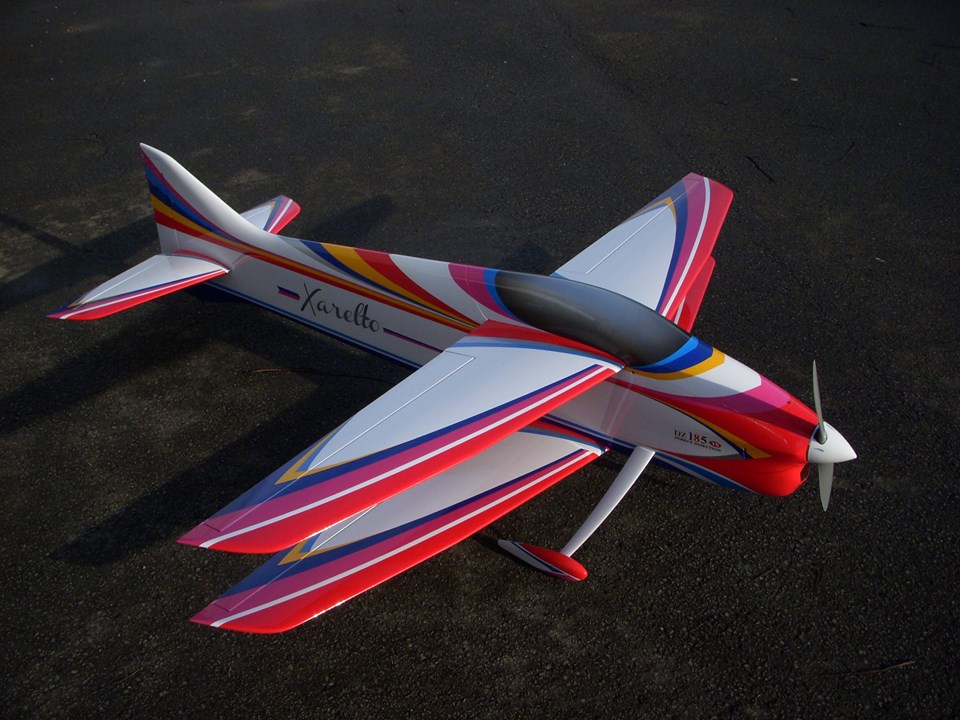

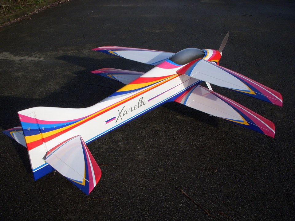

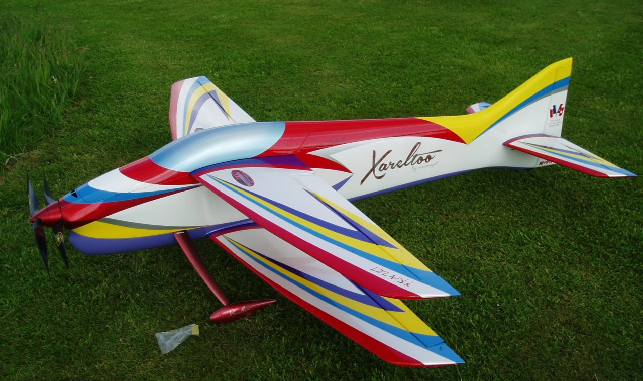

Just finished mine and have it trimmed and flying well.
ID:	2020747   Click image for larger version
ID:	2020748   Click image for larger version
ID:	2020749   Click image for larger version
Your xareltoo is very beautifull !
how do you feel it in flight ?
what are the differences between xareltoo and sensation ?
regards,

(Your xareltoo is very beautifull !
what are the differences between xareltoo and sensation ?)
I can't really tell you a lot as I lost the Sensation on its fifth flight. From the little I flew it, I could tell it was going to take a lot more trimming and mixing versus the Xareltoo. The Xareltoo took almost no trimming. I moved the CG forward just a bit to get rid of a little gear tuck on knife edge and I had just a hair of roll out on left rudder knife edge that I mixed out. Other than the normal down elevator mix to low throttle, that's it...no other mixes.
The Xareltoo is must be extremely efficient. I normally run around 3,400 to 3,600 ma flying the US Masters with my Arixtra. With the Xareltoo I am right at 2,850 to 3,000 and that with a weight right at 5,000 grams.

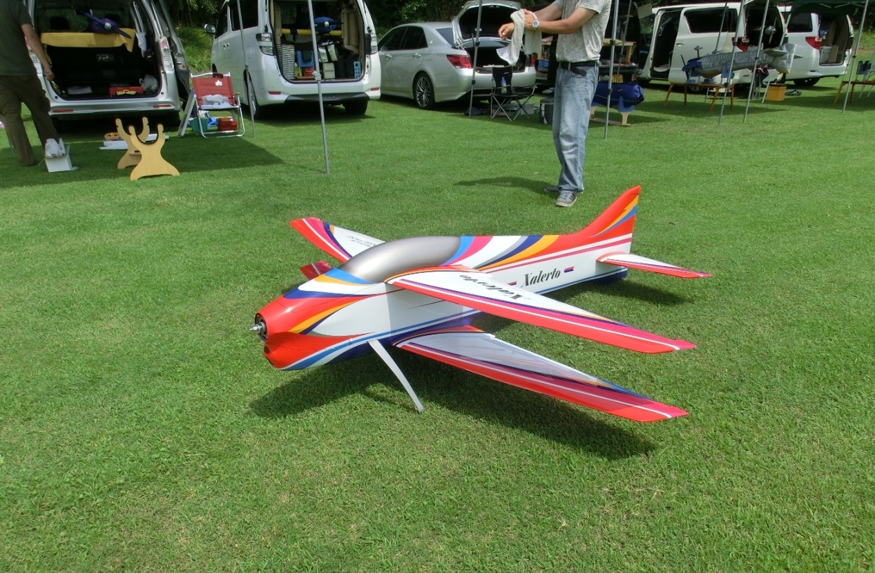

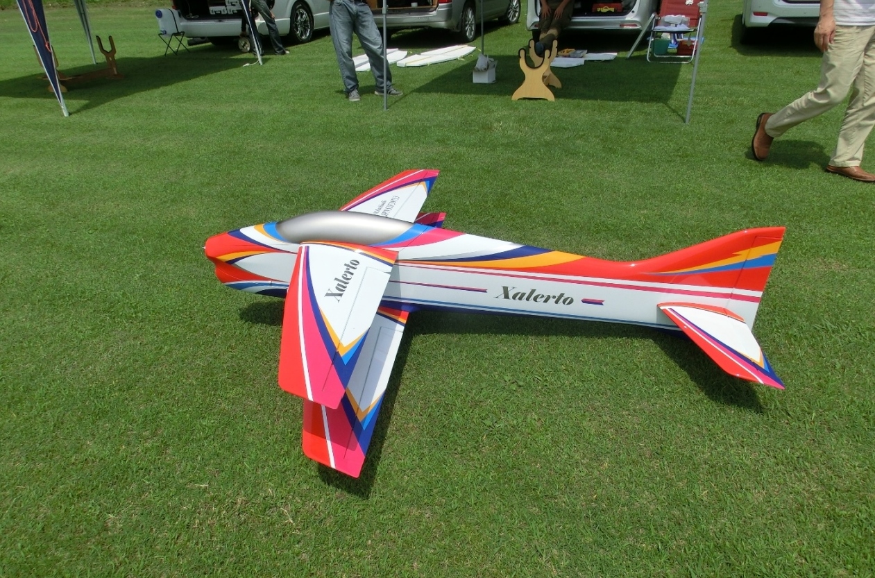

Pascal sells his Xareltoo (YS version) :
contact e-mail: [email protected]
https://www.facebook.com/pascalnowik.aerocompet?fref=ts
ID:	2021372   Click image for larger version

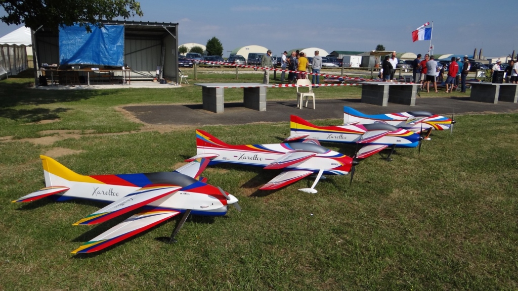

Hello
Xareltoo in 2014 french championship
Name:	CDF 2014 1.JPG
ID:	2022280   Click image for larger version
