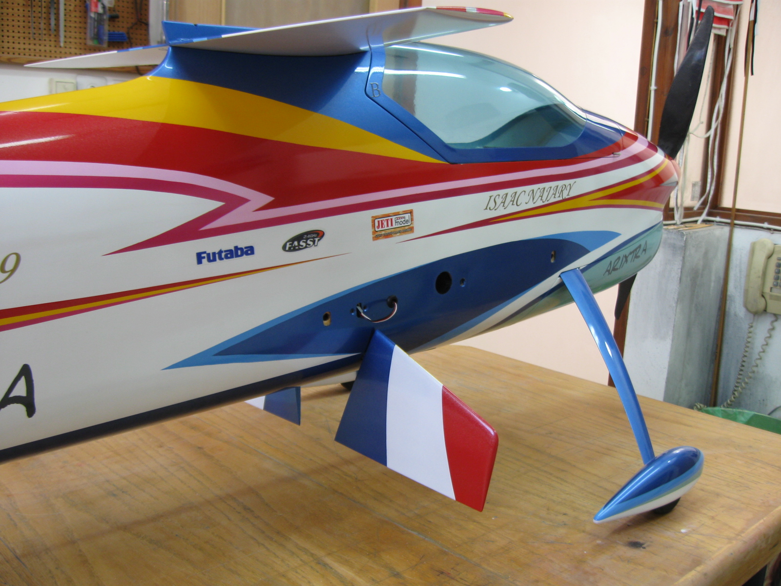

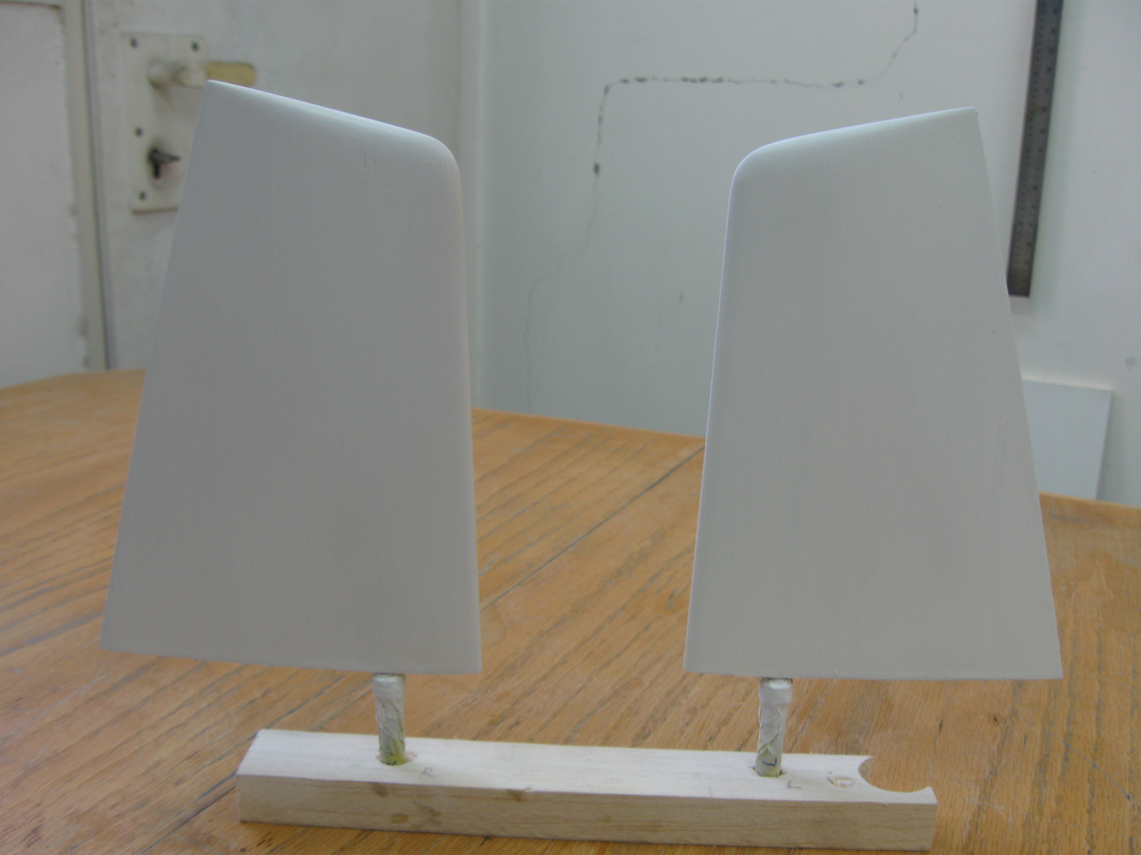

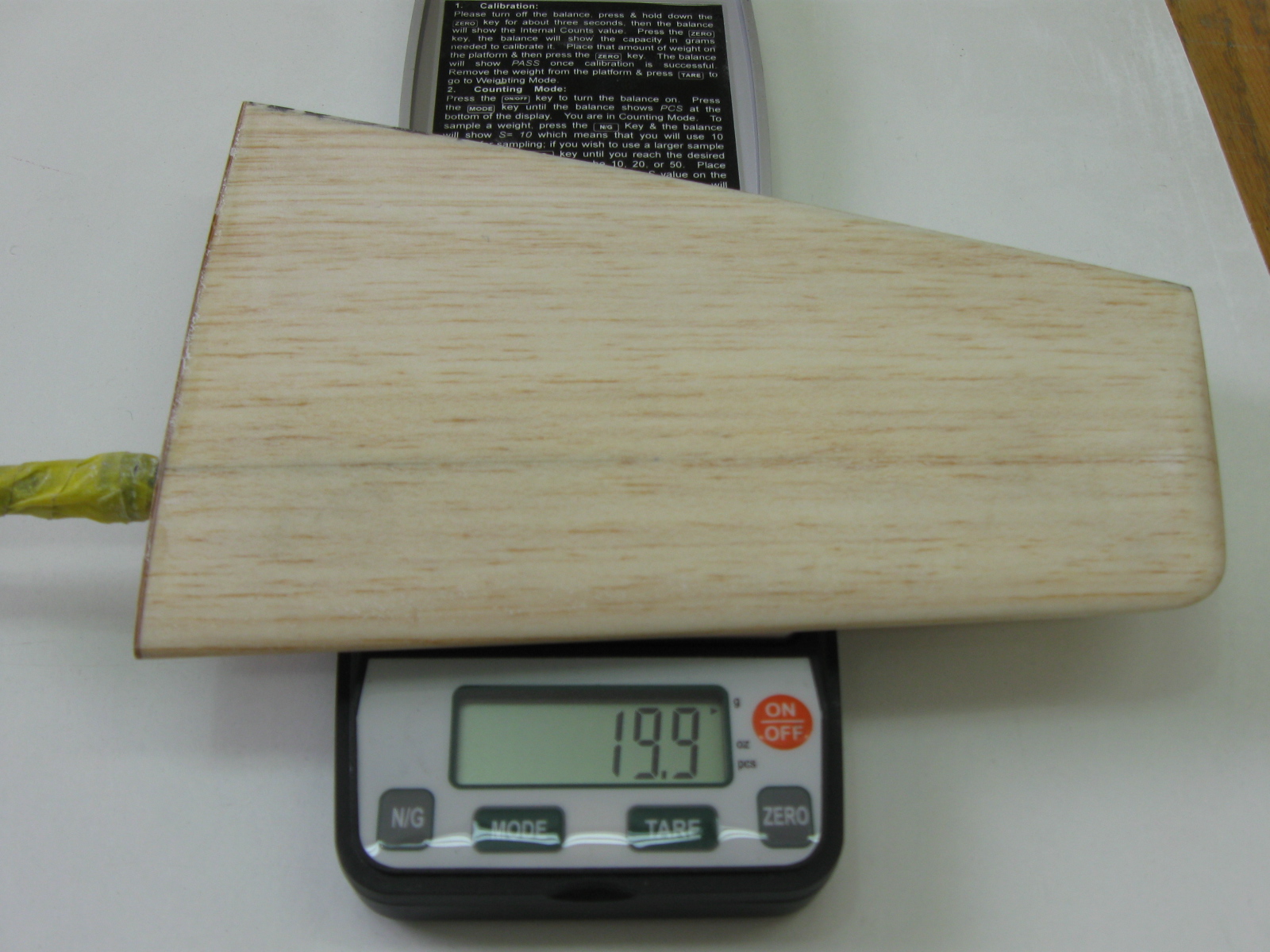

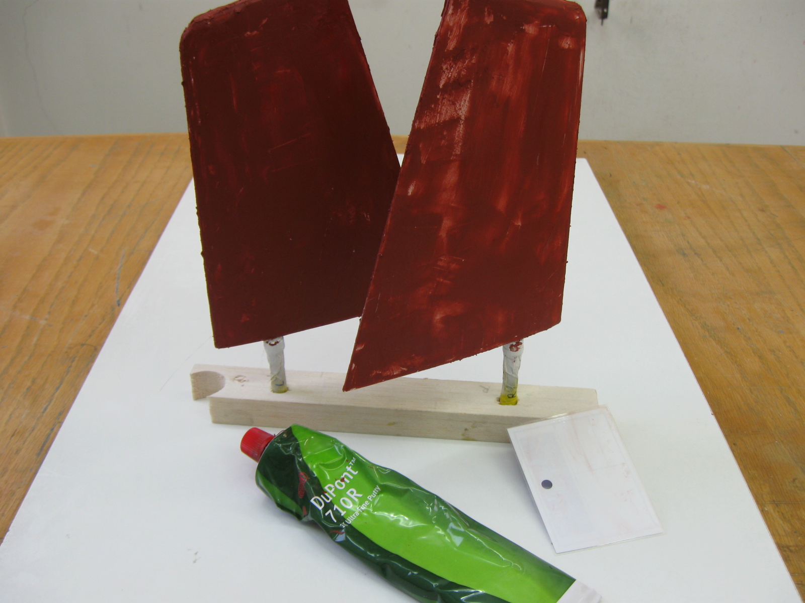

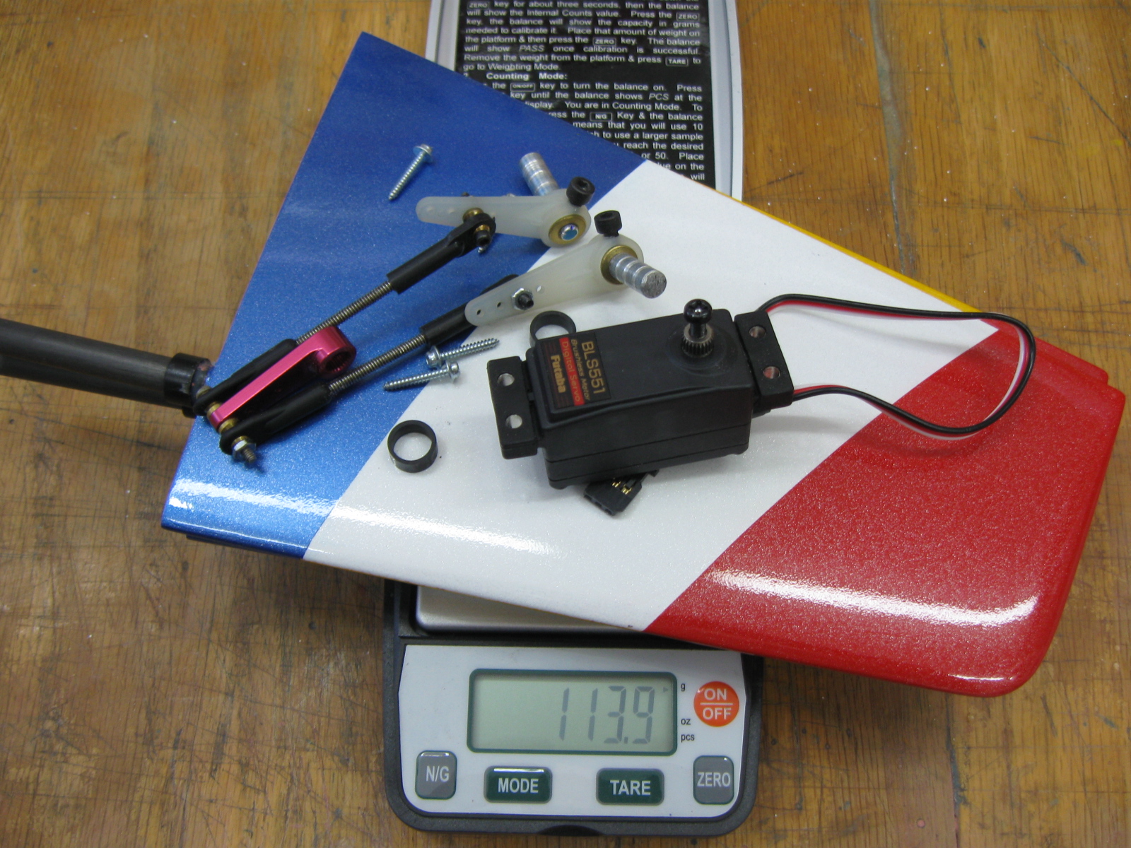

Applying micro glass added 5 gram (19.9+19.0-17.3-16.6).

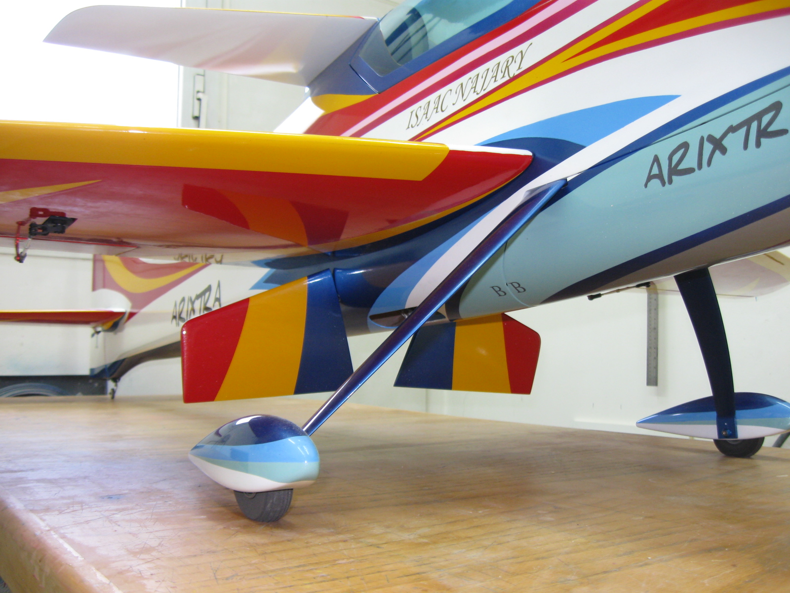

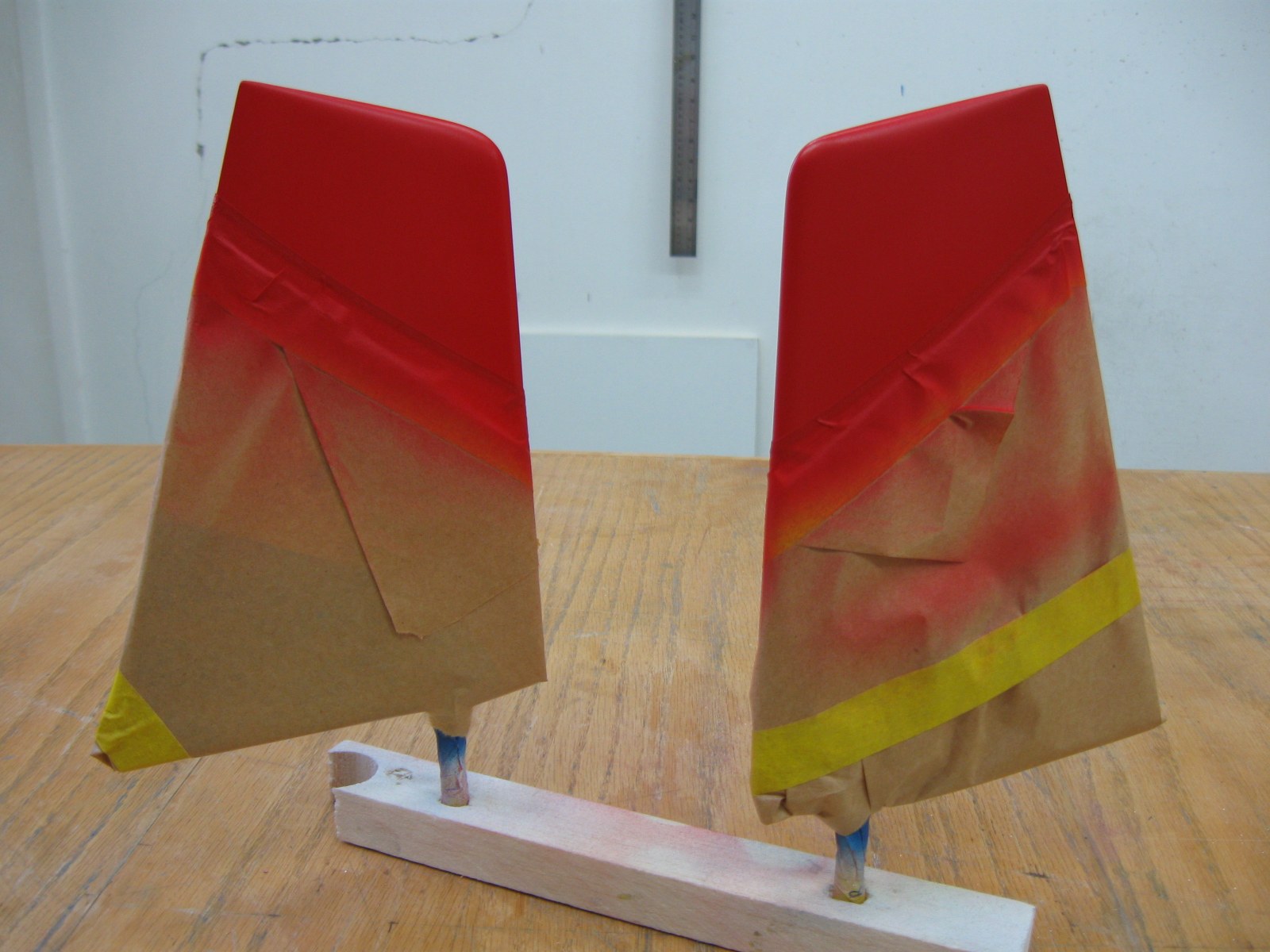

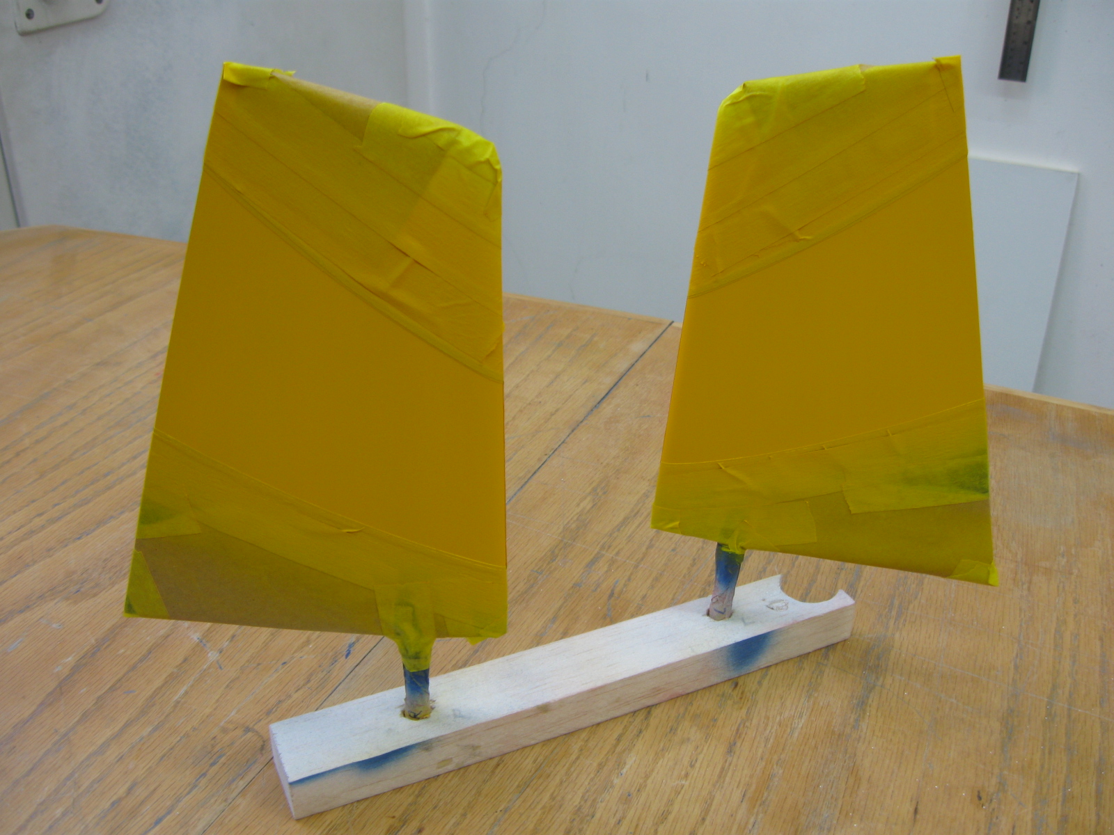

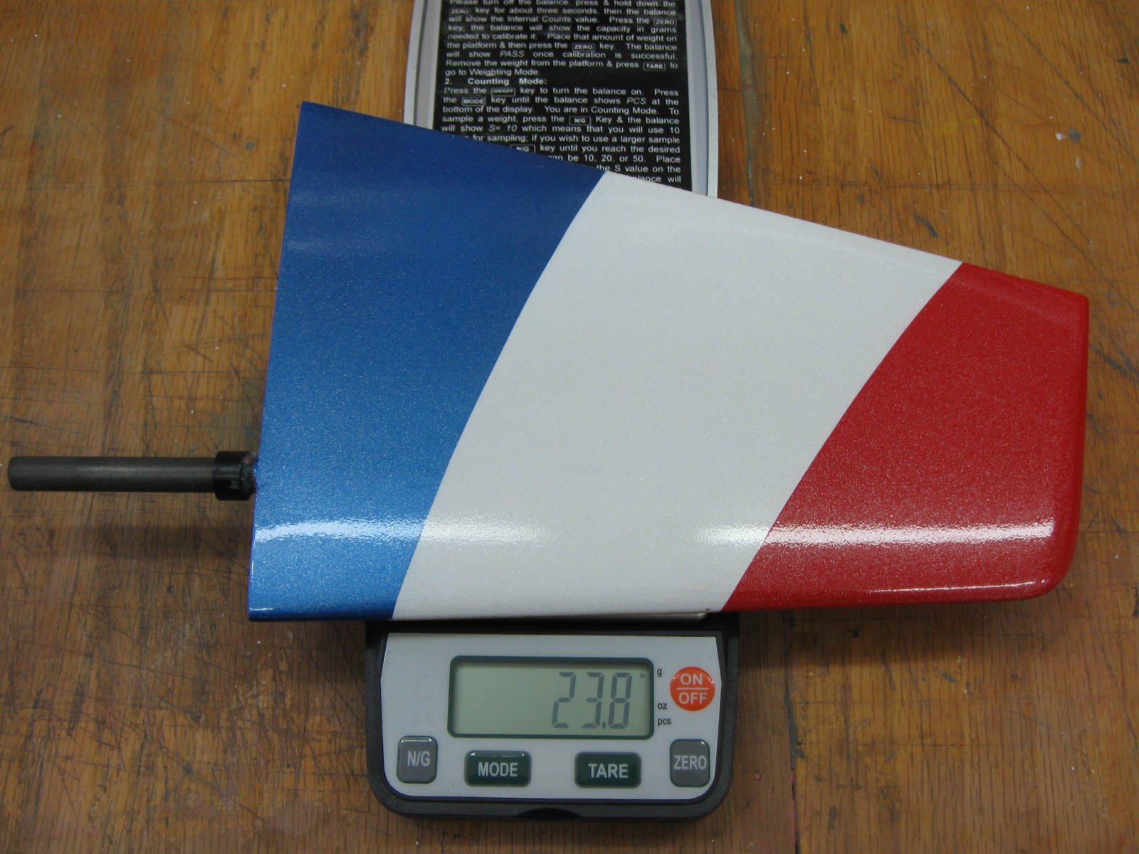

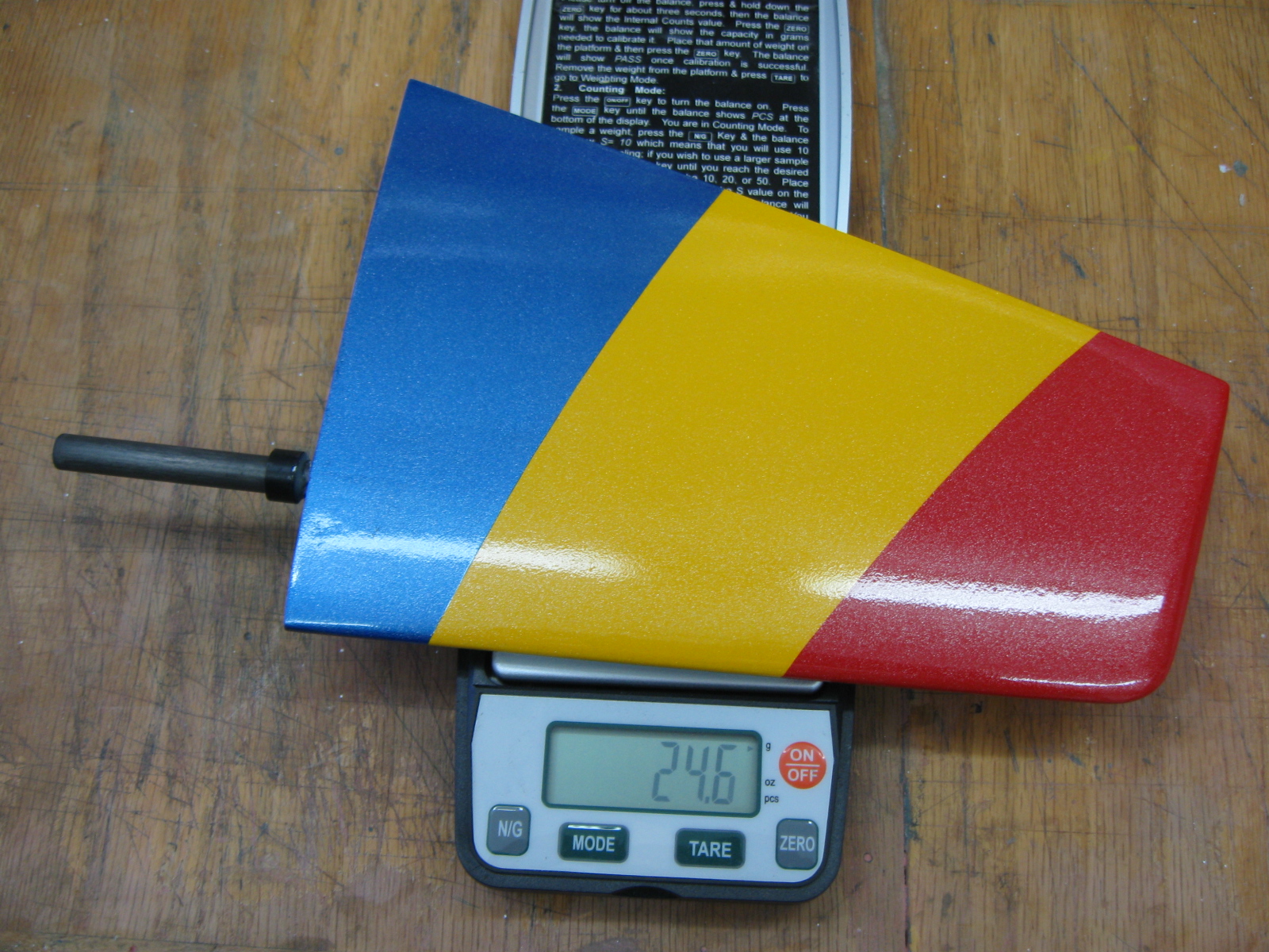

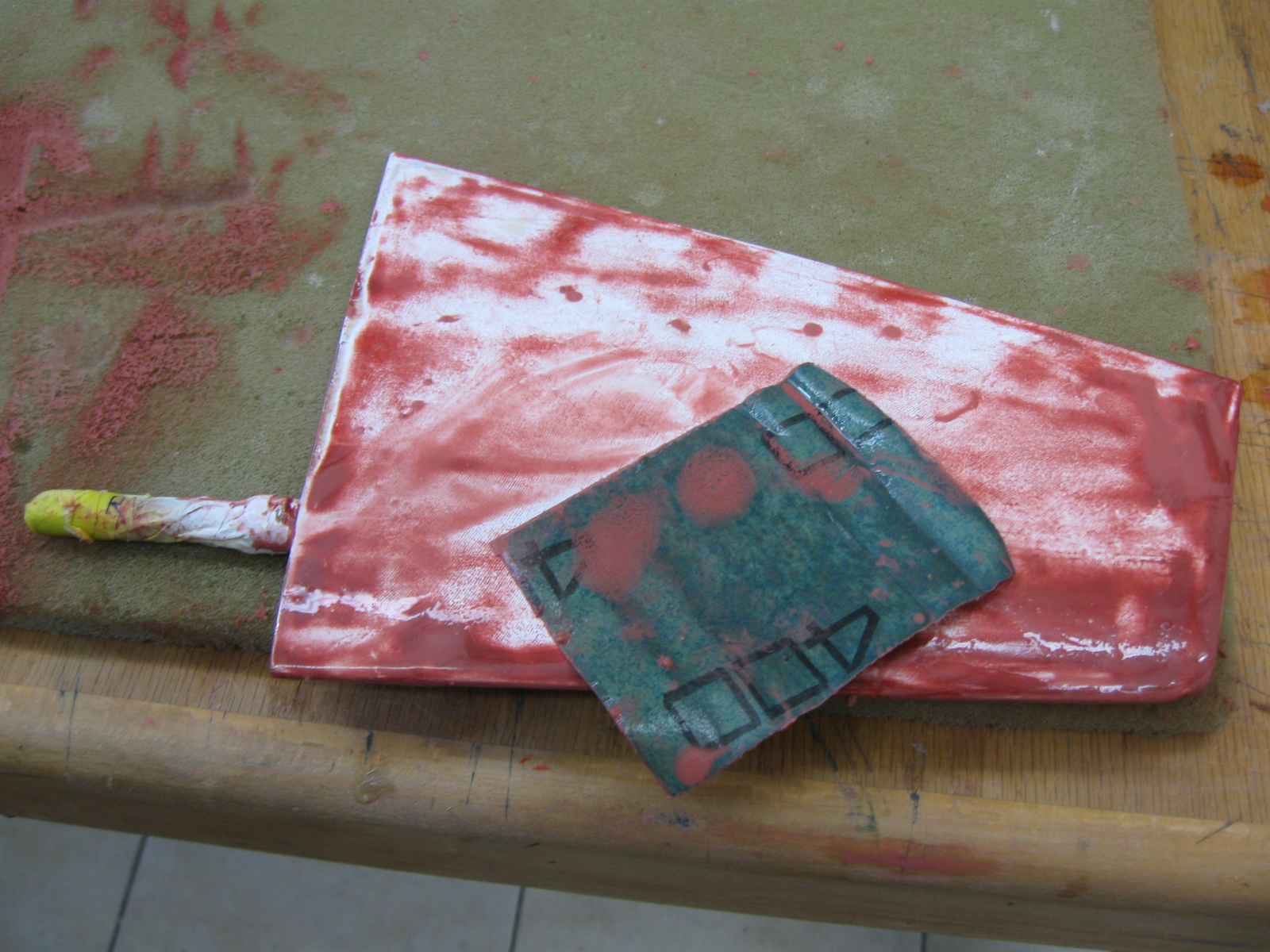

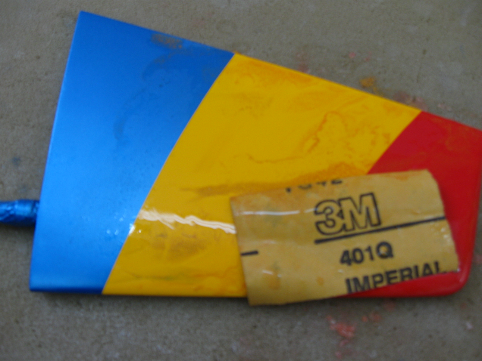

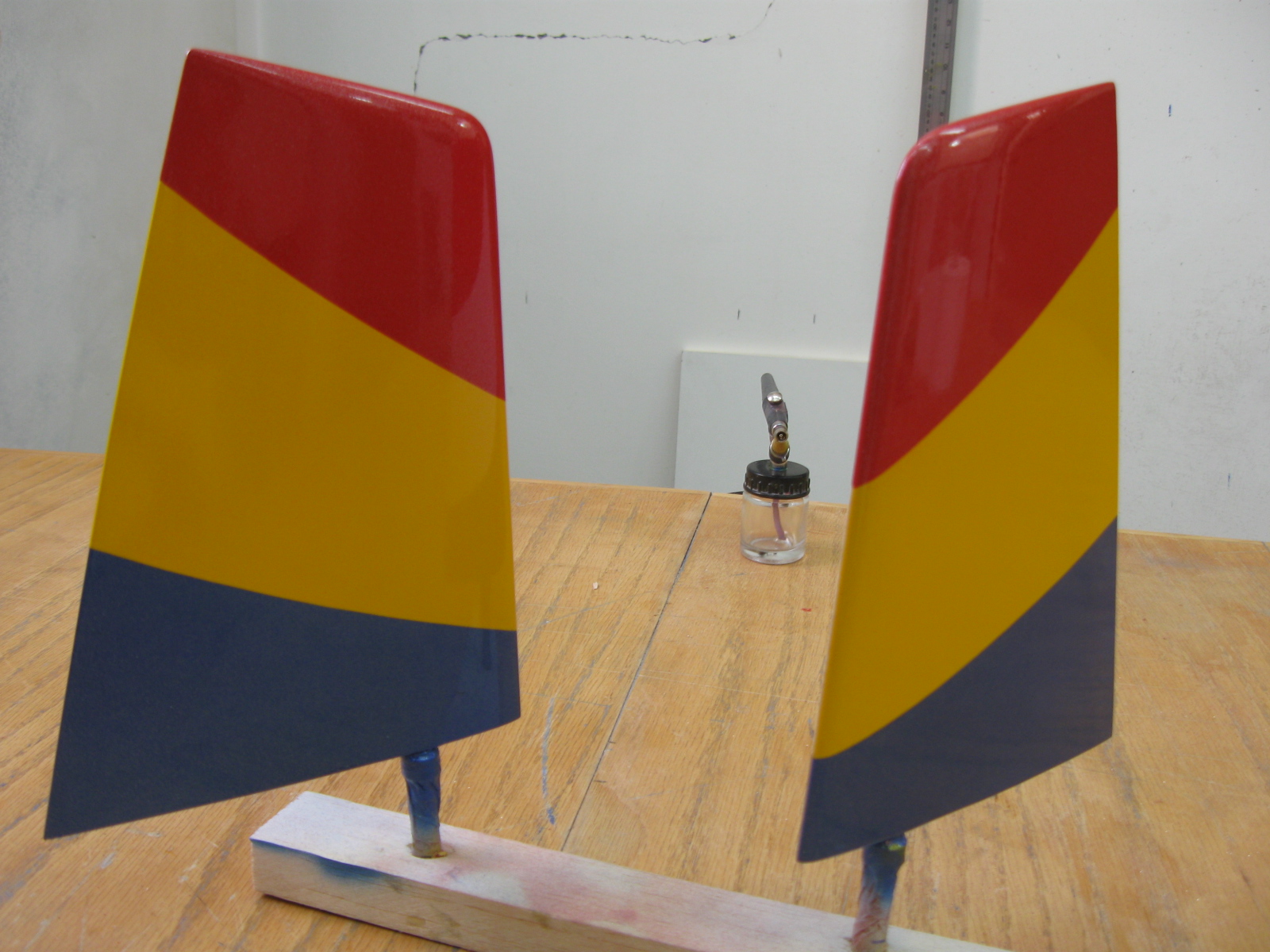

Painting.
Total finishing process added 15.7 gram (24.6+23.8-16.1-16.6)

More

More

More

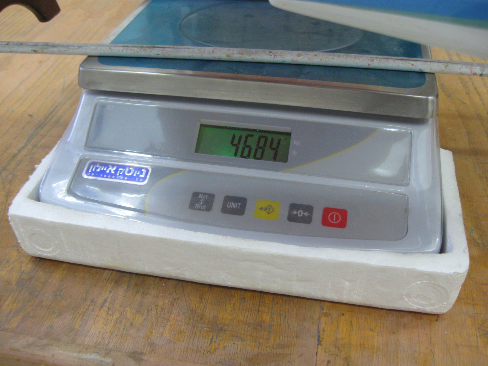

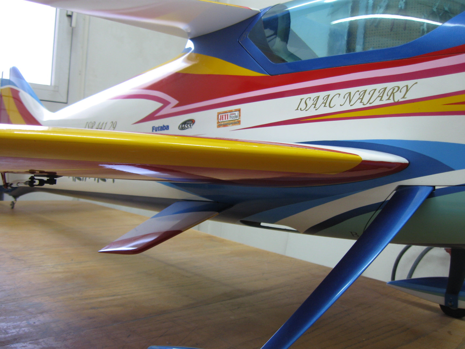

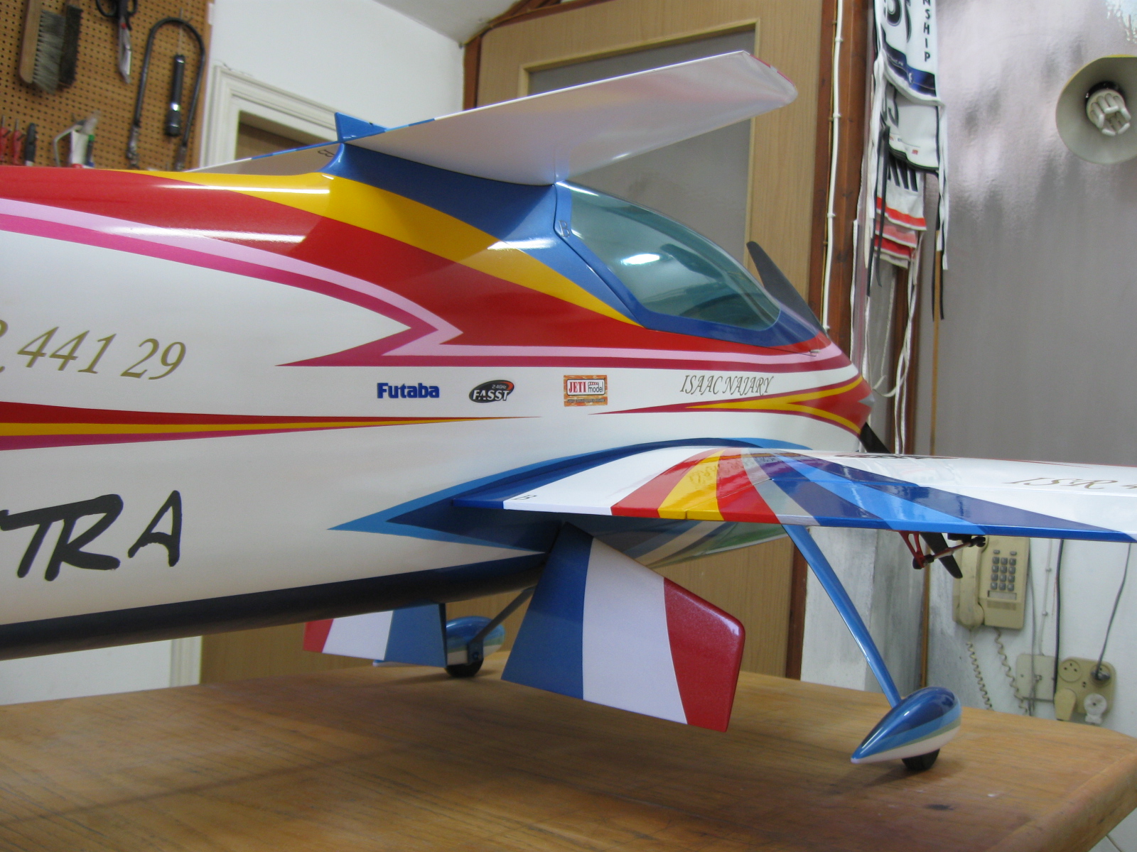

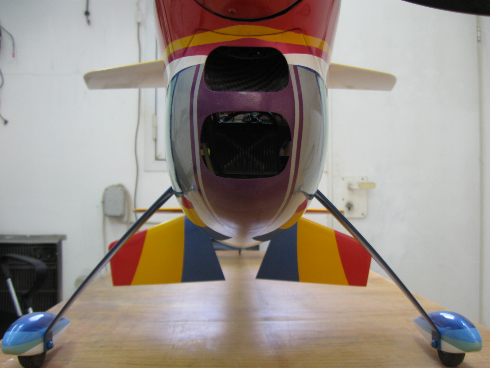

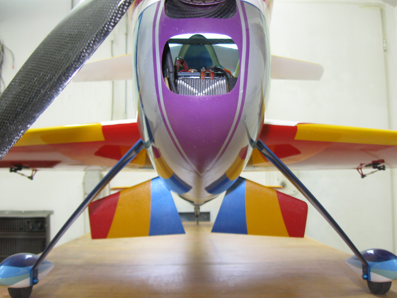

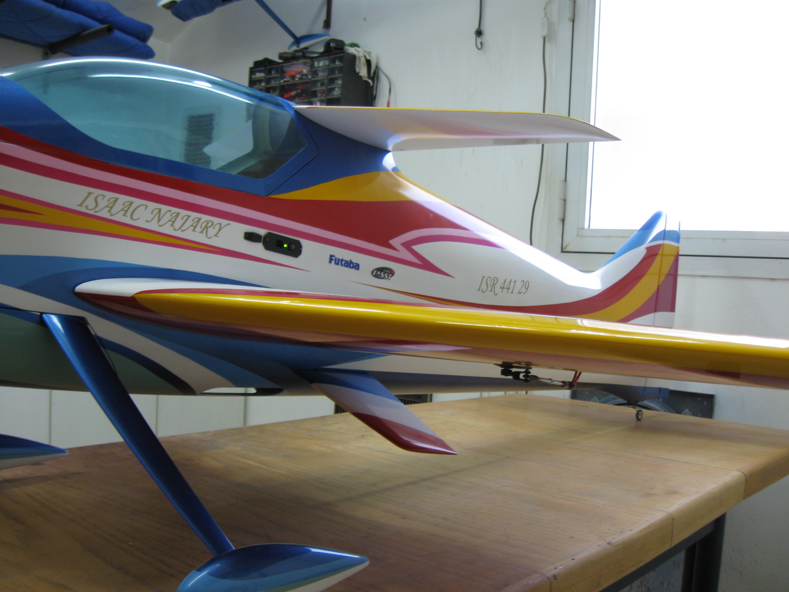

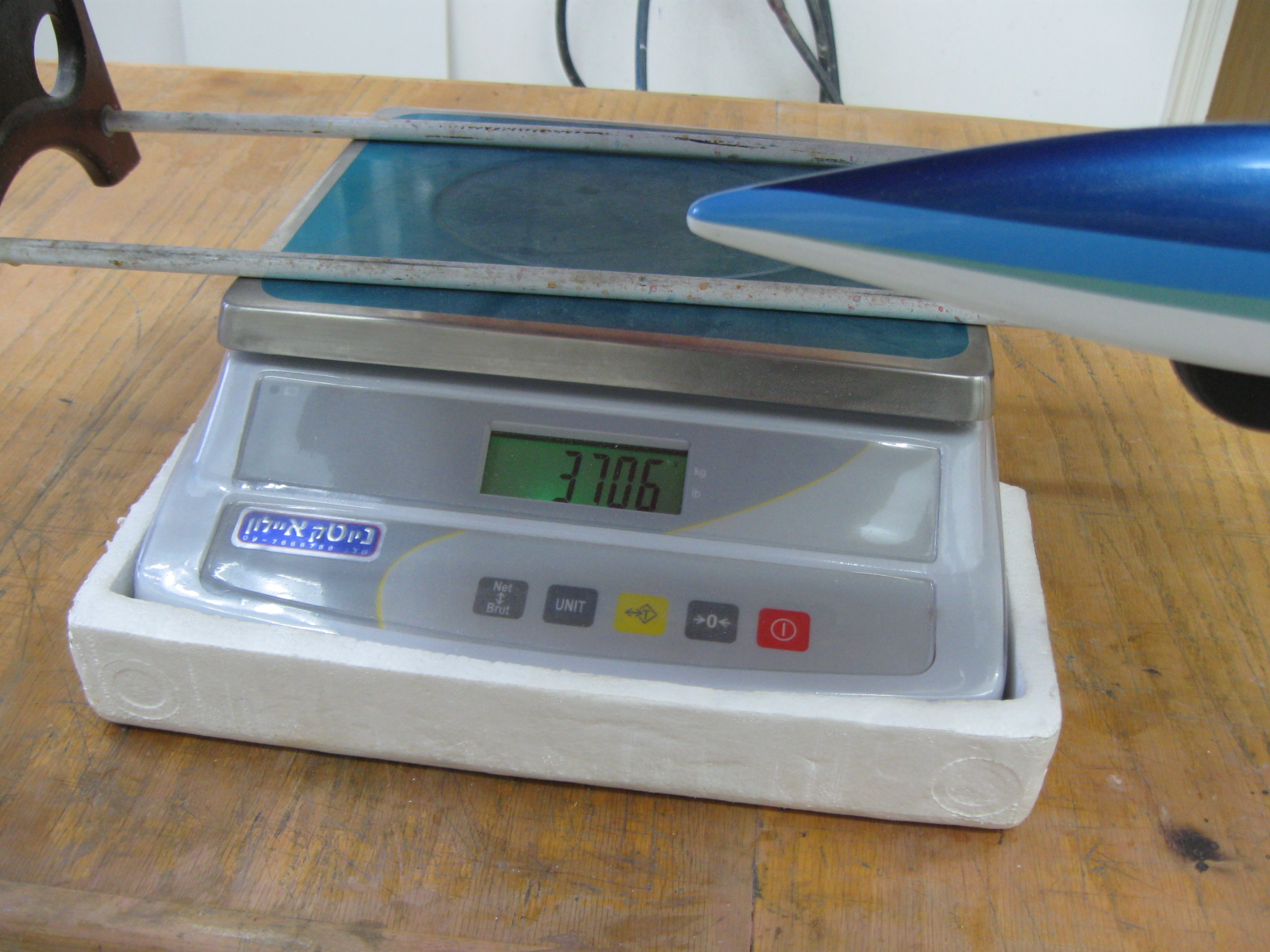

Model final weight without motor battery – 3,706 gram.
Model final weight with DUALSKY battery (4,600 mah 25C - 978 gram) – 4,684 gram.

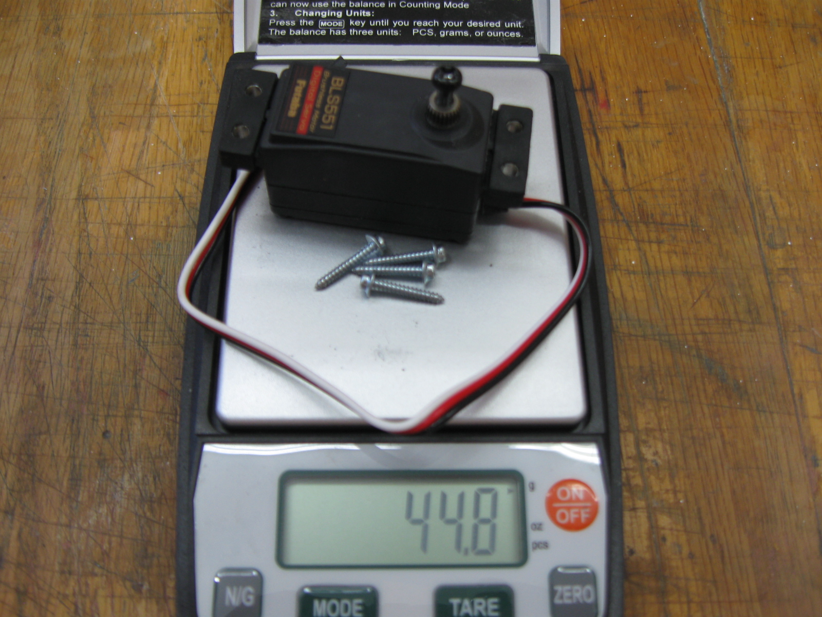

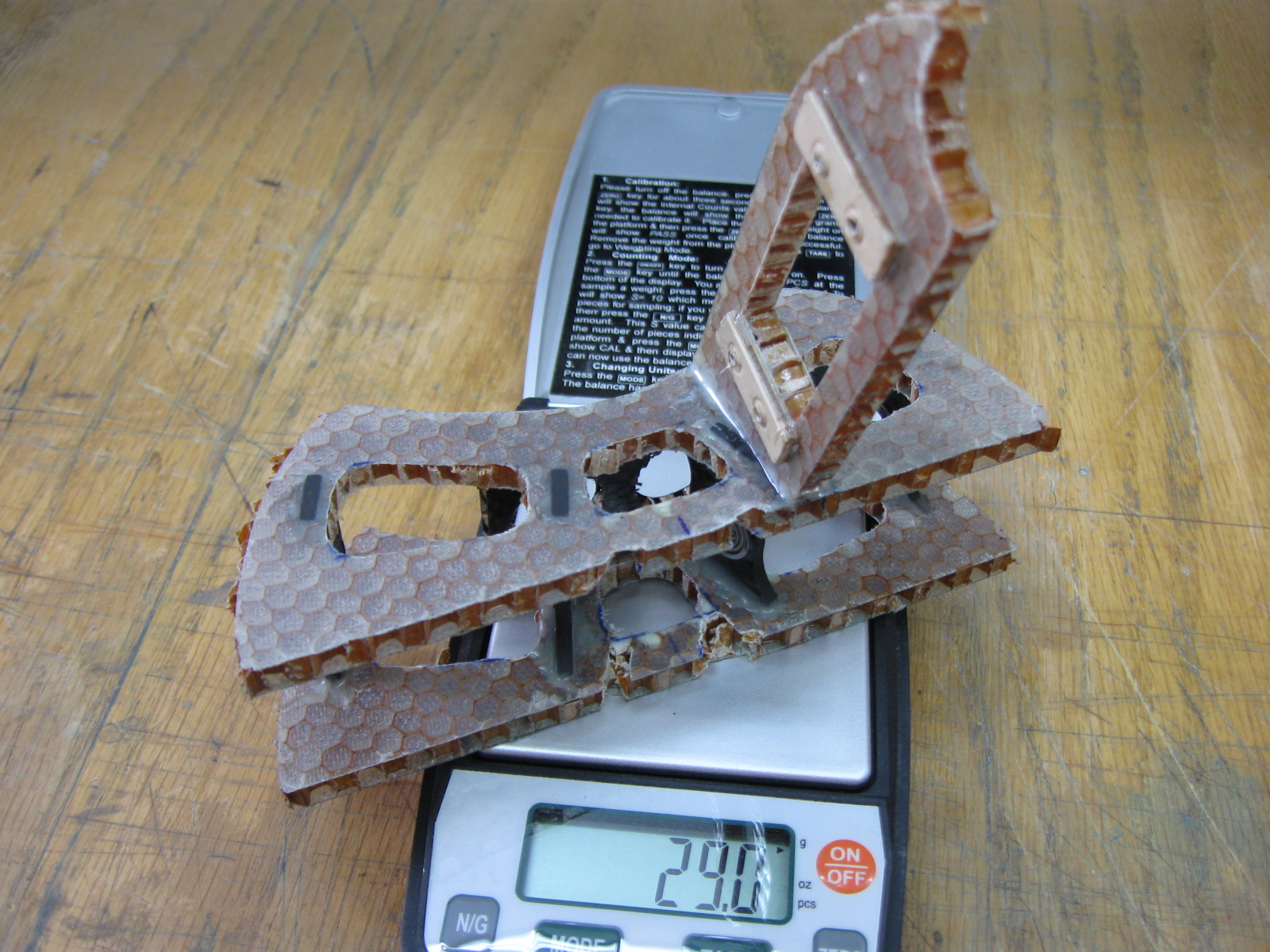

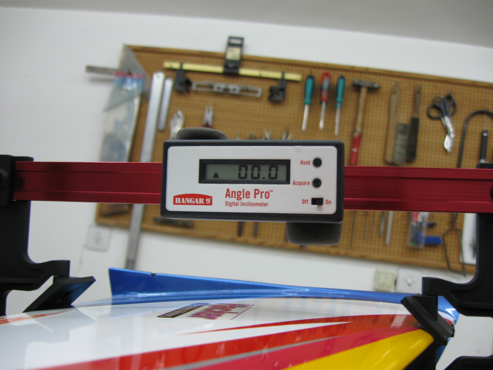

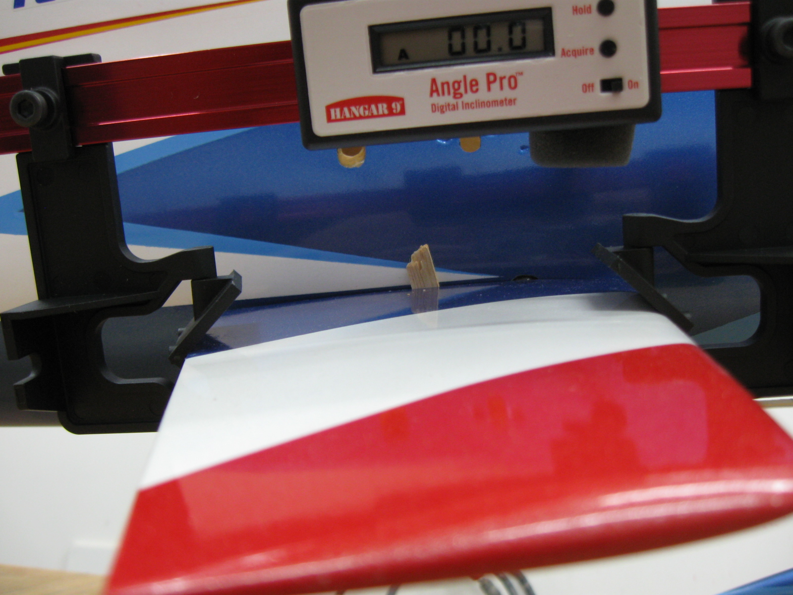

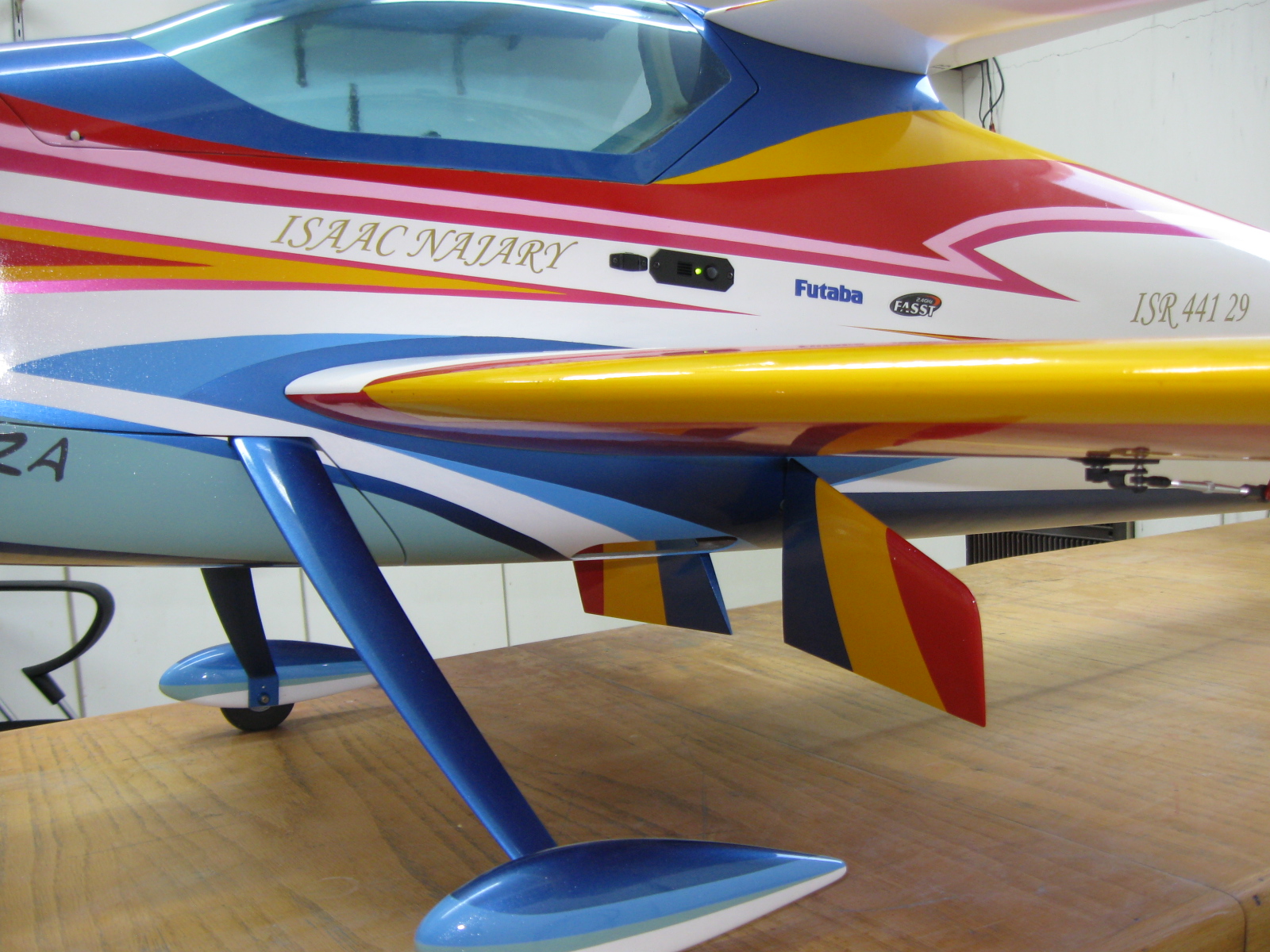

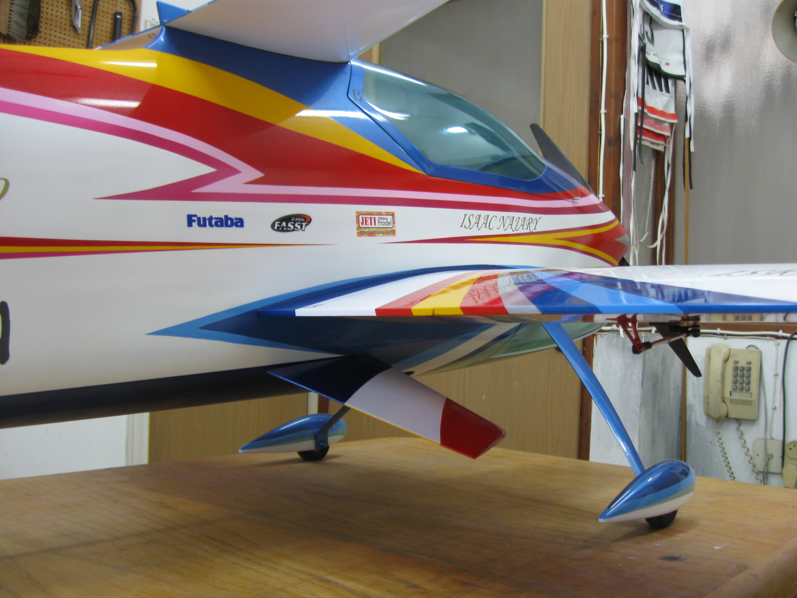

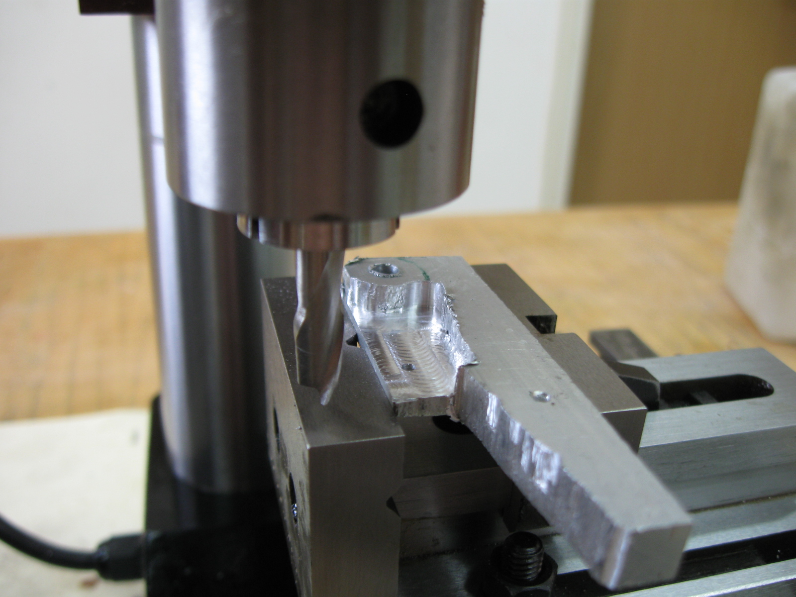

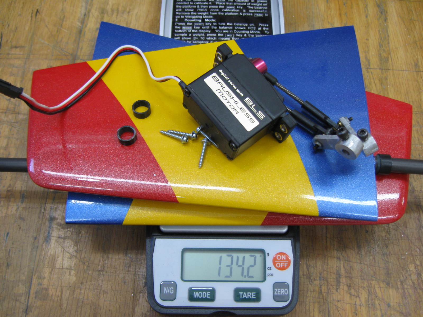

To avoid unwanted flexibility of the plastic horns I make new ones from aluminum, and to avoid the servo meal gear tolerance, I changed the servo to a plastic gear servo.
The final weight of the all system is now 163.2 gram (134.2+29.0).

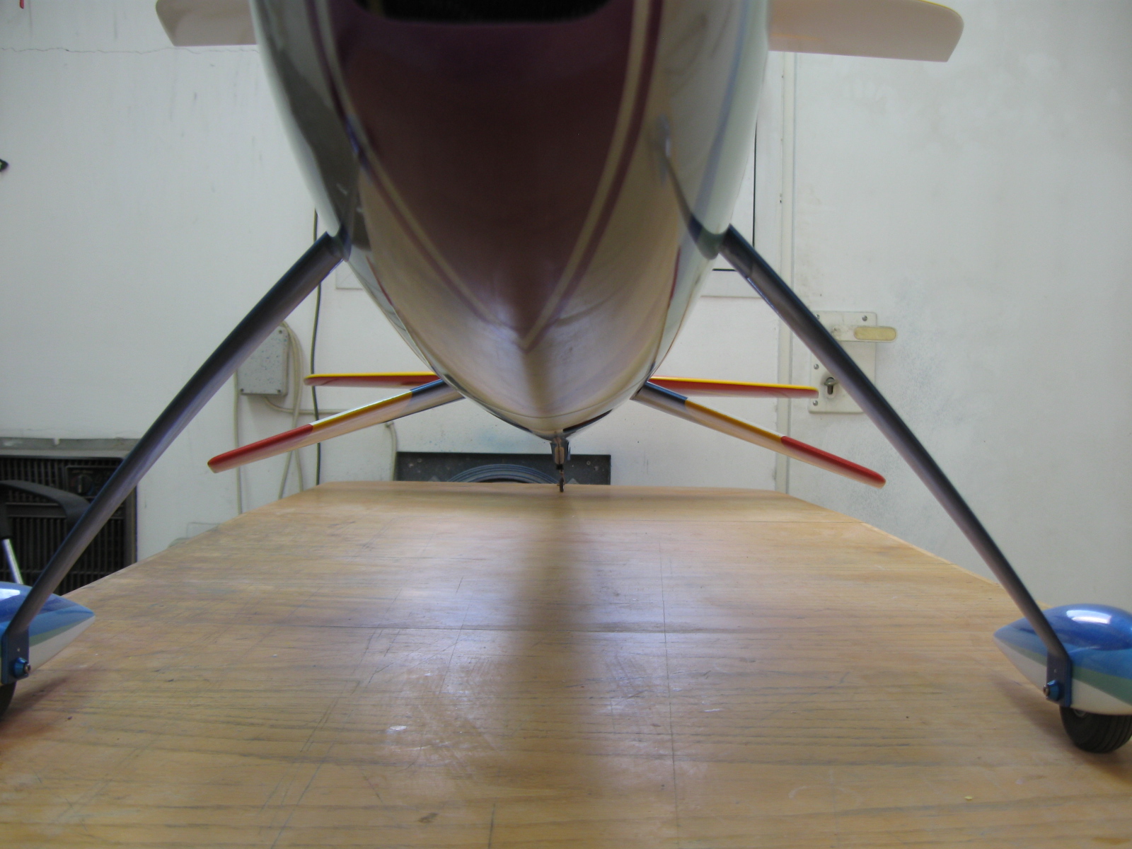

Hello

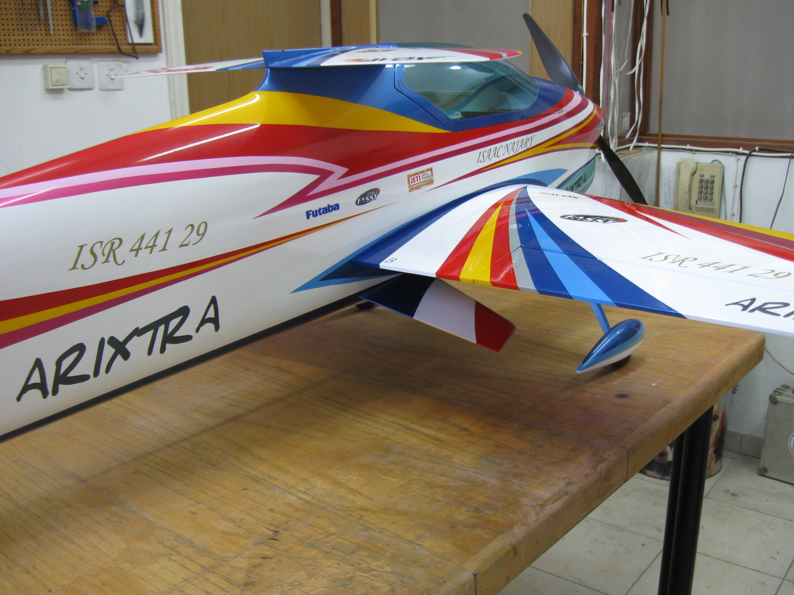

Today I flew with Isaac Najary, And I saw the Najarylyzer In action
At a time when the plane dive Isaac runs the air brakes . and have to see it to believe
The Plane diving vertically at a constant speed and slowly Like a parachute attached to his tail
Very impressive

After watching the movie I made some calculations (all the dives started and ended at about the same altitude):
Dives without any brake takes about 7 seconds.
Dives with the air-brake and the motor brake takes about 10 seconds – it is 43% longer then without any brake (10/7-1).
We did not film dives only with motor brake but I cam estimate that only with motor brake is somewhere in the middle.
Best regards,
