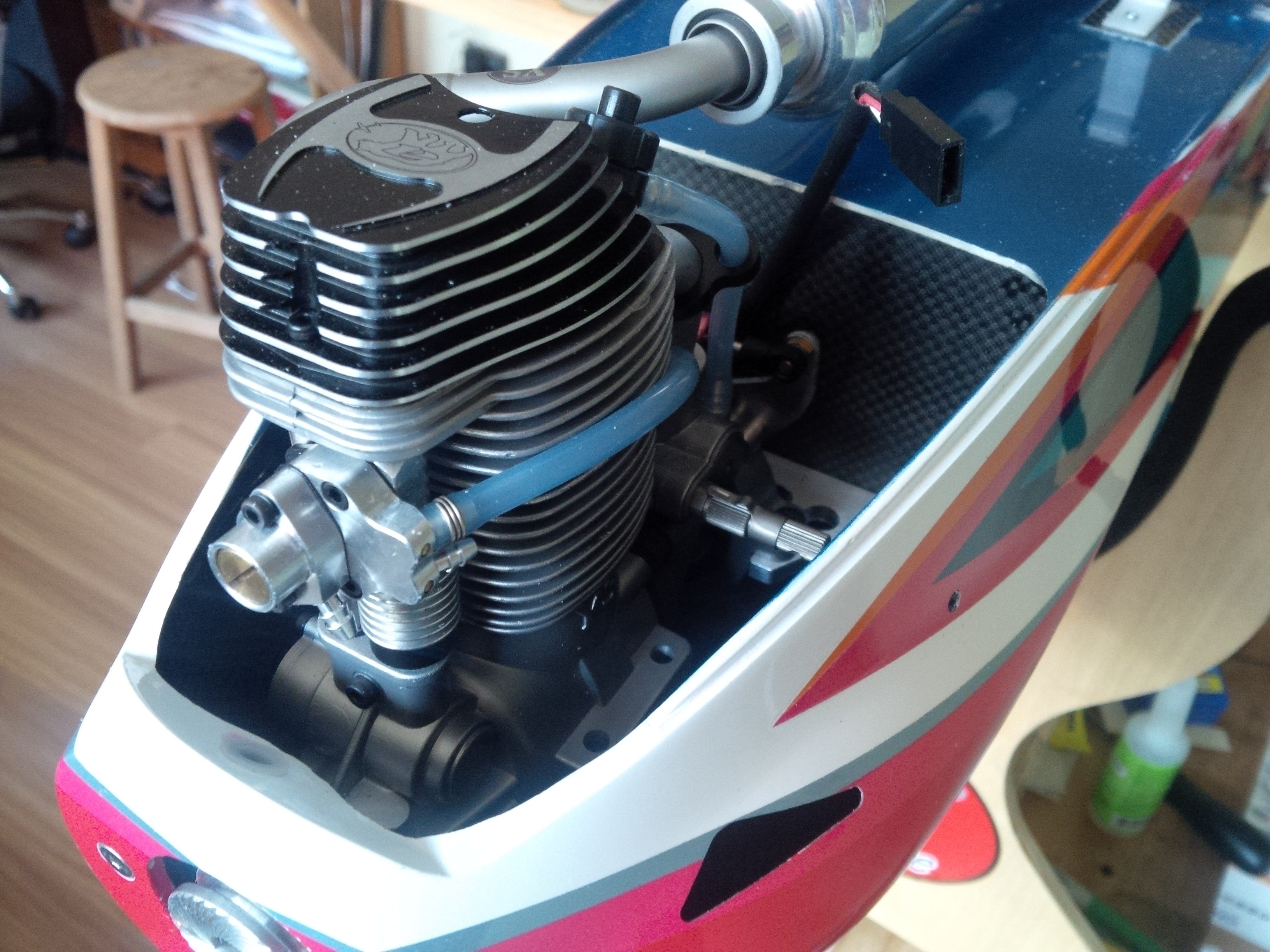

Just finished breaking in the non cdi 185 DZ on an engine stand, & all I can say is "WOW". This thing is an animal, with scary power, especially on transition from mid to top end.
On my last two tanks, I put on a 20x10.5 PN prop - the same one I normally use on my 175. With 30% heli fuel, the 175 gets about 7,100 with header & pipe, the 185 get close to 7,800 without any restriction. However, the 185 power delivery is smoother than the 175. Since the 175 with the 20" prop already have more than enough reserve power, I have the feeling the 20.5x10 PN is probably more suitable for the 185. Hopefully, I will have time next week to fly with the new engine.
More to follow.
Adrian

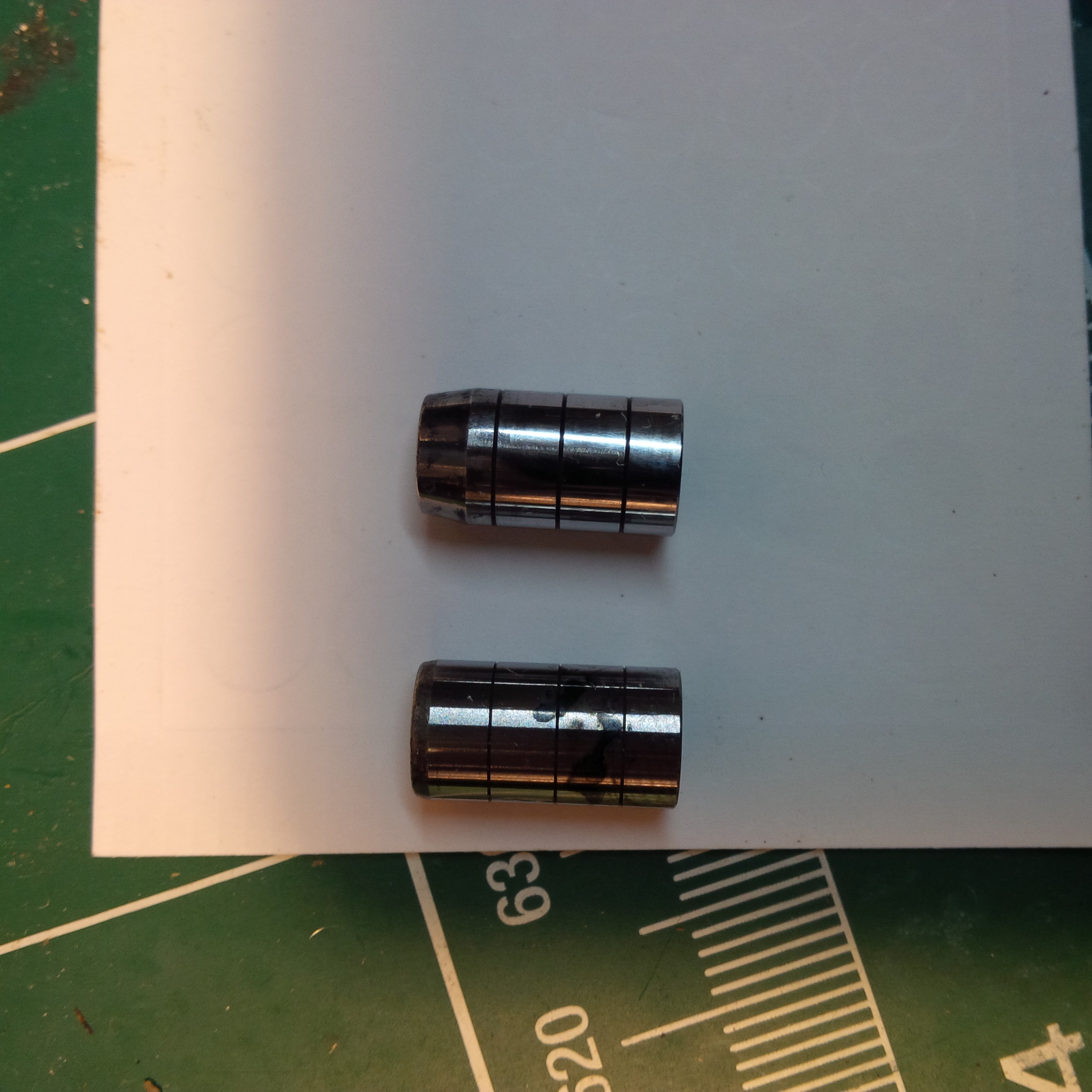

Dave,
Here is a picture (the best I could do at the moment) of the pistons, the one on top is on the 175 pump, 170 on thebottom, it has a taper on top and the lubrication groves are bigger , I guess with better lubrication it should last longer.
The pump internally pretty much remains the same.
I hope this helps and is what you wanted to see.
Regards
Alejandro

Thanks a lot for your efforts to answer the pump piston question.
I had hoped that YS had installed a cylinder liner of harder material than aluminum.
I am somewhat surprised that it lasts as long as it does with a steel piston.
This might be a good reason to avoid low oil content fuel and perhaps add a small amount of castor.
My airplane has limited space in the engine area even for the 170.
Also, I hope the 185 has the same mounting hole spacing.?
Is the 185 larger externally than the 170?
Dave

Hi Dave,
The fact the piston and liner are aluminum/chrome is no surprise as it is the most used combination for piston engines, from RC to full scale aircraft piston engines, but backwards, where the piston is steel; An aluminum body is easier to manufacture and it is lighter, but I do think the grooves in the piston might be all that was needed to solve the situation you had, how many flights did you have on that pump? 600+?
I fully agree with you about the oil, I still run 23% oil and never had problems, but no Castor, castor in this pumps is a killer if you let the engine sit for a while, my engine was in a bag for over a year, and the old fuel stained the piston, now that I took the pump apart to take a picture for you is when I realized if I want to store this engines, it is better to take the pump apart completely, clean it and lube with a light oil. Personally a have been using 3 in 1 since I was a kid and started on Rc with great results. What do you think?
The 185 is identical to the 170 and it's predecessors, exact same dimensions and physical appearance, the only way to tell which is the 185 is on the pump, the reference pressure hose it is not used anymore, look at the picture I previously attached, apart from that, like with previous models it is a bolt on replacement.
Best regards
Alejandro
