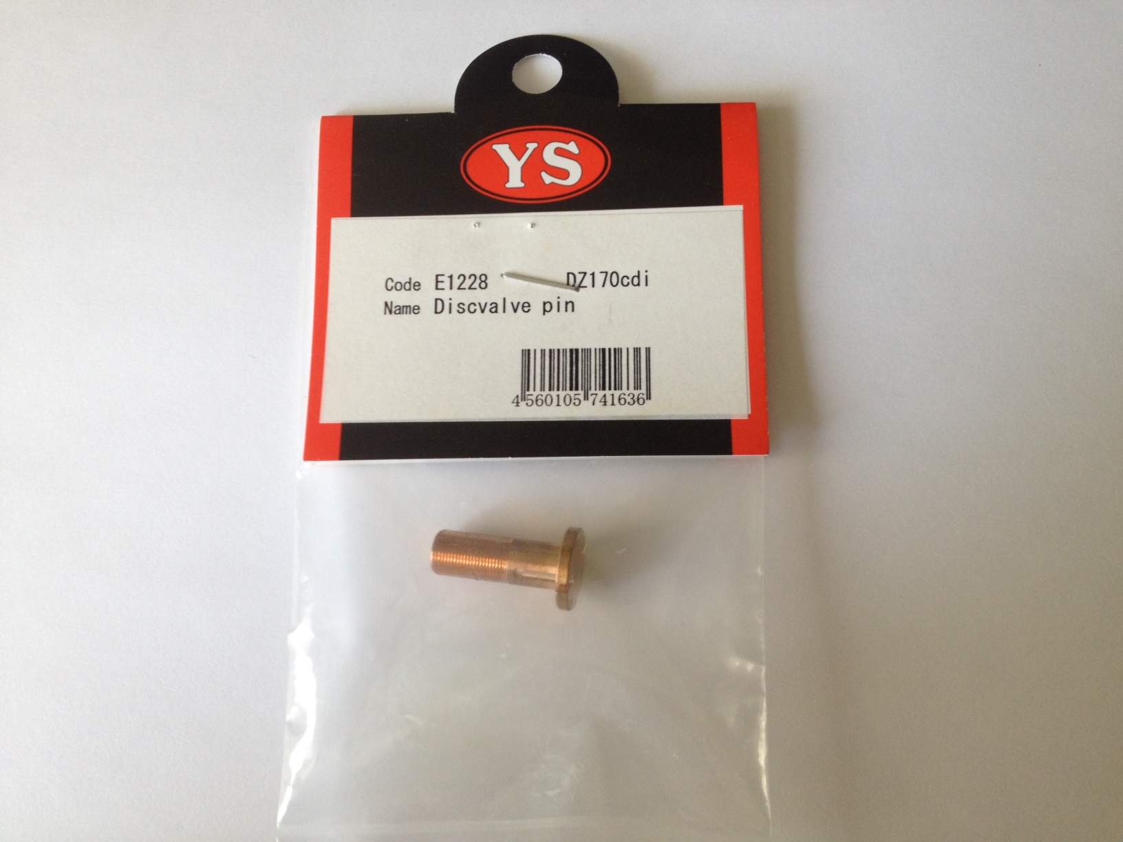

Old 07-29-2014 | 12:47 AM
Joined: Mar 2004
Posts: 67
From: Kongsberg, NORWAY
My experience is that play will develop radially over time, however, does not seem to hurt the performance.
But no need to change the entire disc valve, just the Disc Valve Pin (YS part no. E1228 (170CDI)).
The reason the pin gets worn is that the disc valve is not balanced hence the pin has to react the radially forces.
regards,
Arnstein

Hi Arnstein,
Thanks for the advice........it turns out you can't buy the pin on its own you have to buy the whole disc valve assembly.
regards
Mavros
Old 07-31-2014 | 12:23 AM
Joined: Mar 2004
Posts: 67
Mavros,
I was not aware of that, the cost of the pin is probably only 10% compared with the complete assy. It certainly would help keeping the maintanence cost down.
regards
Arnstein

Old 07-31-2014 | 01:07 AM
Joined: Jan 2009
Posts: 342
From: NEWCASTLE, AUSTRALIA
OH so you can ...i will try my supplier again
thanks Arntein
ps Where did you get yours?
regards
Mavros
Old 07-31-2014 | 01:16 AM
Joined: Mar 2004
Posts: 67
Directly for YS.
Arnstein
Old 07-31-2014 | 01:27 AM
Joined: Jan 2009
Posts: 342
Which website are you using for YS
Mavros
Old 07-31-2014 | 01:35 AM
Joined: Mar 2004
Posts: 67
http://www.yspower.co.jp/en/index.html
Old 07-31-2014 | 01:48 AM
Joined: Jan 2009
Posts: 342
Arnstein,
Thank you so much just placed an order ...much cheaper than whole assembly.
kind regards
Mavros
